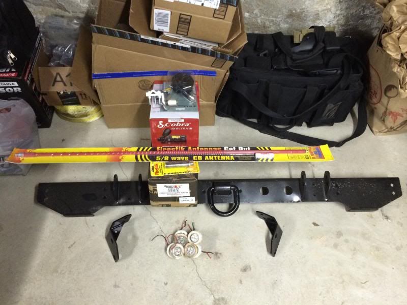

I picked up a Genright rear crossmember bumper from a local buddy with frame tie ins and rock lights for $100!
I also have my CB setup now. Cobra 19 Ultra III, rugged ridge dash mount, and firestik 3' antenna with all necessary mounts and wiring.

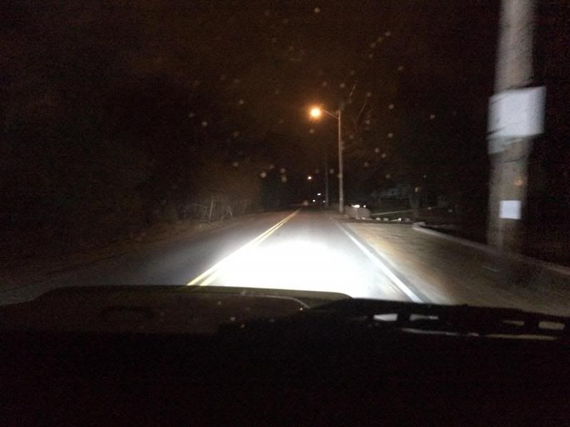

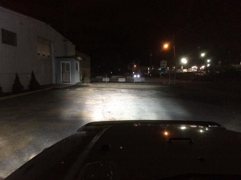

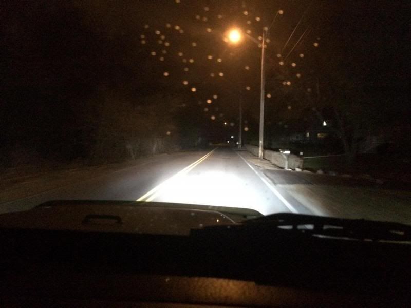

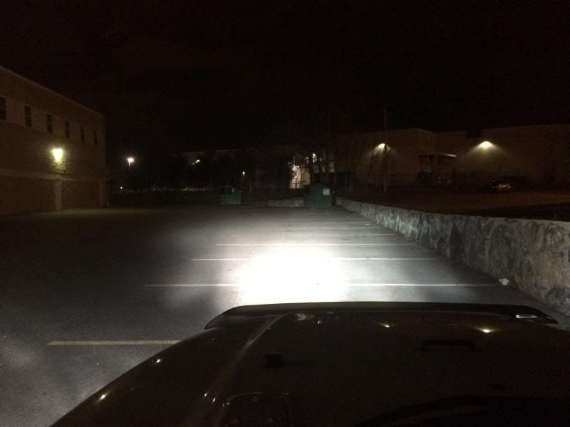

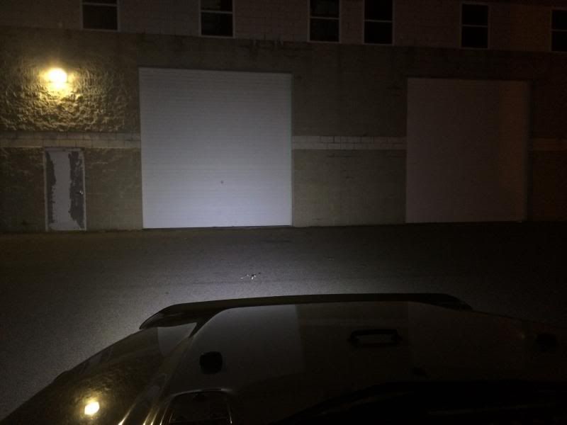

As promised, output and pattern pics.
Output is great, but the pattern leaves a lot to be desired:
These will be very nice after stage 2 is complete:
As you can see the pattern is quite scattered:
The LED flood lights are less obnoxious:
On the road:
While I would not recommend people who drive a lot in the dark do this, it is a start. We do very little night driving right now. By the time we are ready to drive the LJ more often (good weather), stage 2 will completed.
