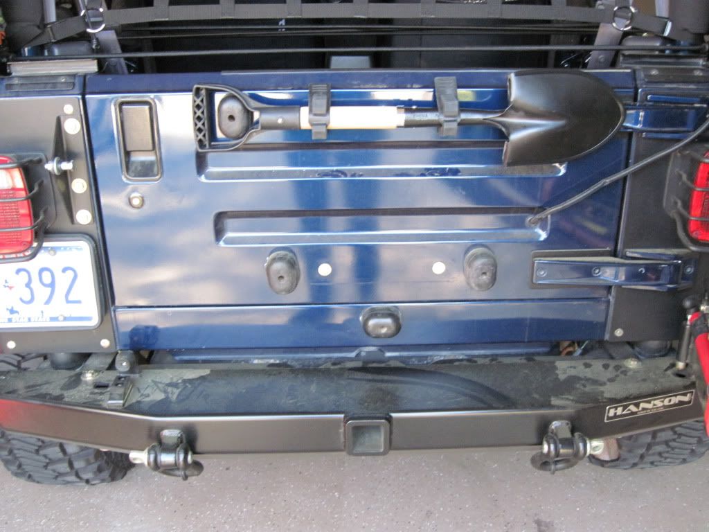

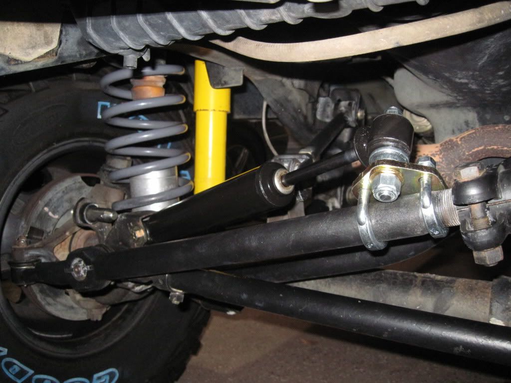

I picked up a Monroe Steering stabilizer from Napa for $26 and put that on my currie steering bracket.
I also picked up a 2' shovel from craftsman for $9.99, alongside some quickfist clamps for $9.99 from 4wheelparts, I drilled their hole for 5/16" bolts and put them were the stock carrier bolts were, added some edge guard around the shovel just as insurance it wouldn't rattle on the hinge.

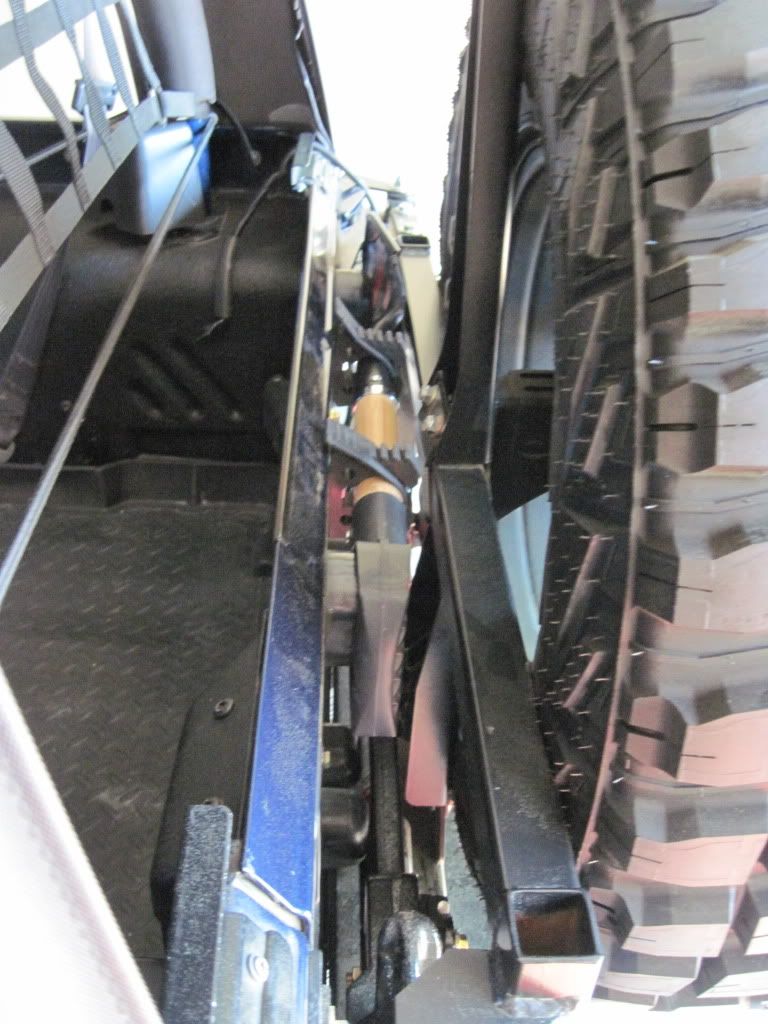

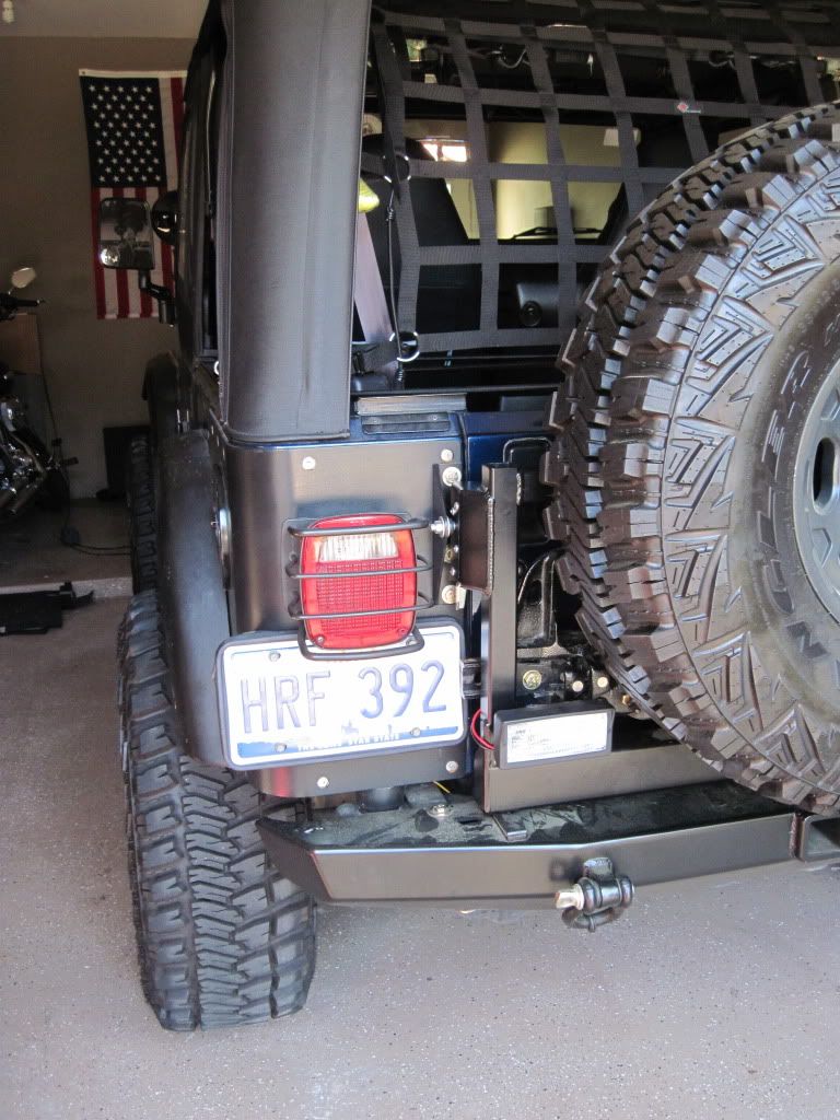

I also scored a Raingler RPBX back net off ebay for $65 which fits from behind the soundbar, down to the seat belt mounts where you can see in this pic. Another great thing, is that it will fit across from the rear rollbars to the middle ones, effectively becoming a cargo net. Ill get some more pics of this thing soon, the quality is great.
and I installed a pair of 55Watt KC hilights 26 Series backup lights at $64, I bough them individually,from 4wheelparts, and I bought all the wire seperate because I wanted to redo my front KCs also, so about $60 in wire and crimper, relays, for the fronts and rear came out cheaper than buying the kc harnesses. I also ran 12 leads and 14 control guage wires, So I shouldn't have any more burned out wires. I also went ahead sealed up a Radioshack project box to waterproof my relays.
These things are bright, alot brighter than I expected, Im glad I have them on a toggle switch and not everytime I backup.

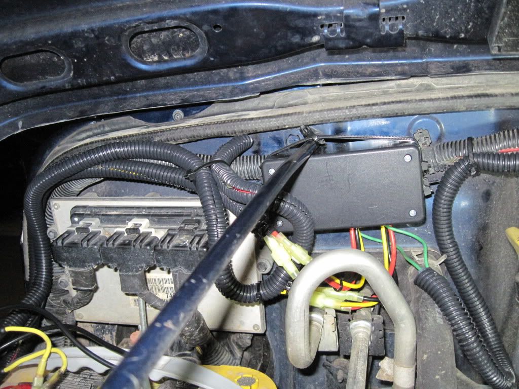

The splash guard for my Relays I sealed with rubber grommets at the wire holes, and siliconed the face on, but its still accesable with a screwdriver and some prying off, I ziptie mounted it for now, its not pretty, but it works fine and doesnt rattle around.

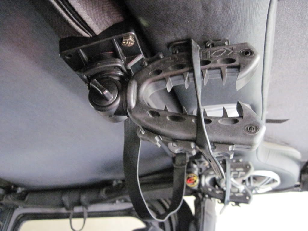

I also wanted to come up with a good solution for mounting a rifle inside the vehicle while hunting that didnt take up too much trunk space. I found these KOLPIN XL RHINO GRIPS at gander mountain for about $40. Theyre plastic and rubber with a steel backing plate, and they rotate and lock in at pretty much 360 degrees by loosening big screw to rotate one way, and pulling the clip thing to rotate the other way
Once I replaced the hardware with longer 3" 1/4" grade 8 bolts they fit on the upper rollcage. Well without the rollbar padding they would fit perfect with all 4 bolts. But I didnt want to remove mine right now so I just used two bolts across each corner. Once bolted in place It held my M4 very snuggly.
Theyre no security by any means, other than Its high up, and youd have to be in the car to grab at it.

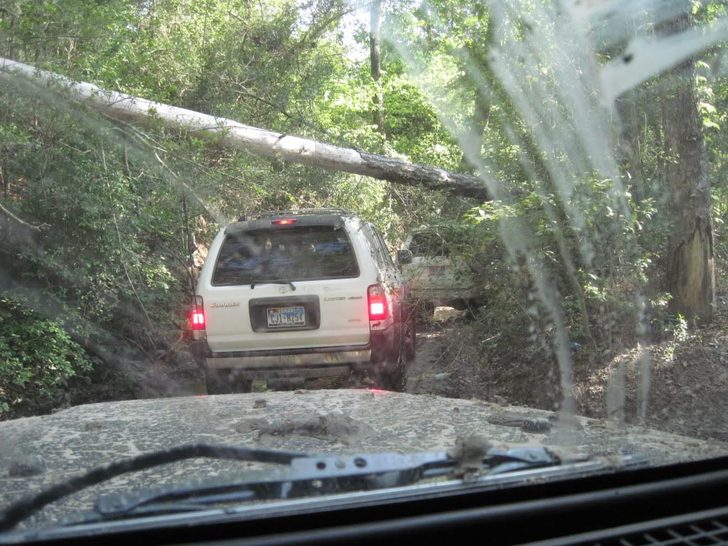

joined some friends and some rigs from TX4WD katy chapter, at Brazos Valley Offroad Ranch.
I took the doors off for the first time. It took three people theyve been stuck on their good but I lubed them up and hopefully it wont happen again.
Heres the some pics

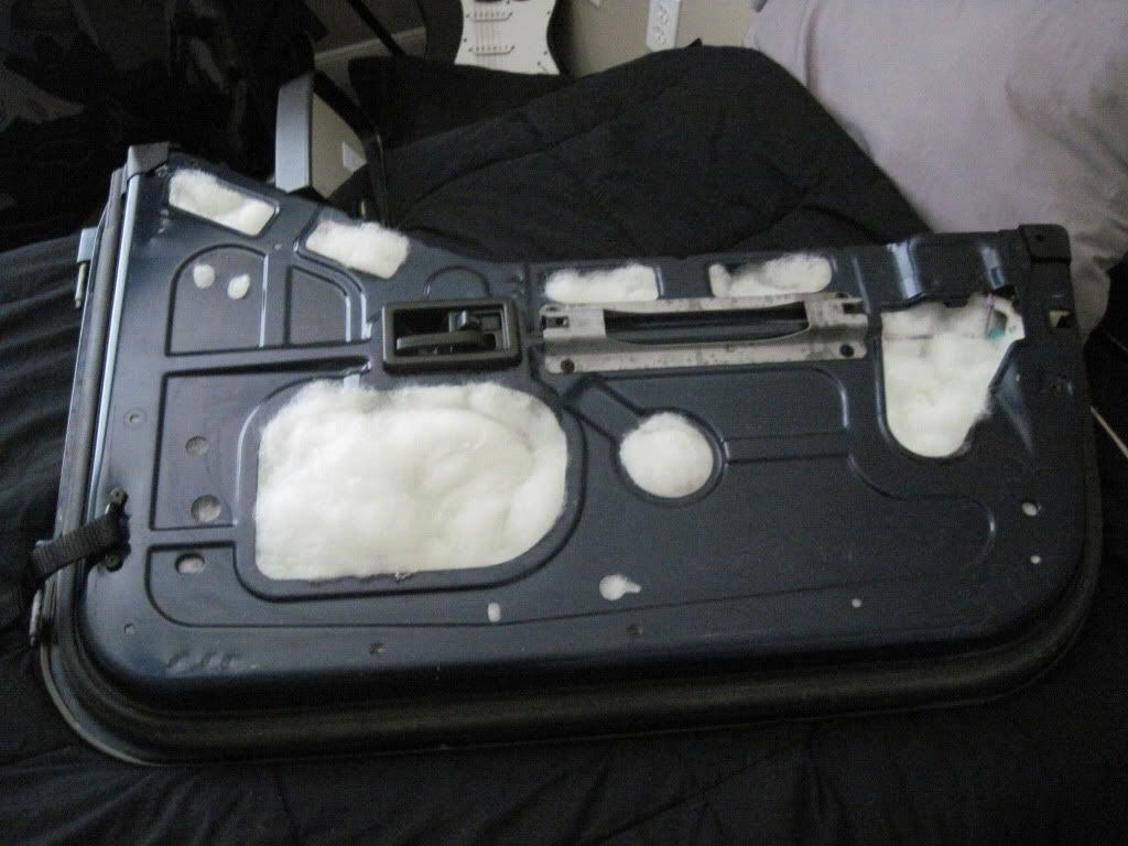

I decided I wanted to try that peelnstick as a cheap dynamat alternative that gets talked about sometimes to see if it works.
I bought just 1 roll for 16dollars and lined the inner part of my doors. Its probably the stickiest substance known to man, getting it off would take some work. I also then stuffed it with fireresistant polyfill for 5 dollars.
Between the two, it worked great. A simple knock test you can tell the acoustic difference. And now the door slams with a subtle "thump" and not a "ker-clank" and the poly fill also makes turning of the lock, and handles feel tighter and dont have as much play, because of the cushioning tension on the levers.
i might put some under the tub over the cat and muffler and see how well they do with that much heat
I also added polyfill around my speakers and it made a slight difference on the dash, and alot of difference in the soundbar.

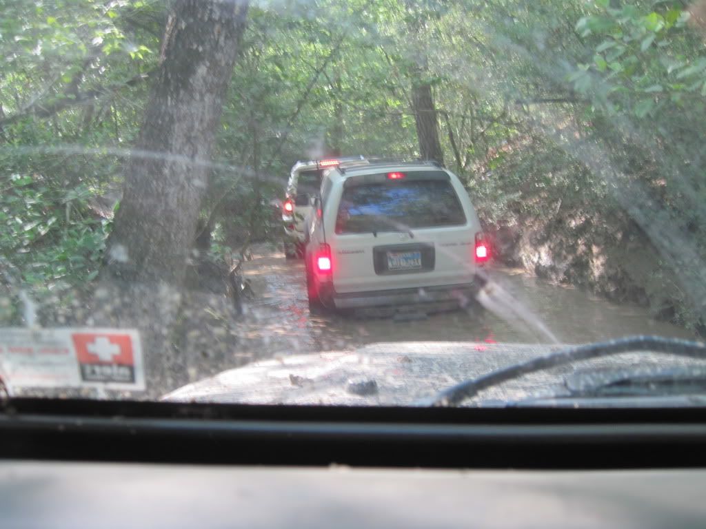

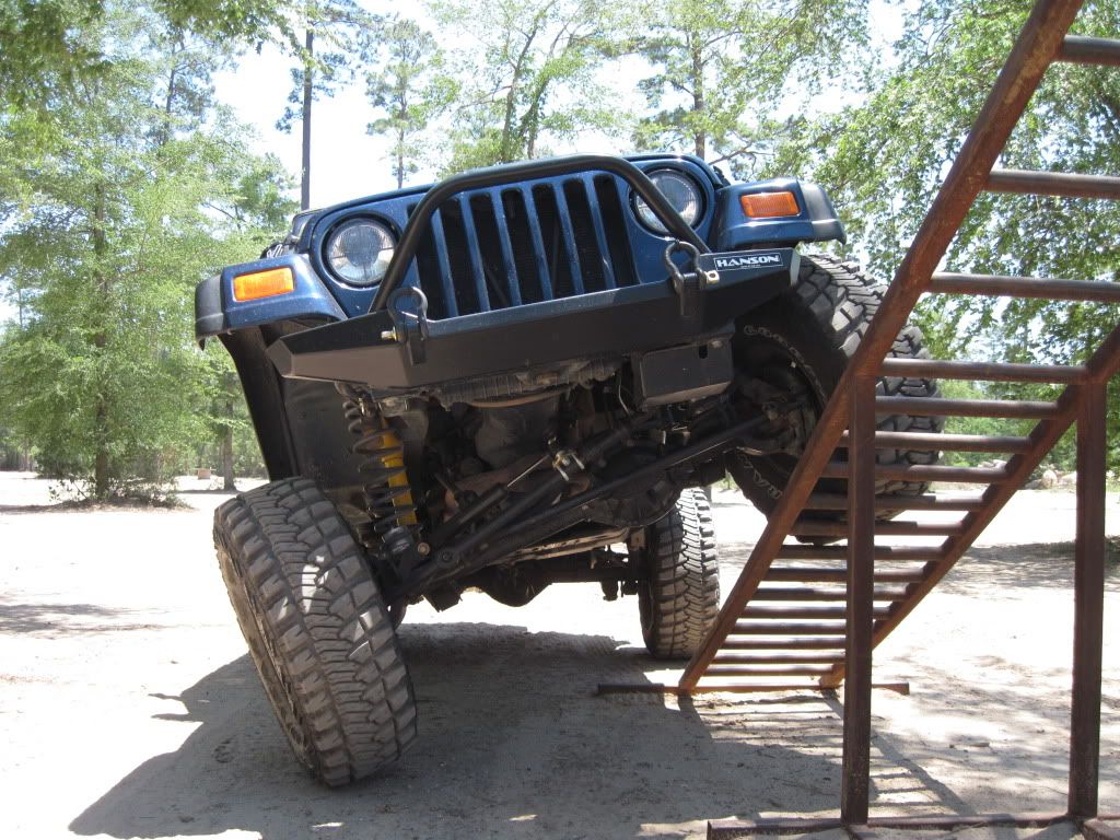

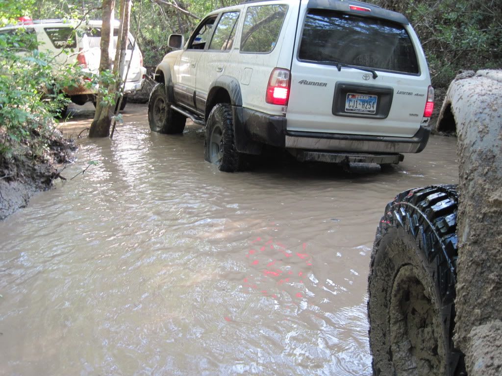

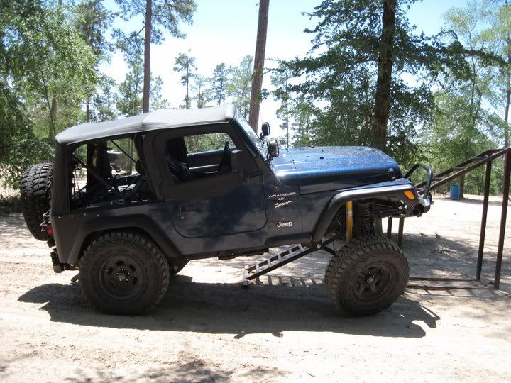

Went to General Sams in huntsville with three 4runners to play in the river and the mud holes.

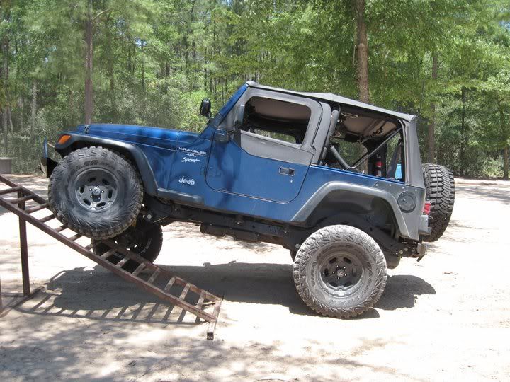

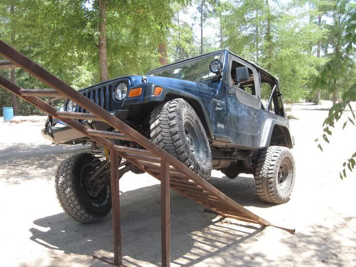

Had the chance at a real RTI ramp but forgot to measure. Hitting the bumpstops, not the fenders, shocks almost extended, front spring dropped, thats the max useful travel I can get.

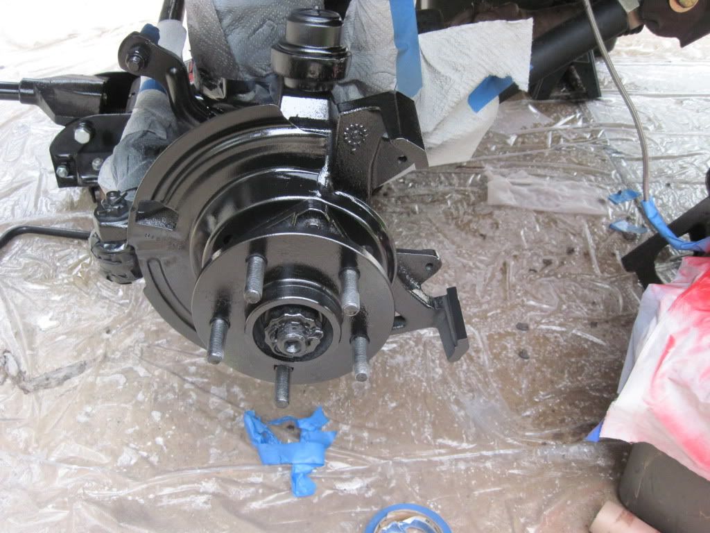

had to clean the mud outa my rotors and I decided to paint my axle as much as possible with it still underneith. Rustoleum semi-gloss engine enamel is my new favorite paint. Dries quick and looks supperb, oil and heat resistant. Might redo my corner guards in it.

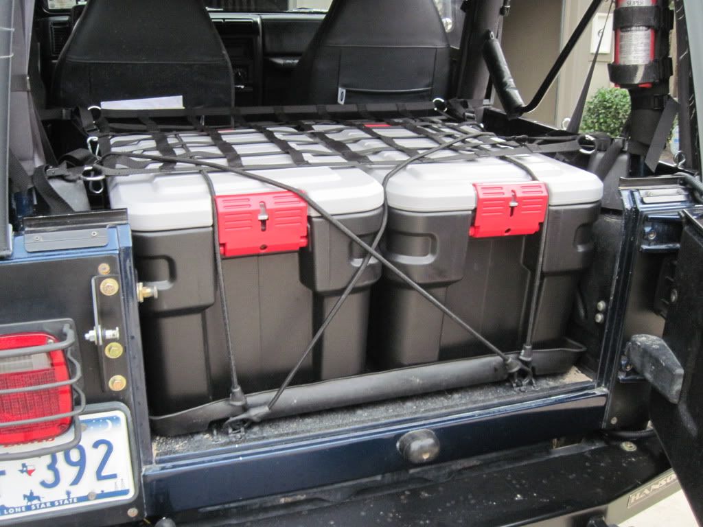

I added 2 24gallon action packers I got from lowes, they fit nicely in back for storing trail gear, couple tie downs would keep them sitting still as they fit perfectly snug to the sides, also leaving some room right in front, maybe for a folded seat, idk, I have my sub box and other things there.
I have my rear Raingler rear window net strapped to the rollbars horizontally like a deck cover. It keeps everything in in the even of a rollover, or really hard bump. I open both latches and slide the top off, theres enough stretch in the net to get things in and out.
You cant open them up or slide the whole box out with the rear window on, but thats fine. makes it harder to steal the whole boxs out.
