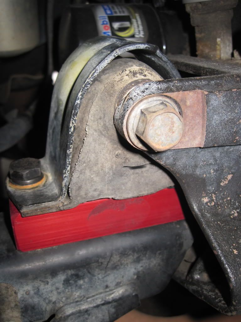

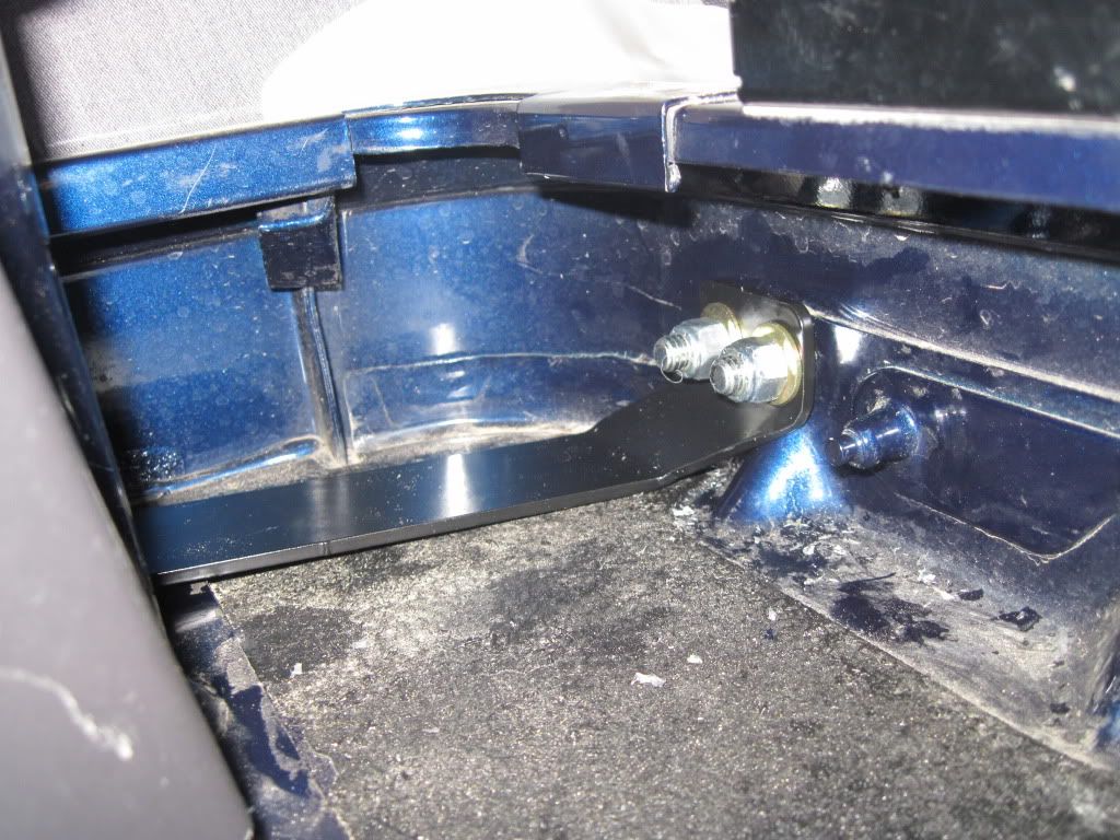

More scavenging took place over a few months and I found a mml and body lift on ebay
Budget Motor Mount $51.00 shipped, JKS TJ Body Lift $80 shipped
It was a real pain in the arse install. I may end up replacing the MML with a brown dog rubber if the bushing gets much older but it will do for now.
You can also see its always had Mobil 1 oil and filters its whole life.

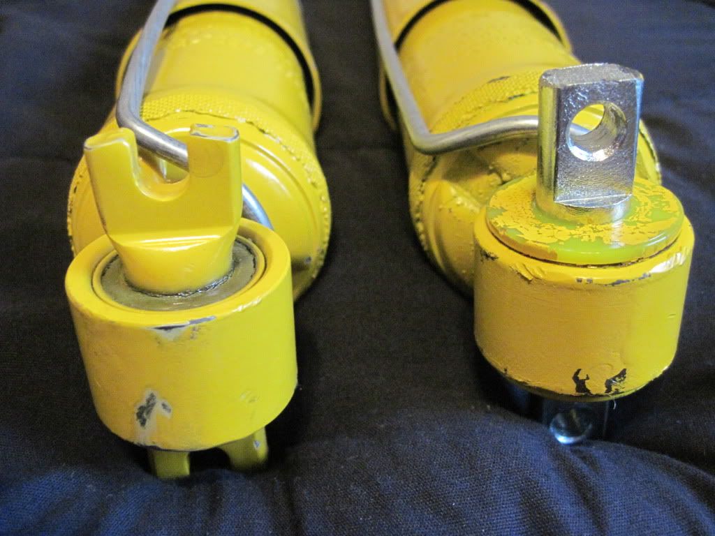

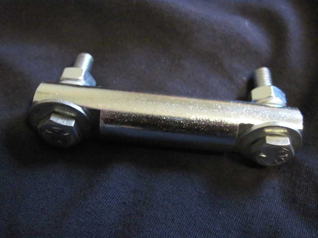

Then I found a set of front OME N67L for $39.99 shipped on Ebay!
But one was the older style and was missing a barpin, I picked up a heavy duty replacement pair from Warrior for $34.70 shipped.

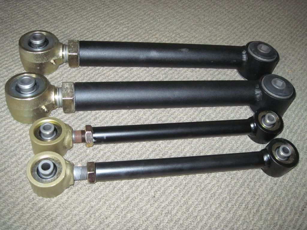

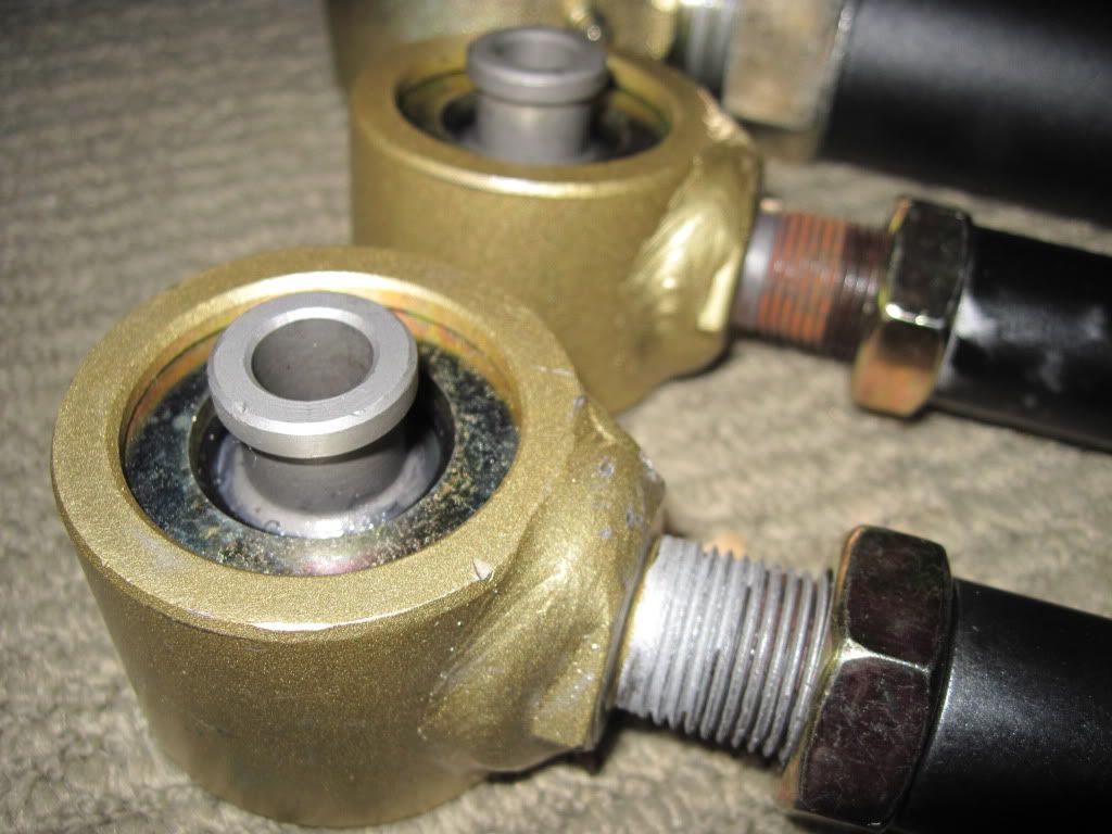

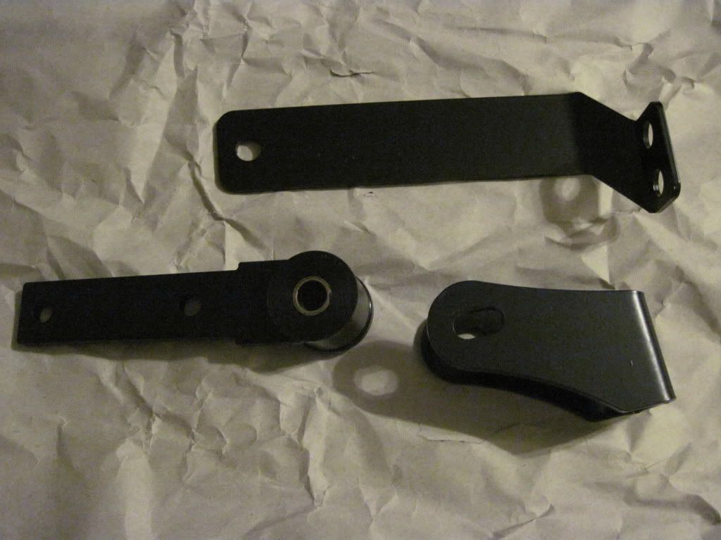

Then I continued to hunt and tracked down some currie rear uppers on ebay for $178 shipped.
Here they are next to my rear Rokmen lowers. The rokmens make them look tiny!
theyve got the older style welded Johhny joint
To finish up gathering parts for the final big install I picked up some JKS bumpstops from a vender on Jeepforum for $76.00 shipped.
I picked up Currie front upper control arms from 4x4groupbuy for
and OME N66 for $78.84 a piece and Currie front uppers for $229.95.
and of course full price for AEV 3" Coil springs which was like $320

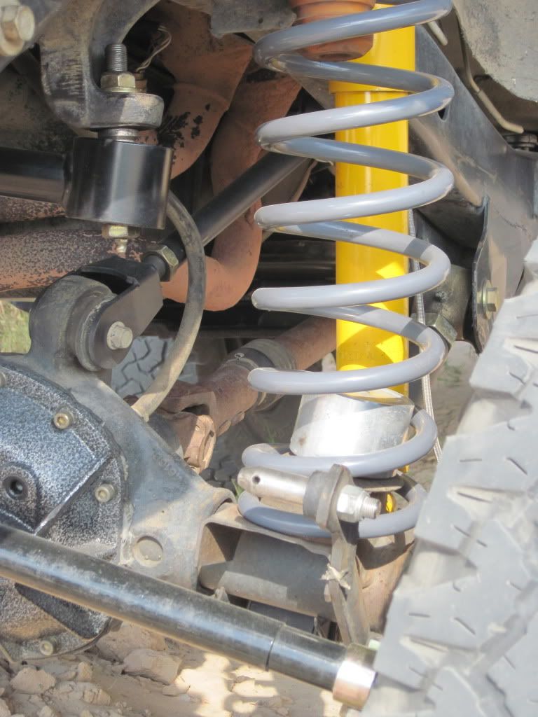

I went back and replaced the front lower control arms bolts for the rokmens with grade 8 hardware and washers, and bought some for the rear.

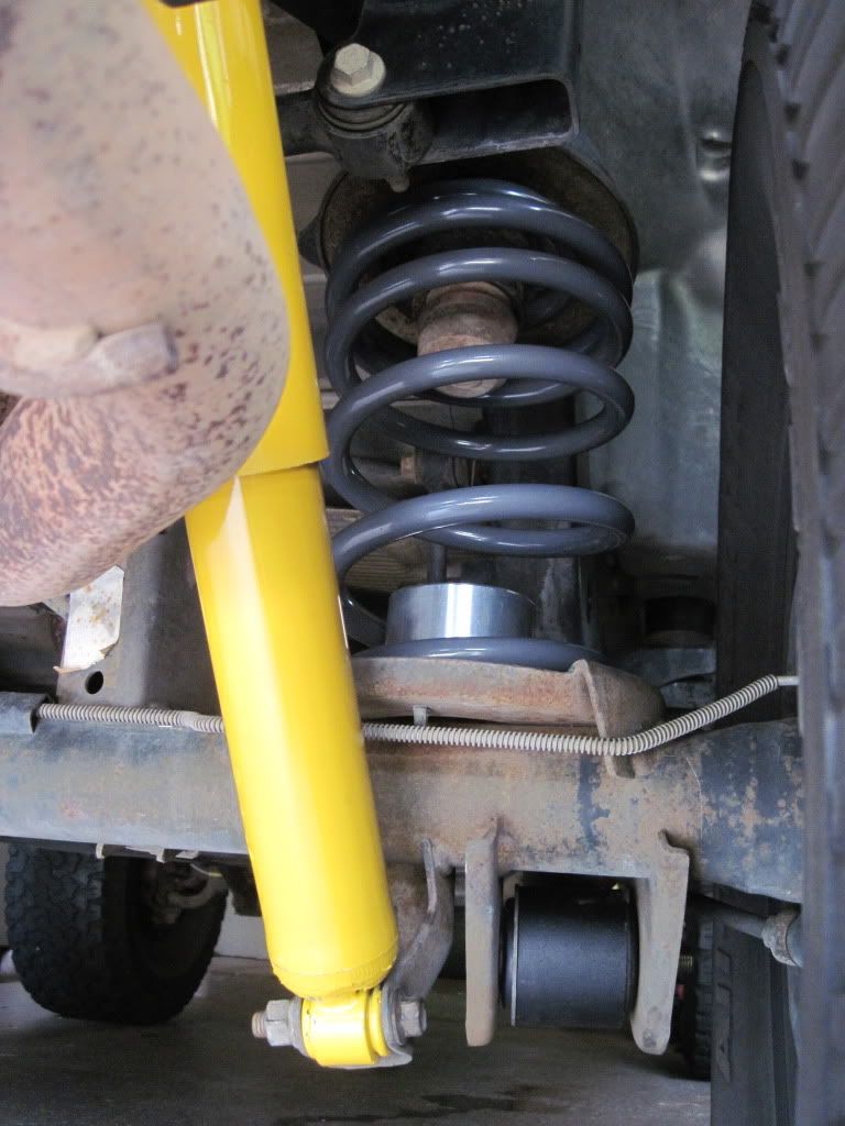

Then It was time to install the shocks, coils, bumpstops, front rear lowers, and front and rear uppers.
I was real busy during school unfortunately and really wanted to get everything installed so I let Texas Truck Works handle it.
I left the .75 spacer on in front, and the tcase drop untill I was sure of my angles.
Ultimately, they tapped one bumpstop hole sort of crooked, my drivers rear bumpstop fell apart, not their fault, some jam nuts were left untight or came loose on the way home, and some of the jjs were crooked in the mounts, probably from the jam nuts being loose, and they installed the front uppers at 15" when I said to do 14.5", but they said they put it on the alignment machine.
And I had a problem with the front drivers side bumpstop cup rubbing the springs at ride height and small bumps, which Im not sure why. I went back the next day and had them straighten up the joints and tighten the jam nuts, and we pulled the bump cup and drilled a hole and just shifted it over.
So at this time
The Bumpstops were at 2" front, and 1.25" rear.
Front lower CA 16". Rear lowers 15.75". Front uppers 15.2". (i forgot what my rear uppers are let me check in the morning)
The springs actually gave me 3" lift in front so 3.75" with spacer, and just the springs gave 4" in the rear.
The shocks seemed pretty short in rear, but I was anticipating sagging from a rear tire carrier and opted for more uptravel so I figured Id just figure that out later.
I had some problems shifting into 4low with the JKS body lift, mml, and the jks tcase bracket that came with it. So I got a skyjacker bracket to fix it $70, and it works pretty well.
I also later removed my 1" tcase drop and used 3 grade 8 large 1/2" washers all around and maintained my pinion angle within 1 degree off from parallel and didnt notice vibs.

Looking good. Your bump stop cups were hitting because the axle is a little too far back. 16" is a bit short for lowers @ 4+" of lift. I'm only about 2.5" over stock and have my lowers @ 16.25". You might try pushing the axle just a tad out and making sure it's centered as well. How are you liking the change from rubber bushings to JJ's?

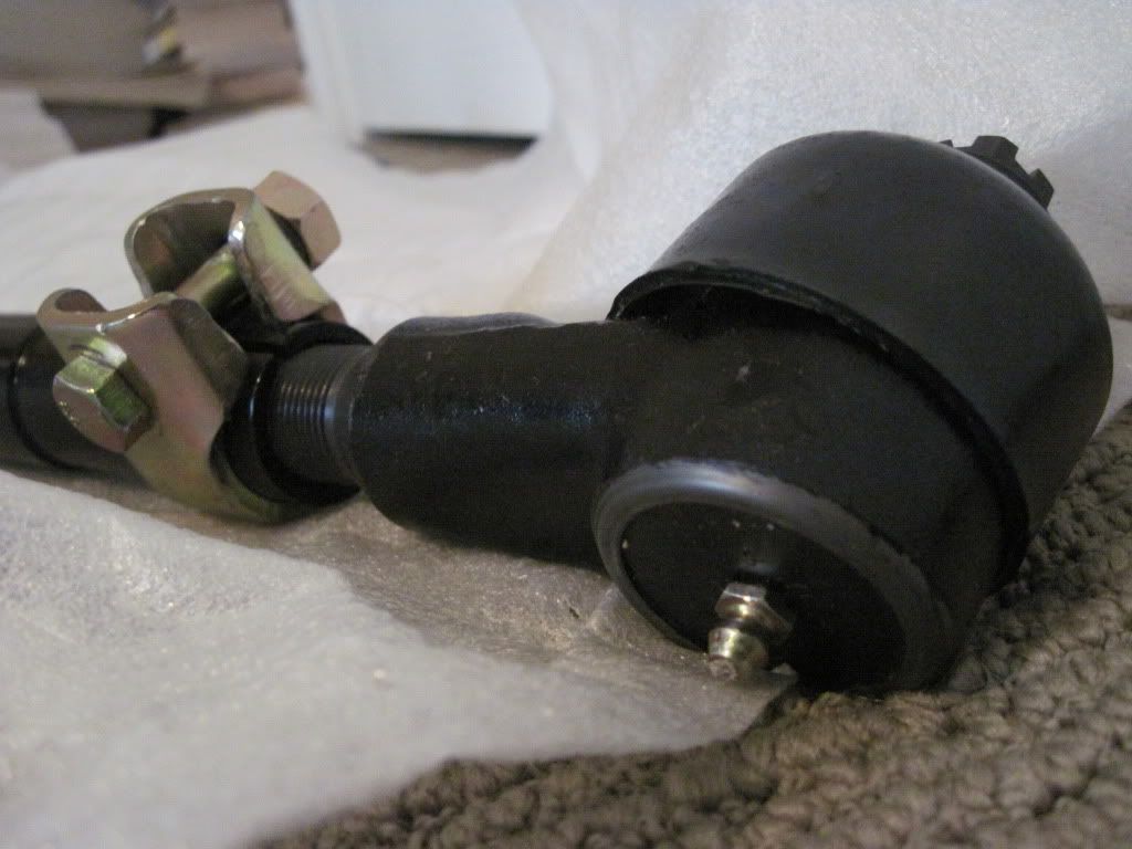

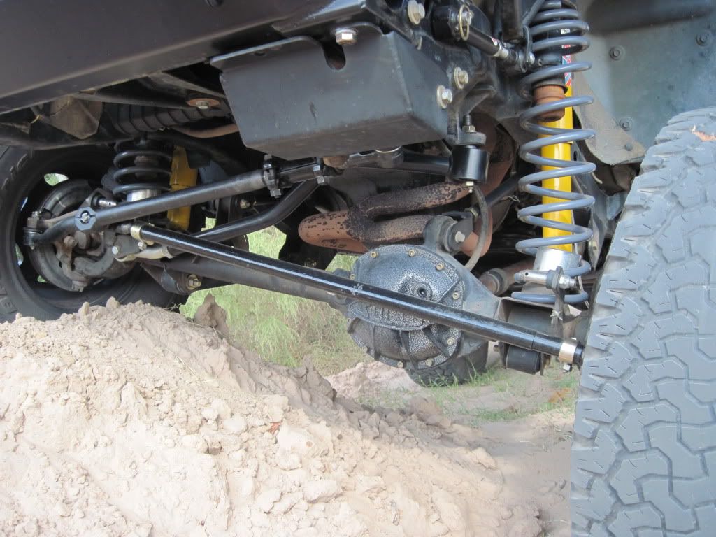

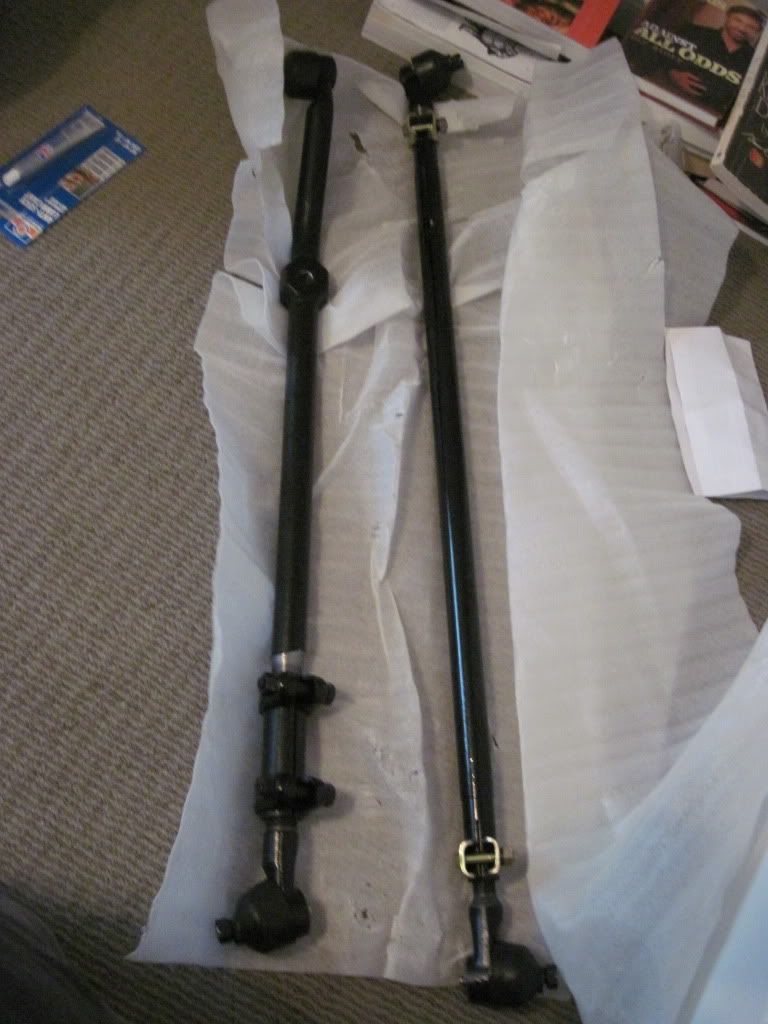

The next great ebay finds were a Rokmen steering skid for $32.51 which was an easy install. Note there is a gap between the bumper and skid on the far left side, but with some washers and a self tapping screw It should be no problem, this thing is rock solid without it, and does make good contact on the right side.
and Currie steering for $305.41 shipped.
I installed it in a walmart parking lot at 10pm and it took me about 2 hours.
I edited original post front is at 3.75" with the springs and spacer, not just springs, so exactly 3" from springs with the 75 pound bumper.
My caster is at 5.0 on both sides the way it is now. Im getting some wandering to the right, Im thinking from low caster and no road crown compensation, so I was going to shorten my uppers. So it seems that id better benefit from lengthening my lowers and that would help with the caster. The only thing is, my jks track bar clears the solid diff cover, and I dont want to start hitting it hard.
My thrust angle is at +.02 so theyre pretty square wouldnt you say?
And the switch from POLY procrap to JJs and Rubber is definetely better. It flexs great and less vibration. I do like my rubber on my Rokmen lowers because theyre at the bottom which see alot of dirt, clay, water, and mud in Texas trails, which tends to clog my JJs up and get sqeaks until I clean them out.

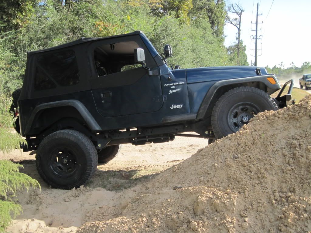

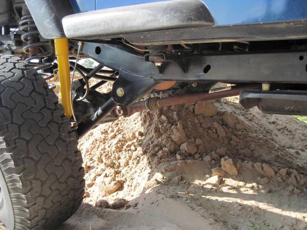

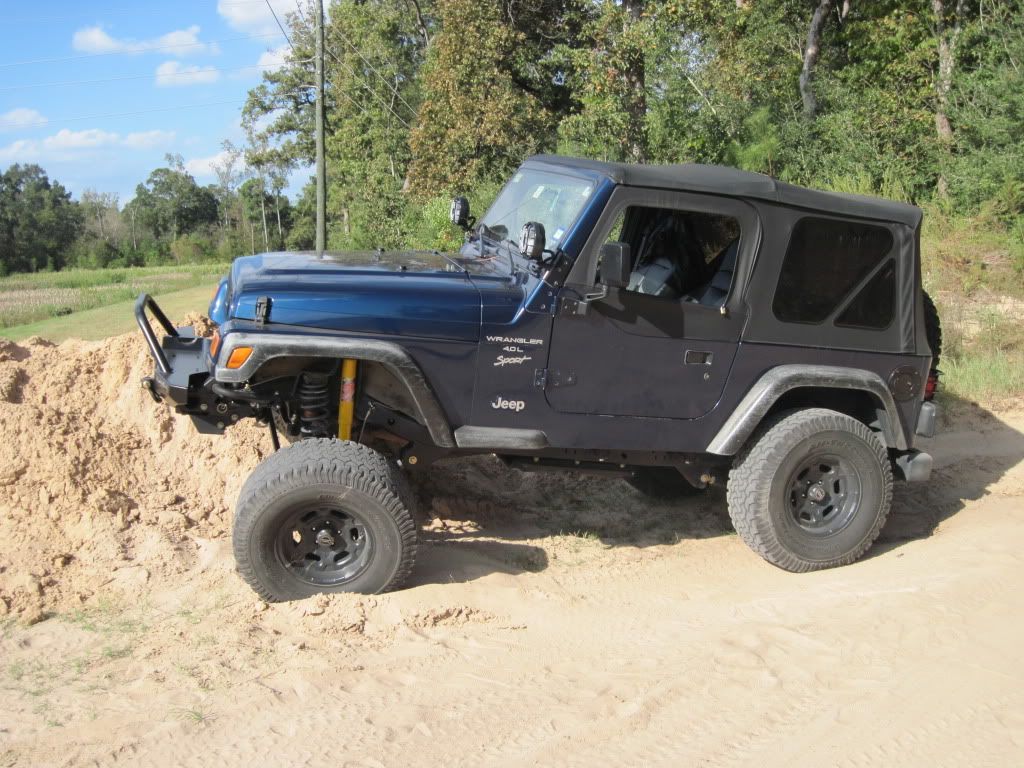

After installing the steering i found a little dirt pile near the park and quickly tested out how it flexed. I made it up and over the little dirt pile in 4hi even with those bald all terrains which were fixing to go!
Need to find bigger places to test I think I still had alot more room to go into the wheelwells and none of my bumpstops were near touching.

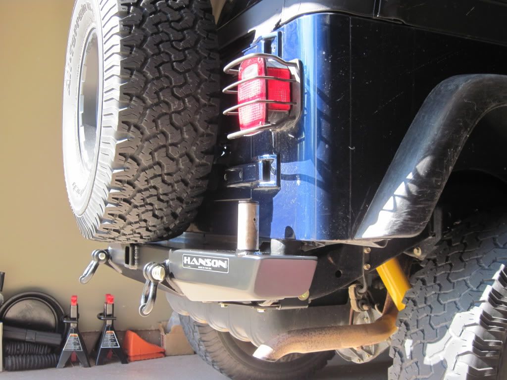

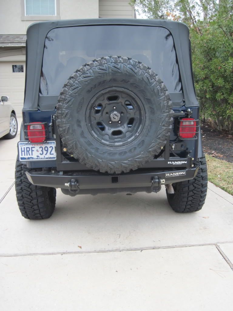

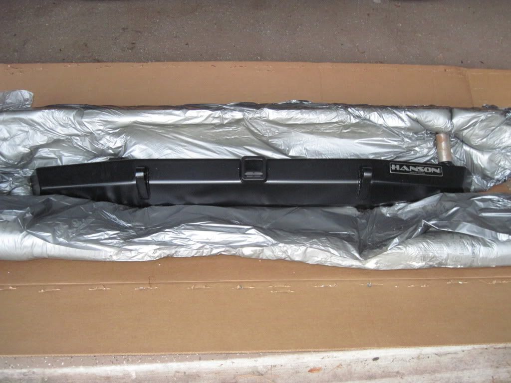

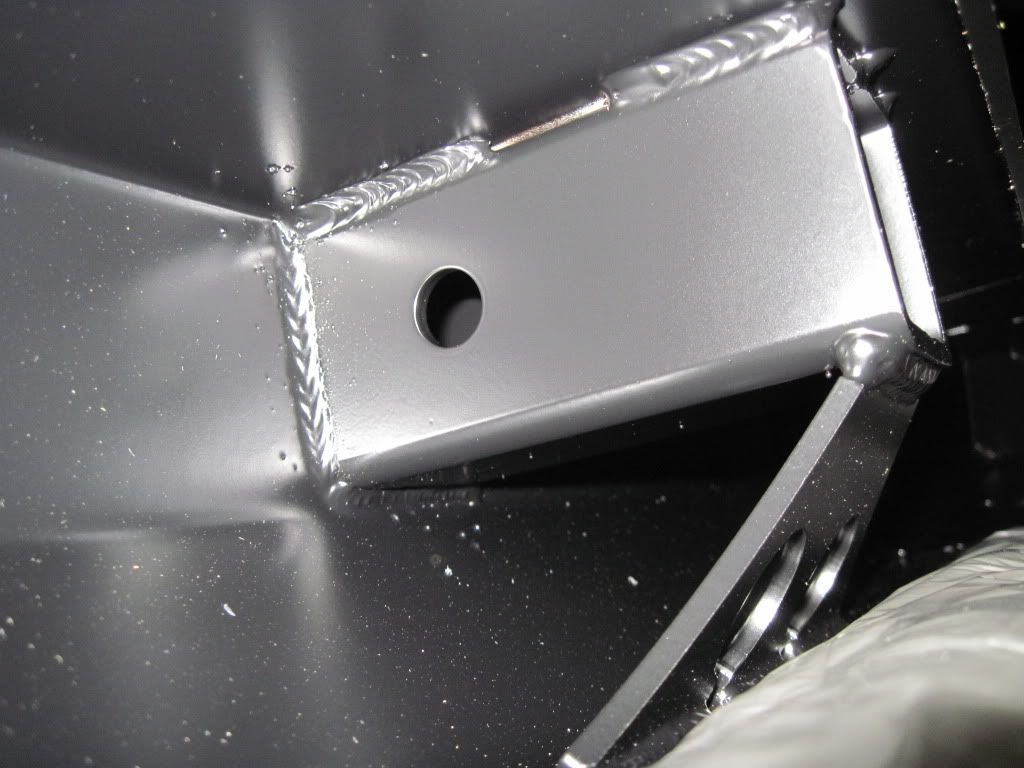

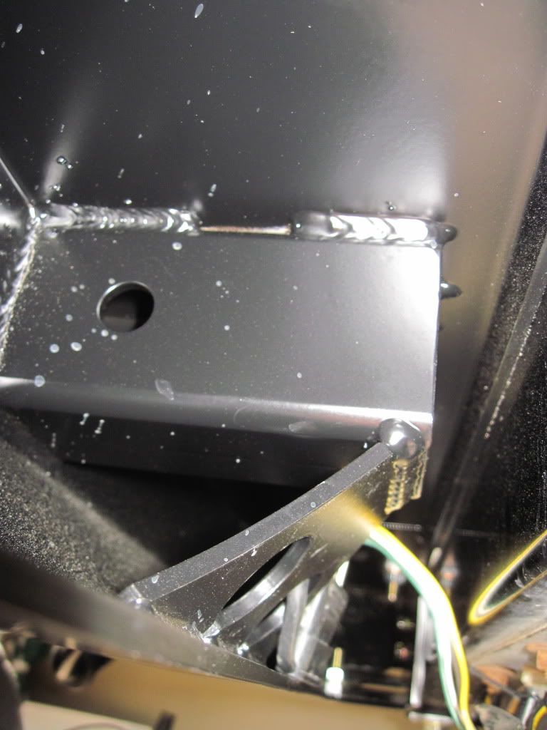

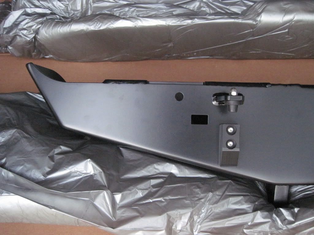

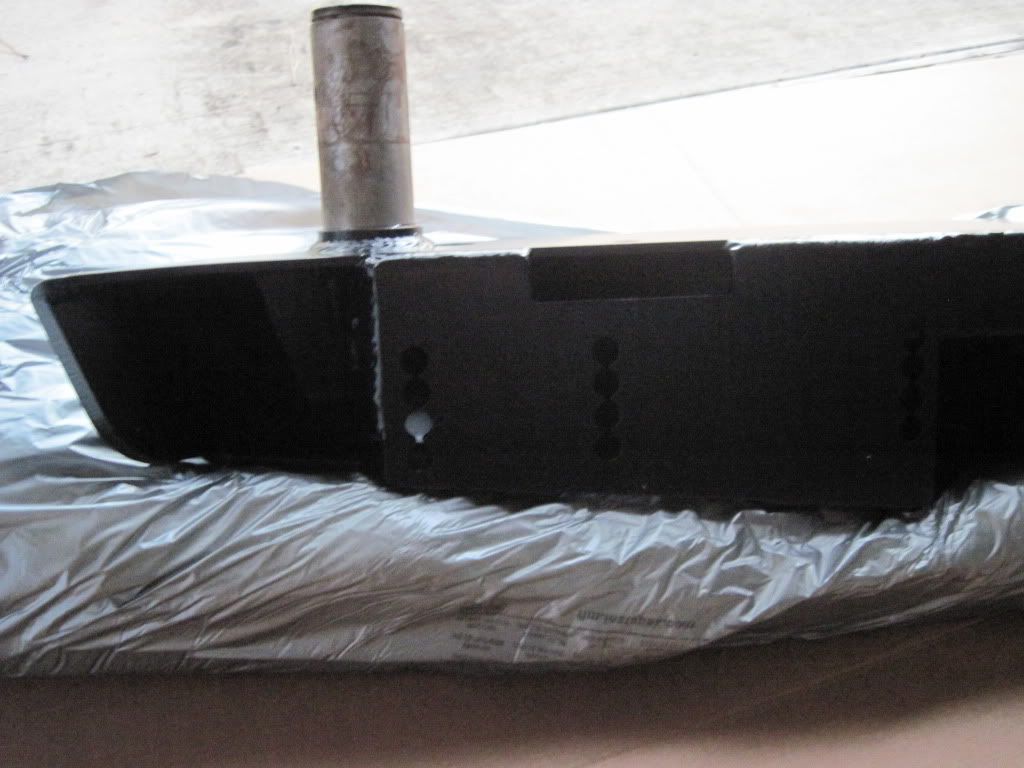

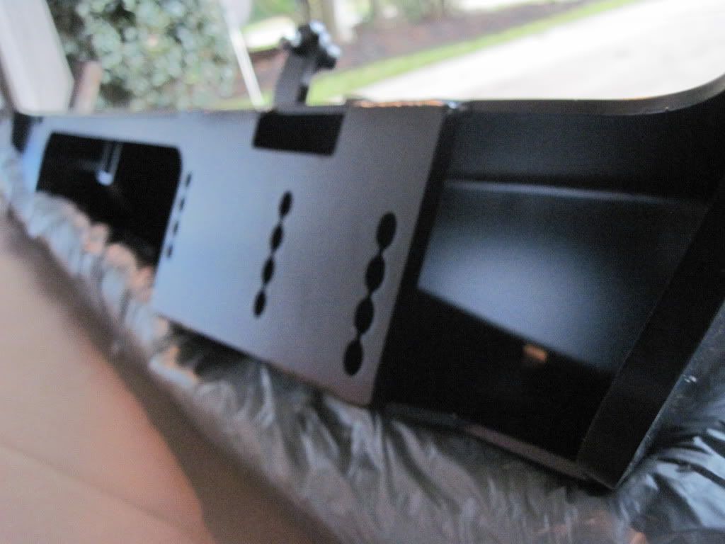

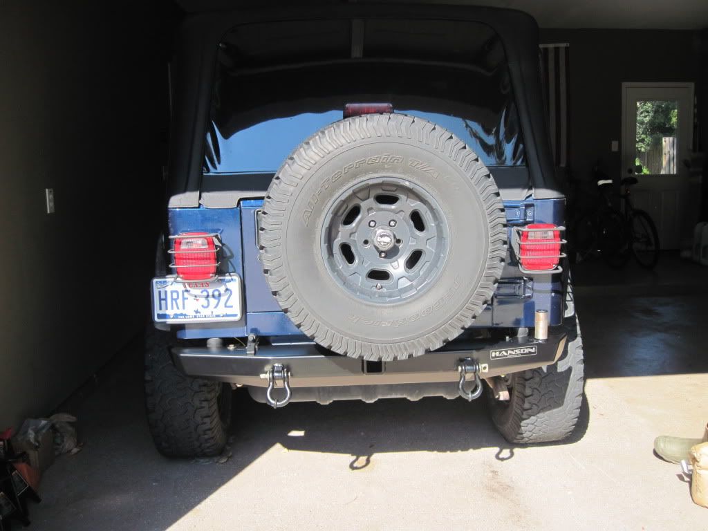

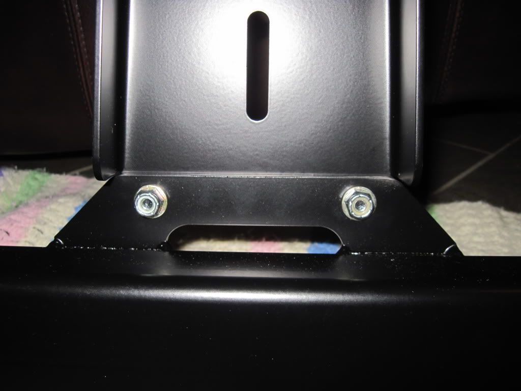

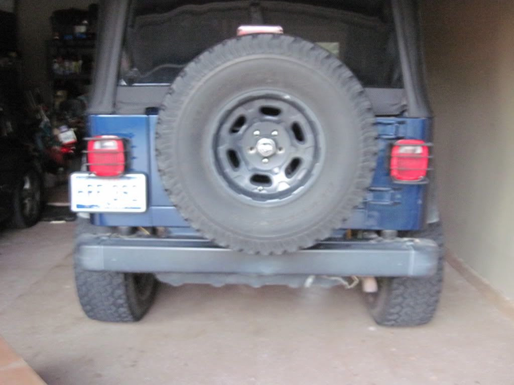

After that it was my 21st birthday and my parents got me the Hanson Rear bumper id been wanting to match my front. Pictures dont do this thing justice.

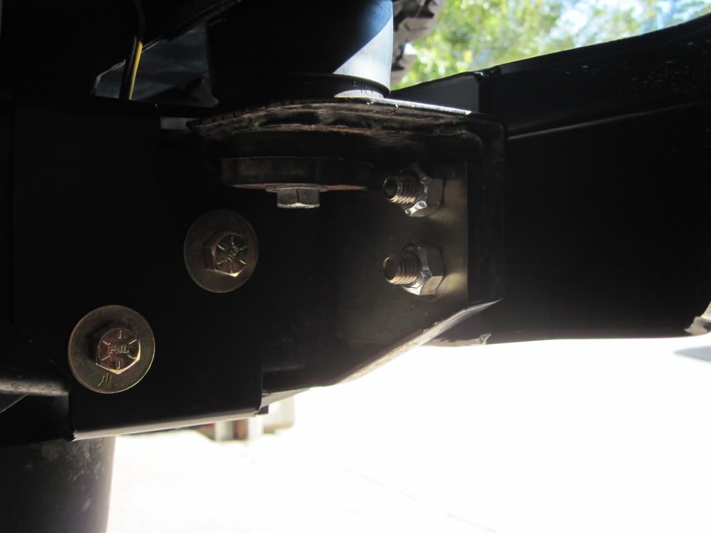

Basicly this bumper contains all the same aesthetics of the front with the nice 45 degree angles and black semi gloss powdercoating, and name plate on the right side. At 60" wide, this bumper consists of 3/16” cold rolled steel, 3/8” end plates, frenched-in 2” receiver hitch, 1” clevis tabs and 1 7/8” machined spindle, and hidden tow chain safety hooks, and frame tie-ins. The spindle is inserted and welded in with reinforcements. Like the front bumper, the top portion is actually raised, and would come almost flush with the body without a body lift, or hides the appearance of a body lift.
its worth mentioning that I love the way Hanson ships their bumpers in heavy double wall cardboard, industrial stapled every inch on every panel, and the interior is stuffed with plastic bags filled with expanding foam for a perfect cusioned fit.

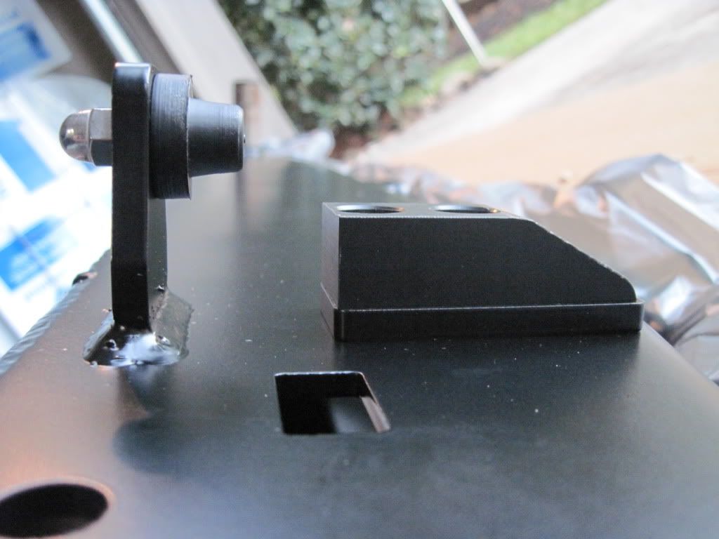

This nice little polyurethane ramp, which guides the tire carrier into position against the rubber snubber, is a very nice feature.
The bracket actually supports the top and bottom
Hanson ships with grade 5 hardware, and its sounds like its just a legal protection thing so they'll brake first and not your frame, of course I upgraded mine to grade 8 anyways.

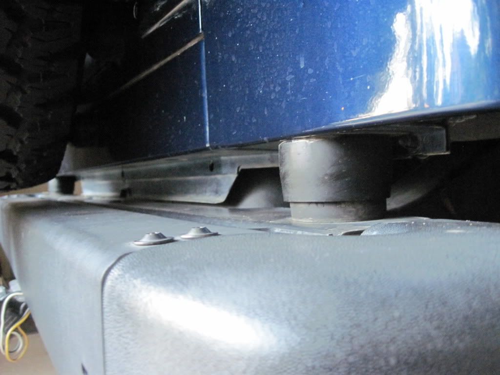

Look at how It covers the stock body mounts.
with 33x12.5" on stock carrier it sits right on the bumper with a pretty tight fit.

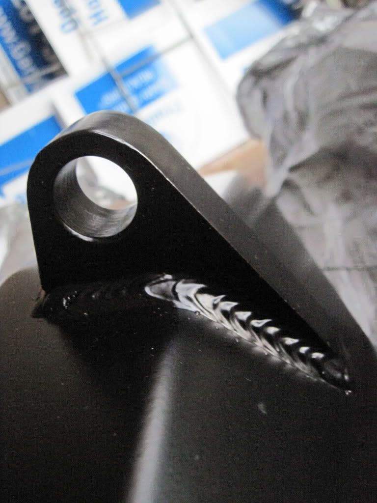

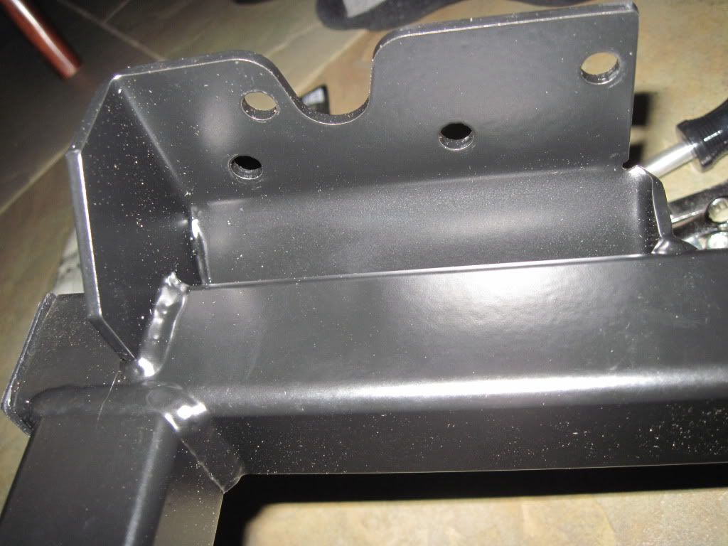

it wraps around following the tub corner to slightly protect them
theyre frame tie-ins seem fairly sturdy
See how the spindle is gusseted down the middle and sort of boxed in.
notice the hitch pin and safety chain spots are hidden inside the bumper
it is alot wider on top than stock, but it makes a great surface to stand or climb on or set things on while the tailgate is open.

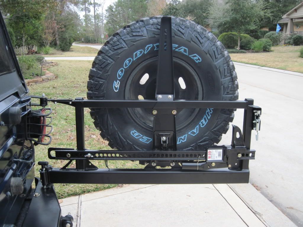

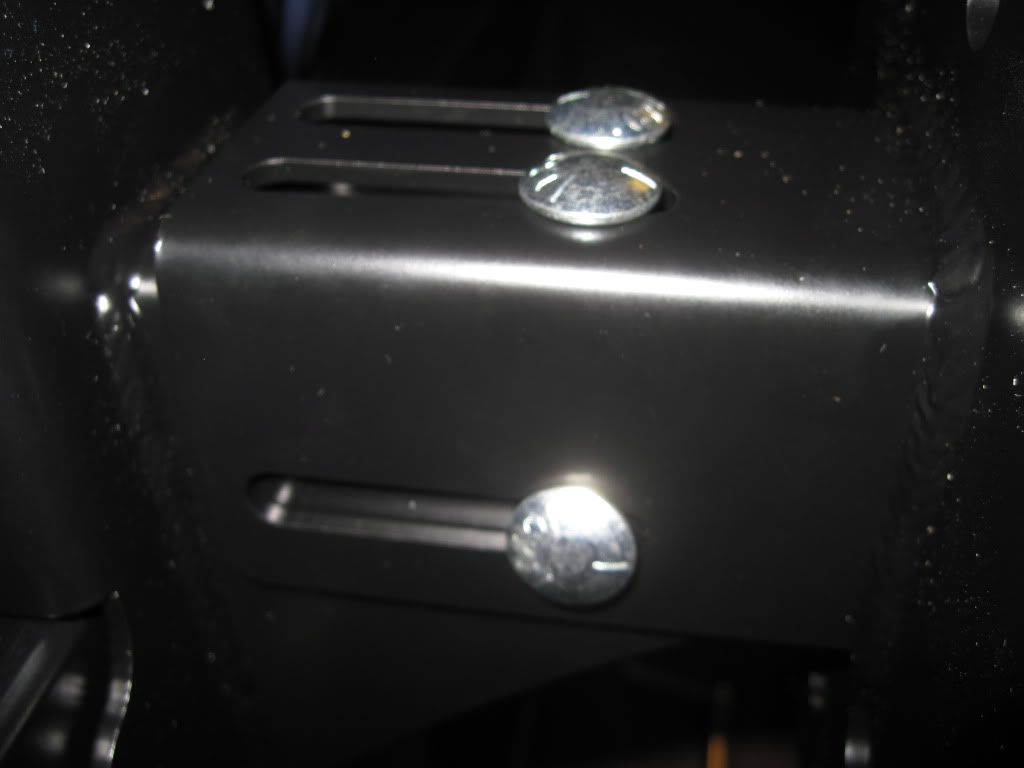

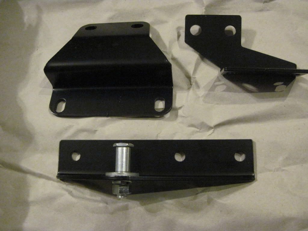

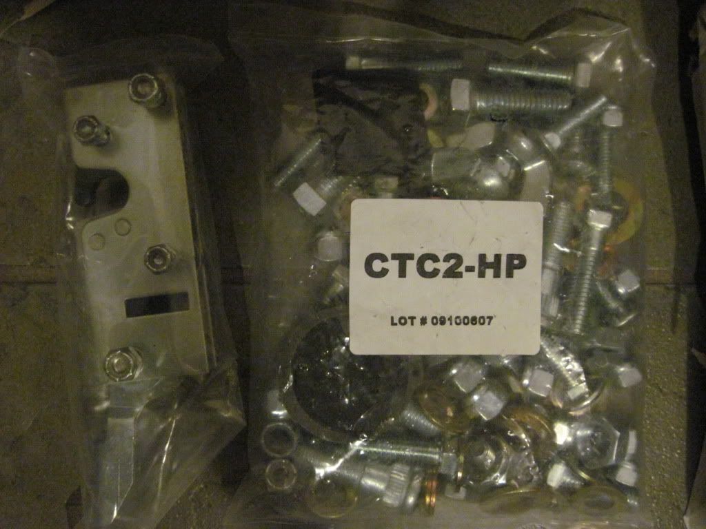

But that wasnt all I got. I had another box.
It was the hanson tire carrier to go with the bumper.
Yay a big bag of hardware to sort out. Note: Hanson ships out grade 5 bolts, grade 8 washers, and grade 5 nylock washers, I upgraded everything to grade 8 eventually to be consistant.

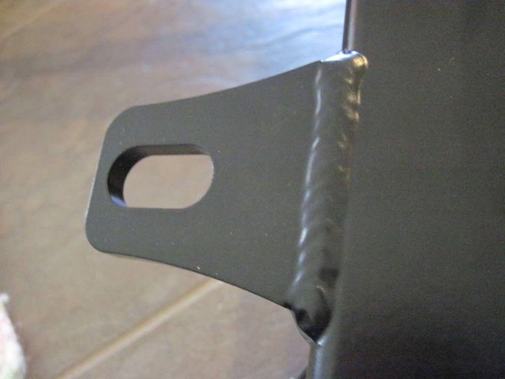

tub mounted upper support hindge, and rear brace which attaches to rollbar

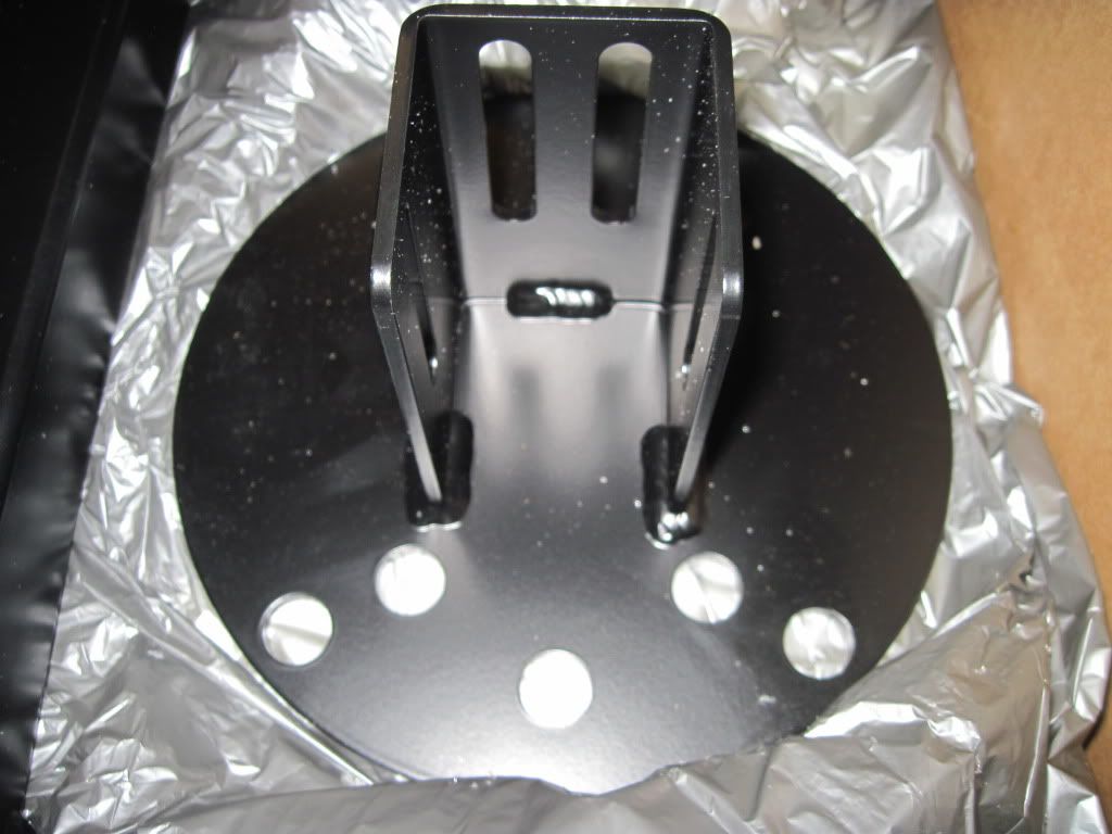

this is the upper vertical post bracket, the tub mounted locking pin which is adjustable an inch, and its support bracket.
assemble to bearclaw locking mechanism to the frame

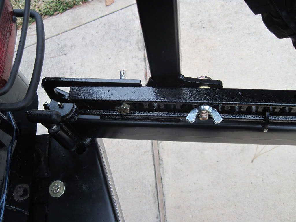

Locate Hi lift tabs on both sides

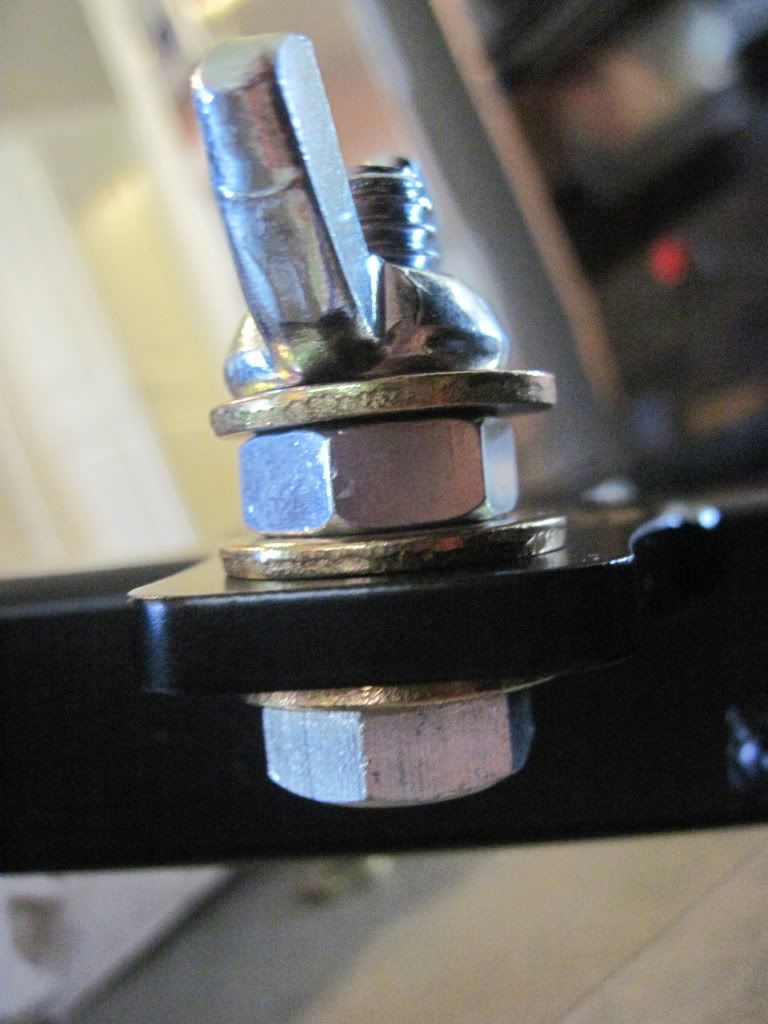

Next assemble the hilift mount with 1/2" bolts nuts and wing nuts as shown.
Next step is to attatch the vertical post to the square frame at the bottom with (2) 5/16" nuts bolts and washers
next use the bracket to secure the top portion of the vertical post with 4 5/16" nuts bolts and washers
the top of the vertical post has a 1/2" diameter hole for mounting a CB antenna, it also has room left over to drill in a 3rd brake light should you wish.
heres what it looks like sofar
this is basicly the spare tire support
and its adjstable hub
which uses 4 5/16 carriage bolts.

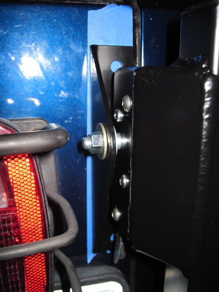

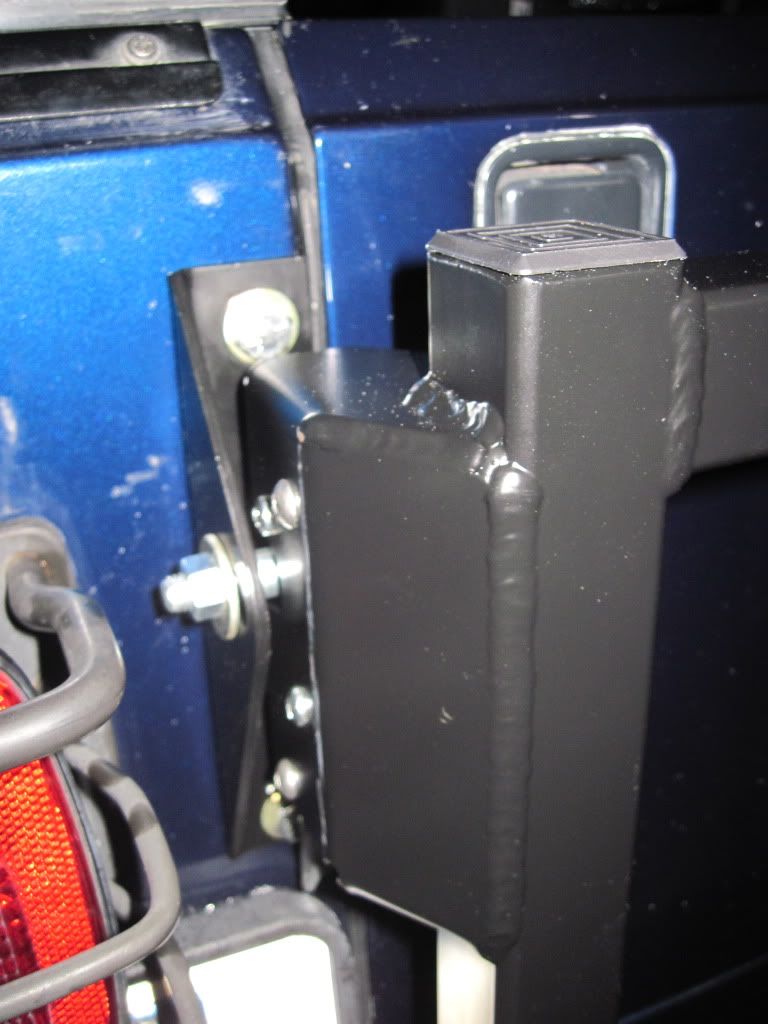

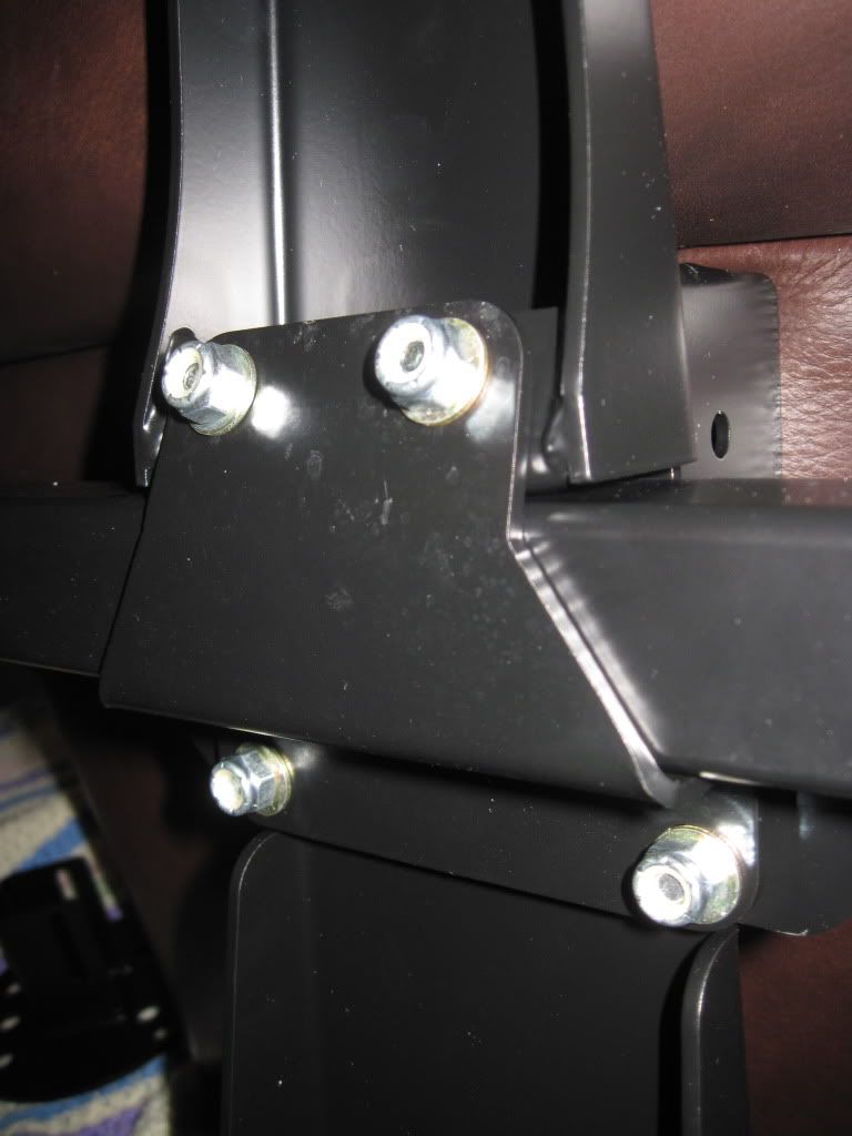

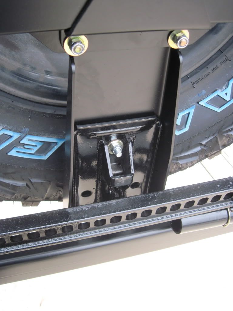

Assemble the upper hindge with the 3/8 bolts, if you have a body lift, install it ontop as shown here, if not, install it under the tire carrier frame. I maybe should have flipped the whole thing over since its offset, but it really depends on if youve got corner guards with bolts in that area which will be best for you.
slip the tire carrier onto the spindle, be carful not to take out the paint like I did

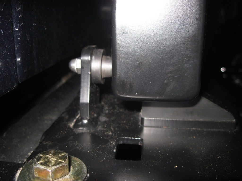

put down tape so that pin does smack into the paint when you first put it on, the just remove it and put some grease under the pin and it wont scratch the paint during operation
make sure to adjust the latch pin so youve got some preload on the rubber snubber
push firmly closed and mark your spots for drilling
start with a pilot bit and work up to a 9/16" bit
attach rollbar tie in bracket

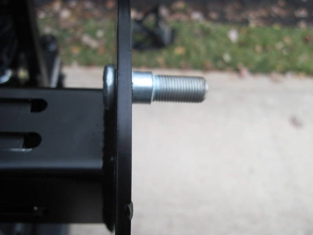

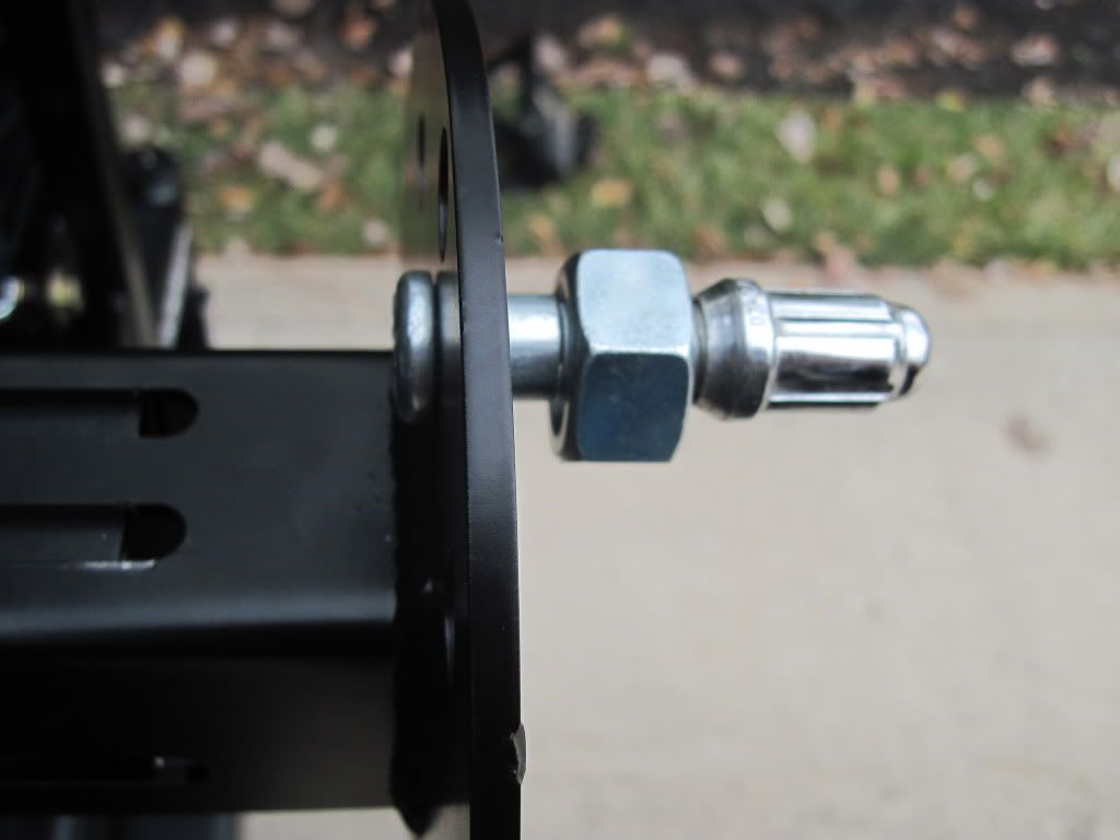

Put a big 7/8" nut between the lug, and lugnut and tighten with a wrench and it will pull the lug into place.

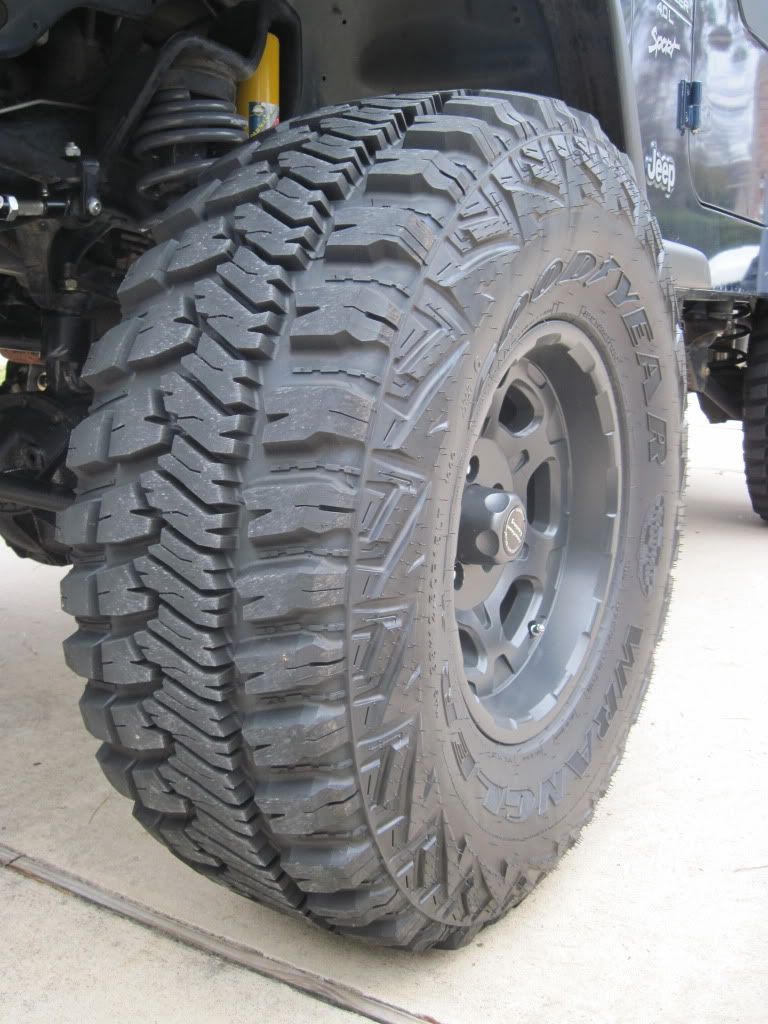

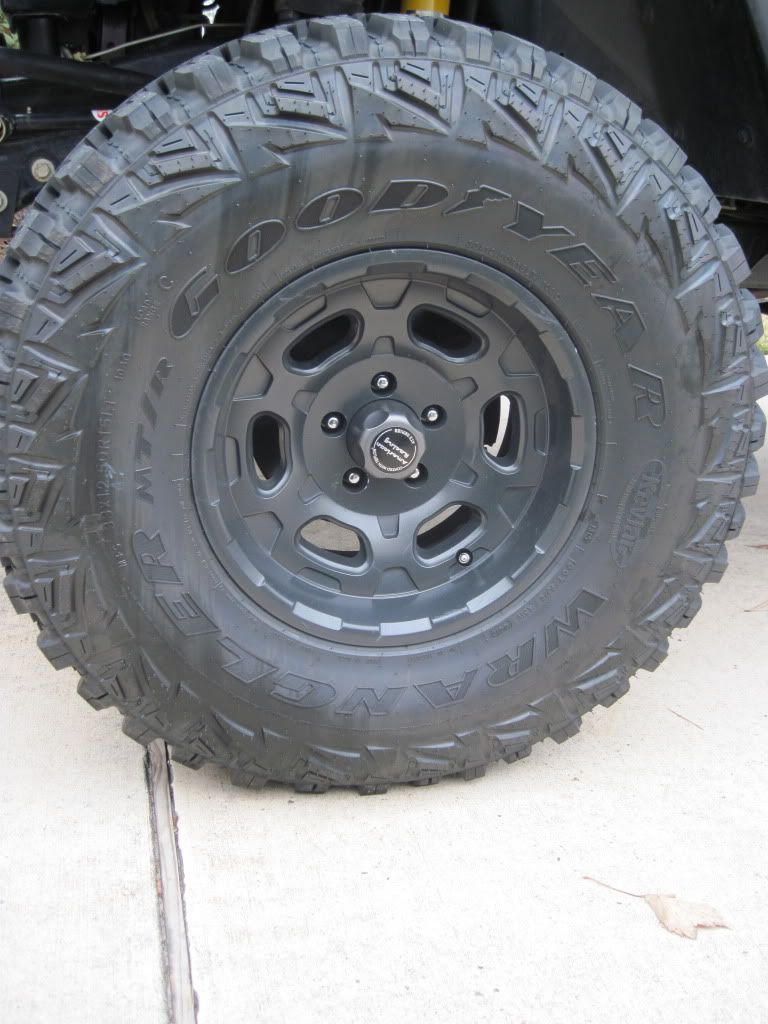

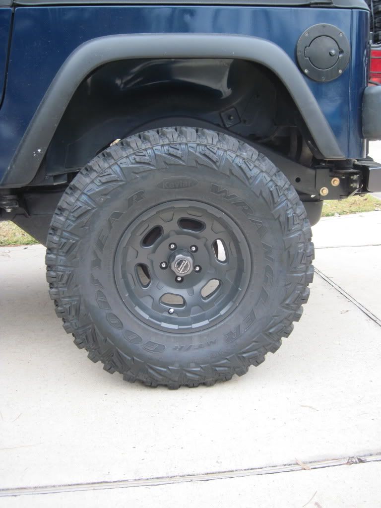

You may have missed it in the last pic. But by now it was christmas and time for my other gifts TIRES!
I got 5 33x12.5x15 Goodyear MT/Rs with Kevlar. I mounted them blackwall out because it looks better.
I also got a 42" black hilift from my girlfriend which I put on my tire carrier. It was kinda a fight to get everything aligned well so it would close and fit on and off, and not hit the hindge but it works fine now that I found the sweet spot.

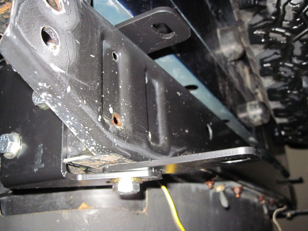

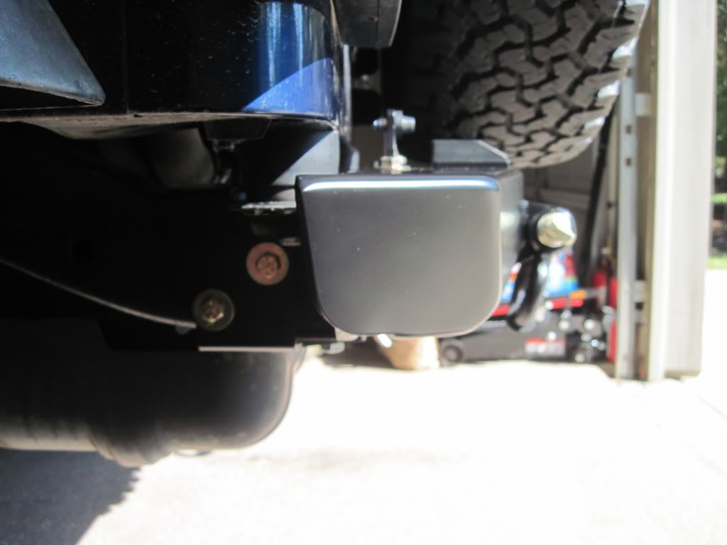

Actually another christmas present from my mom was some ROKMEN corner guards. A uhaul actually pulled up in front of our house as my mom and I were leaving, and it looked kinda shady so we went around the corner and came back to see what was up. Well they were delivering the corner guards. My mom was mad that they shipped boxless and I saw my present early.
First step was to strip the rear ends
Man I wish I had a ratcheting combo wrench for the flares, I couldnt get a socket in, and the stupid plastic backing things should have been really a nut.
then I lined them up and held them on with some borrowed clips
and rechecked with the flares inserted and made adjustments as needed
things lined up perfect

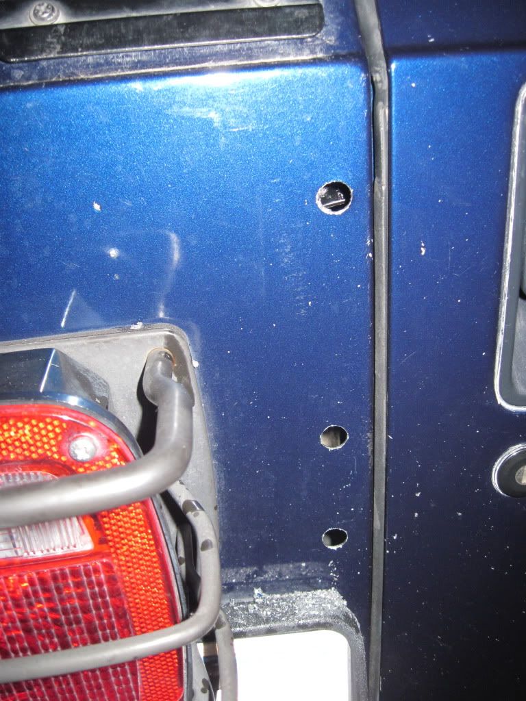

the other side was stripped of its hindges. First useful thing about a hilift jack, its handle makes an awesome cheater bar. To my surprise I had no stripped bolts, no broken sockets, no fuss.
then it was time to start drilling into the tub.
Is it me or does this pic look like an eyeball?
and bolt them on using the flush stainless hardware
and reattach the flares
then I went to work on the passenger side
then I had to address the tire carrier's upper hindge. I tried to flip the bushings and the bracket, and while It would have worked using the rokmen hardware and only had to drill 1 more hole next to it, it would have put the bracket to high for the bushing so it would be at downward angle which would allow more sagging once it was swung open.
So I kept it how I had it and just drilled the two holes I had before through the rokmen corners. And I havent had any problems since.
After both sides were done, I cleaned with denerated alcohol
I did 2 coats of self etch primer, sanded with 1,000 grit between each, then 2 coats of Rustoleum satin black and sanded with 1,000 to 2,000 grit between each coat.

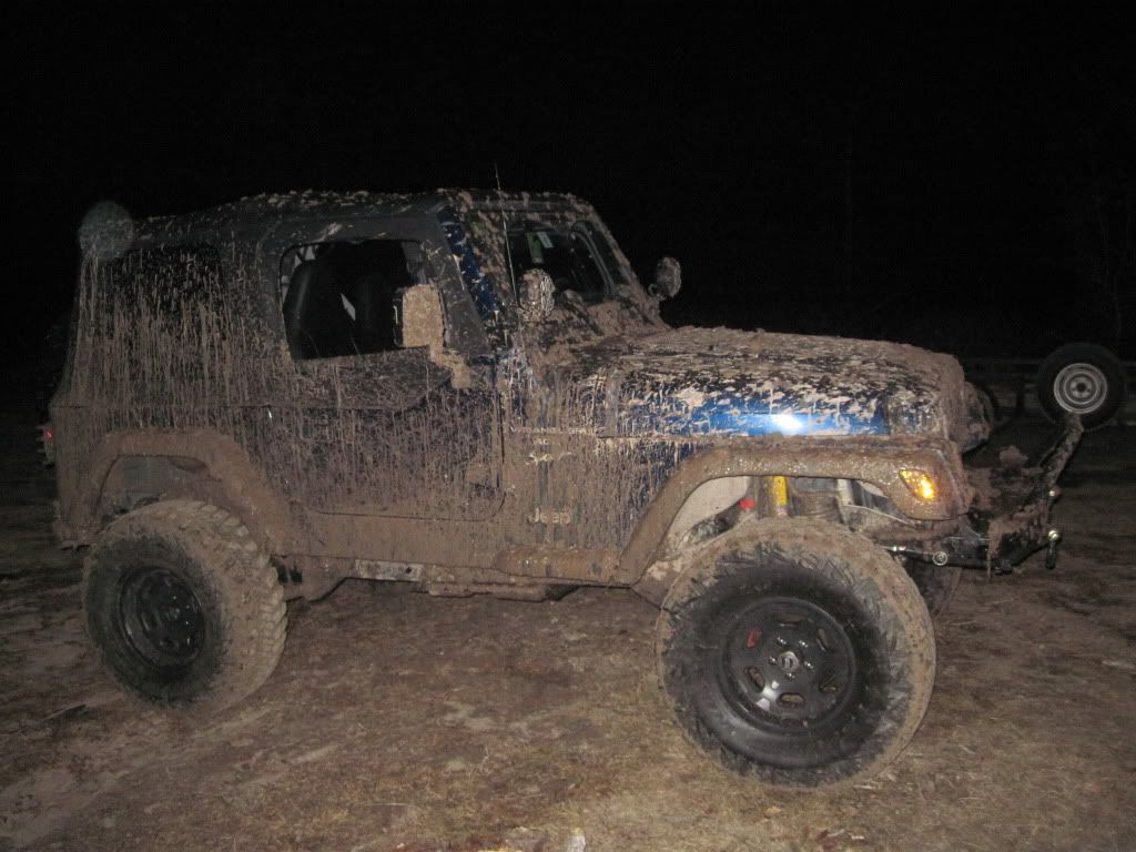

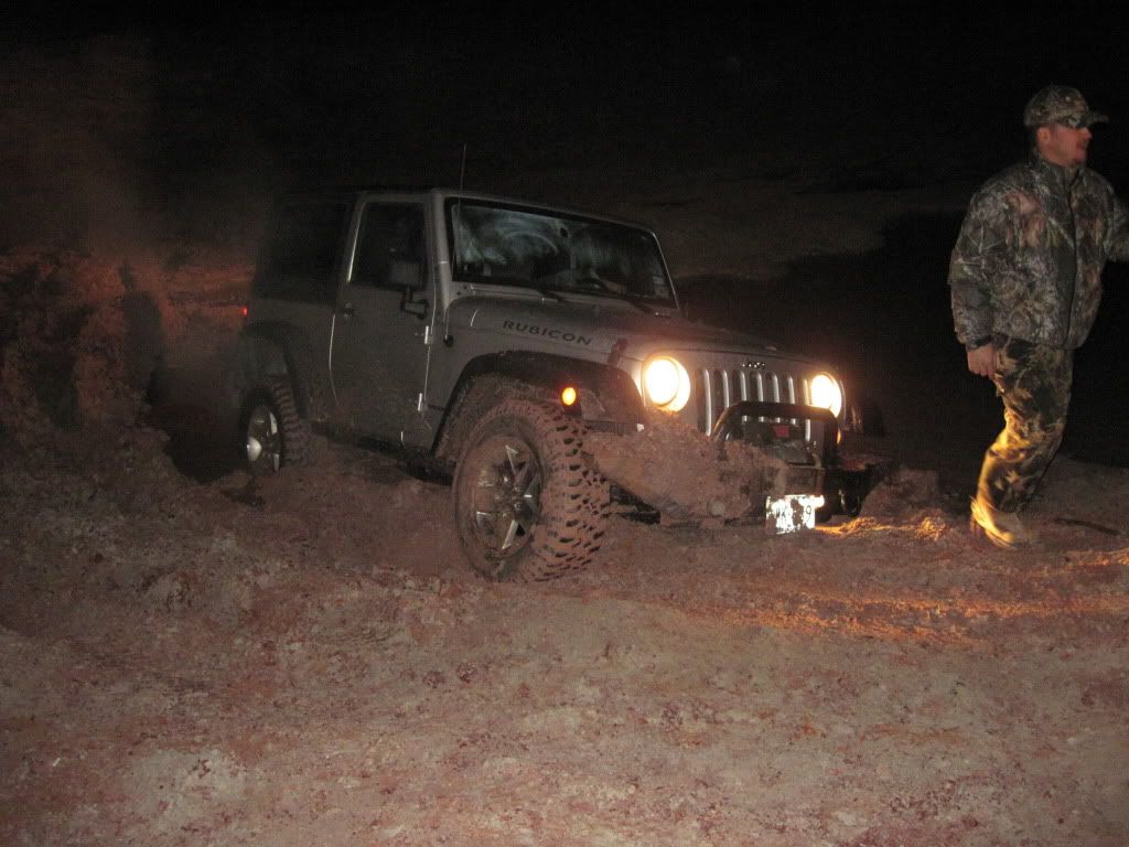

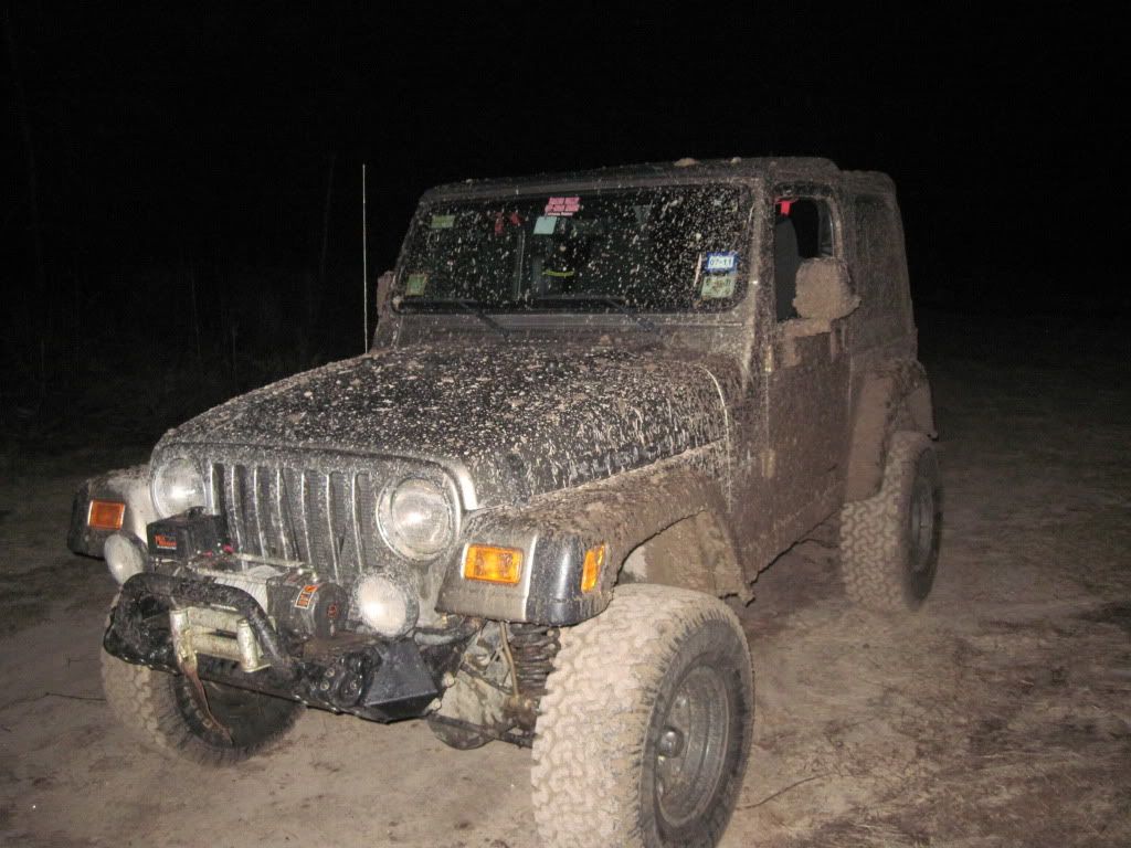

Then I took it out on a friends private land for a spotlight hog hunt.
I got really muddy with Josh's 04' Rubicon, Travis's 09' Rubicon , and Clayton's '87 Ford, take a look at how deep the mud was compared to his rear 36" tire.
