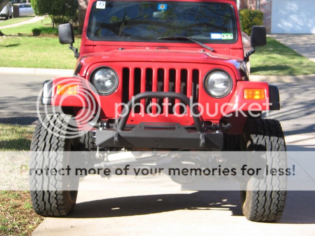

I installed the bumper today. I also took the cheap pocket flares off and put the factory flares back on after painting them with Fusion satin black.

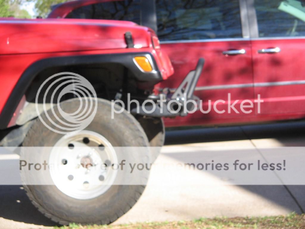

Well I made a stupid mistake. The Smittybilt winch I bought hit the gusset on the left side. So off came the gussets, I still need to grind the left over welds down and recoat. I may redo the gussets someday, but for now I'm not. It only cost me $20 to have it welded up, I have made worst mistakes before.

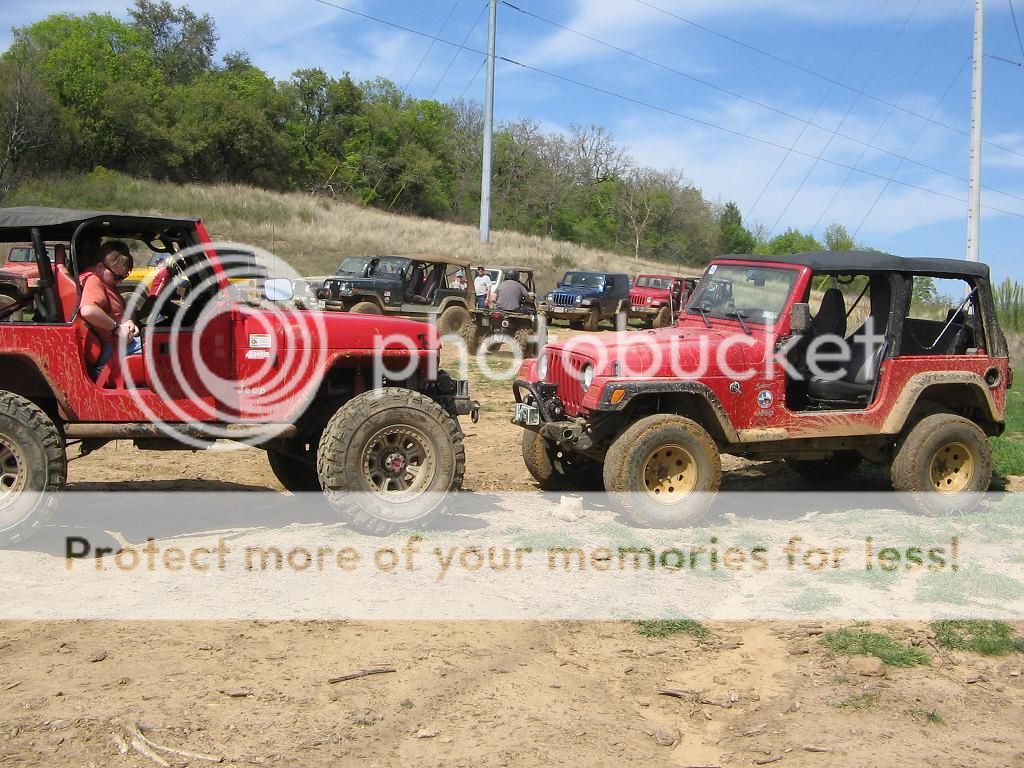

Pictures from wheelin today.
Me
Brian- EZAces on here
Our jeeps, damn mine is small

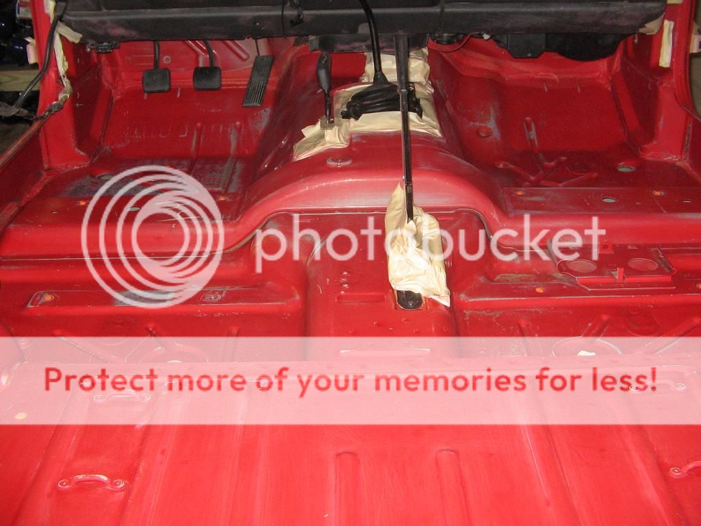

I'm going to line the tub with Monstaliner, Lady in Red. I have everything out but the drivers seat and took it to the carwash to clean it up some. I need to get a electric sander to dull the paint, then epoxy primer the bare metal.

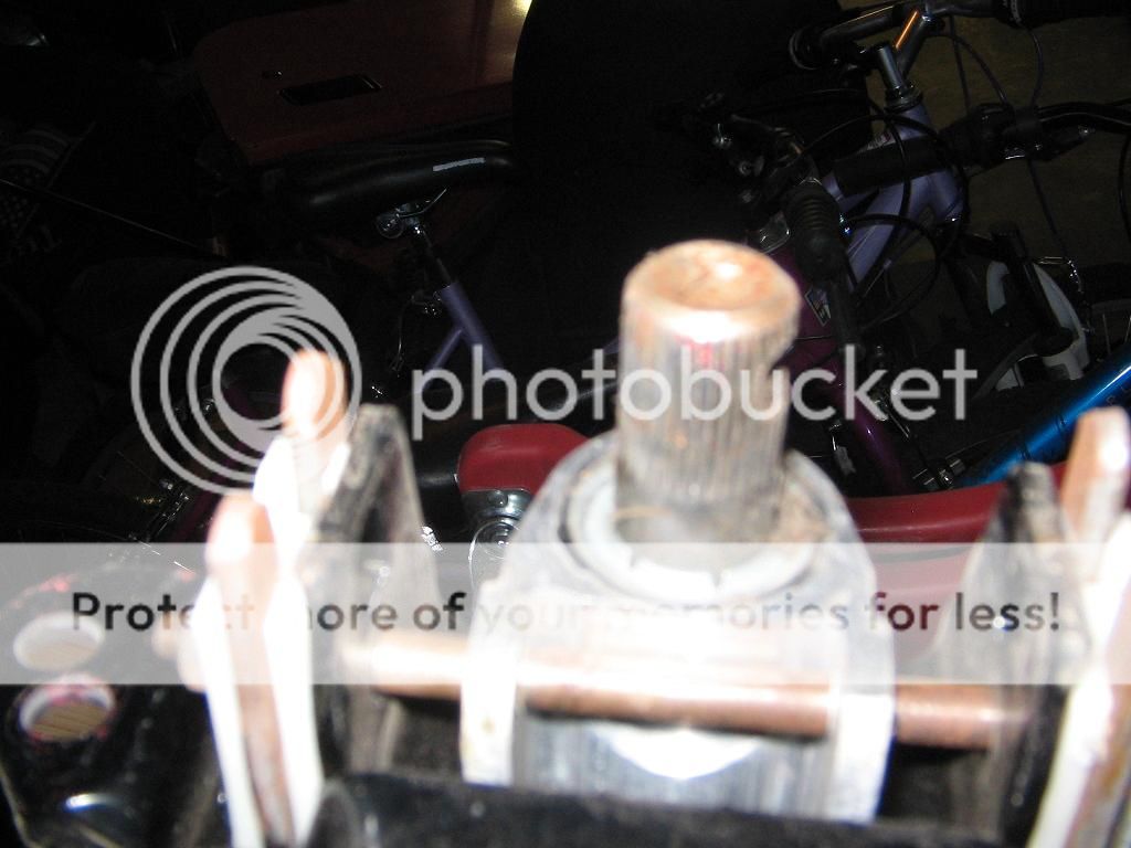

Got it ready to roll Monstaliner and also pulled the steering column to swap the 2001 tilt in. I'm going to have to take the tilt mechanism off the 2001 and put it on mine, also will have to put the 01 cruise control buttons on my steering wheel. The ignition switch is different, as is the shaft that goes to the bottom end. Mine is splined and the 01 isn't.
2001 shaft.
2000 shaft.
