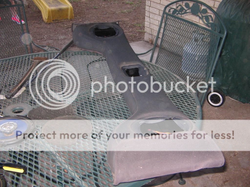

I have had this Jeep since 04 and had never folded the windshield down, so I did it because I had to take the bars over the doors off anyway to paint the covers.
All the covers and soundbar were faded to purple. I had taken the back covers off a few years ago to paint them and never had. The paint on the rollbar is getting scratched up, so it's time to paint the covers.

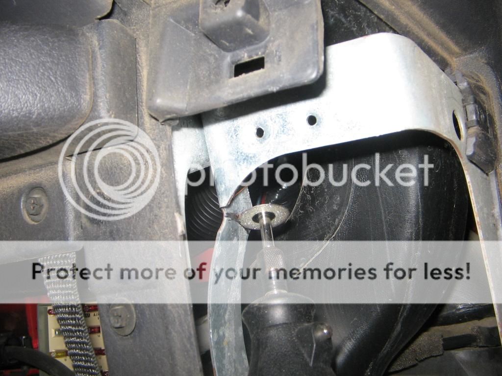

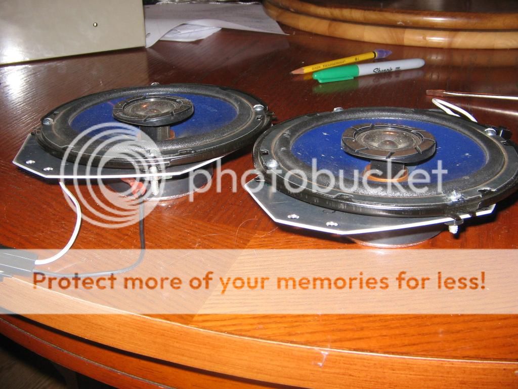

I used the adapters that I had made awhile back to put the 6.5" speakers in the dash. I had to cut the speaker supports in the dash to get them in far enough for the speaker covers to not bulge out on the side very much. I also bought another pair of 6.5" Two-way speakers for the soundbar.
