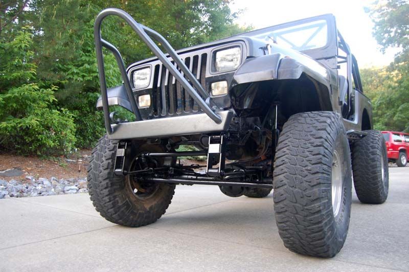

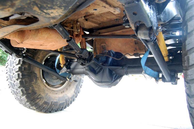

A little horse-trading, and my out of pocket cost is around $600 so far for axles and suspension.
Here are some pics of the rig it came off of. Pretty simple yj from the top but not so much underneath.

Are you gonna keep the link brackets as they are? I'm no link expert but it may be adventagous to triangulate the uppers and lose the track bar. But if everything works well as is then disregard
I wad going to say the same thing

That truss is already welded like crazy so it would probably be easier to add to it to mount the upper link brackets.

Took the words right out of my mouth. I think triangulated 4 link would be a better setup. How should be a awesome combo tho!

This will be my first real experience with links but this is set up almost exactly as a TJ factory setup, from what I was told. I can certainly see how a center UCA mount would help with articulation. It's definitely possible but the guy I bought it from told me everything worked great on his. I think I will just keep things the way they are currently.
If I find myself unhappy with ride height after I install everything I will probably pull it apart and make adjustment from there. I want to ditch the front shackles because of their length but that would mean shorter rear coils also and thus I'll need to make adjustments to the link lengths as well.
