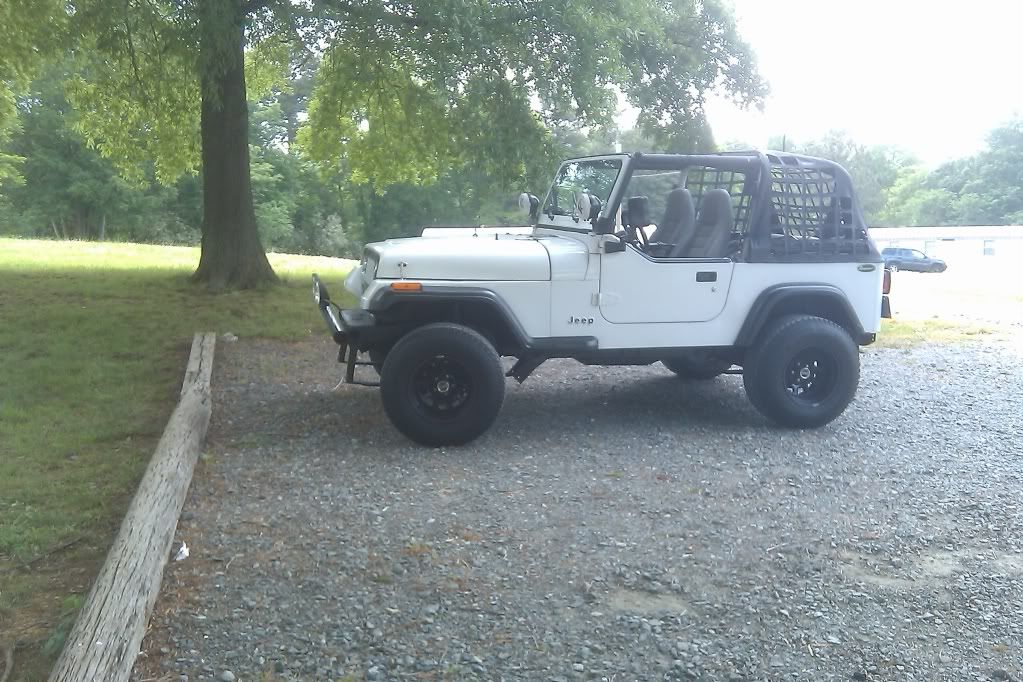

I need a roof rack!

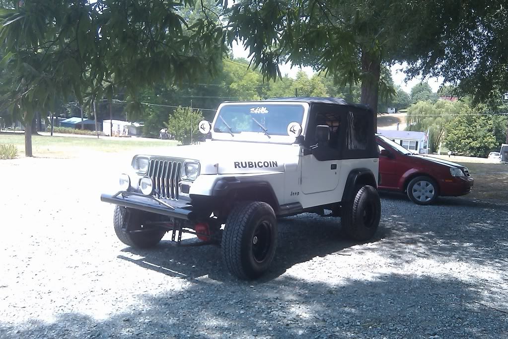

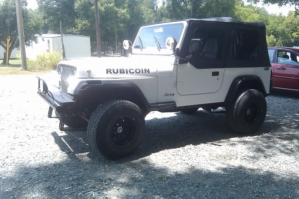

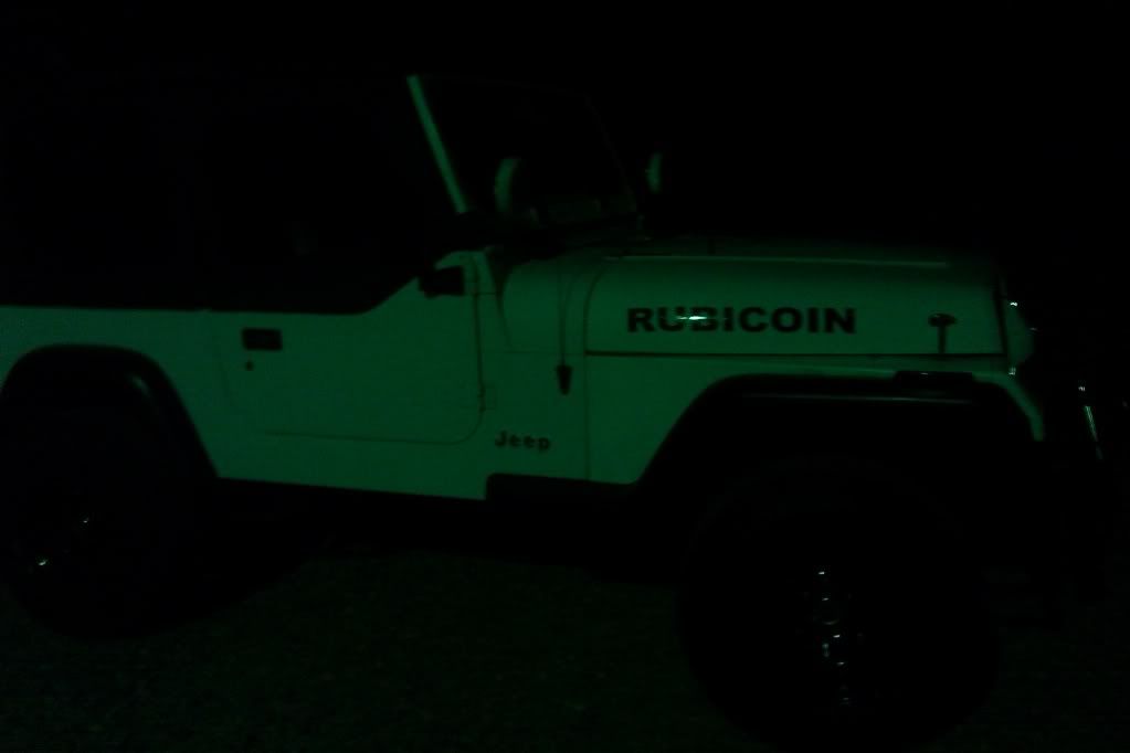

Decals went on today! not perfect buy thats why I have 3 sets right? I'll run it that way until my ocd makes me redo it!

Is it supposed to say rubicon or rubicoin?
Rubicoin. In reference to how we throw tons of money at our jeeps or get "nickel and dimed" to death by them...

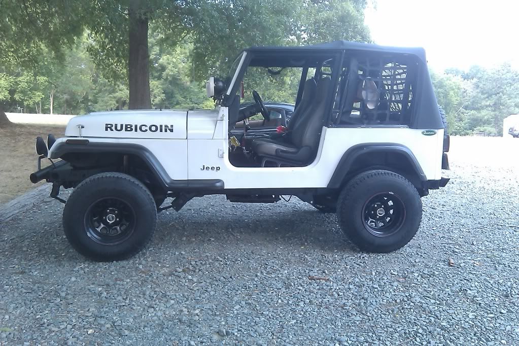

The before:
The after:
So long crazy shackles. Hello much smoother ride. They are still stiff but I now know what shocks feel like when theyre working! By the way, the truck shocks work great!
I also pulled off the shift boot today and realized the plate underneath was causing the problems.. I just left it unbolted until I can figure out a way to cut it to fit.
