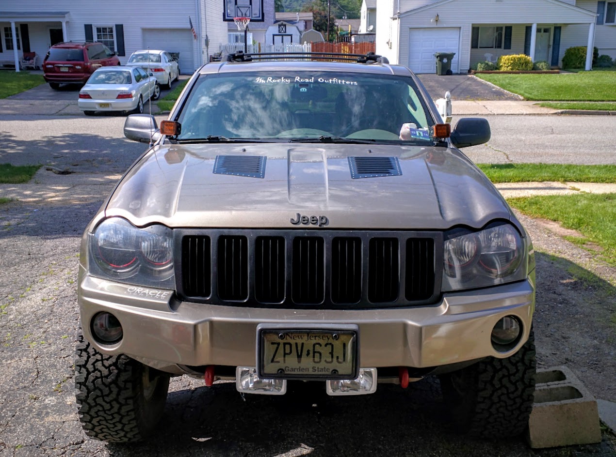

Despite how upset I am right now due to a current electrical failure regarding my Jeep, I will just have to look on the brighter side of what I got done today. I have had this mod in mind for a while, since April of 2014 actually. I noticed that the temps in my Hemi like to rise a good deal when I am wheeling. I noticed it first when I went to Rausch Creek a few years back and the same happened recently on the last trip. I always had in the back of my mind hood louvers and I recalled seeing a set on Rocky Road Outfitters website here: http://www.rocky-road.com/jeep-grand...d-louvers.html So, I shot Chris at Crawl Offroad an email; my preferred WK parts dealer and bought the louvers through him! After it all, my Jeep is looking like this:
When I got the louvers, I found that they are Run Cool louvers and they have some pretty awesome stuff. If ya wanna check them out, see here: http://www.hoodlouvers.com/ Now, back on track. I read the directions meticulously and got my tools; a drill, 1.5" hole cutter, an assortment of tapes, pop riveter, and a good ol' angle grinder to hack away. All that and protective gear as well! I started by pulling my hood latch; it broke. I should have just stopped there and said, 'Pkay, Casey you literally just broke your hood release, sell your Jeep now.' But no, I am persistent. I started off by marking where I wanted them and measured once, twice, three, maybe even four times. I lost track. I ended up with this:
As the directions mentioned, circular corners have more structural integrity than a plain shard corner, so I followed in belief.
Then the fun part of cutting the holes, which was said and done with pretty quickly. I noticed that the hood supports ran just near the bottom of the holes, so I followed the directions and 'Swiss cheesed' them.
Then, with bare metal showing and the possibility to see through the louvers, I decided to paint it all flat black.
And voila! This took about four hours. The hardest most tedious part being drilling every 1/8" hole and riveting the louvers on. It was all so worth it though and I love the look! Not to mention, heat BLOWS out of these things. You'd think I had a fan under there blowing hot air out. The Jeep took considerably more time to reach anywhere near its previous temps and it runs around 15-20 degrees blow what it used to.
If you're wondering where the negative remarks came from, it is because on my way home from work earlier after feeling satisfied from the louvers, I got a CEL. All of a sudden my Jeep was in limp mode stuck in third gear with trouble codes P0700 and p2067. It seems like I will have to drop the trans pan for a third time IN ONE YEAR PLEASE C'MON JEEP TRANS FLUID ISN'T CHEAP AND YOU CAN'T GET ENOUGH OF IT. That AND replace the solenoids above the valve body. Yay. I'll get under the Jeep tomorrow after I pray tonight that I find a loose wire. Wish me luck!

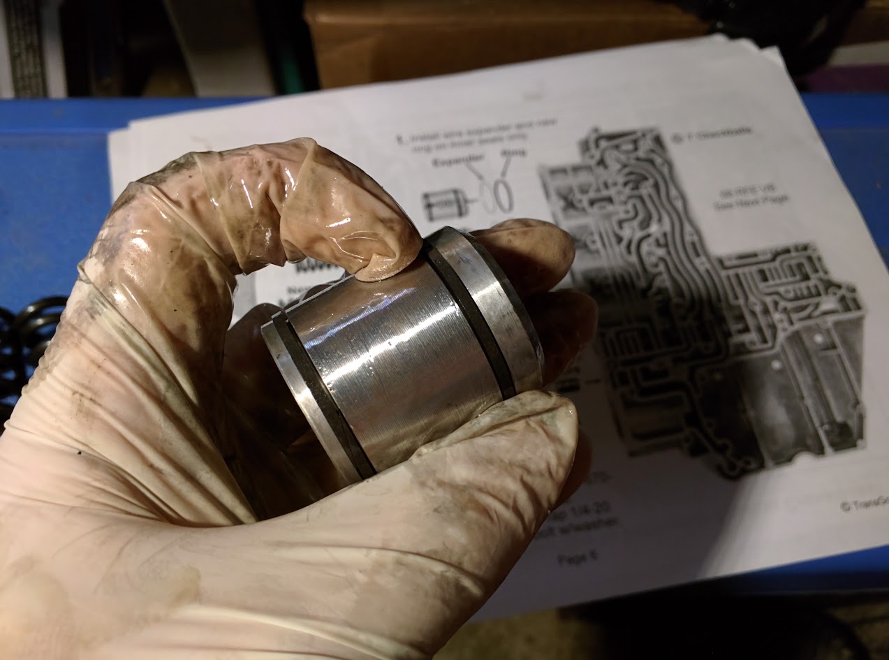

This post will hopefully be the last transmission update for some time! This was a pretty gnarly overhaul. I want to do as much preventative maintenance as I can, especially before I go away to college. With the solenoid pack shot, I opted to get the updated genuine Mopar solenoid, B&M Drain Plug Kit http://www.bmracing.com/products/802...rain-plug-kit/, Transgo 5-45RFE-HD Shift Kit http://www.transgo.com/products.php?...&product_id=96, Auto-RX http://www.auto-rx.com/category/transmissions/, new Royal Purple ATF http://www.royalpurpleconsumer.com/p...mission-fluid/, Fel-Pro gasket, and Filtermag pan magnet http://www.shopfiltermag.com/product/tm/.
Starting off with the simple things... I installed the drain plug kit at the lowest portion of the pan so most of the fluid will come out and so that it doesn't interfere with the dipstick. As for the magnet, I just placed it on the outside as it is meant to be! I was not sure of clearances on the inside of the pan, so I opted for one that sits on the outside. I am actually very excited to see what this picks up as even in the small amount of time since I changed the fluid, there are some metal particles floating around that were not caught by the puny stock magnet.
Next up I will mention the Auto-RX. I have been purchasing bottles of these for my engine and motorcycle engine, but had half a bottle left over and it makes some good claims to help the transmission. Here are some:
-Prevent or delay costly transmission repairs.
-Dramatically increase the life of your transmission.
-Improve overall transmission performance.
Next up is the Transgo shift kit. This kit is awesome and not pricey at all! It is meant to quicken shifts while making them more firm. Most of the parts can be installed with the valve body removed (which I have to do for the solenoid) and is not complicated at all. Most of the work is centered around the five accumulators which are the five holes with springs in them.
The five holes are accumulator pistons and inside the pistons are springs. Five springs, all five inner piston seals, the switch valve and cap, as well as the plate to hold it all in will be replaced!
The springs are much stiffer in the shift kit. The new one is on the right.
As for the piston, my finger is pointing to the seal the is going to be replaced. It is replaced with an expander and a new ring.
The new switch valve and cap are on the bottom. They are claimed to be self lubricating.
And the new reinforced plate to cover it all up!
And the solution to my problem to begin with, the new solenoid!
All finished up and ready to be reinstalled!

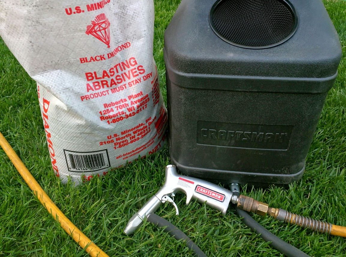

One thing I was really stoked to pick up was a new sandblaster. I find myself stalling days on a project when it comes to painting because I don't want to do simple prep. I ended up picking up a Craftsman sandblaster (http://www.craftsman.com/craftsman-5...&blockType=G33) for just $50 to my door.
I have used this a few times already and I can't see how I ever lived without it. I will be redoing my wheels with it, CAI with it, grille, and the small crevices when I paint my Jeep.

Great Find! I may have to pickup one of those! Much less intrusive on the shop space than a blast cabinet!
I figured the same thing; with the amount of time that I will actually be using this, I figured I wouldn't spend the money, or space, on an entire cabinet setup. It works really well too!
