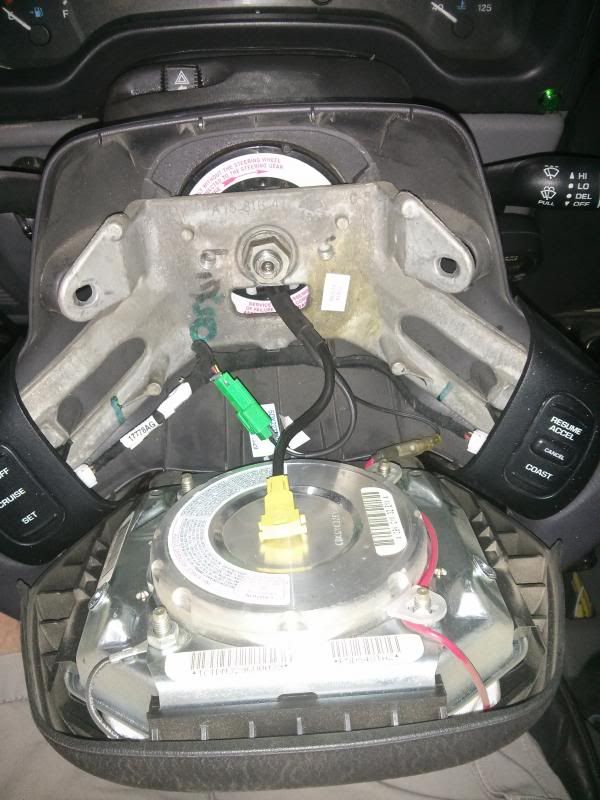

Sorry it took so long but here are the steering wheel pics.
Remove these first on the back of the wheel (after disconnecting the battery)
Then disconnect the yellow, green and clear connectors

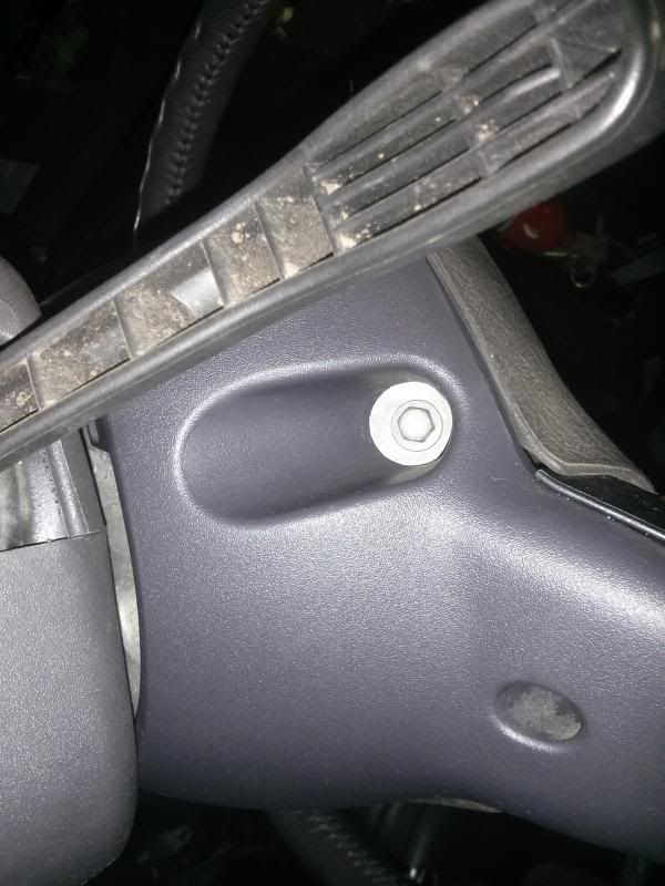

Then remove the nut/bolt and use a puller to remove the wheel, here you can see how bad the leather was peeling

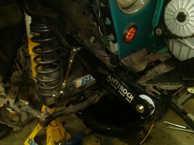

Got a bunch of parts in last night, so started by putting in the Anti-rock and the power steering pump. Anti-rock was easy, just follow the instructions.
Cleaned up the frame first.
Then hook it all up

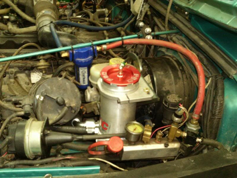

Power steering pump was easy, the hard part was getting the reservoir to fit with everything else under the hood.
Still need to do the cooler for the power steering. I had ordered the PSC cooler and mounting bracket, but after looking at the work to get it installed and the fact that it had two relatively small opening that would restrict the A/C condenser and radiator I decided not to use it and instead ordered a heatsink style cooler, that should be plenty with the increase in fluid volume the PSC remote reservoir provides.
