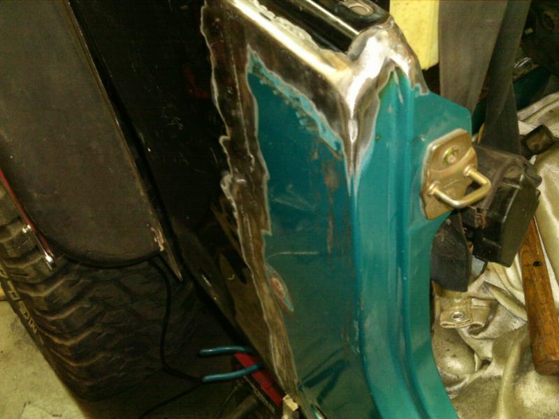

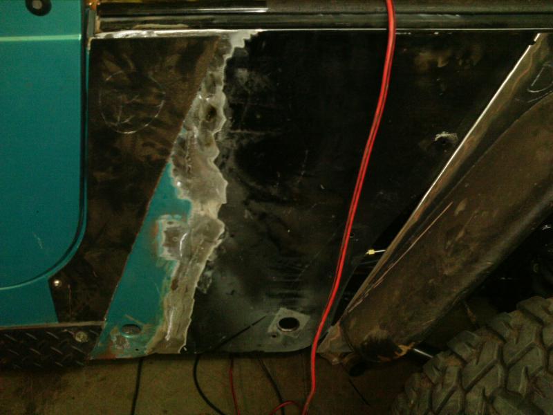

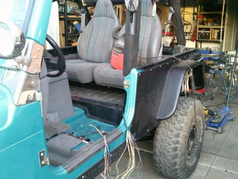

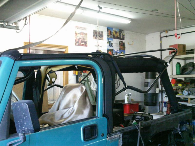

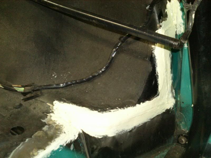

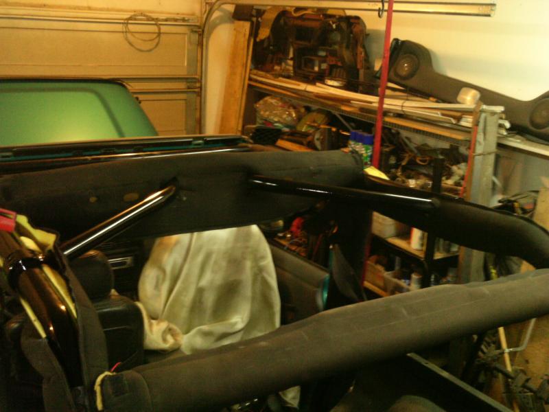

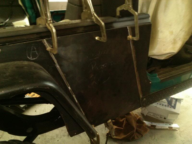

OK, so got the t-cases buttoned up, the rear suspension back together and no leaks this time. Driveshafts are in and the tranny crossmember is removed, just have to decide on what direction to go. The weekend was spent on installing the roll bar and various bars as well as putting the new Bestop NX softop on and making sure it fits.
Then I started welding up the body and fitting my corners.
It's not the prettiest but it will all get covered anyway.

Your sheetmetal work looks good to me , but I think most of us are our own worst critic . And the Dana 300 is no where near as easy to shift as the 231 .

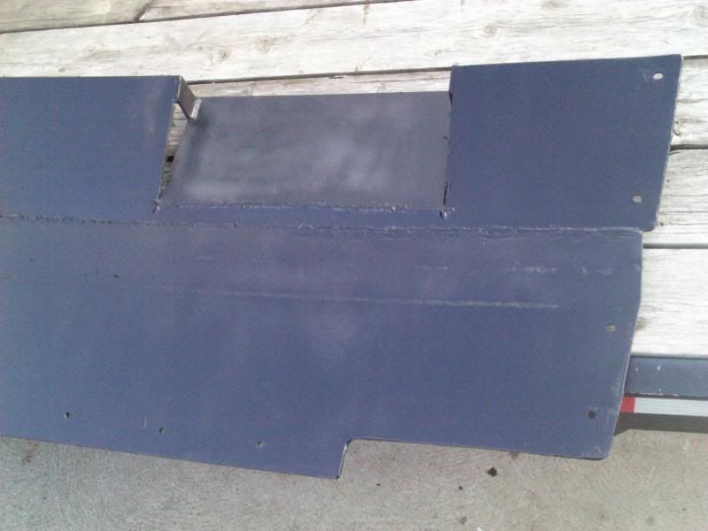

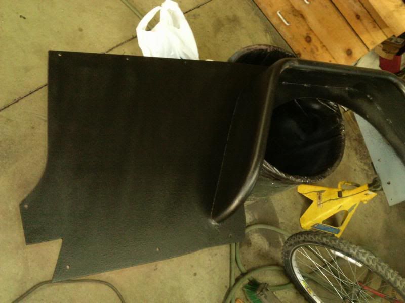

The 300 is stiff, but with the Jeep rolling it shifts not too bad. I just cover my sheetmetal work with body sealer or plate, so almost none of it will be visible in the end.
So got a lot accomplished the last few day. The body work is all done, got to be the worst part. The fenders are welded up and the center skid is modified to fit the doubler.

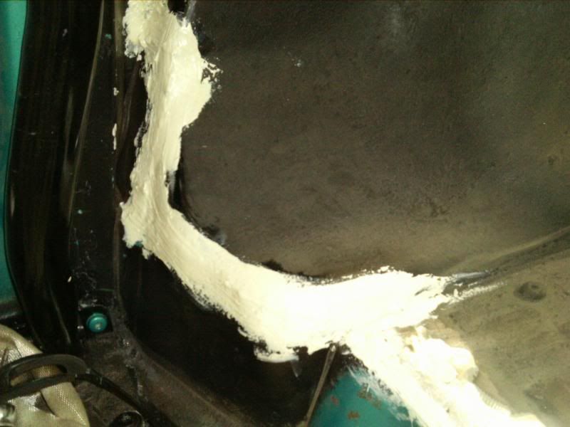

This week I've got to get the exhaust done, finish some painting, splice the electrical in and install the lights. Also the rear bumper and rear seats can go back in once I bed line the last of the tub.

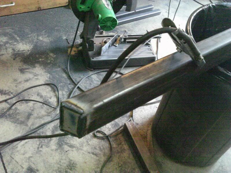

I picked the Jeep up yesterday from the exhaust shop, a little concerned with clearance over the axle, but it might work, otherwise they'll fix it. Has a code right now, but may be just because the rear O2 was unplugged at one point, I'll check it tonight. Got the right corner painted and holes drilled, have a little to do on the body side, hopefully tonight. Installed the main skid plate so I can measure for the cover between it and the crossmember. Also picked up the steel, 4"x2" 3/16" wall tube, for the side steps, which will be worked on this weekend. I can't wait to get it on the road for a test drive though.

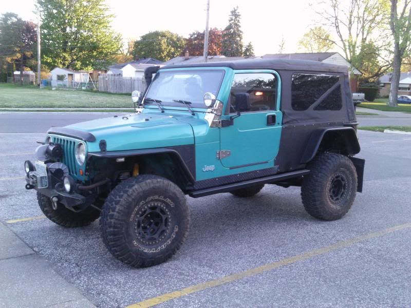

It's still a build, maybe not quite as large, but still a lot of little pieces, which is all any build is.
Got the right side corner all done yesterday and then took it for a bit of a drive, almost forgot to bolt the drivers seat down, but did do it. Drove nice, put the top on but left it down for a nice cruise, was good to get it out, now if I could only find my shift knob, it seems to have walked away. Was going to drive it in to work this morning but it was raining and I didn't want to get it all wet and then have to work on it this weekend, so I took the car. Found two codes, one for upstream O2 shorted to power and one for e-fan, which I don't have. Looked at the O2 and the connector was loose, the lock's broken, so I plugged it in and started the Jeep after clearing the codes and it didn't come back right away, so we'll see. I'll zip tie it together for now and see what happens, but otherwise I think I have another O2 that I can change out. Also did an oil change since it was warm, it was almost 2000 km since the last one, that was July of 2011, I've got to put more miles on this year, good thing I use a full synthetic oil.

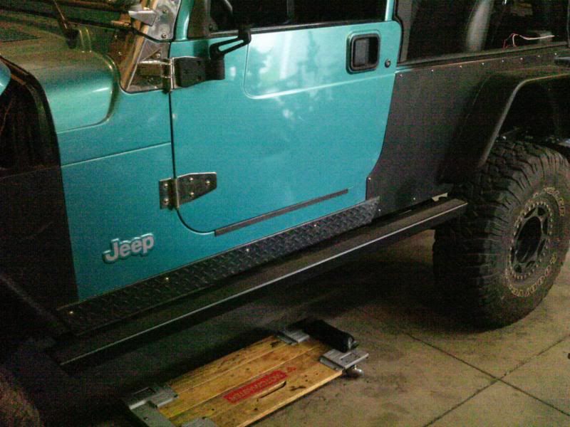

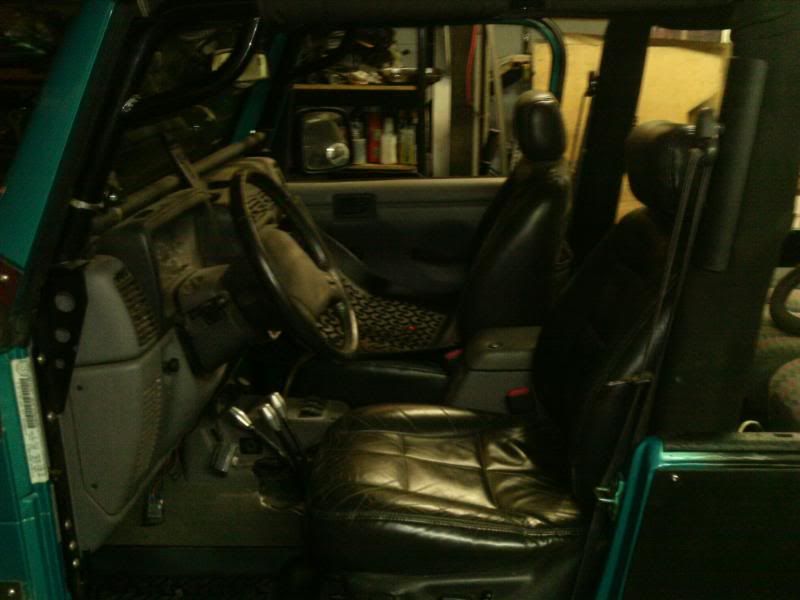

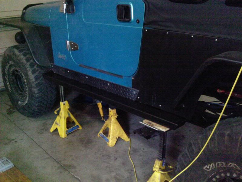

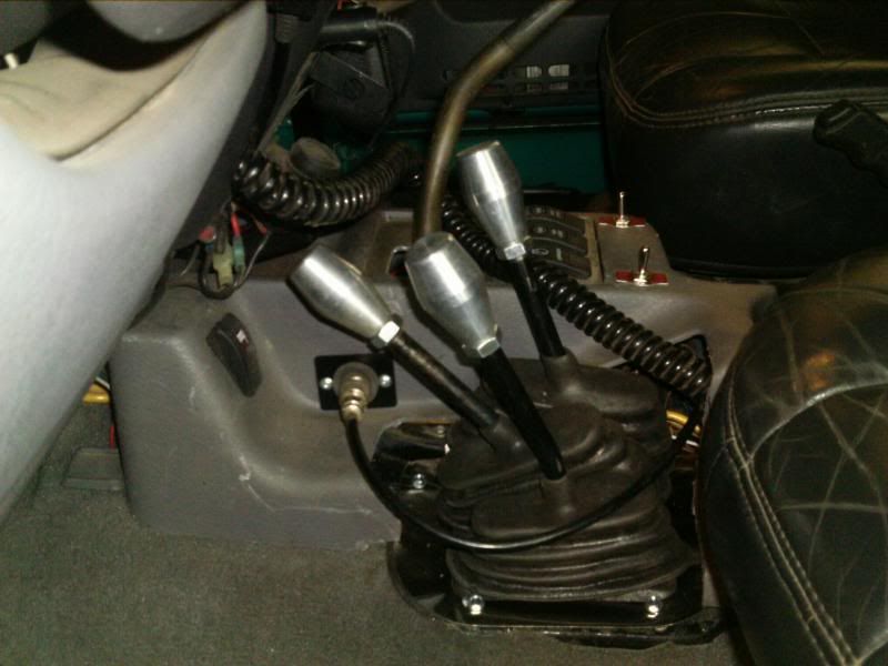

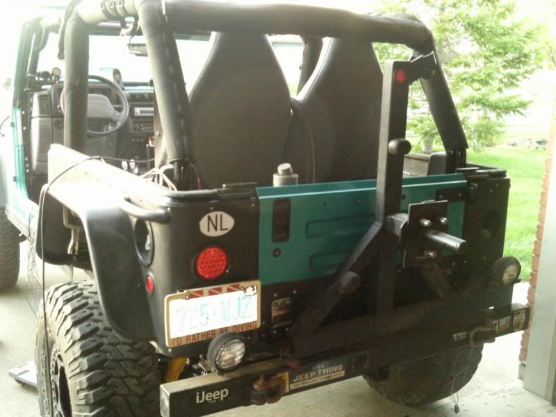

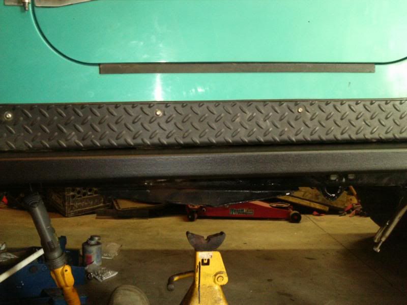

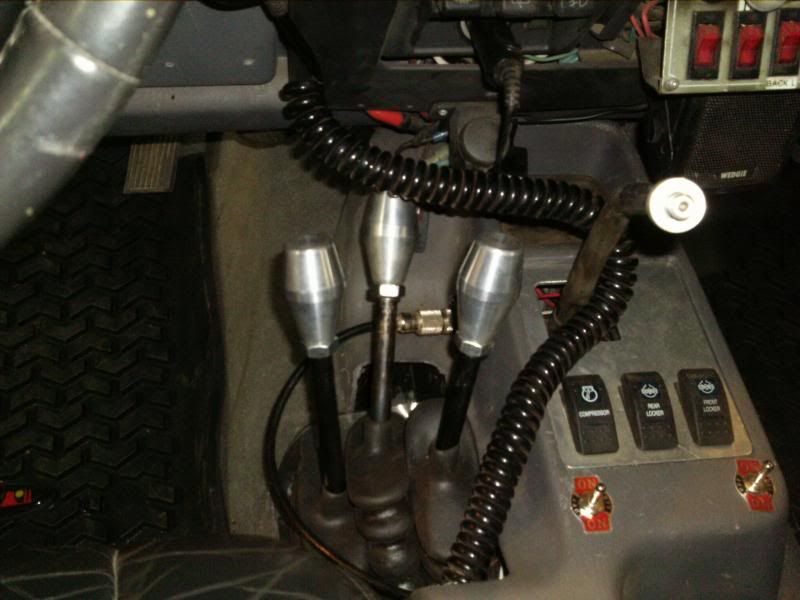

Got almost everything done this weekend, at least that's needed before next weekend, because a Jeep is never really done. Built and installed the sidesteps/rock guards, put the boot and knobs on the t-case shifters, put the hi lift on and spare tire, ran the wire for the CB antenna and re-installed the center console, soldered the wires for the backup lights but ran out of convolute. Tomorrow I'll get the last two pieces of steel I need so I can finish the skid extension and the rear cargo cover.
I did put labels on the shifters, but forgot to take a pic after that

Wow. Looks great. Good job on he sliders and the triple sticks/center console

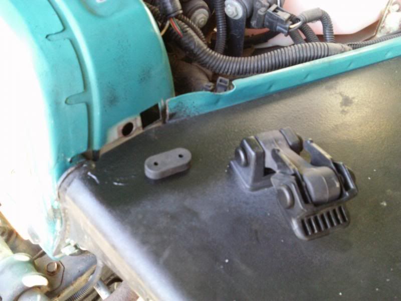

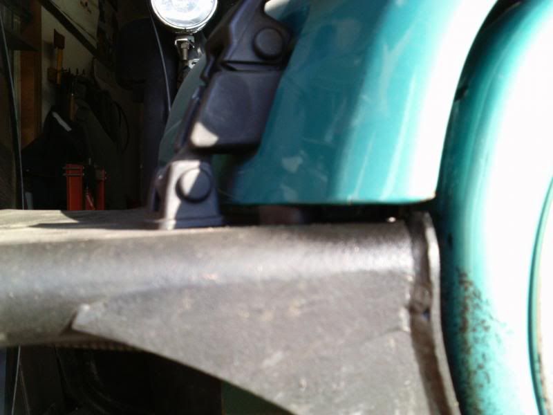

So all ready to head to Rausch Creek tomorrow, finished up loading and a few small final pieces. Got the last piece of 1/4" plate for a little skid plate extension under the 300, I may still make the transition smoother, but for now it should do. Also picked up some hood bumpers as I was tired of the metal on metal rubbing of my hood on the fender.
