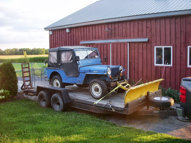

Not too related, but also picked up this little guy.
Right now it has no brakes, and is running out of a temporary gas tank, but it's a blast.

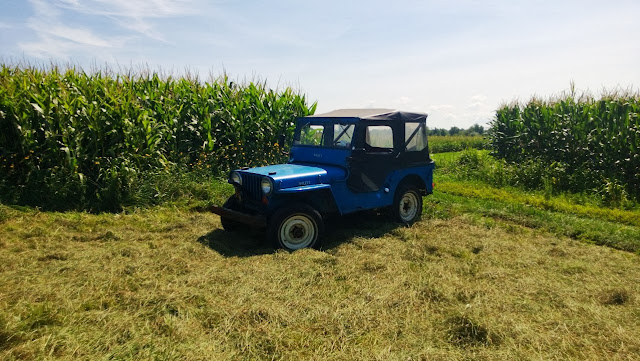

A little update on the Willys. I replaced all the brake hoses and hard lines for the front axle. The hard lines from the knuckle over were a little bit of a pain.
One of the hoses looked in decent shape originally, so I had left it on but I wasn't able to get any fluid through it. NAPA listed two different rear brake hoses, I went with the longer of the two for both the front and back.
I still need to work on the rear brake lines and all the wheel cylinders and pads, but it was enough I can drive it around for the fall.
Folded down the windshield and spend some time with the Willys in its natural environment.
The tires left a little to be desired in the muddier areas, but it was a blast.
