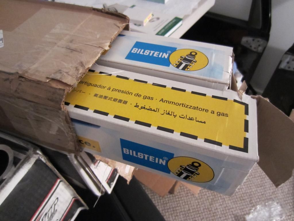

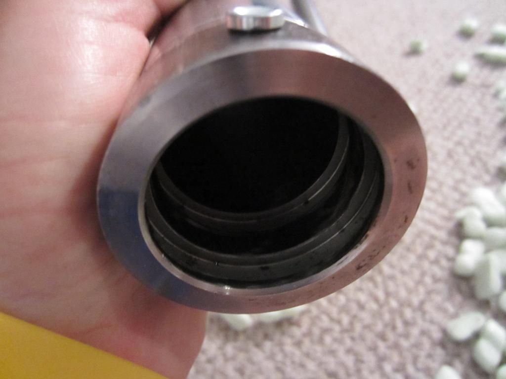

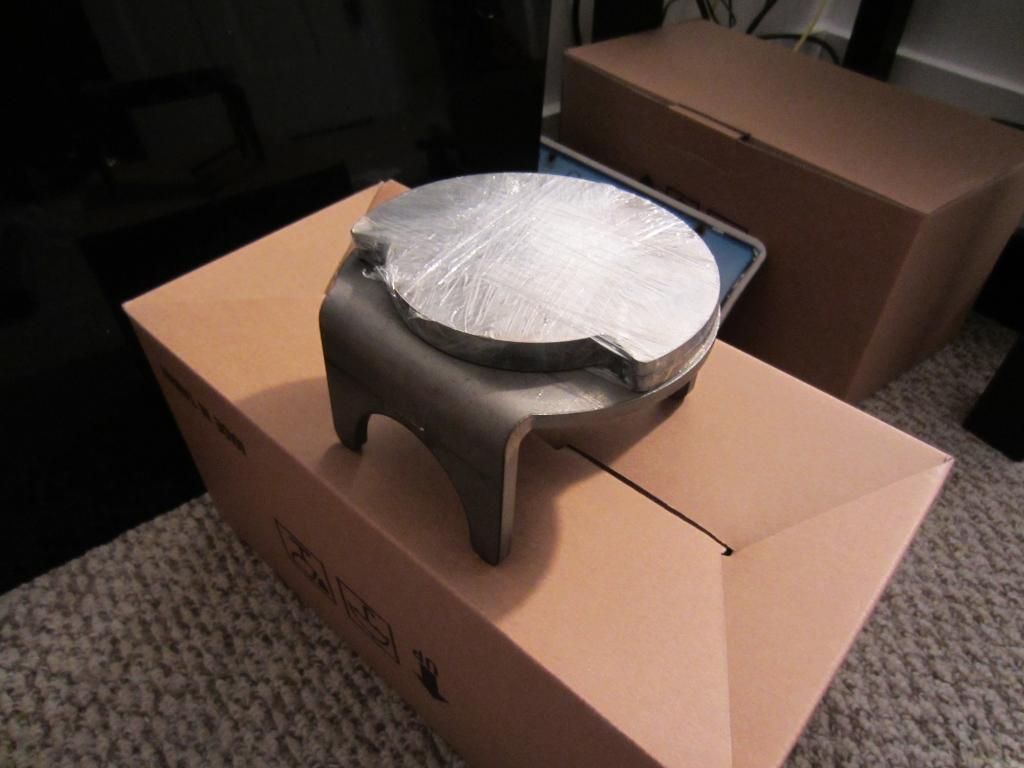

No more progress has been made on the rear 4 link yet. Jeeps in my friends garage and he lives over an hour away from me so we dont get any weekday nights to work on it. This Sat we will be getting back to work but in the meantime I got a few items in the mail.
Front Bilstein shocks arrived
Axle sleeves, they came with washers to provide a seal
Coil bucket with spring retainer. Might not use the bucket and just throw the retainers on the stock buckets. Not sure yet
No more updates until this weekend
