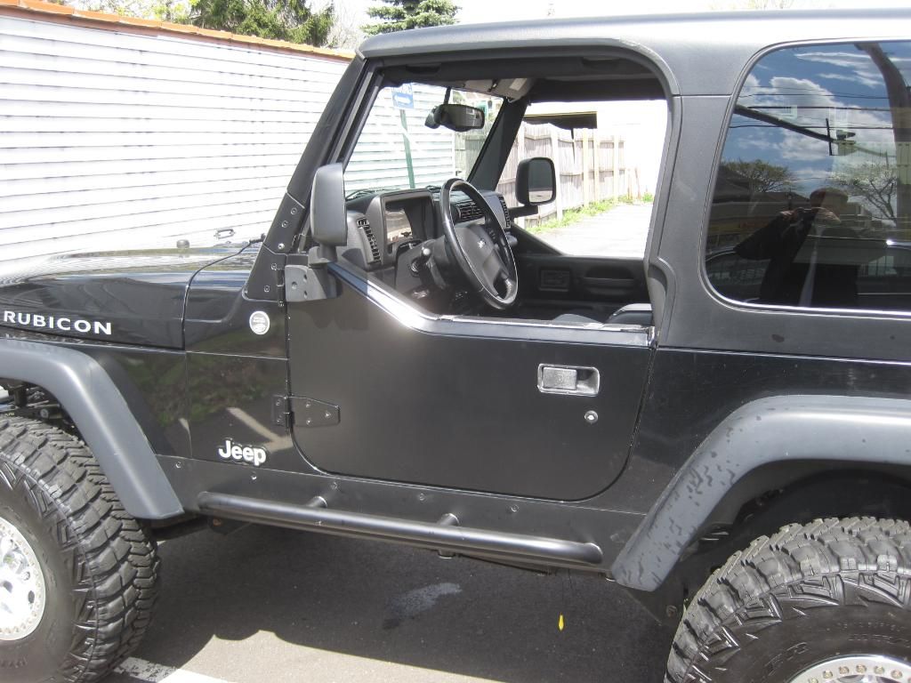

Small update: Got my half doors on, paint doesnt match perfectly but its close enough.
