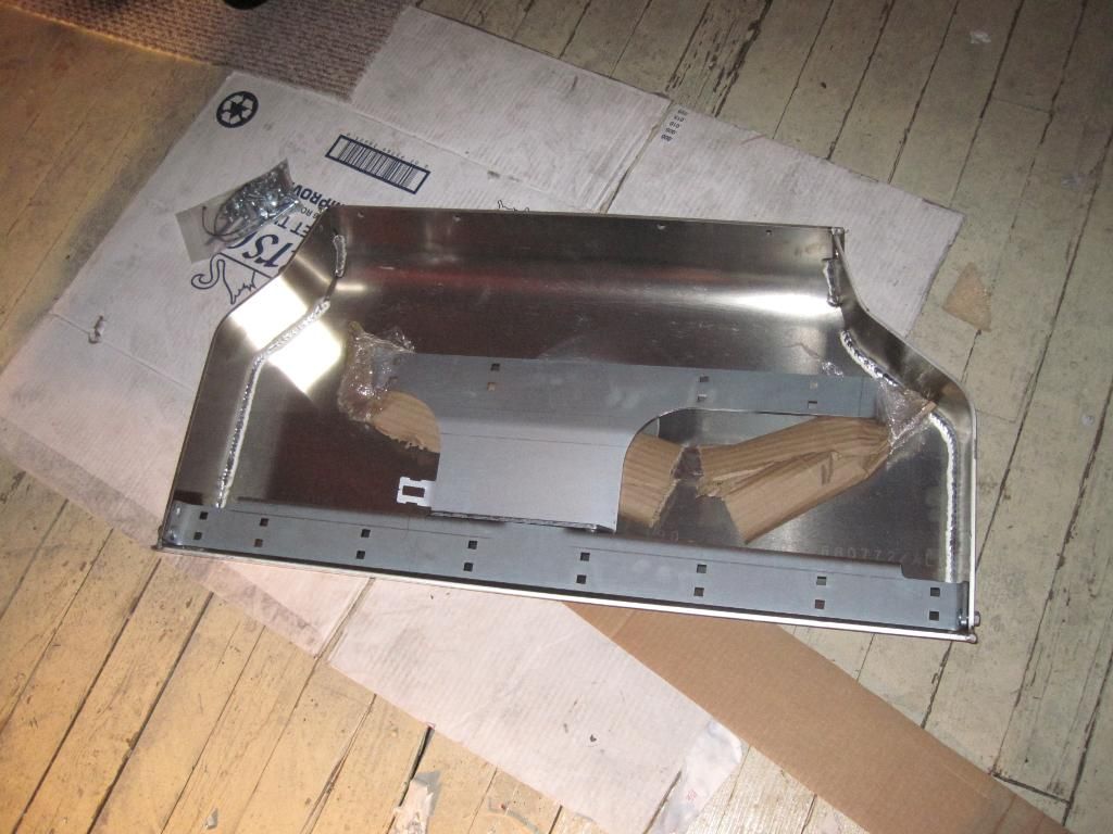

-Gas Tank skid has arrived and has been painted satin black

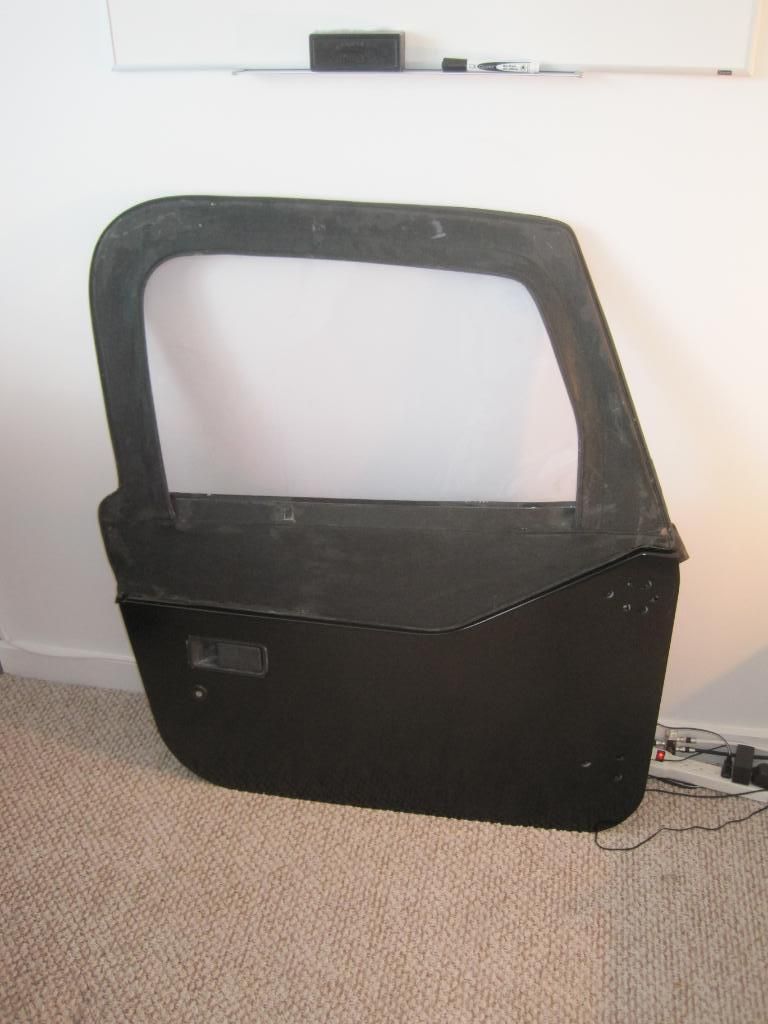

-Finished painting the passenger side half door.

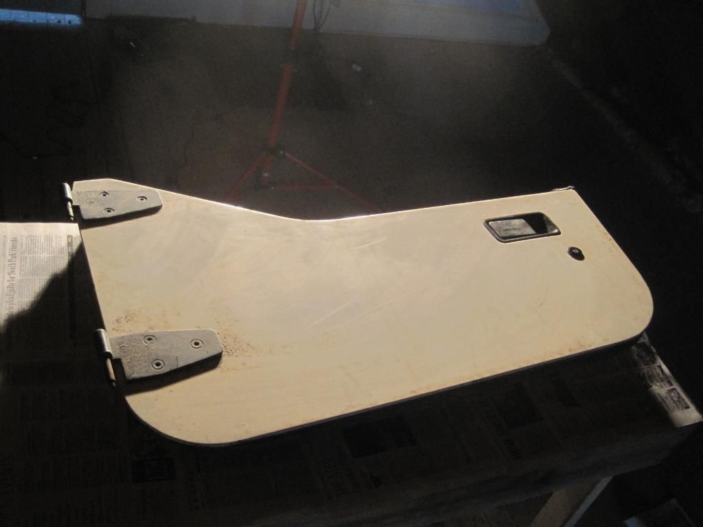

-Started to sand and prime the driveside
