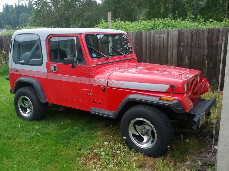

Like this YJ I just scored for $1500. Looks like it just rolled out of the showroom.

Every time I walk by it I think about putting a small lift on it, a 350 V8 with a 700R4, some 31" tires and make it a street / fire road cruiser....
Originally Posted by H3lzsn1p3r View Post
put a 4 inch lift on it sell it for 4000
I could probably get 4500 for it how it sits (once I fix the rod knock). Good wranglers with hard tops go for crazy money around here.

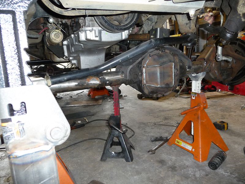

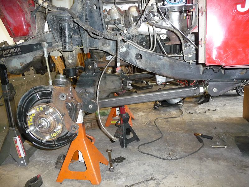

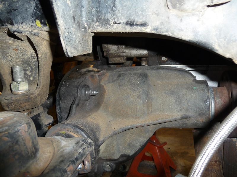

I played with the front axle a little last night. It didn't go exactly as I was picturing in my mind. I was hoping for 4-5" of travel for the front with my 3" savvy springs but that looks like it's going to be a no go. Everything wants to be in the same place. My exhaust, front drive shaft, track bar mount, and upper link mount. The switch to a high pinon front really moves things around.
On a positive note, I ordered my wheel spacers and also called Tom Woods up and got my pinon yokes.

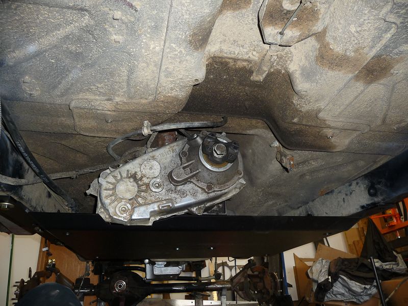

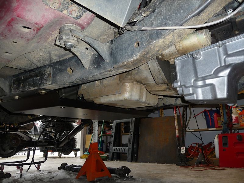

I did manage to get a little more done. Played around with my new skid plate. Added a transmission mount with some C channel and made some cutouts for my transfer case and transmission.
Then I fixed a broken nutsert and bolted the skid in place.

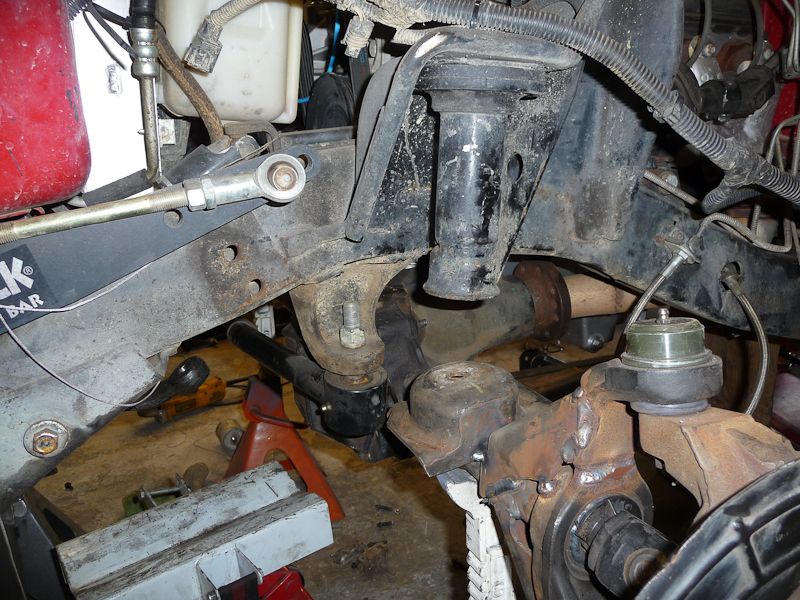

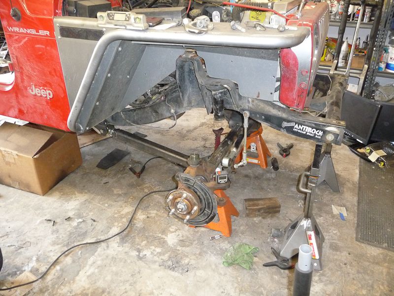

Then I started work on the front end. Finished fabbing the control arms and tacked everything in place. I also bent a truss for the front.

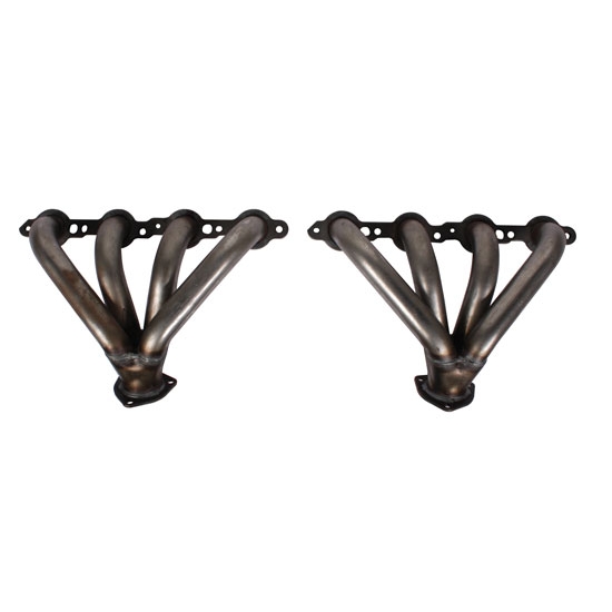

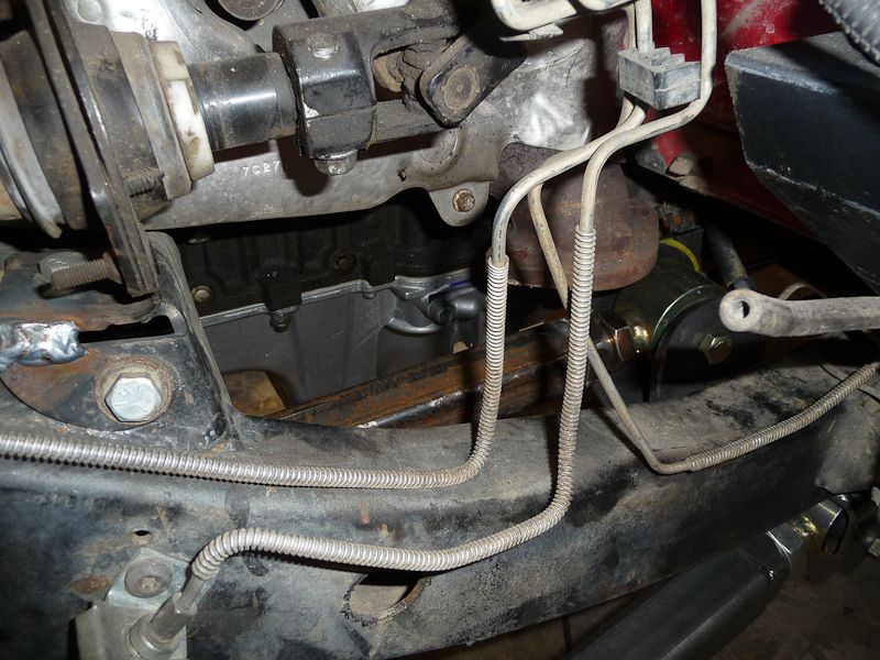

As luck would have it, my upper link sits exactly where the exhaust manifold outlet is. Looks like I'm going to have to order up some center dump block huggers and hope for the best. There is really no other place to put it, so I have my fingers crossed.
I'm going to order these up. I think they will do the trick.
They are only $200 so I can't really complain too much about that.
A few road blocks:

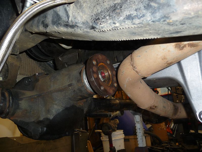

I tried to mount my wheel spacers that came today. The back ones are great. The front ones don't seat all the way because of a slight lip on the unit bearing next to the face. I'm not excited about dealing with this, as it was supposed to be just an easy bold on deal.
Also, I tried to bolt the JK drag link to my stock pitman. That was a no go. The JK taper is quite a bit larger than the TJ, and I sold my TJ stuff so I can't cut / weld the two together. Looks like I'm going to have to go with some poly performance stuff for that.
Tomorrow I'm going to check clearances and see where I'm going to be at for maximum uptravel and maybe fab some spring plates up.
