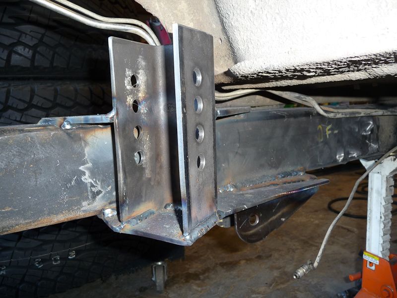

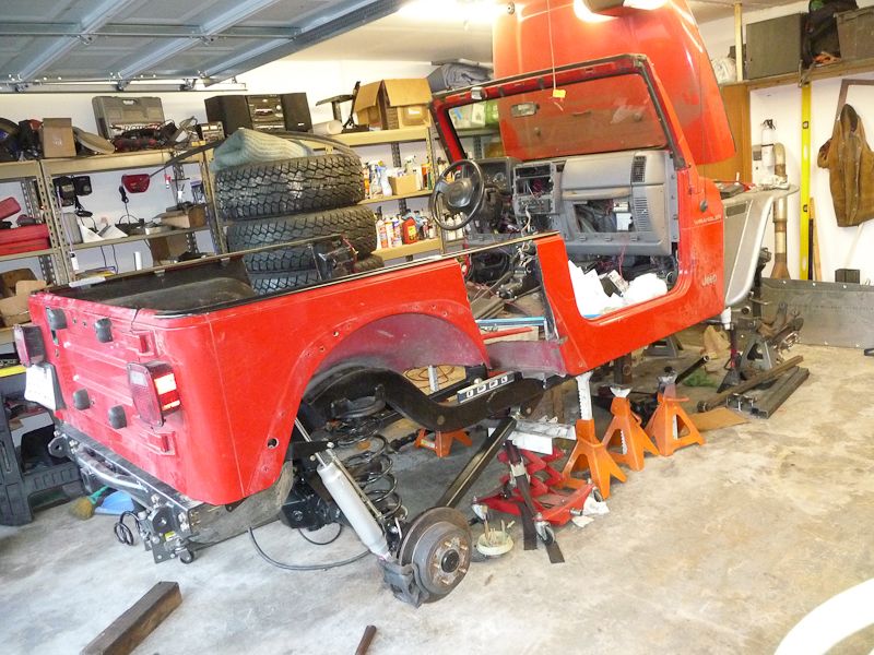

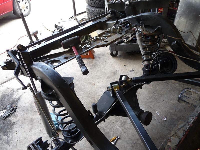

I've been distracted by other projects, so the Jeep hasn't been getting much attention. Now that I have most of that out of the way, I can refocus.

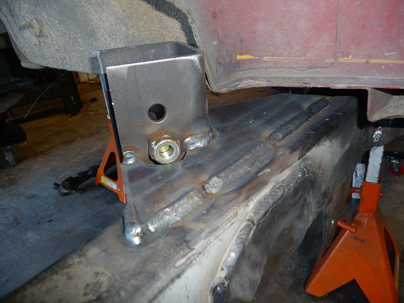

I finish welded all my brackets. Here are the uppers.

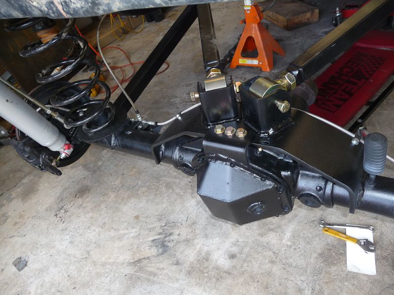

Painted everything and bolted everything up for the "final" time.
I also had some braided brake lines made and ran them.

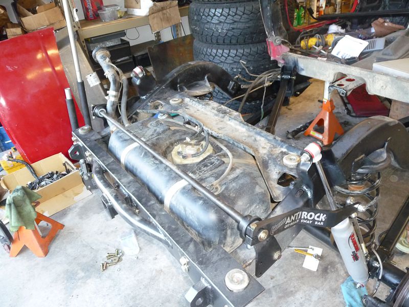

Put the gas tank back in and started to figure out what I needed to do with my various lines.
After a little notching for the rear anti-rock I set the rear of the tub in for a little sense of accomplishment. I also set the soft top rails on to see how close I was. Everything lines up nicely.

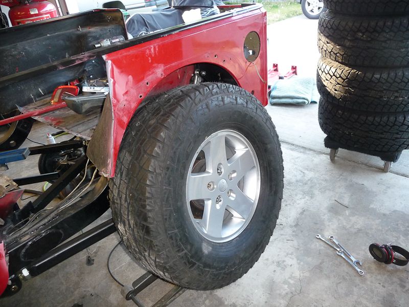

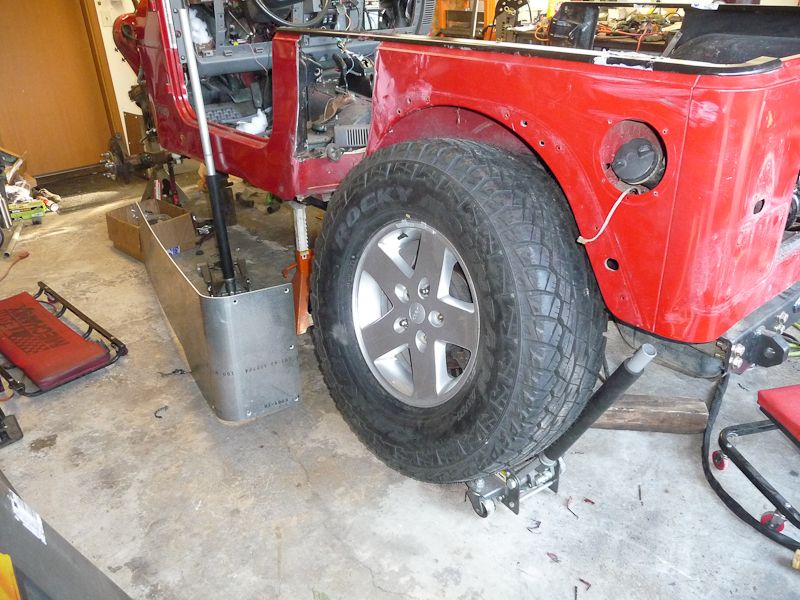

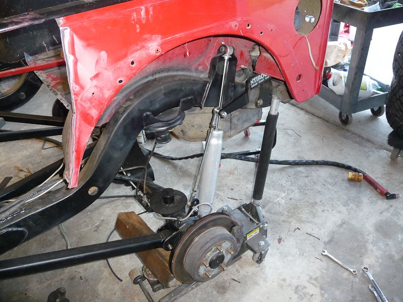

I had to make clearance for the rear anti-rock. Warmer weather, short sleeves, and cutoff wheels and plasma cutting isn't too fun. The rear suspension is about 100% at this point.
I threw a tire on to check clearance on the tub at full stuff to see if I need to cut some. Nope. This is with the bumpstop out and fully stuffed on the bump stop pad. I'm super glad this worked out. I need to get this project on the road.

Clearance in the rear is looking good man. How do you like the Ranchos? Were they outboarded before? Ever feel the need for some something with a res?
I've never used the Rancho's before. I will say this: the shock bodies are huge. Makes packaging them interesting. This is my first time outboarding shocks. I've never had a Jeep that rode nice enough to drive fast enough in rough conditions to need a resi shock, so I suppose I will see?
