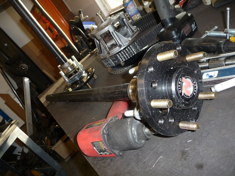

35 Spline Nitro Chromo shafts. Complete with bearings, retainers, and ABS rings, pressed on ready to go.
Matching ARB should be here Wednesday.

Thanks guys! Can't wait to go out and beat on it. I figure 35 spline should be pretty anything proof on 35's.

The stock rubicon locker in mine did fine with 35's. I also had stock shafts with my 5.3. I made sure to keep the rear locker engaged whenever I was wheeling since the weak point is the limited slip gears. I didn't do too many rocks with this setup though.

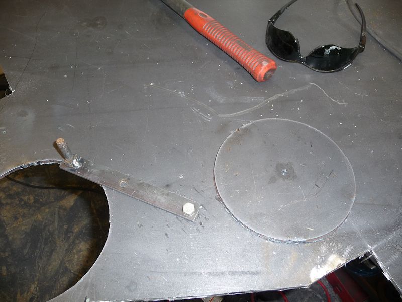

Made some lower coil mounts. Used my plasma cutter and a piece of scrap to make a nice little circle cutter.

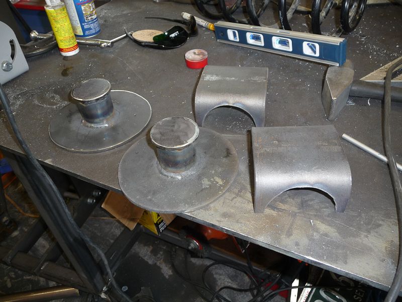

Used my press brake and bent some 1/4" strap for the axle side of the mount.

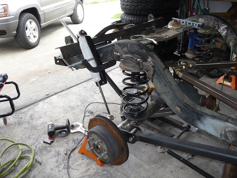

Tacked everything up and mocked a shock up to see what I was dealing with.
At this point I was getting tired and the garage was a mess so I called it a day and cleaned up. If nothing else, I have learned that it's much easier to work in a clean, organized space. It also looks like I'm going to have to order an anti-rock for the back as the stock JK anti-sway bar is a no-go.
