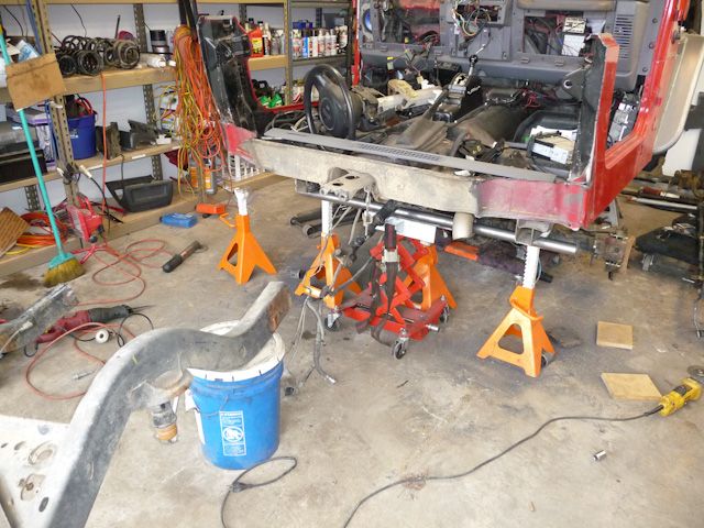

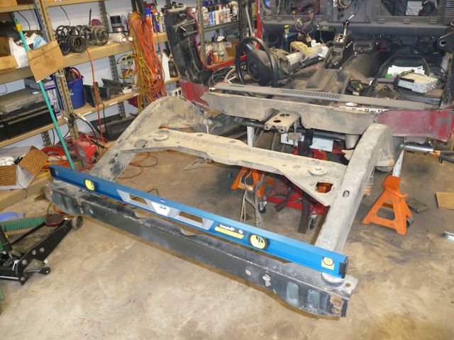

Then I started work on the front end. Finished fabbing the control arms and tacked everything in place. I also bent a truss for the front.
As luck would have it, my upper link sits exactly where the exhaust manifold outlet is. Looks like I'm going to have to order up some center dump block huggers and hope for the best. There is really no other place to put it, so I have my fingers crossed.

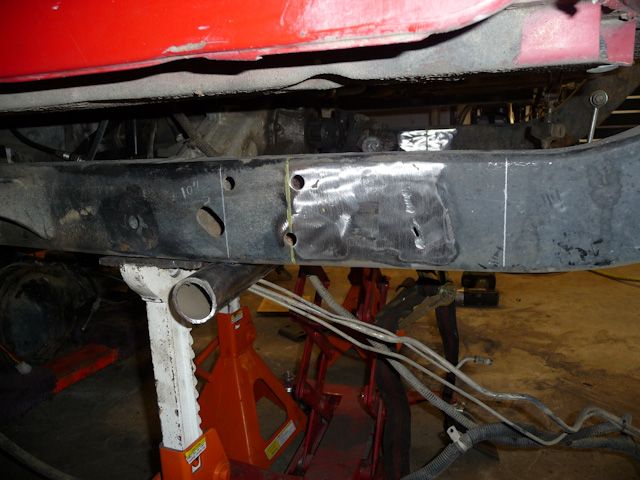

The original plan was to put the axle in about the stock location, maybe .5" forward. That way I could reuse my track bar and avoid removing the factory track bar bracket.
This is what it looked like. Not happy with the amount of uptravel I was getting or how close everything was to... Everything. So what if I move if forward 2 inches? Much better....
I gained at least 1.5" of up travel. I've read that removing the factory track bar bracket is a pain. That is absolutely correct. I can't believe how solid that sucker is attached to the frame. I killed two good cut off wheels, a 40 grit flap disk, and a set of consumables for my plasma. I was originally going to quit my job and start a business removing factory track bar brackets, but after this ordeal I think I'll stay where I'm at.
