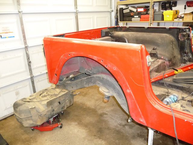

I've been making some progress. Got the top off, roll bar out (the security torx bolts were a nice touch, thanks Jeep), seats out, gas tank out...

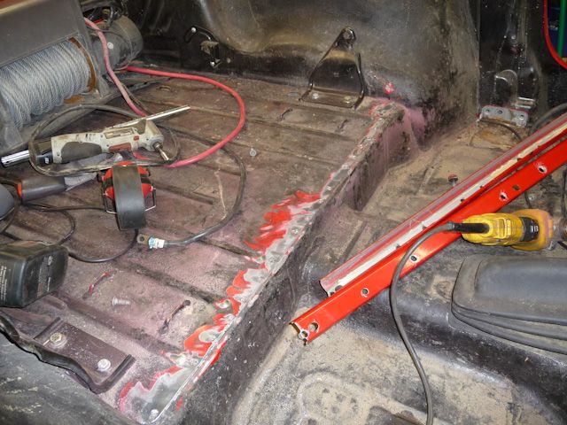

Then I had the displeasure of cutting out spot welds. The harbor freight spot weld cutter is like a lot of their tools - oh sure, it will work - you just might want to kill yourself after you are done.
The bed liner the PO sprayed in the tub came off pretty easy with a wire brush in a grinder. I think I'm going to remove the rest of it and re-do it with a higher quality product, since whatever he used looks like crap and is damaged easily.
I also had a chance to call some yards looking for a LJ tub. No luck. It looks like I'm going to have to make patch panels myself. No big deal - should actually save me some money.
More fun pulling the belt rails off.
With any luck I should have the rear of the tub cut off tomorrow.

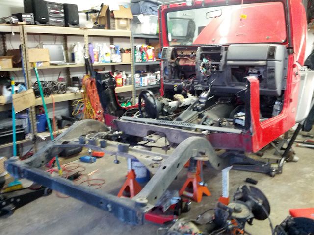

I've been sick the last week so I haven't gotten much done. I have, however managed to do this.

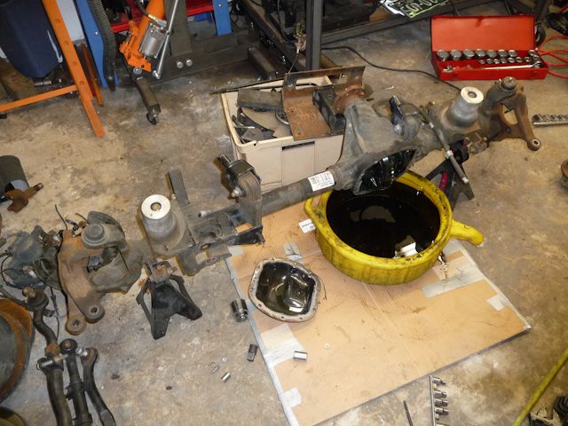

Uh oh... Looks like I'm past the point of no return now! I also had a chance to pick my axles up. I found a HPD30 and D44 out of a JK that have been regeared to 4.10. Perfect! Nice and wide, better brakes, no inverted Y steering.

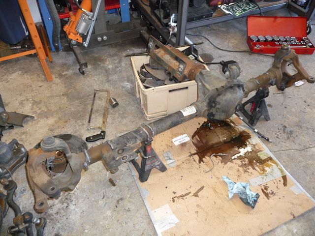

Here's the front.
This is what it looked like after a few minutes with the plasma.

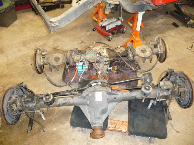

Here's a look at the rear D44 in front of my old Rubicon D44.
Thicker tubes, bigger brakes, and the center section is defiantly more stout with thicker ribs and overall wider.
