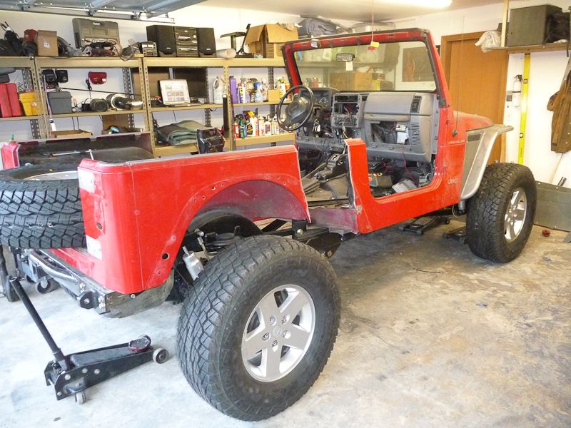

In other news... A big milestone in this build.
NO JACKSTANDS
That's right. The Beast is now a big boy, and sitting on all fours. I just have to final weld the drag link, paint it, and put some bump stops in the front and I am DONE. (with the suspension)
With the Jeep on the tires, I now get a full 15" out of the front springs, which is exactly 3" of lift over stock. I only have 4" between the bump pads, so I think I'm going up to the 4" springs.
Also, another thing to add to the "buy list" is new front brake lines. The JK calipers put the brake line at the bottom of the caliper and my lines are just too short. Plus, the alignment bosses on the JK caliper have the line coming out to the rear of the Jeep, and not up. The stock JK brake line has a 90 degree bend to it right out of the banjo bolt. I'm not sure if I'm going to try to use the stock rubber JK line, or most probably just pony up the $100 for a set of braided lines.
Whatever it takes, I'm getting this Jeep in shape for a shake down run at the end of the month.

First thing this morning I had the intention of putting my driver's side fender back on. Then I caught a glimpse of my power steering cooler I bought a while back. I had intended to install it when I did the 5.3 swap, but the urge to drive the thing made me toss it into the "do later" bin. Well, there it was, begging me to put it on... It will only take a few minutes...
Hour and a half later I came up with this.
It fit well, and the clearance around the hoses is good. The cooler is actually a trans cooler off a ZJ Grand Cherokee that I snagged at a junkyard for $10 awhile back. It is a good size, stacked plate cooler that has the right sized connections and has 3 tapped mounting tabs. Perfect.
I started the body work today as well. Rough cut the corner guards and clamped them into place to make sure the back of the tub was square.
Then I put some 16 gauge in the bender and made myself a floor. I now have one, continuous floor in my Jeep!
I also put the engine compartment back together. It's oil, oil filter, and coolant away from running open headers. I also finally installed the horns. Very annoying to drive around without those.
I also made some measurements today. Looks like I'm sitting on a wheelbase of 108" and a belly height of 19". Should work nicely.
