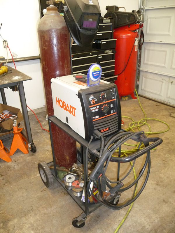

I'm going to try to build everything I can, and buy parts where practical. So, with that thinking, I decided to spend a little on more fabrication tools.
This will be nice for cutting out brackets, skid plate, removing axle brackets, etc. I'm working in a standard 2 car garage, so space is limited. I decided I would mount the cutter below my welder.
My girlfriend bought me a harbor freight 20 ton press for my birthday (she calls it the big red "H"- I told her it's actually orange, but it's more red in the coupon I gave her...) Anyway, I wanted one mainly to put Swag's press brake into.
And used it to make this
Some scrap angle iron, some wiring, and ....
