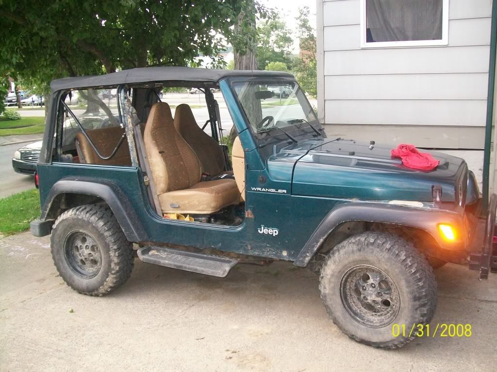

I bought my 98 Tj SE dirt cheap. I knew there were some rust issues with the frame when I bought it but hey it was cheap.

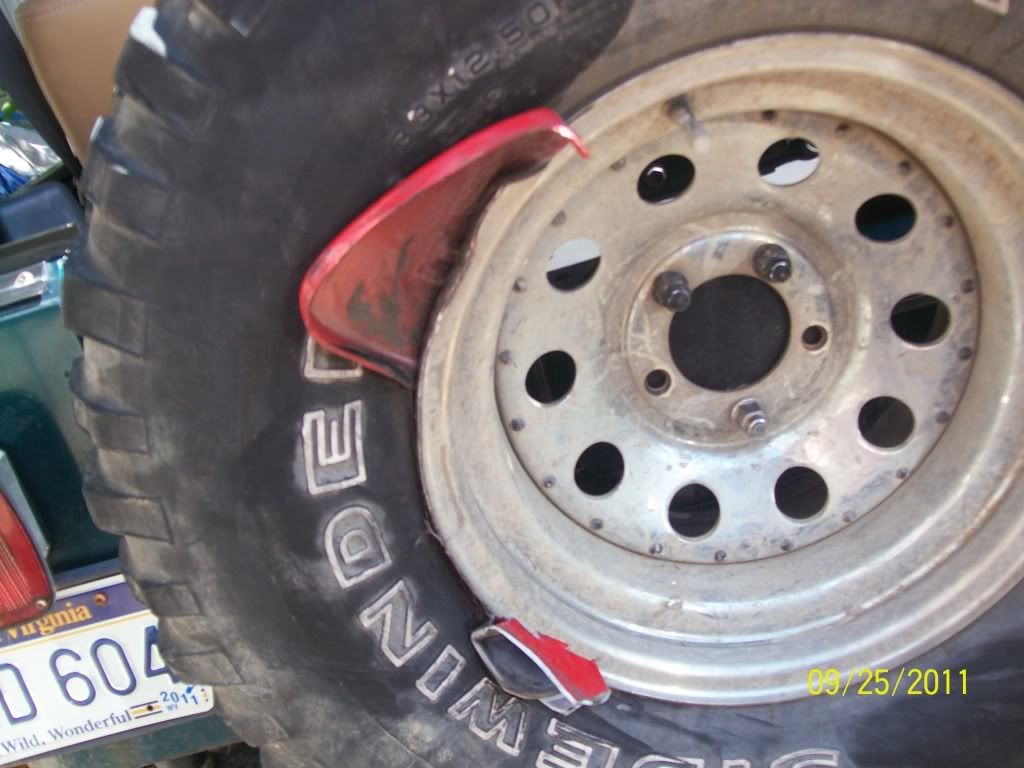

The first time I took it to the trails around here I tore the rear UCA's off the frame...
The crap 235's that came on it were worn too much so I put a set of 1" BrownDog Motor mounts and a Zone 1.25" BL with 31x10.50 MT's and wheeled it some more.

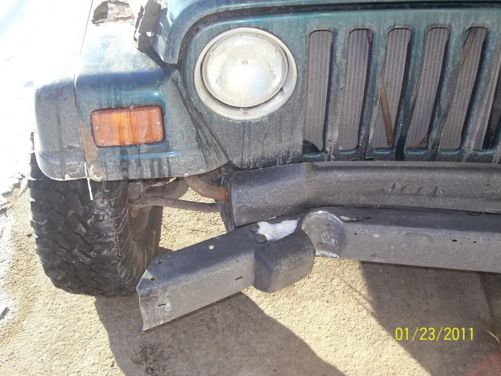

Then that winter I was late for work and pulled into the gas station a little too fast and slid into the gas pumps...
It also pushed the tub forward on the frame-

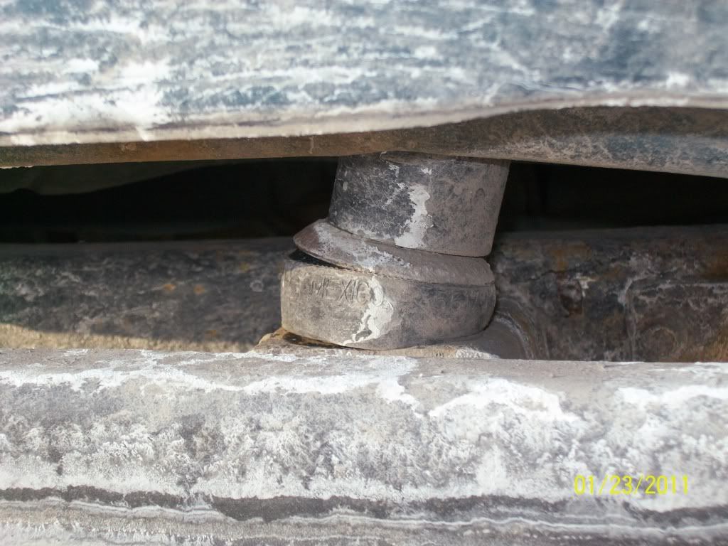

Anyway I "fixed" those problems and in the spring I noticed this-
I was just gonna plate it and wheel but I found a frame on the classifieds on here for $125 that was in a wreck and "bent" so I went to Richmond Va. to get it.

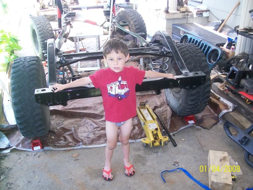

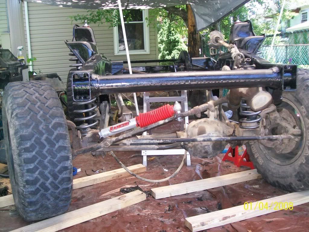

Then I took the axles off the old frame and swapped em to the new frame. I also added a set of RCX 2.5" progressive springs, a pair of 3/4" daystar spacers to the front, and Skyjacker Hydro shocks(for a 4" lift) to the new frame at that time. In the rear I used the Tera Rear Upper Shock Relocation Brackets so the longer shocks would fit. Also put a Ranch SS on too.
You can see how the Tera brackets let your shocks go up through the rear crossmember giving you 1" more uptravel-

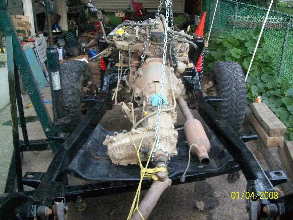

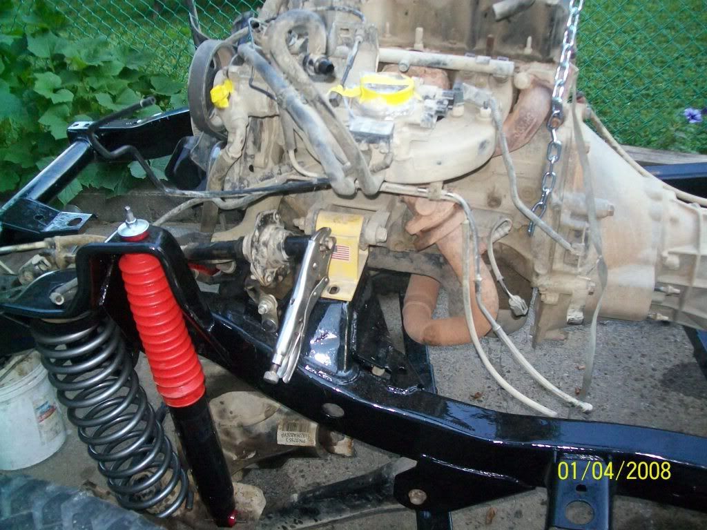

Then I swapped the engine/tranny/t-case over to the new frame. I picked them all up with the hoist and pulled it back. Then I put the old frame down on this dolly thing I ganked from beside the Krogers dumpster
And rolled the old frame onto the sidewalk. Then I pushed the new frame with the axles and tires under it to the old frames spot and dropped the drivetrain in. I had to get a little creative with a peice of rope in order to get the drivetrain to balance right. But I was able to set the tranny mount down on the OEM skid first and then the motor mounts fell right into place.
I had to use a set of vicegrips on the steering shaft to get the frame turned around in the road and my driveway. Adapt and overcome.....right???

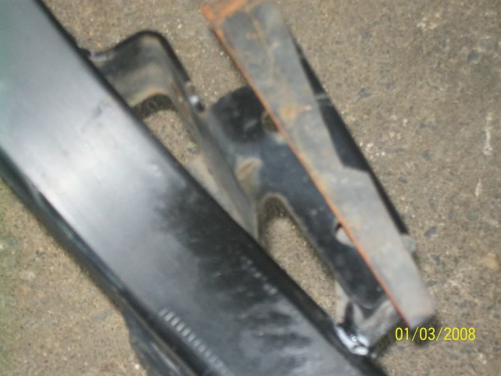

Then it was on to fixing the tub. I'd never done any type of body work before this and I hope I dont have to do any ever again!

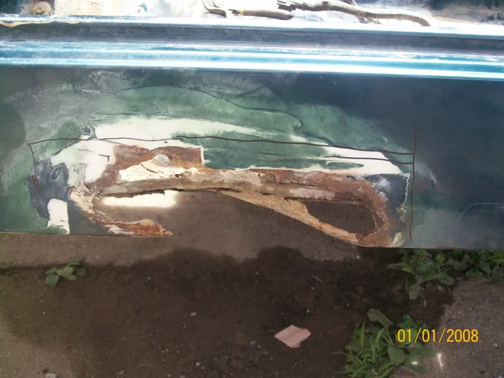

Drivers side rocker panel had a big hole in it so I cut it out and replaced it.
Before:
After:

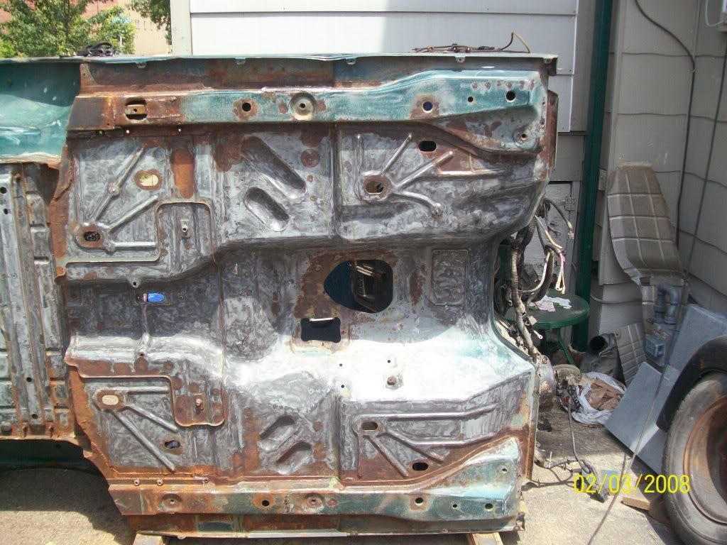

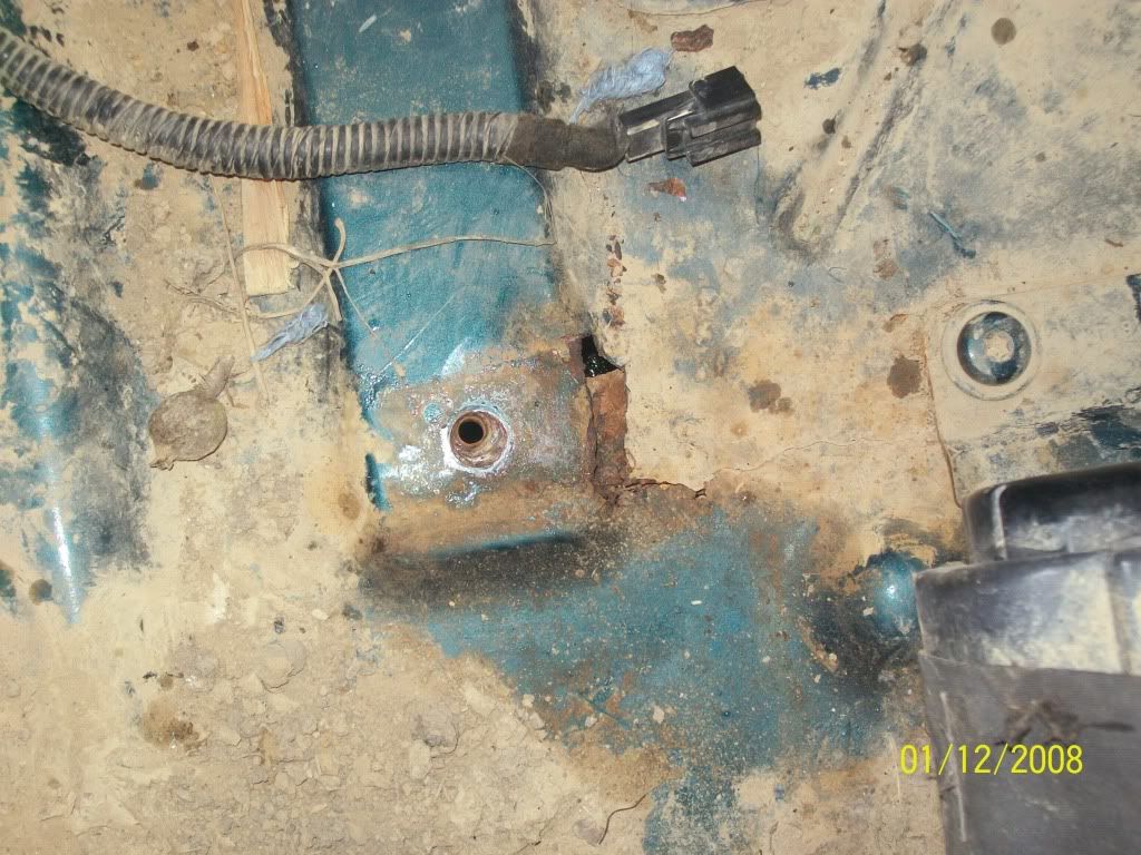

When I pulled the seats out I found a hole under the drivers seat-
When I rolled the tub up on its side this is what I found-

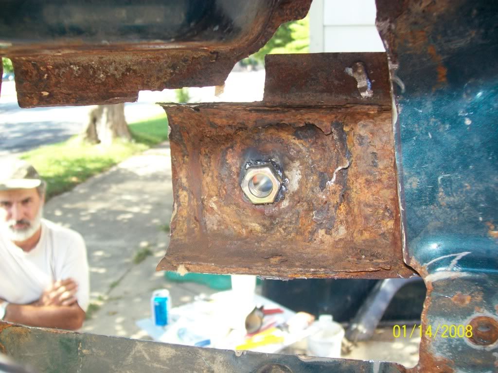

NOT GOOD!!! So I cut the old rust sheet metal out,
welded in a nut for a body mount-
and welded some new 18guage in-
All that took 2 days...

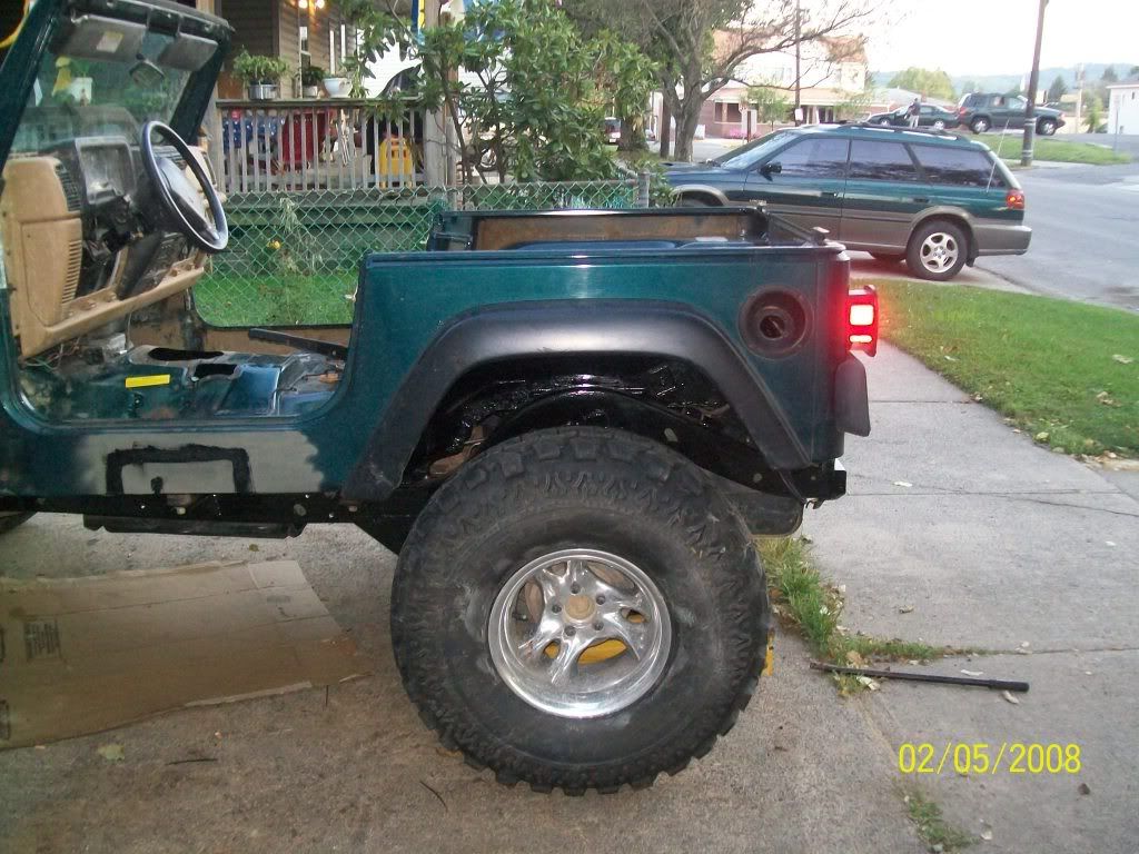

Time to put the tub back on. But first I swapped the gas tank and skid onto the new frame and ran my SS brake and fuel lines I got from Classis tube and Inline tube. After that I called up 4 friends and Dad showed up to "Supervise"-which means he came over to get away from mom and drink a 12 pack or so.
Anyway we got the tub back on and I bolted it down again.
Then I proceeded to put the front clip and windsheild frame back on before dark. This is how far I mad it before it got too dark and dad got too drunk to be around..

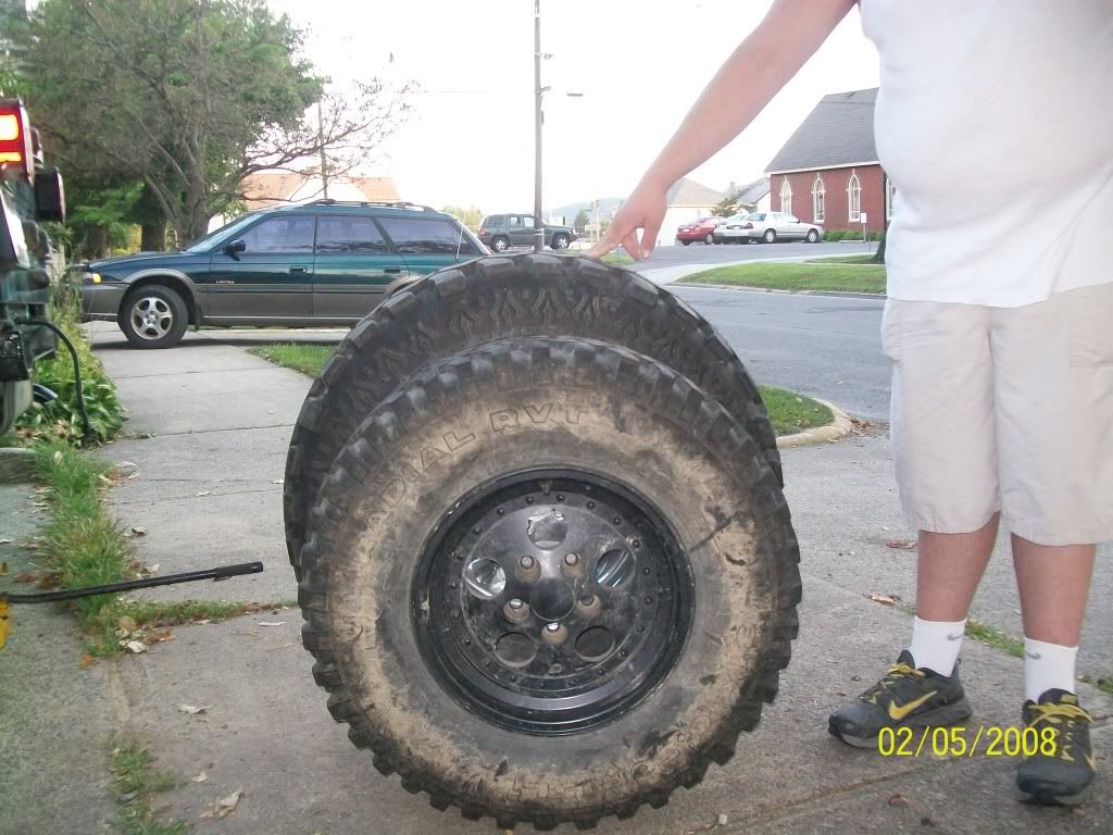

I barrowed one of my buddies 35" Swamper Radials to see if I had enough room for em; I think I got more than 2.5" of lift out of the springs. They were for a 6cyl and I have a 4cyl so mabey I should have....
The 35 in the back,
and in the front.
And a comparrison of my old 31's to the 35" Swampers-

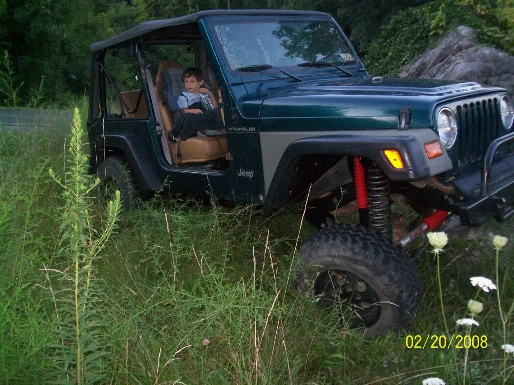

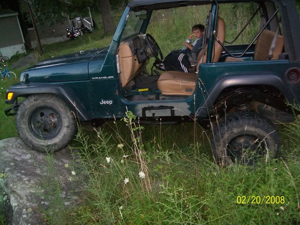

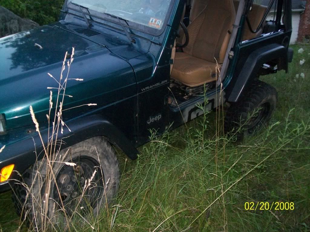

I took it to my great great grandma's abandoned house/yard to test the flex. She has some HUGE rocks in her yard...
Not bad for OEM shock mounting locations, OEM CA's, 10" travel shocks, and 31's.

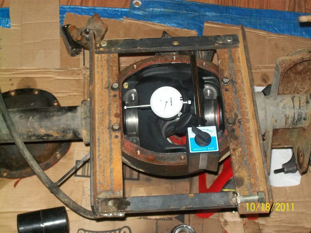

So now Im in the process of installing gears and lockers for the first time. Did I mention Im doing it in my kitchen floor?
I had to get larger bearings for the D30 E-Locker. I called Eaton and Superior and the advised to put the carrier bearing shims on the outside of the bearings instead of between the locker and bearings.
So to to that I had to either buy a case spreader, or make one. I made one-
And while that did work, I stripped the threads of the nut out on my 3rd attempt to spread the case. So I modified my spreader-I drilled a hole so that the bolt could go through the peice of angle and the threads of the nut would always be enguaged, used a 3/4" shaft bolt and nut, and welded some 3/16"x1" flat bar to the outside of the spreader to stiffen it up some.
Works great now.
This is where Im at right now; installing traction aids and gears(in the kitchen) and trying not to screw it up too bad.

I think I've got my gears down. Good pattern, .007 backlash, and 32in/lbs to rotate the pinion. Do I really need to have that inner pinion baffel in there? Im gettin tired of waiting for it...
BTW-its a heck of alot easier to put the shims on the outside of the carrier bearings when doing an E-locker. That way you dont have to keep taking the bearings on and off. I didnt even use setup bearings or any of that BS. just a rubber hammer, calipers, dial indicator, and some "click" Craftsman torque wrenches. Oh and my cheap spreader. Its not as bad as i thought it would be. Just have to make a good educated guess for a starting point.
But the D35 is kinda intimidating(sp?) me. IDK about that crush sleeve....or C-clips. Thinking of doing a rear disc brake swap from a Zj when I pull the rear end....depends on time and avability of parts.

I ordered 2 pinion baffle's, a D35 pinion nut and another set of d35 pinion shims from 4wd.com. Its been over a week but they finally gave me a tracking # so they should be here wed or thurs.
