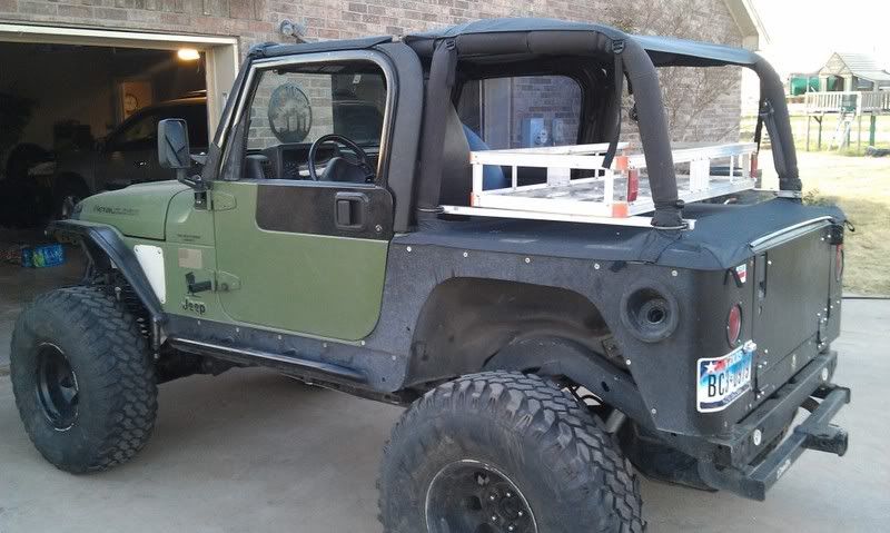

Here's what I did for storage on my last wheeling trip. I had a hitch rack that I bought from Harbor Freight for $59.99 lying around in the garage. All I did to mount it was purchase a piece of aluminum "angle iron" from Lowe's for about $10.00. I attached the aluminum to the factory cage with 2.5" exhaust clamps. Then I just bolted the hitch rack to the aluminum. It offered a ton of storage and the tire still fit beneath it and it's easily removable. I love the look of those other racks you posted pics of but my redneck version will work in a pinch:

Even that Harbor Freight one is $100 bones now (on sale from $130) -
http://www.harborfreight.com/automot...ier-92655.html
I'd also want something that isn't crazy hard to remove in the unlikely event I wanted to get my spare out, which honestly has never happened... 1 blown bead that we were able to reseat and I carry a puncture repair kit that I've had to use on the street before. A sliced sidewall would be a crappy end of my day if I wasn't carrying a spare.
I may stick my spare this evening in there and see what my options are for height... My ActionPackers and my Quart Crate will be here this week, so I'll get a better Idea of what I'm working with for space.
