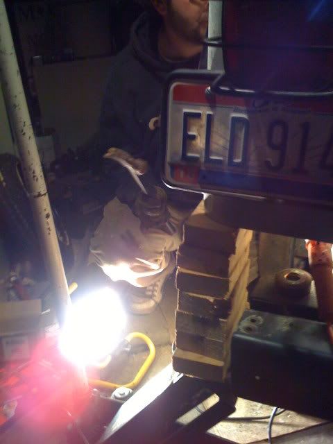

I undid all the body mounts all the way to in front of the doors...I then jacked it up (granted it may not have been the safest thing I have ever done) with some 2x4s stacked on top of each other and screwed together.
I'm still alive with all limbs intact...so I guess it wasn't that bad
