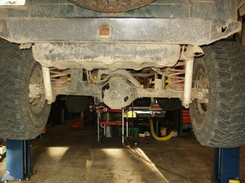

I just looked through the pics you have posted,
I don't think I'd be able to make a bolt on shock relocation mount for your axle since the lower arms are not OEM type mounts. The weld on high clearance mounts I use will work and gain clearance.
these are what I made for mine and several others I've installed
