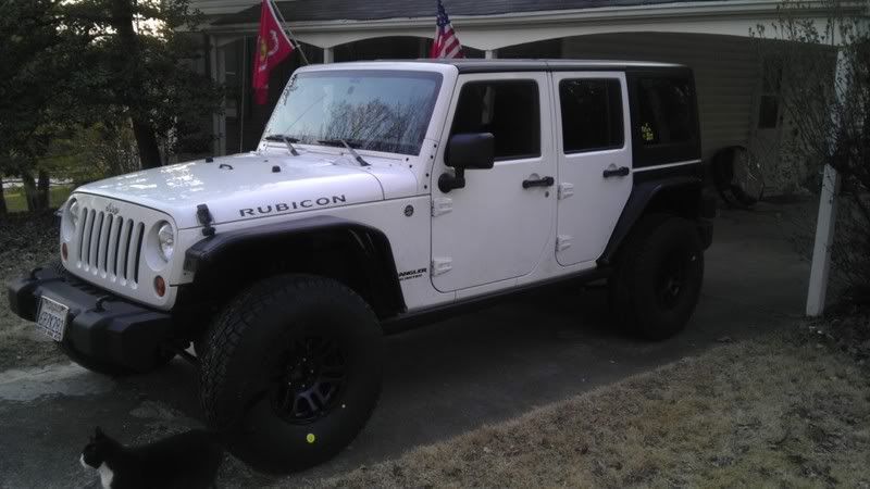

Looks great! I'll let you know how 37" Toyos look as soon as my MC fenders get here.
Awesome. Be sure to post pictures. 37's might be my next set of tires.

Looking really good man! If you want 37's at some point, definitely go ahead with 5.13's (manual) or 5.38's (auto.) Have a look at River Raider for skids, they come in multiple pieces like you're looking for but shipping may be pricey to the left coast. I'd also take a look at Evo's rockstars and skids for your control arm brackets.

Very nice . that's the way I want to do mine. Did you extend the bump stops?

Currently I'm on stock bump stops. However, I'm confident that my tires will not make contact with my Fenders. I'll flex it out tomorrow and take pictures.
