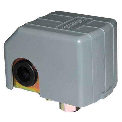

You're going to need a pressure switch so the compressor knows when to engage and disengage to keep your air supply going. I nabbed this guy at Lowes for $21. It comes set for 30 PSI on 50 PSI off, but you can crank it up to 200 PSI.
http://www.lowes.com/pd_74036-15649-...tch&facetInfo=

The manifold splits off in 3 directions. One goes to my pressure switch and blowoff valve, which are connected via a T:
