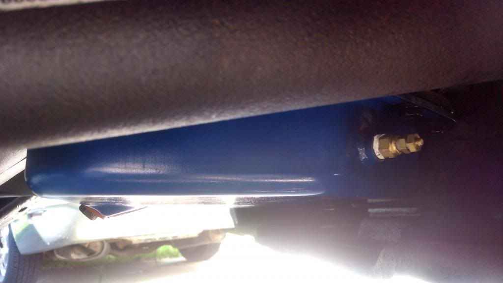

MOPAR Deep Trans. Pan (Holds 2 extra quarts of ATF)

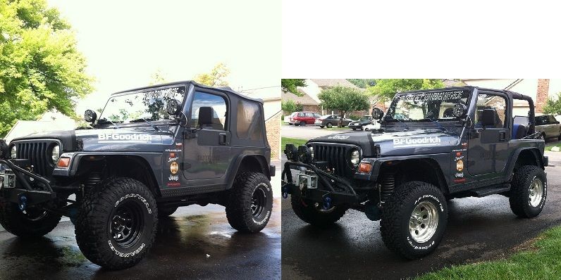

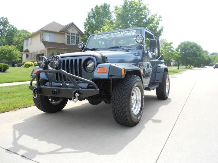

What she looks like presently: 6/26/14

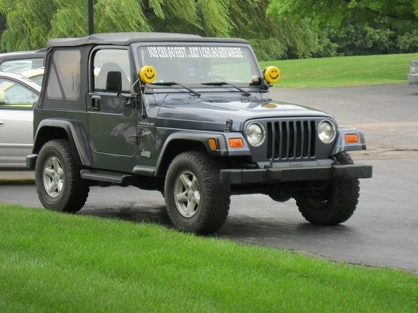

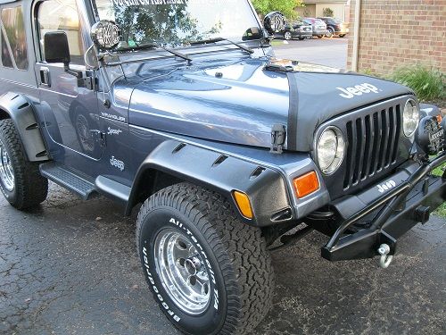

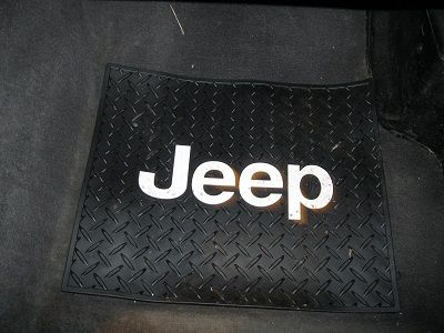

First thing I did with the Jeep was purchase some blue seat covers, slush mats, and Sony Face plate Radio with all around Pioneer Speakers. However I have since removed the seat covers and put on a matching blue water proof set I got off Amazon in both the front and rear and relocated the "Jeep" slush mats to the back and put some tougher ones that cover the entire floor board up front.
I then went to the local off road shop "Mumblys" and purchased some KC Fog Lights and added a decal I made myself.

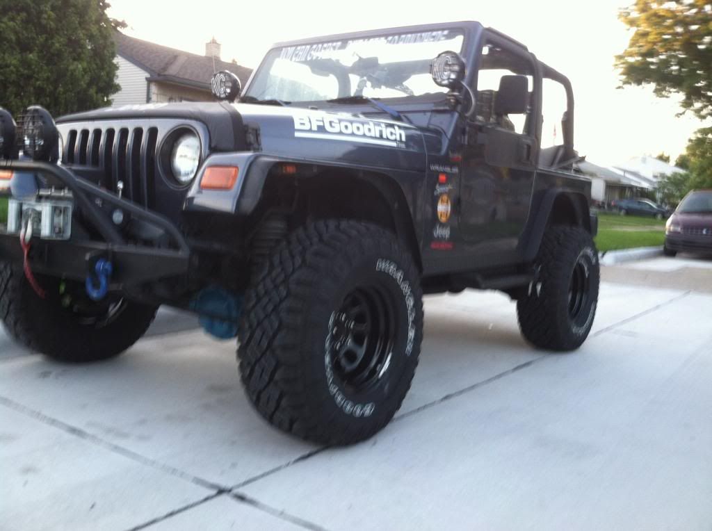

It was then time to get myself some new meat, I had always liked the BFG A/T tire and since it was my DD I wanted something that provided performance on/off road that wouldn't affect the mpg much. I stuck with the 31" BFG A/T tire and got all new 15x8 Classic II Aluminum Rims (Which I later sold because aluminum doesn't hold up well in Michigan, or on a Jeep period).

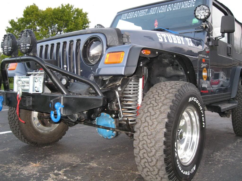

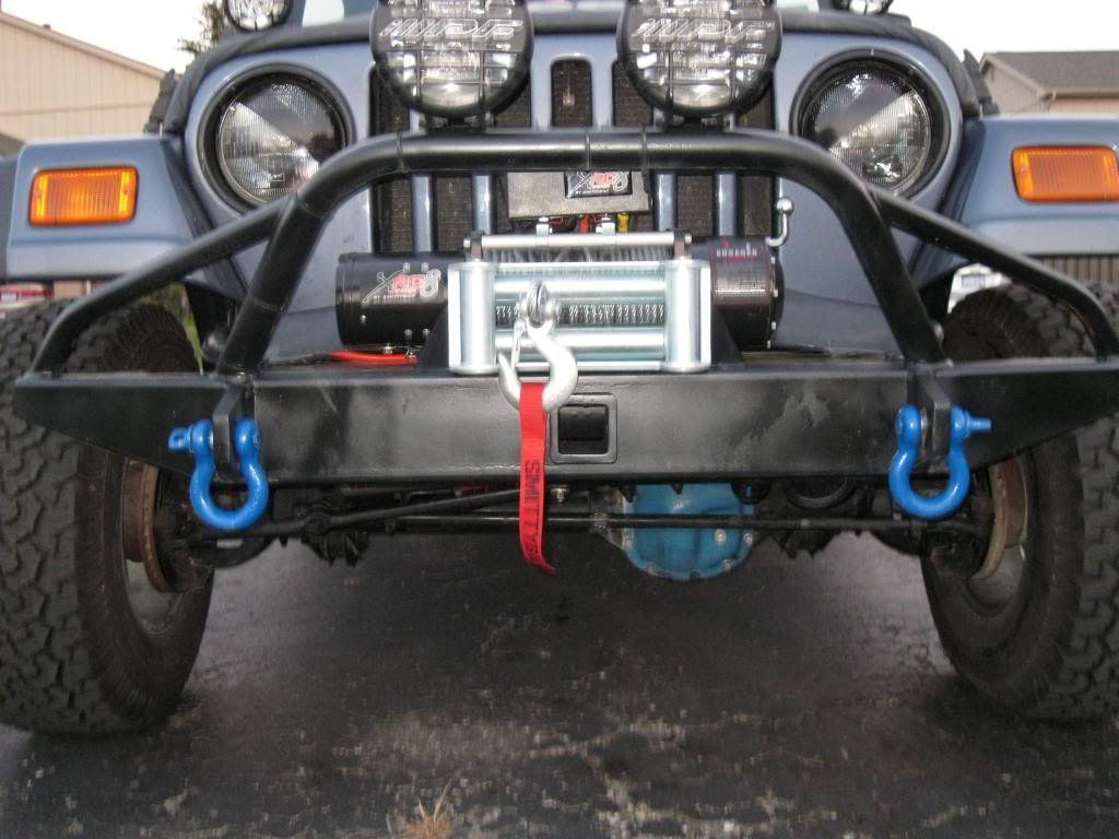

As you can see, I also purchased a new front bumper as well. I went with JCR since I had heard they did some really great work. This is the JCR Pre-Runner bumper JRC provides and I specially ordered that they added on the D-Rings, Winch Plate, Light Tabs, and Front Receiver for future uses. I also added on the PIAA Extreme 510 Fog Lights to the bumper that I ordered from Quadratec.
I added 1.5" Wheel Spacers to the Jeep to add a bit of stability and took the fenders off and painted them. (Note that later on I would remove the spacers completely).
I then added Bushwacker pocket fenders to the Jeep and a Jeep hood bra. (Both have been removed, the fenders were due to less room for articulation which I learned very fast when I took it off road my first time and cracked the front passenger side one, and I removed the hood bra because well...I decided it looked much better without).
I then tinted the headlights for that "Angry Eyes" look but again later removed because I didn't want to copy everyone else.
Me and the Jeep, summer of 2011

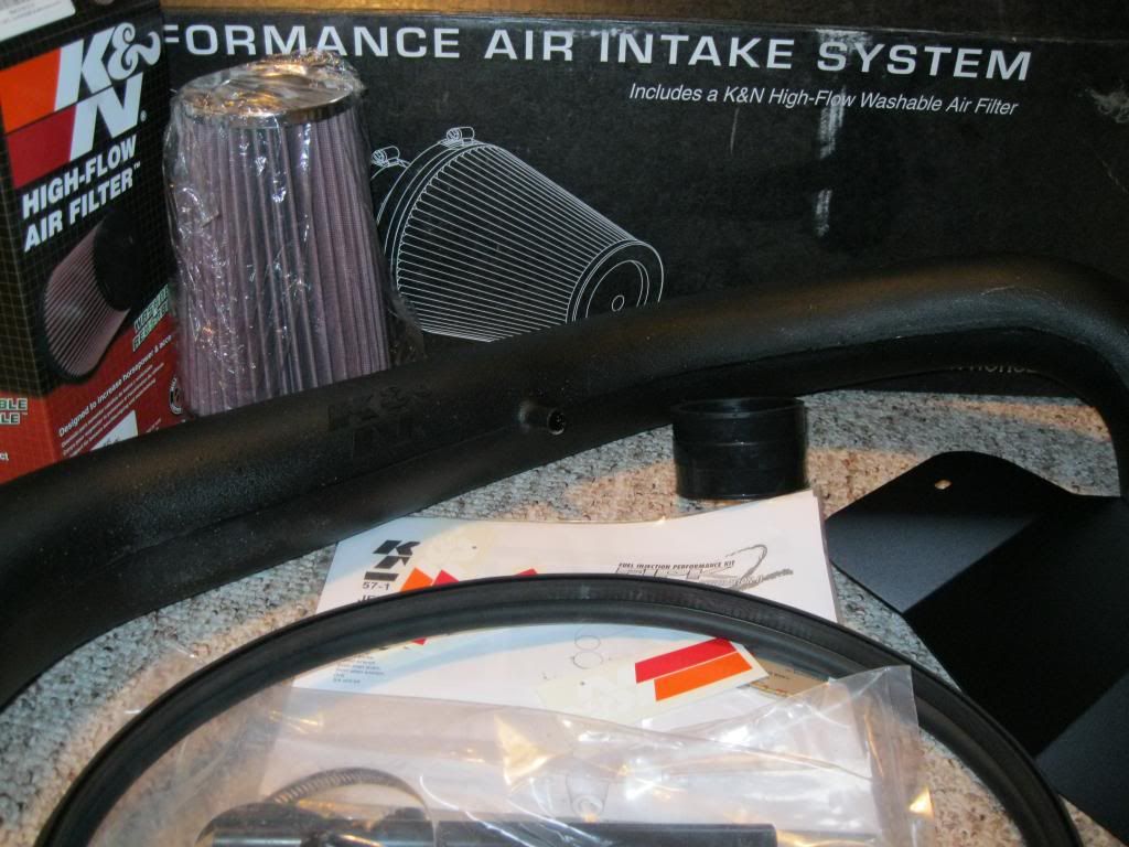

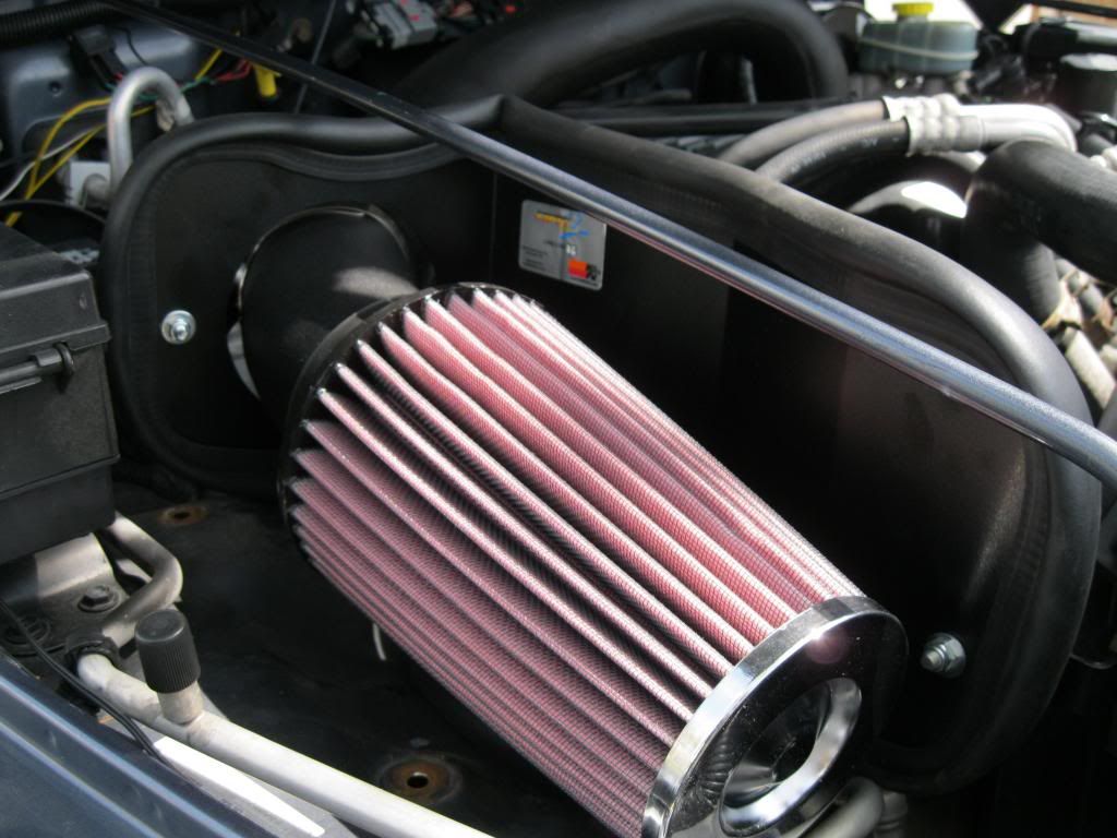

I next decided to go with a cold air intake, my choice was the K&N Cold Air. I later learned that the Cold Air Intake can actually be more harmful that good due to the dust particles it lets in. I inspected my throttle body and found that it would get dirty much faster with the Cold Air on than stock. I thought I'd at least test one more thing and have since put a K&N Drycharger Wrap on the filter and since then the throttle body has stayed spot clean.

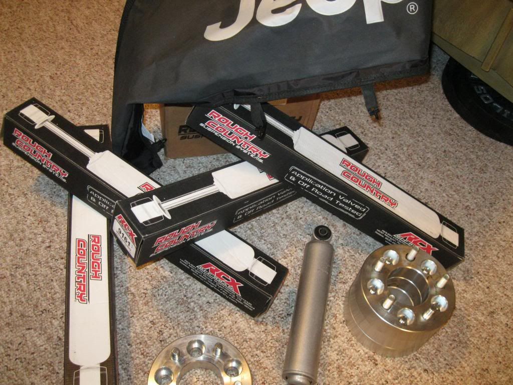

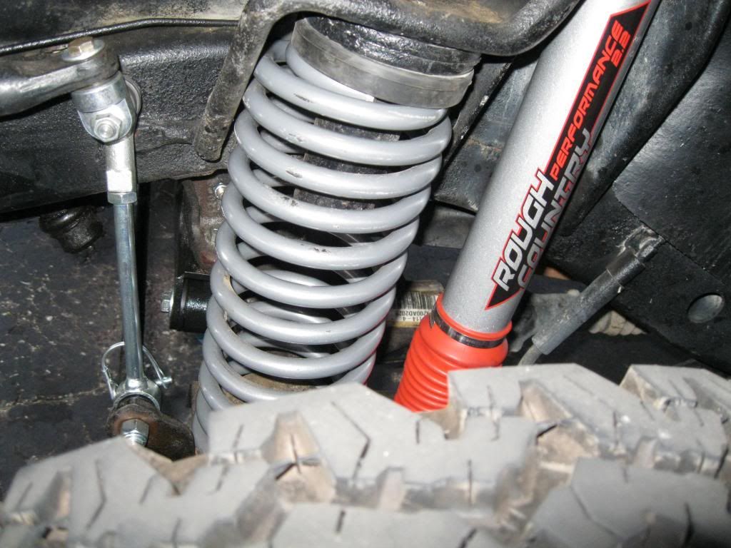

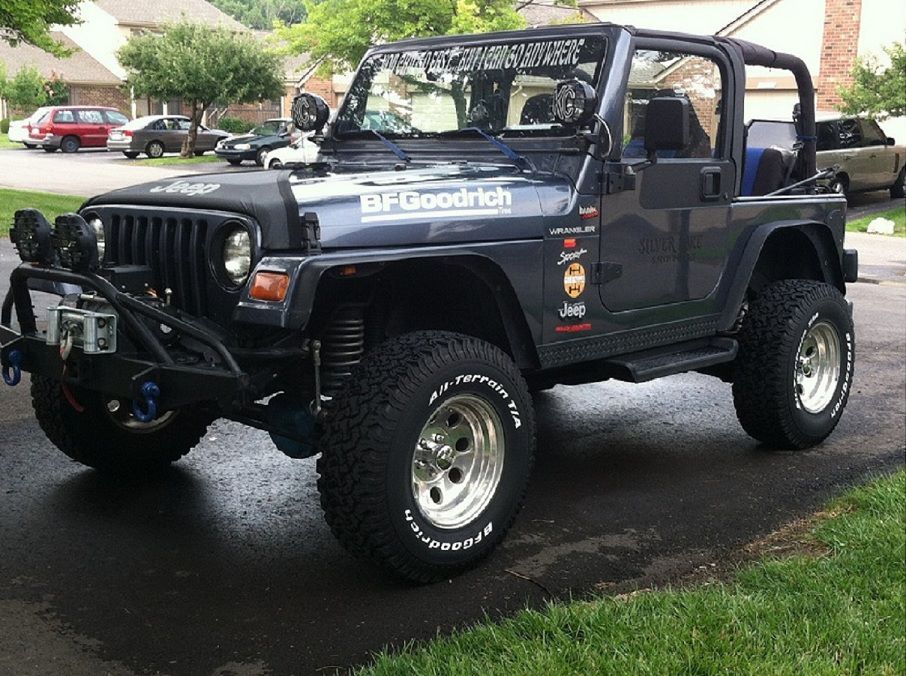

So after saving up for a few months, it was finally time to put a lift kit on the Jeep. I didn't have to much money to work with at the time but I wanted some more height. When I had taken it off road a few times prior, she had hardly any room for articulation and I felt nervous I'd smack something on the under body. I then purchased Rough Country's 2.5" Suspension Lift with the 2.2 Performance Shocks. I also ordered the RC rear track bar relocation bracket, front adjustable track bar, and quick disconnects. With that also came a Smittybilt XRC8 Winch and I added some paint to the front end as well. Added Bushwacker Rocker Panel Guards and painted the top half of the doors with some truck bed liner. Also added a "Silver Lake Sand Dunes" decal to the drivers side door that I had gotten from Silver Lake MI.
(I have since removed all Rough Country products from my Jeep except the quick disconnects, rear track bar relocation bracket, and sliders which I purchased at a later date because I'm sure as many of you know, RC is GARBAGE).

2013 came and it was time for some more upgrades. You will probably find in time that most of my upgrades are installed in the beginning of Summer. Pretty much I put away money for the Jeep all year in a separate account, and once Summer rolls around and its nice enough to work outside, I go on a Jeep purchasing frenzy. So for the next week or so, my front door is lined with packages like Christmas
The Jeep was startin to look pretty good, but she still needed a lot of work to get to where I wanted it. Spring had arrived which meant more Jeep parts and new opportunities. The lift kit had been on for a few months now and I was beginning to learn that I really didn't like Rough Country. Soon I would be upgrading...

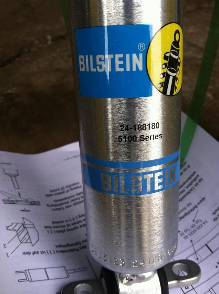

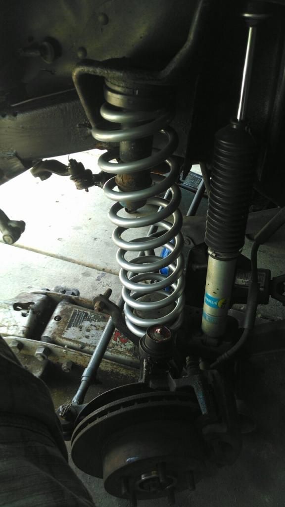

With the lift kit performing like garbage, I upgraded to all around Bilstein 5100 shocks...these things are AMAZING, I would recommend the Bilstein product to anybody.

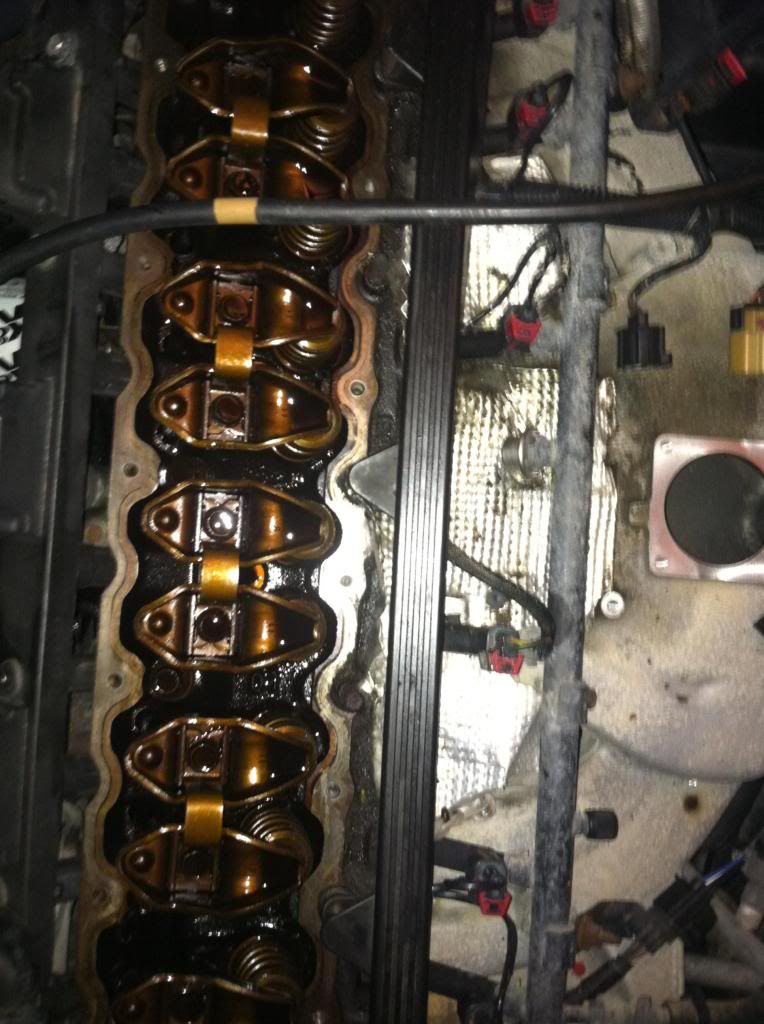

I had noticed that the Jeep had a few oil spots on the ground after I had let her sit for awhile. I inspected and found that the valve cover gasket was leaking so it was time to pull the valve cover off for my first time and replace it.
I do not have pictures of everything I had replaced/upgraded on the Jeep simply because at the time I replaced/upgraded parts I didn't think I would be making a build thread down the road. However, I believe it was around this time I had replaced many other parts on the Jeep such as all around brakes, fuel pump assembly, all of the sensors on the Jeep, a good variety of gaskets, ignition coil, starter, battery, ect, ect...

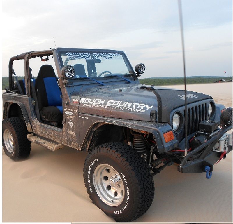

Here's a shot of the Jeep at Silver Lake Sand Dunes last year before her major makeover...

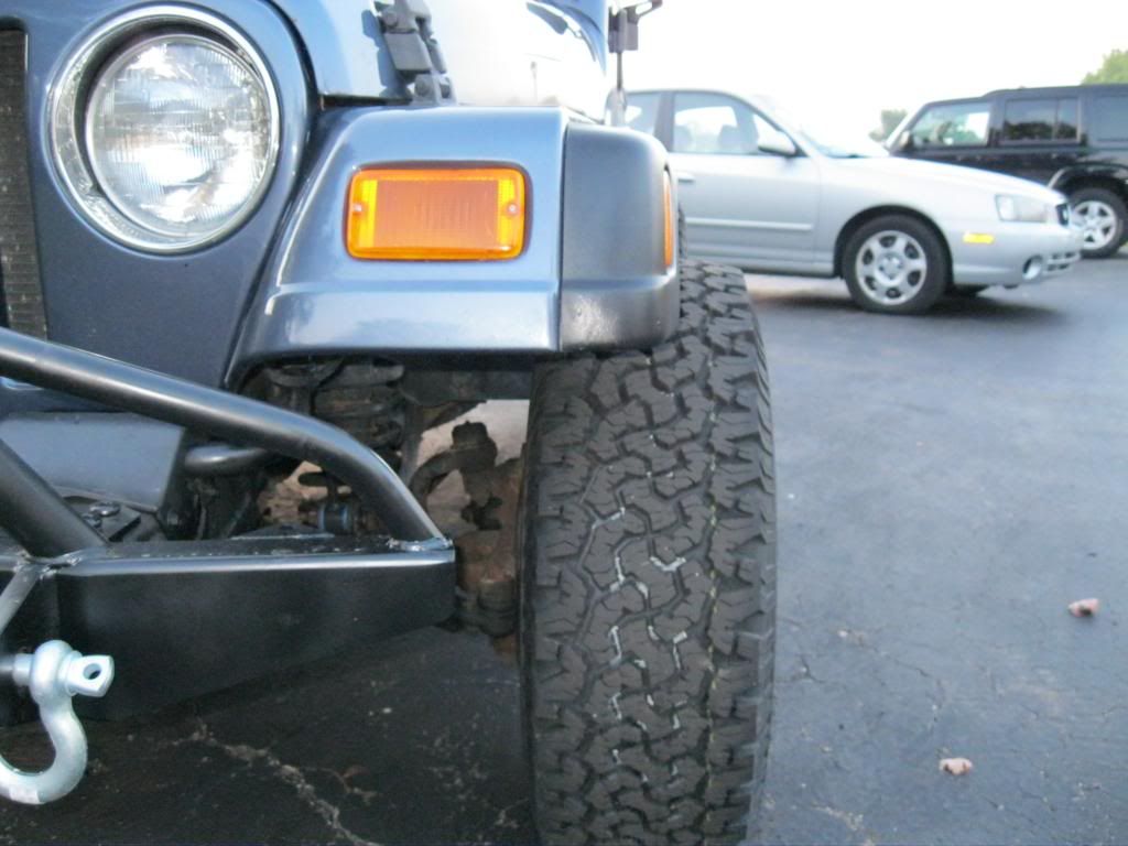

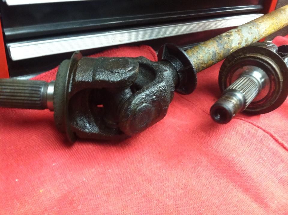

I had started to notice a clicking sound coming from my front end wheel well, I inspected the axle shaft U-Joints and found they were worn. I replaced them with some Moog U-Joints.
At this point Summer was reaching it's end and I really didn't want to worry about my aluminum rims taking salt damage anymore. I was also itching for some bigger tires since the 31's looked kinda small on the Jeep. So I sold the tires that were still in excellent shape and threw on some poop tires until a found a pair I liked.

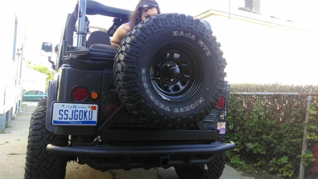

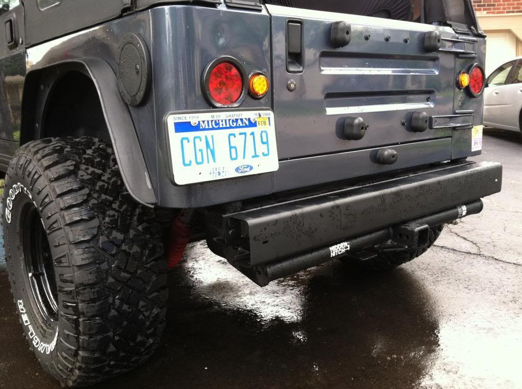

And this is from last weekend, got myself the QRC Rear Tube Bumper with Oversized Tire Carrier that Quadratec personally offers. It's a great design and wasn't a bad price, also came with a 3 year warranty. I also got myself a 33" Mickey Thompson Spare that I found for a good price brand new.

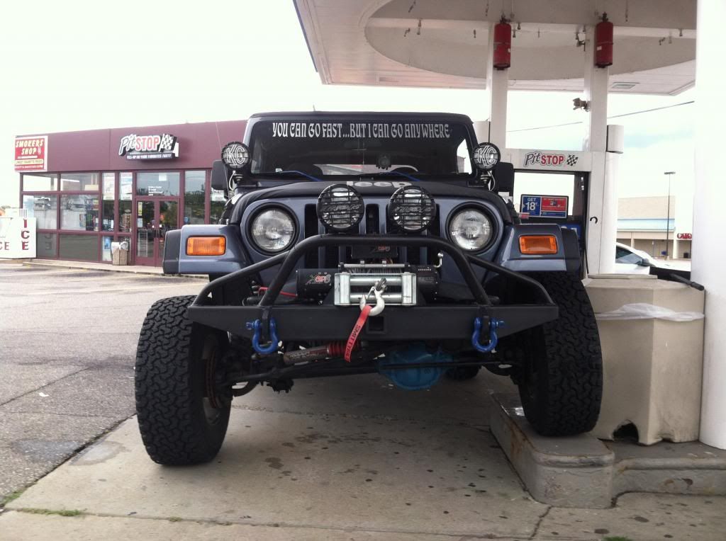

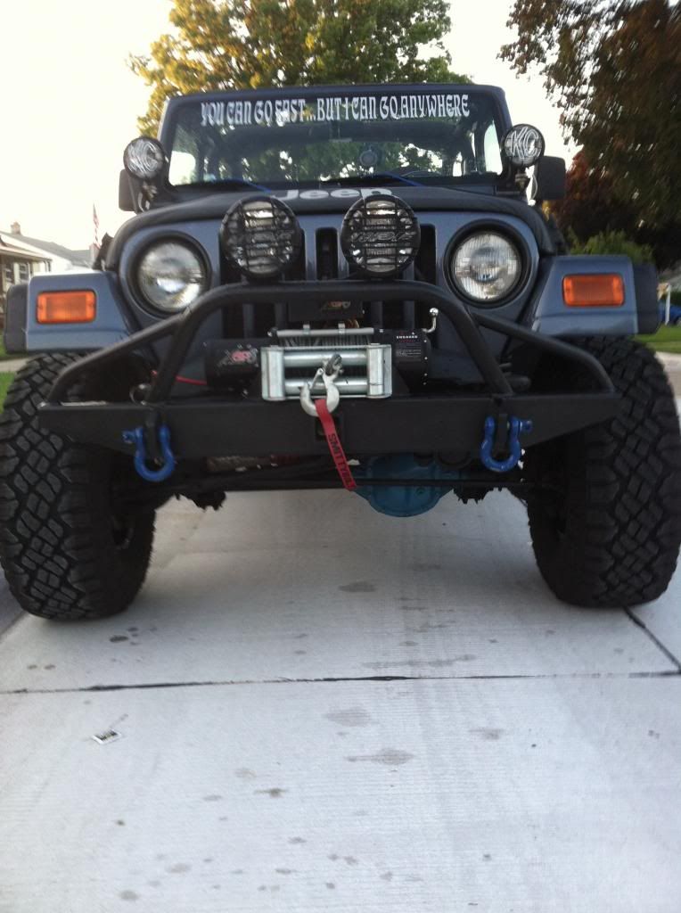

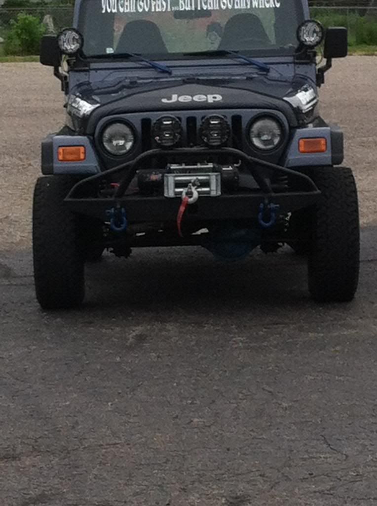

Here's a shot of the front end finally completed after several cuts and bruises

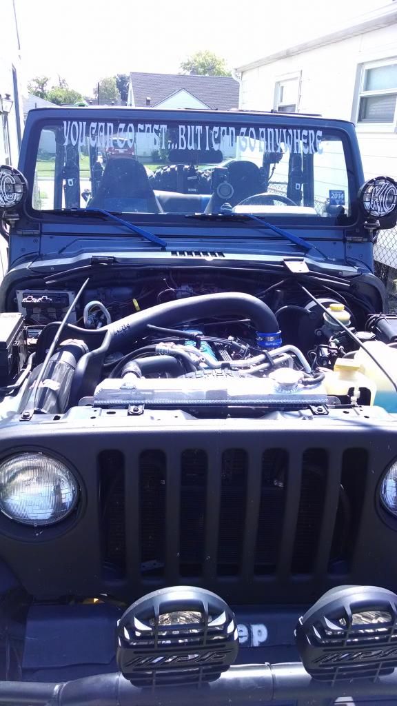

Under hood shot...very clean

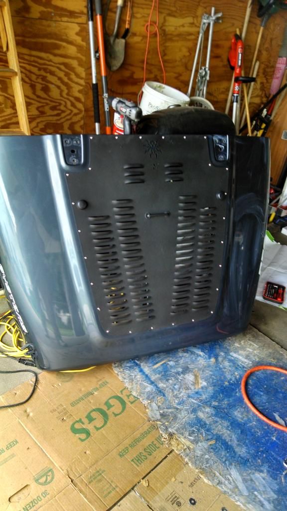

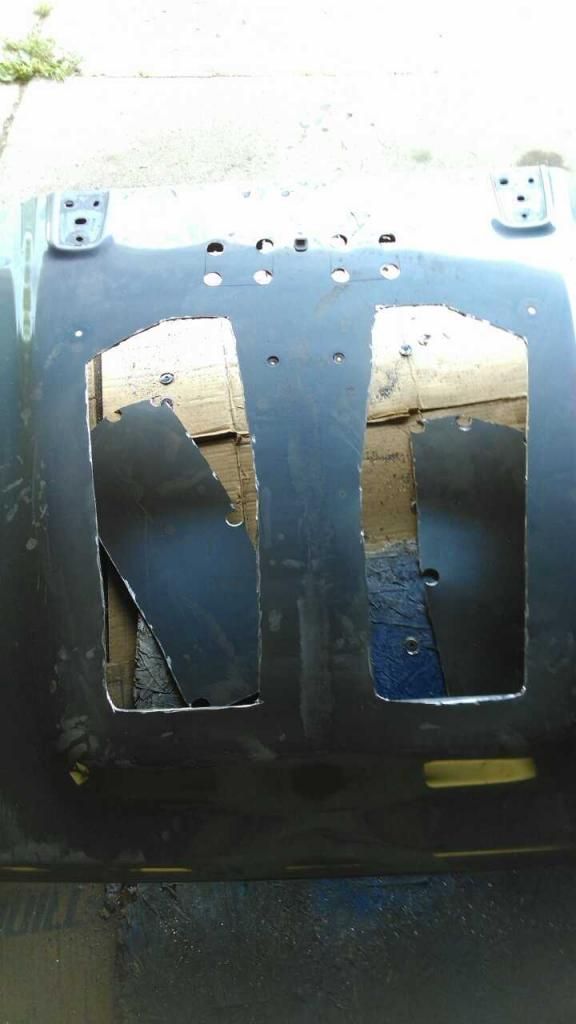

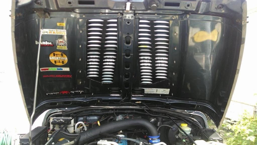

Here's picture's from this past Saturday morning. I installed the Poison Spyder Hood Louver on the Jeep, I think it turned out pretty good! Installation was fairly simple since Poison Spyder sends you a template that you just place over your hood, mark the holes, connect the lines, and cut. Most difficult part was using an angle grinder but even that was a piece of cake, and it was my first time ever picking one up
Removed the hood, no problems here:
Hole's drilled with a 1" Hole Saw and connected with a Sharpie Marker:
Cut the lines I drew with the Angle Grinder, had to put gloves and pants on cause my hands and legs were getting burned from the sparks:
Installed the Louver, this part took a little bit of time due to all the bolts but was still an easy process:
Installed on the Jeep:
Under the hood with the Louver installed:
The job took about 2 hrs total by myself, wasn't all that much to it. Even though I've only had it on for a few days I've already had the chance to test it. I have a temperature senor under the hood to monitor under hood temps. Before the louver was on, on avg the temp would sit at about 160-170 idle. Now that the louver is on, it sits at about 100 idle, HUGE DIFFERENCE. It also down poured here yesterday and when the storm was through I looked under the hood and the compartment was still dry.
Note: I also have a cold air intake and it may sound crazy but it feels like I have a bit more pick up now. I think this may be because the hot air isn't trapped under the hood now so the intake is actually sucking in "Cold" air now instead of "Hot" air which makes a difference.
