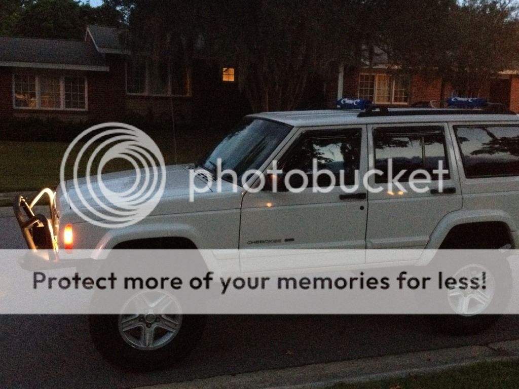

Build looks sick so far.. Looking forward to seeing that bumper installed .. How the headlites holding up? Leaning towards to ordering a set

Headlights are great man, such a clean beam pattern, totally worth the pattern. 2 things. Defintily order the upgraded harness (super easy to install) and when you order the housings. i really recommend the rampage ones. they're are two options. with bulbs. (i got that option and they are plenty bright and clear for me) or you can get just the housings without the bulbs for like 30 bucks cheaper. and get the ipf fat boy lights which are un godly bright. 80 bucks more though.

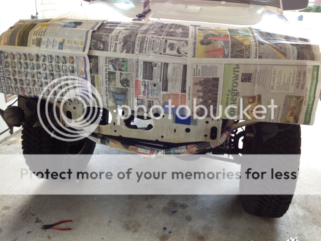

Lots of updates. only like 20 minutes to get it in though. I'm at around 800 miles on the stroker and its getting better and better. im still running 10-40 dinosaur oil and it's wonderful. A week or so ago i did my first oil change at 500 miles on the new engine. Here's a video of the results. also, a teaser picture

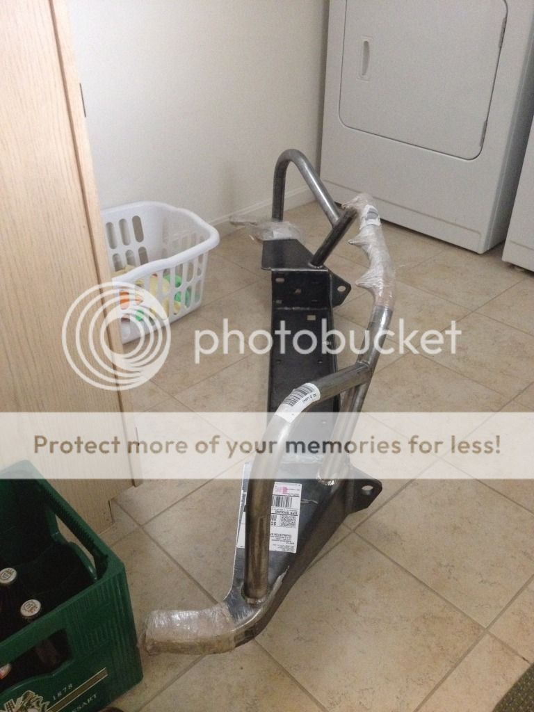

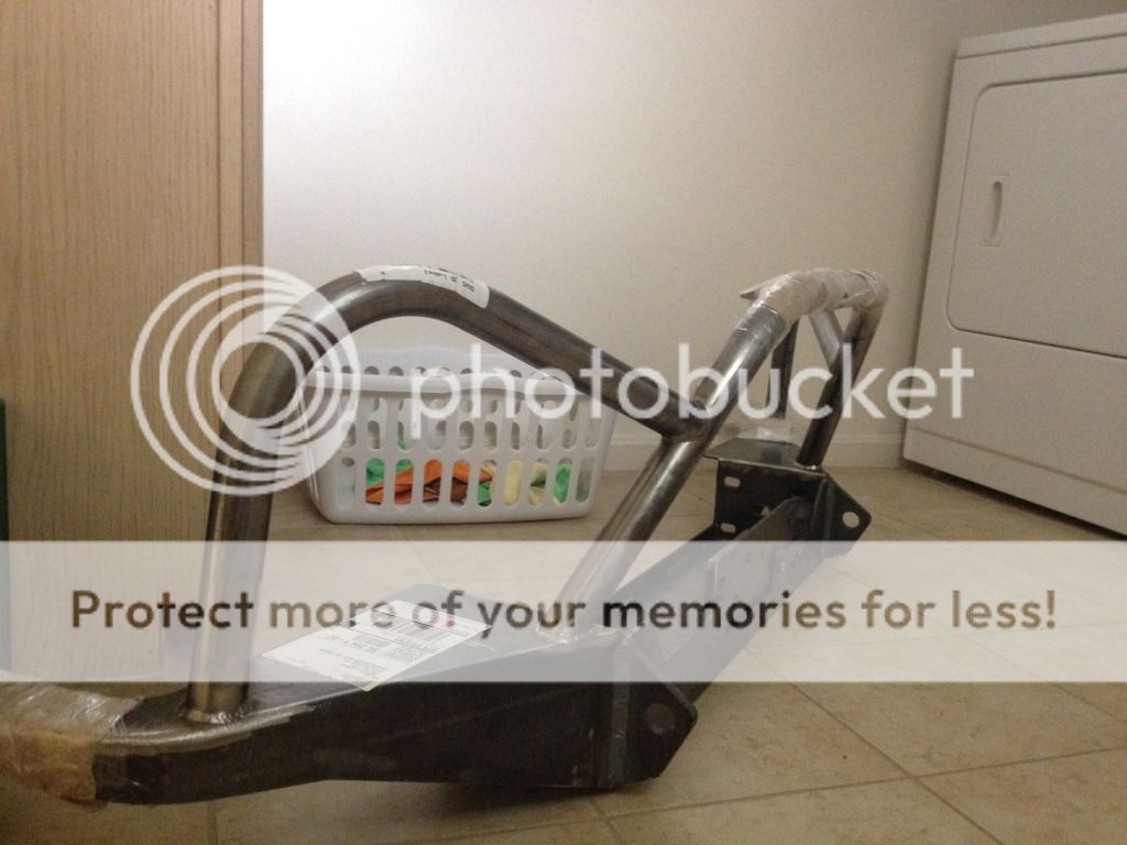

Location: Charleston
Posts: 585

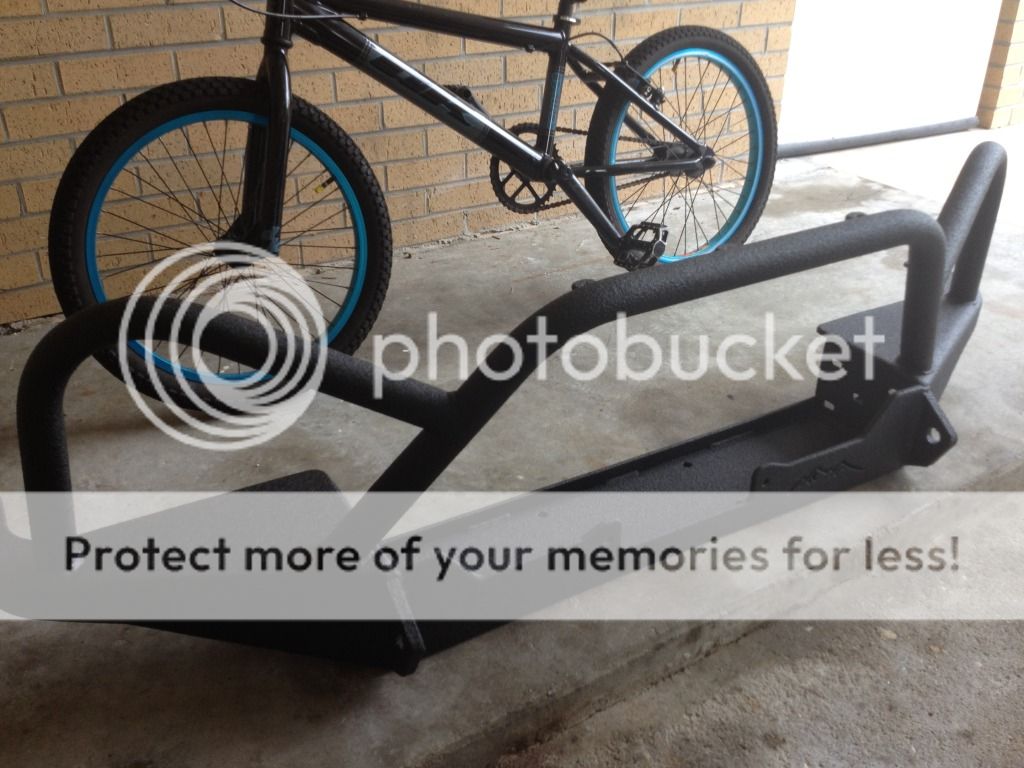

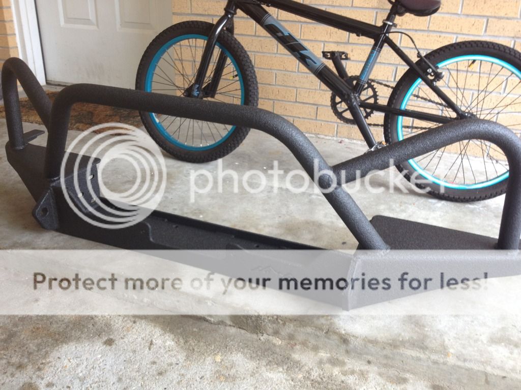

and some more detailed pictures of the bumper before it gets line-x or powder coat. im not sure yet..

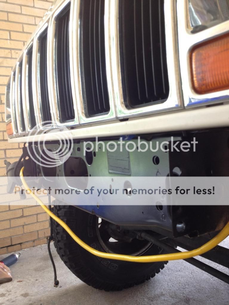

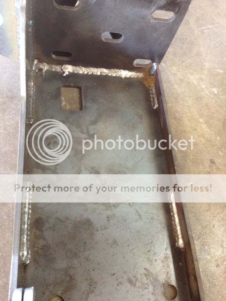

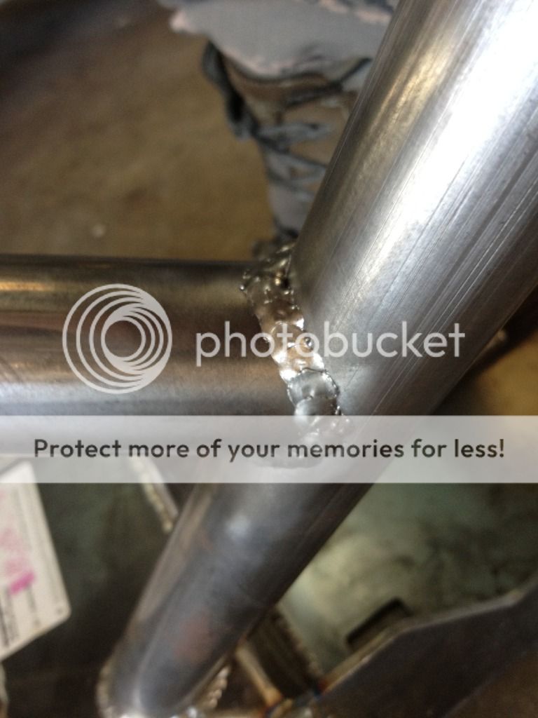

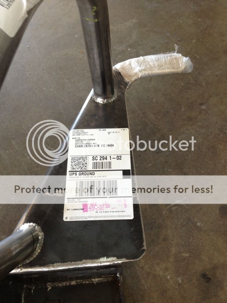

So the bumper is on now, but of course i ran into some hiccups. Apparently Dirtbound offroad hired a new welder last week (when my bumper was built) and i got the short end of that stick.
I will give credit to max (owner of dirtbound offroad) for being very helpful, fast responding, and willing to do whatever it took to make it right. However

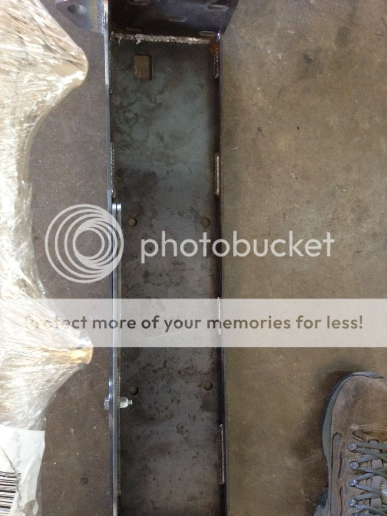

Here was the issue. This gusset was suppose to be welded flush with the bottom surface seen in the picture So since it was welded about 3/8" to high. The bracket wouldn't fit inbetween. i thought maybe it was the line-x fault. But When i sent him pictures via email he confirmed that it was infact an issue with the weld.

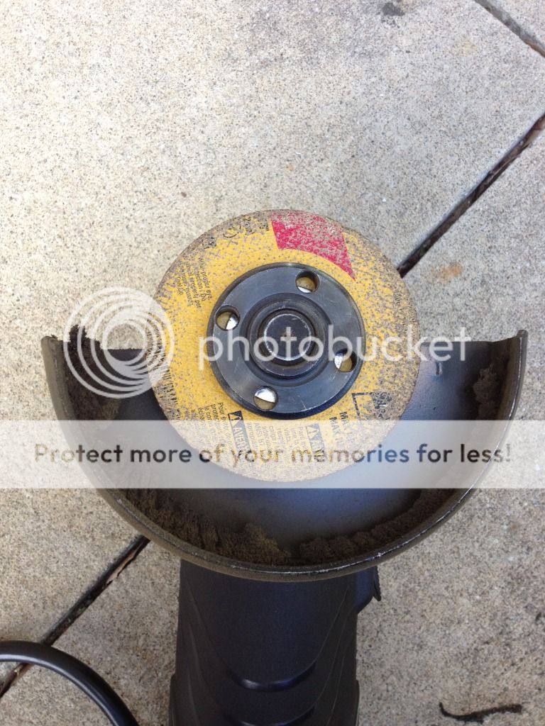

So he suggested that i take an angle grinder and cut off a small bit from the top and bottom. which bummed me out, because it was all freshly covered in line-x. But it wasn't anywhere it could be seen anyway. so whatever. i did, and it fit.
I was on my last cutting disc though lol, and i refused to make a trip 8 miles for a 45 cent part.

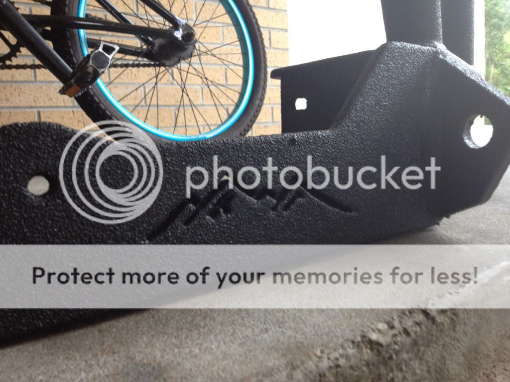

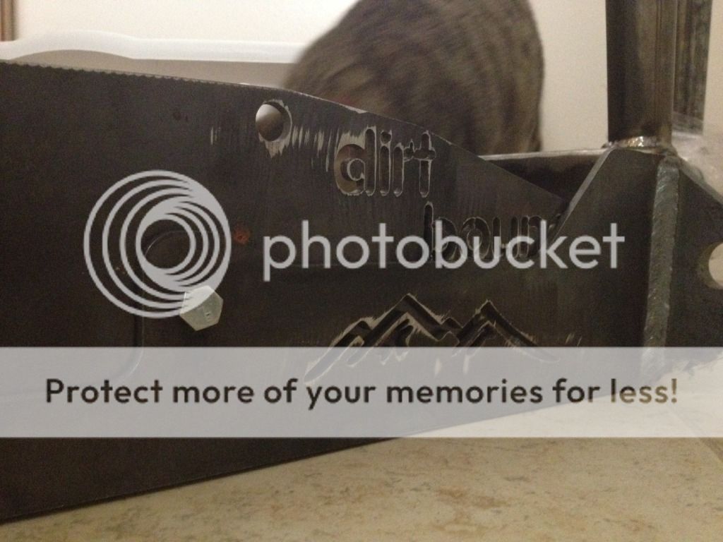

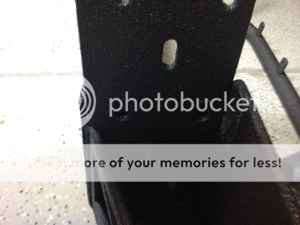

I Took lots of pictures before it was line-x'd so everyone could see details on the dirtbound offroad extreme winch bumper.
POST LINE-X
Detail of the Cut out

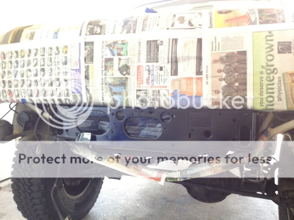

The cross member was white, and when i mocked up the bumper it looks atrocious behind it.
So i taped that ish off and painted it. I LOVE KRYLON FUSION!!!!!
So far the front end feels much tighter. IMO

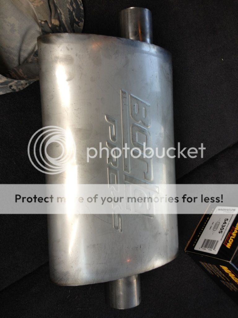

went to the muffler shop the other day. Bought these off jegs. Dropped it off to get them installed and i get a call. "hey we cut out your stock cat, and ahh.. this one jegs sent you is the wrong size. gahhh, so i ended up spending 125$ to get the muffler welded in and the cat deleted. fml. whatever. it sounds epic now.
It's not overbearing while driving like my flow master 40 series i had on another 6 cylinder.
reves up really nice and im really glad i went with borla.
For the record. i did not buy the borla cat back (around 500$)
instead i bought the borla xs with matching specs to our muffler. for 95$ (same item number)
and i just used my stock tubing because it wasn't rusted. I will upload an audio clip soon.

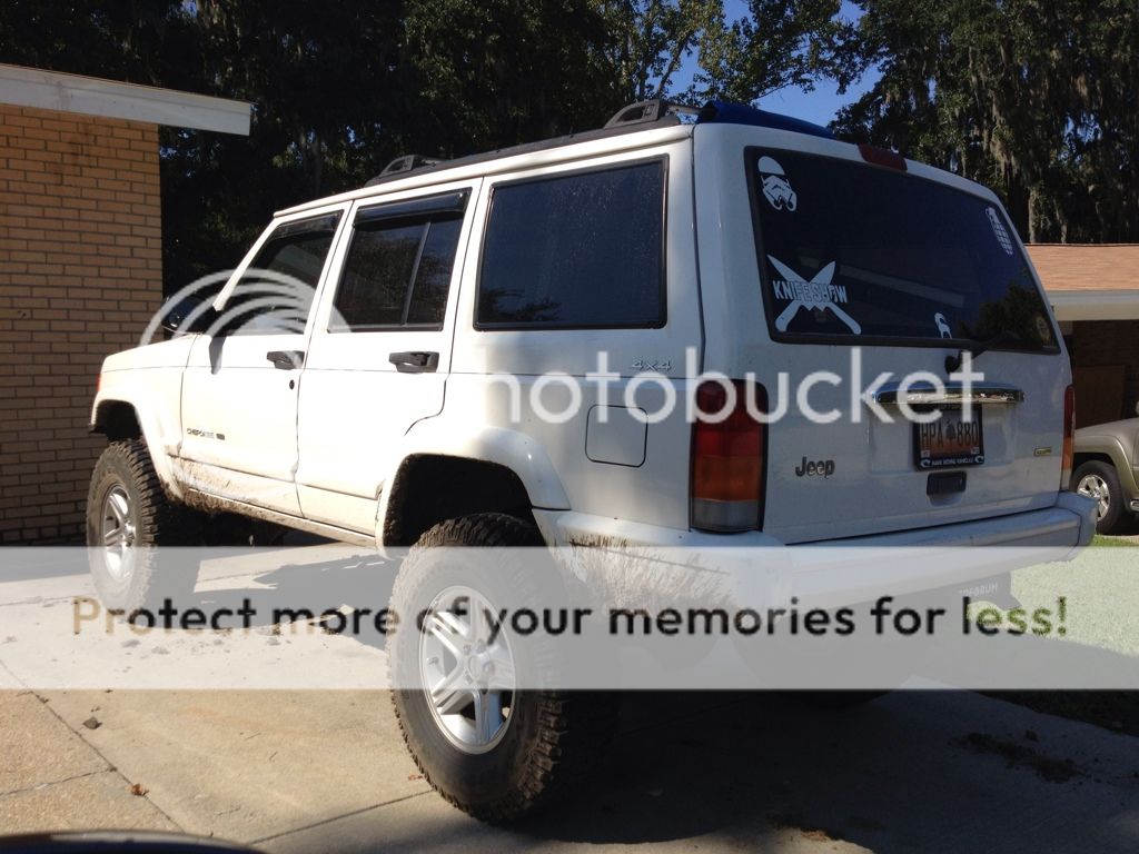

First offroad test since the motor swapped. This thing is a f#cjing monster

There are a lot more creeks inside now, for some reason my headlights only work on low. And the rough country drop brackets have "self tapping" hardware for the trusses on them. And they feel loose. They make knocking noise when I'm off road which I don't like. I think I might get them tacked to the frame. Thanks for your interest
