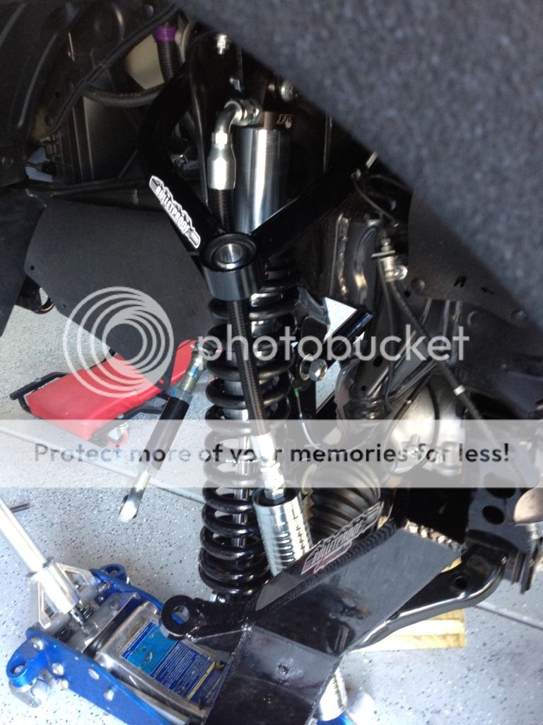

Checking all the others, I was reaching up high to the old uca spot to check the drop brackets bolts for tightness accidently arced the starter i need to replace the lower tranny fluid cooler line anyway since i had to cut the fitting off when i put in the csf 3 row anyway and damaged it.
picture of the drop brackets and whatnot for everyone else to see

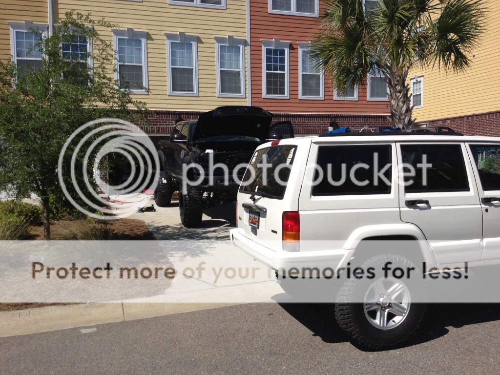

of course i go out of my way to park next to stocker's i see on base. Especially when they make more money than me
And the vibes were pretty Freakin Epic in a whole variety of speed ranges.

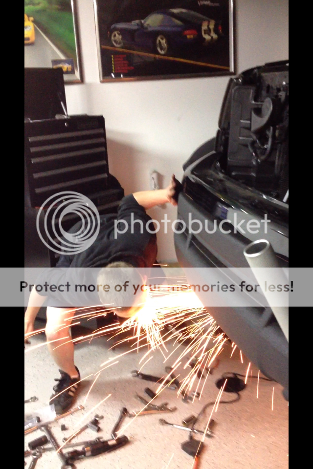

Second, When your buying that. Buy the two Cut off disc. FOR METAL. they are like 1.30 each. Buy a few incase your a twitchy twicther and end up shredding a disc into your face like so.
Yes that is me. And relax mr safety. He was just smoothing some bumpstops down on his fancy pants toyota. My eyes were protected.

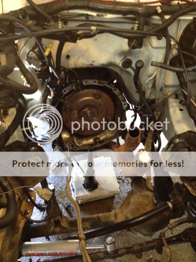

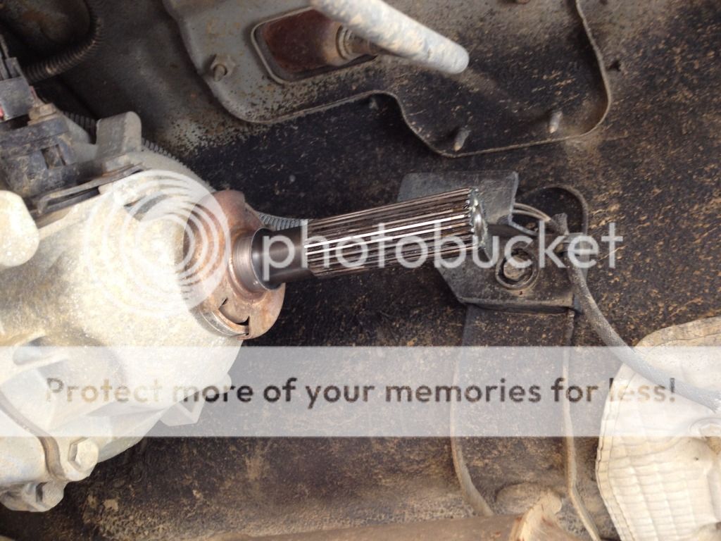

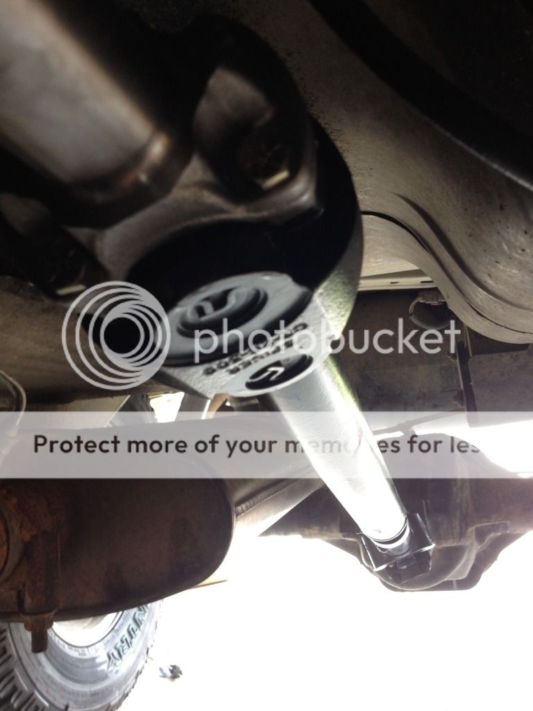

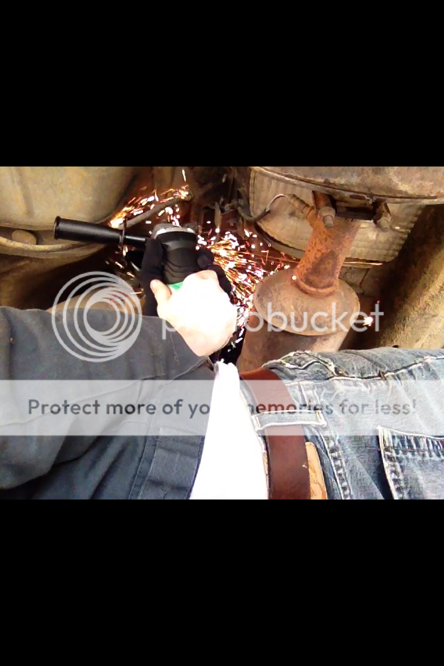

So, You disconnect your Stock D/s Down at the Rear axle pinion. 4 bolts. Pull the little brackets off and keep them safe. It might take a good knock with a hammer of choice. Who cares your not re-using this DS. it wont take much so dont go all hulk Smash on this thing. Just a good love tap. Let it know you love it but your still in charge.
then slide the drive Shaft off of the stock 242 Output shaft and move your old DS to the Scrap bin (or craigslist like me)
Then take your measurment provided On the Iron rock offroad Instructions. For others. This task was very intimidating for some reason Pre operation. After you start doing it though. It is so simple. Relax. Your Xfer case will be fine.
So take you measurment. And mark it well. I used Some epic Tape aswell as the sharpie. Then start your motor. Put it in drive and let that baby spin.
REMEMBER TO GO TO NEUTRAL and let it stop spinning when your done! not just right to park! their I said it.
Feel The Power!
I only had one glove on my hand closest to the action. AND SAFETY GLASSES! DO NOT SKIP the Glasses. Sweet jesus protect the googlies.
Cut and cut, And you end up with this.
I have a video of the whole thing. But it wont upload Right now.
Then you Find your center. I put the new yolk over the Output shaft and used a hammer and punch to hit center. Dont freak if its not perfectly Center.
Also your drill is going to walk when you first start. Be ready to compensate for that.
Throughout the drilling process back in and out. And try to provide some sort of cutting/cooling lubricant. I used P/b Blaster and it worked fine.
Then after you get the recommended distance inside the shaft (HEYO) blast some air in their and clean it out. Then Do it all over again with the Larger Drill bit provided by IRO. Then Tap it. Easy peasy....
Slide the new Yolk on. I Used some RTV to ensure the nut stayed in. and tighten it down. The tap provided By iro worked perfect with their hardware.
And Iro provided 4 stock length Xfer case bolts so after you install the Sye/ds you can take it back to Stock height and gain back that clearence you lost with the Drop kit im sure most of you were running.
NEW D/S Installed.

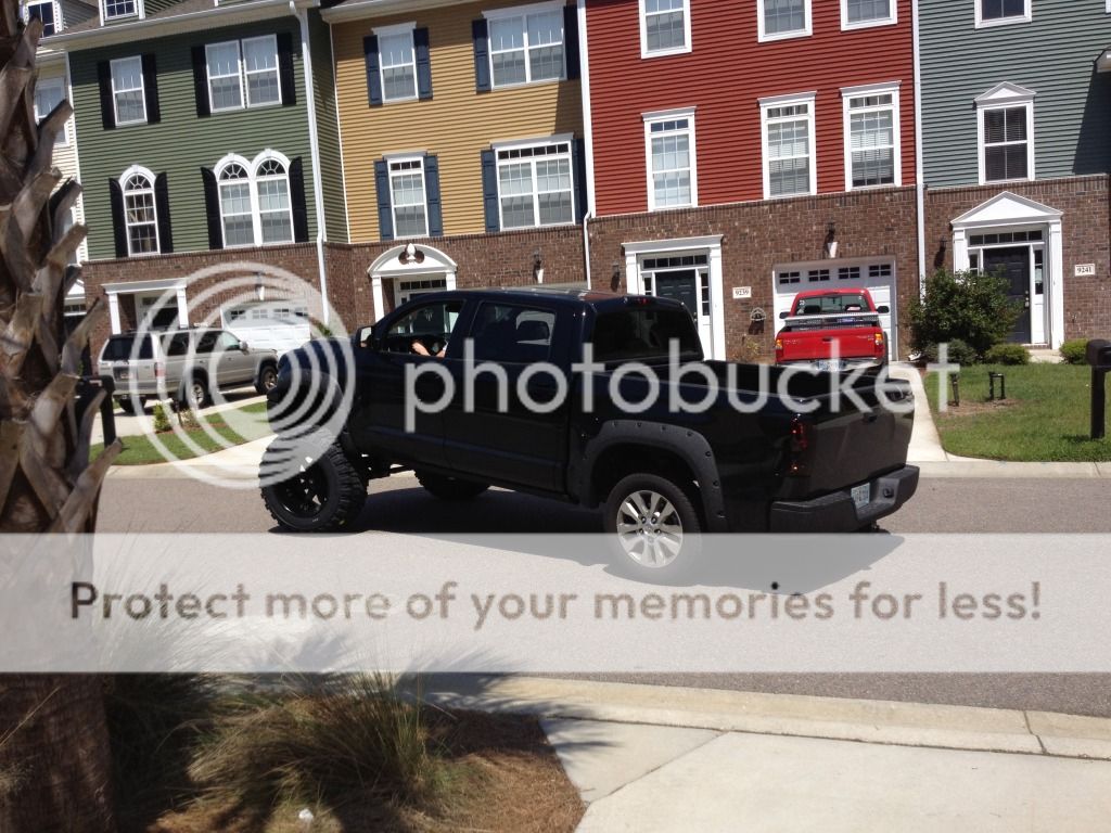

Drive SOOOOOOOOOOOOOOOOOOOOOOOO MUCH SMOOTHER. Feels so much better.
And as soon as i was done that i ended up helping my good friend for the next 4-5 days installing a 12" lift on his 2012 tundra so he could clear 40's and make me feel insignificant Running 32's.... (same guy earlier in my thread with the 4 runner) here's some pics of the tundra project "project RAWR!"
Just when i was starting to think i drove a big(er) truck.

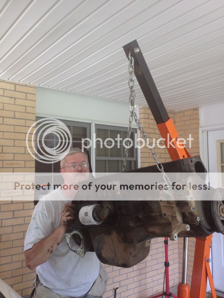

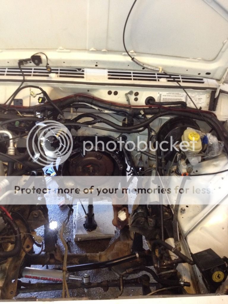

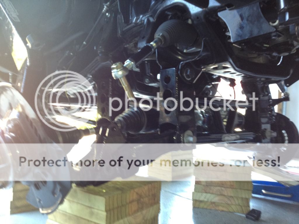

Well After i had the lift installed, Had just changed the head 800 miles ago, and changed my whole drivetrain/brakes. Of course the biggest fear would happen.
I lost compression in 5/6 cylinders. FML
Anyway. I always use something breaking as a sign to replace (and upgrade) at the same time.
So a stroker was on my list of "eventually s" well eventually came knocking right after i spent 2000 on all my other stuff. So i ended up spending another 1600 total to get my stroker build and swapped in.
Hopefully selling the old short block and a few other parts will put me back at 1000$ invested to have a disgusting torque monster installed in my heep.
Enough chat, time for pictures.
First of all to get some of this money i went on a little excersize with the military, and i had a little tumble.
Thanks co worker!
So i get back from that with about 600 bucks and it couldnt have come at a better time.
Since i lost compression i started searching for short blocks/other options.
when i stumbled onto a gem.
Prebuilt stroker short block from a fabricator in florida. (for the most part prebuilt)
The machine work had been done to the block, and all the parts for the bottem end had been purchased, machined and collected.
The owner had 2300 dollars invested so far in the project when times got tough. He was willing to let it all fall into my hands for 800 doll hairs.
I had to pinch pennies for a week or two because i couldnt pass that deal up.

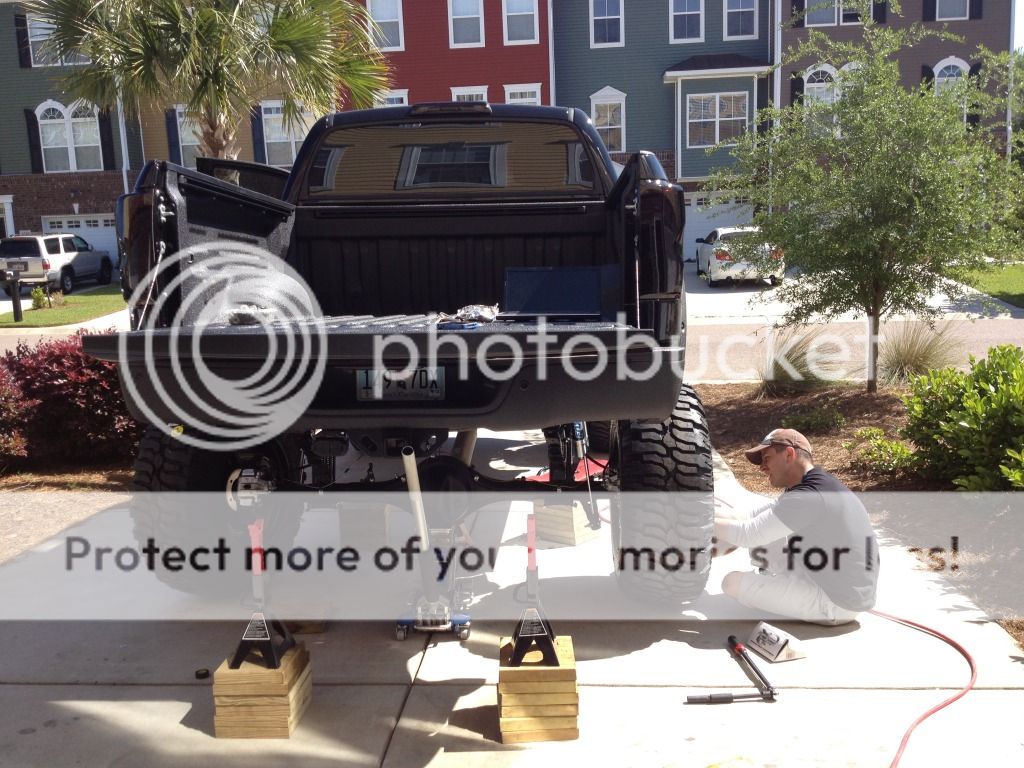

I was however intimdated by the task, i had worked my own suspension, and changed the head myself, but the idea of buying a stroker dissasembled and trying to figure out all the stuff that needed to be done to make it work was insane. but if you just knuckle down and troll the internet (some call it discipline) i call it desperation.

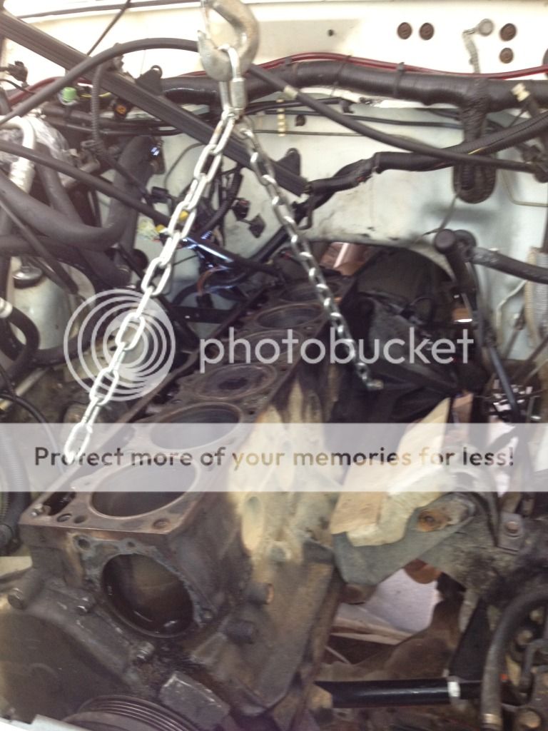

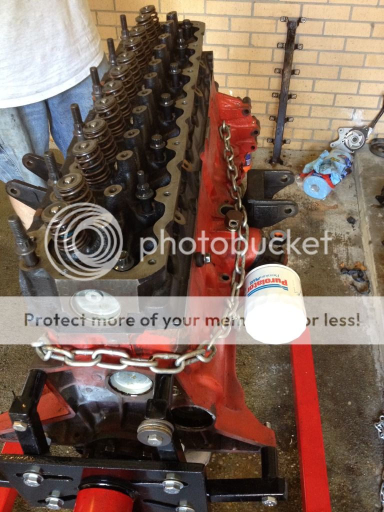

8 days later i have this sitting in my car port
Took it to a local machine shop to get all the tolerances checked and the crank/pistons/cam and all that jazz installed
once it got home

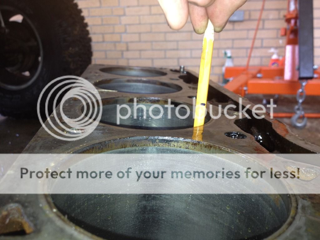

Checking clearance (i didn't mill the deck or the head)
Everyone said to go with the double roller type timing chain, but ive heard it's easier for them to jump a tooth.
so i kept it real with the stock one
Picture of the cam.
here's the info on the block
92' 4.0 Block that had 55,000 miles bored over .030
bathed checked and machined by a shop in South Florida
Calculated CR of 9.6:1
4.2 Short nose crank. I belive thats the 4 coutner weight one.
6.125" connecting rods from 92'
amc 242 timing chain cover 92' cast
OE timing chain and gear set- NEW
Sealed power speed-pro Hypereutectic pistons for amc 242 4.0L .030" (new)
Sealed power main, Connecting rod and Cam shaft bearing STD. (new)
Crane cams Truck torque Cam For Amc 258 4.2L p/n 753905 (NEW)
Crankshaft stroke = 3.845
Rod lengths = 5.875
Piston diameter = 3.905
Piston height = 1.592
Head gasket height= .043
Quench height = 0.081
Deck Height = 9.453
Deck Clearance = .038
along with the 0331 head that's measured to 56.5cc's and got these specific to my build
8.86:1 CR
276.3 cubic in
4.53 liters (bear in mind the 4.0L is really 3.965 and the 4.2 is 4.129)

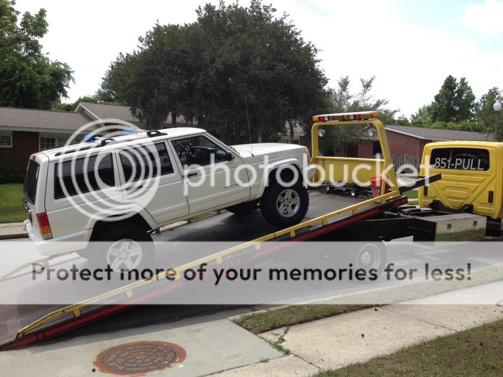

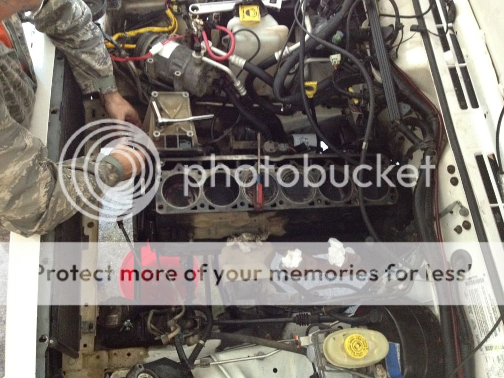

So whenever i was trouble shooting it before i realized i lost compression. I thought it was an electrical issue, i tried in my off time for 13 days. Then i threw in the towel and had it taken to an electrical specialist. Never in my life have i paid someone to fix something because i couldn't.
This made me want to cry
Then 8 days later i get a call. "yeah man you lost compression, We can replace the rings for you but it will be a 1200 dollar and 2 week job"

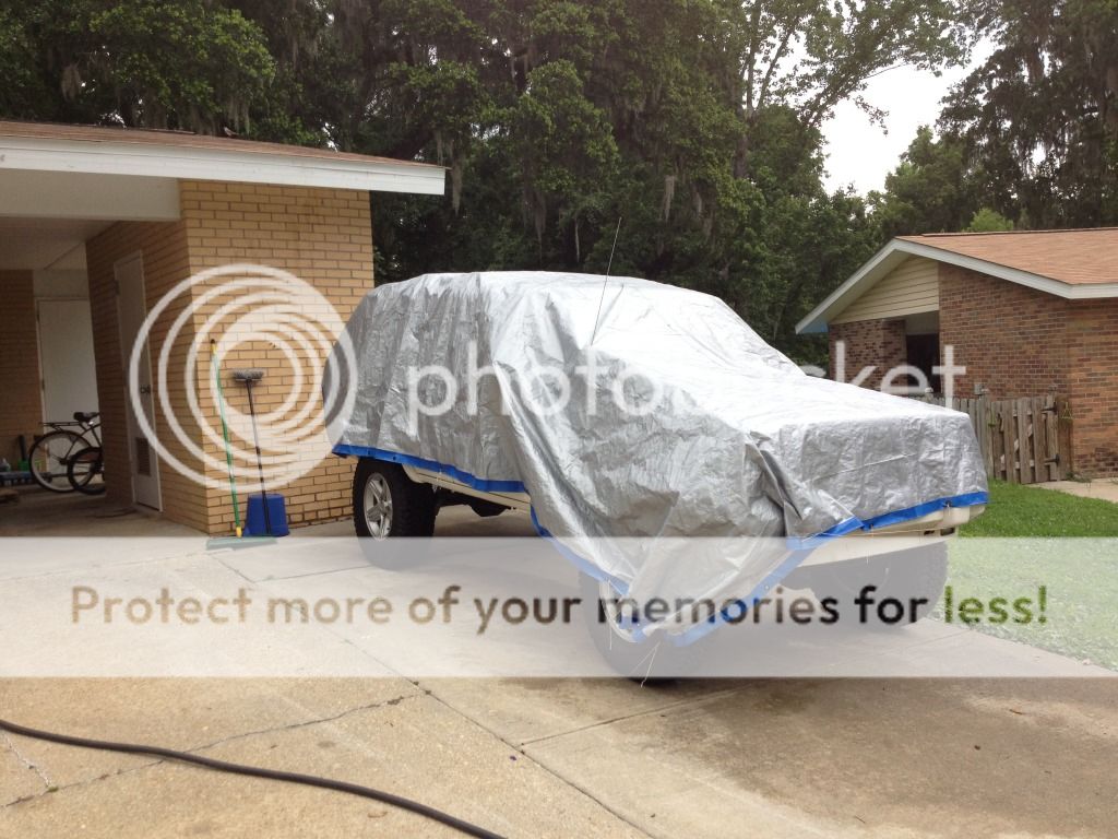

**** that, so i towed it home with the help of a friend.
And tarped it. At this point i didnt care if god struck this thing down.
This is what defeat looks like.

I was going to build something along these lines.
But i had put to much work into it already to throw in the towel.

Anyway, here's more pics from the engine swap.
after the head was out.
ready to come out
my pops who drove from va to help
me giving it the salute
that was the first day.

New block built up in my dining room (my wife was totally okay with it) Im so lucky!!! (she helped pay for the stroker too!
stroker with the head swapped over
for referance
this is the old block. At full stroke (the blue line is full stroke on the stroker)
so you can see the differance in length
