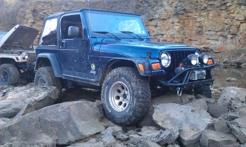

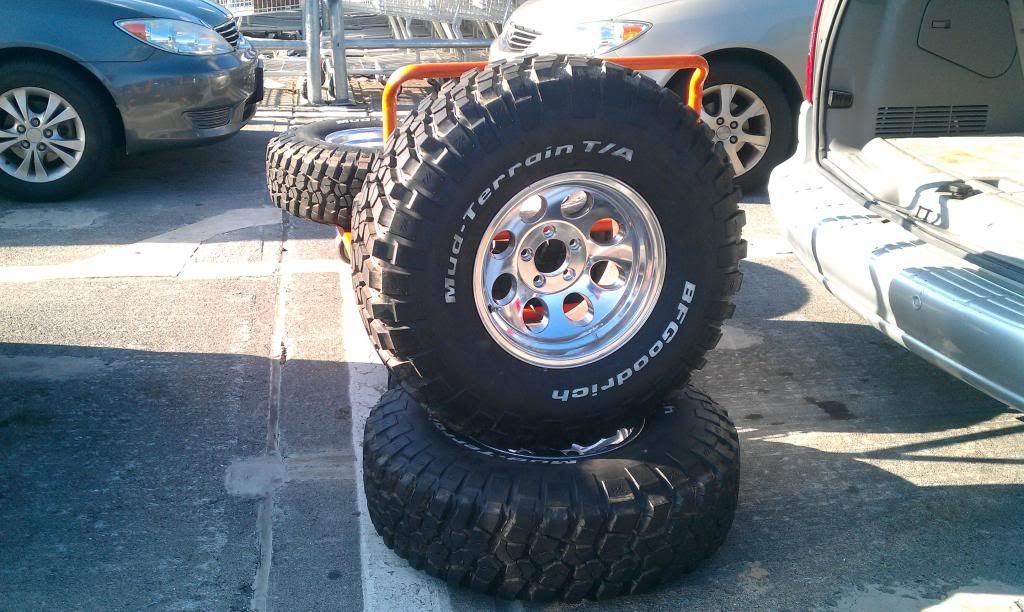

For 2012 I picked up a set of 33x10.50 KM2's on 15in ion wheels for a song.
[IMG]km2s photo km2s.jpg[/IMG]

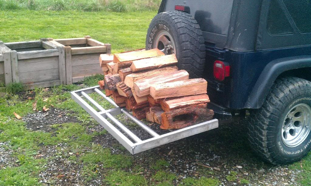

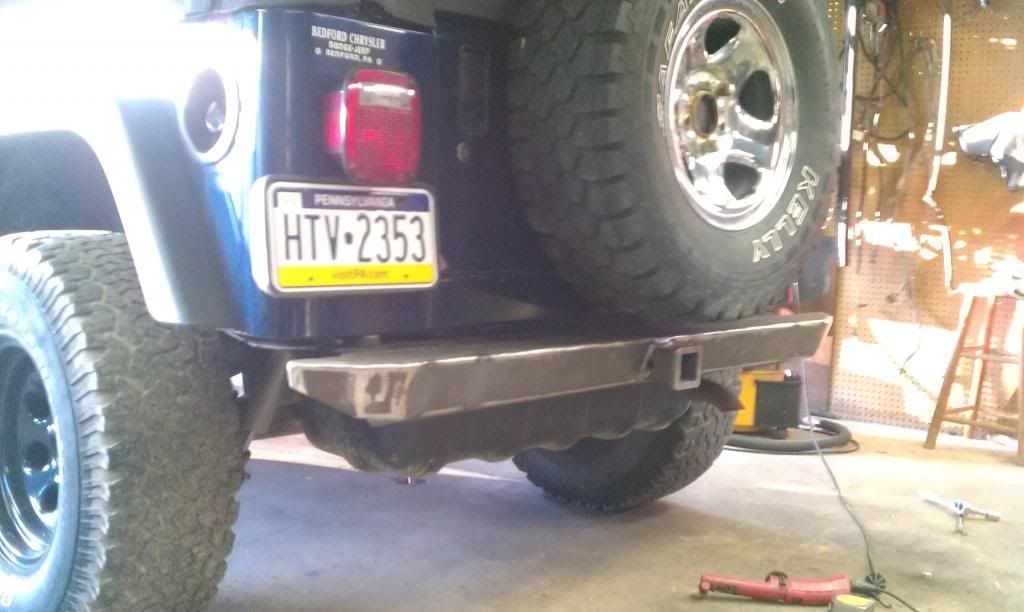

A deer decided it didn't like my stock bumper so I took the insurance check and bought a trail gear front bumper to take the place of the stock one. I decided to build my own rear bumper using all 1/4" steel. I fabbed in a 2in. receive to use as a recovery point and so I had the option to tow.
[IMG]rear bumper photo rearbumper.jpg[/IMG]

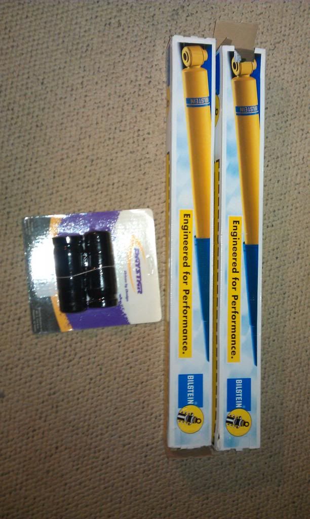

After a while I got tired of the TJ riding like a pogo stick so I ordered a set of bilstein's for the front along with the proper bumpstops to keep them from blowing out.

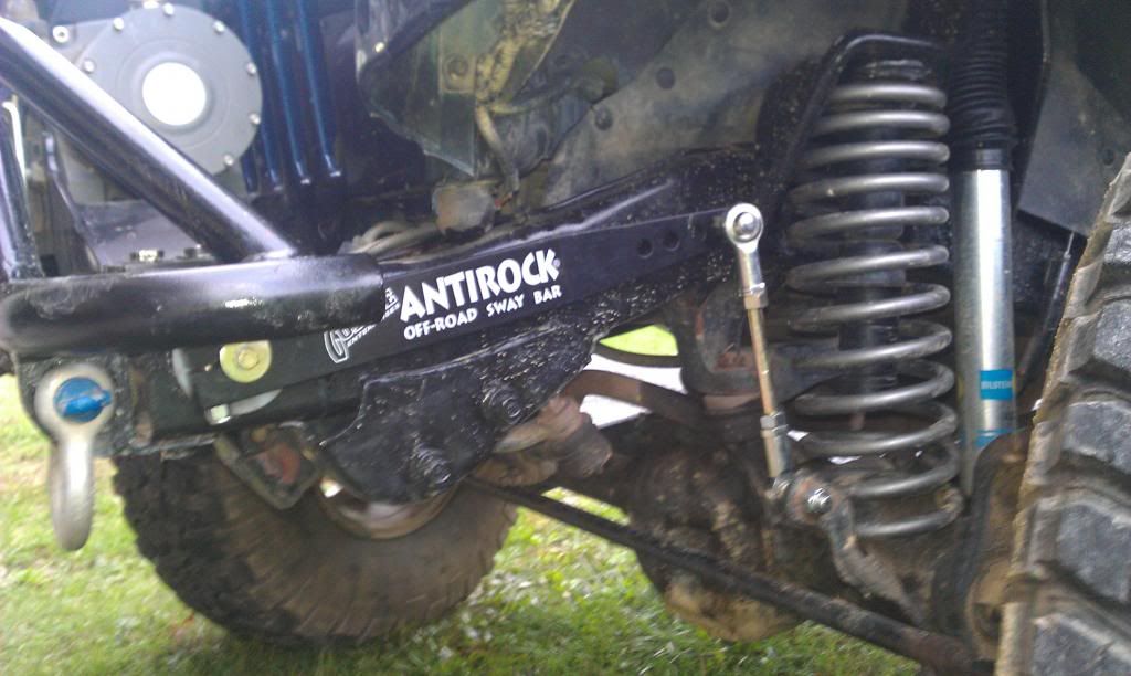

While I was playing around with the front I installed a Currie Antirock. I love how it controls body roll and stability why'll still allowing it to flex. It's one of my favorite mods to date.
[IMG] photo antirock.jpg[/IMG]

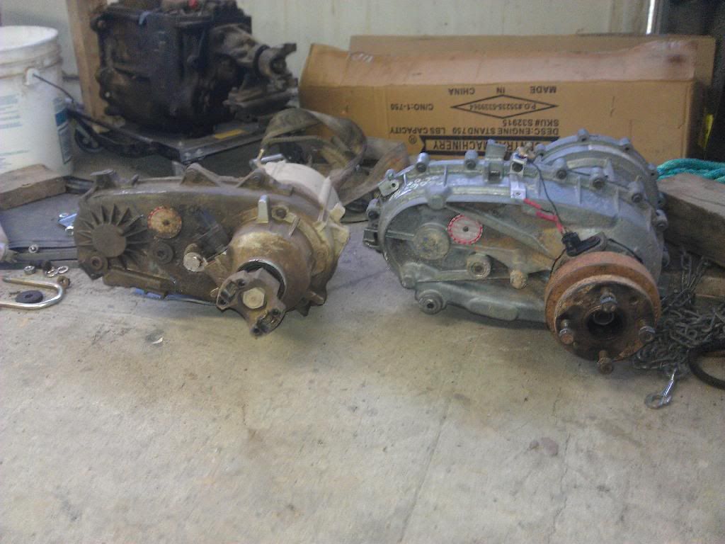

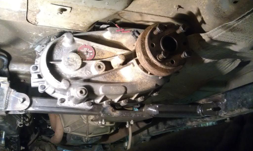

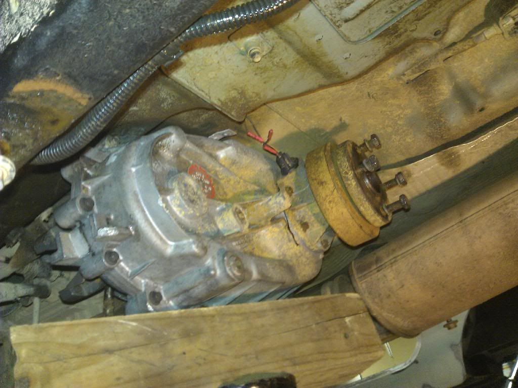

I was getting tired of getting high centered so I decided a tummy tuck was in order. To go with it I picked up a np241 out of an 03 rubi.
[IMG] photo FB_IMG_13561108551922531_1.jpg[/IMG]

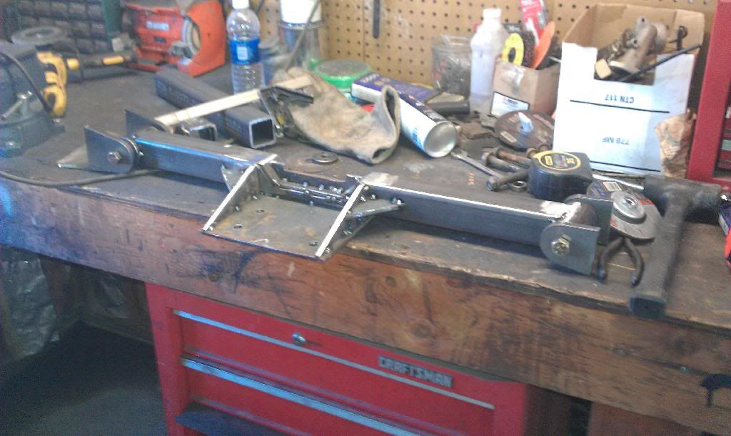

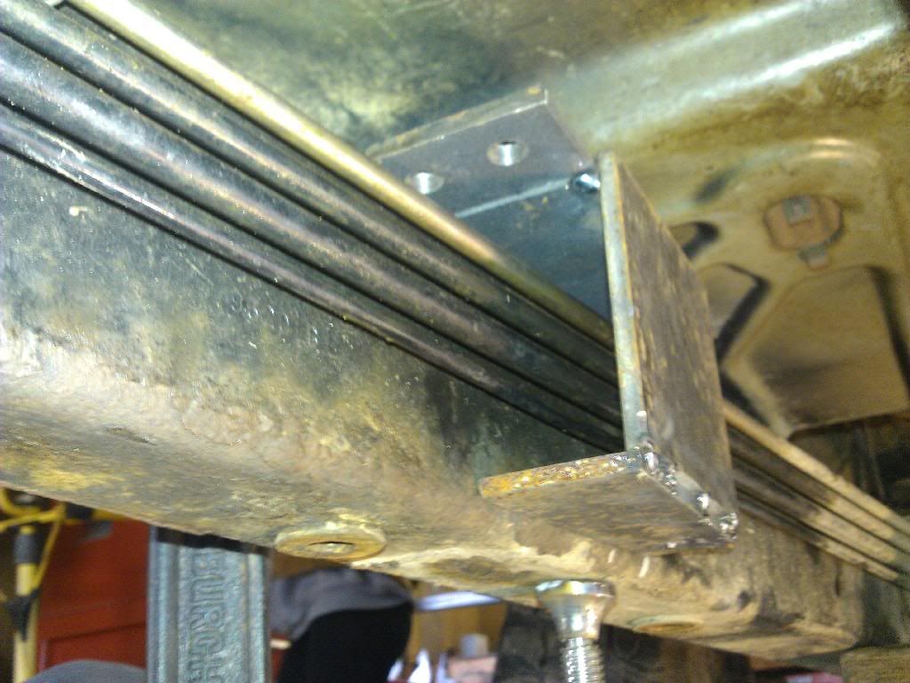

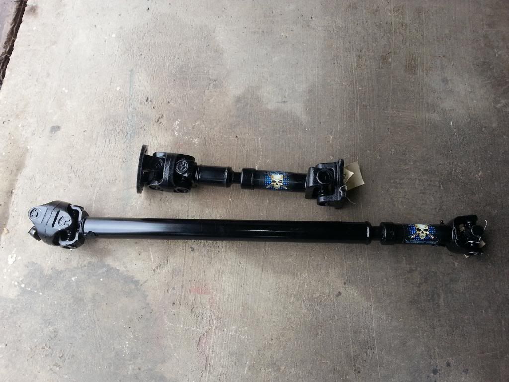

I decided to build a crossmember style mount with a separate skidplate for ease of maintenance. The pics of the mount were from before it was finished, I added much more gusseting. Adams driveshaft built a set of driveshafts for me, I cant say anything but good things about those guys and their product. When all was said and done I got around 19in. of clearance at the skid.
[IMG] photo FB_IMG_13574423334905552_1.jpg[/IMG]
[IMG] photo FB_IMG_13580205500525057_1.jpg[/IMG]
[IMG] photo IMAG0931.jpg[/IMG]
[IMG] photo 20130312_112509_1.jpg[/IMG]
[IMG] photo FB_IMG_13676046853558251.jpg[/IMG]

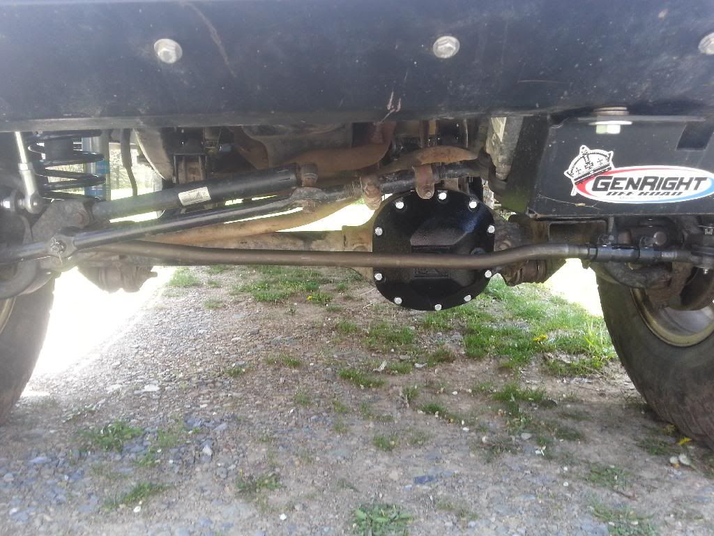

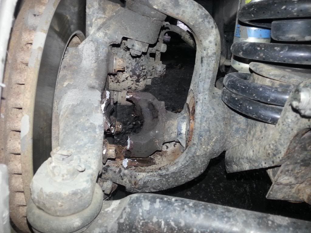

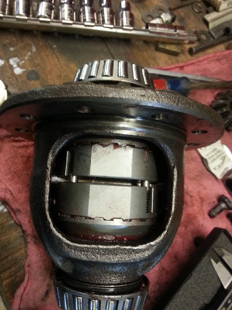

Why'll doing some crawling I took a bad line and dropped onto my tierod which became an instant rainbow! I straightened it enough to get home and ordered a v8 ZJ set up, as well as an aussie locker and a riddler cover for the dana 30 when I got home. A Genright steering box skid also fell into my lap!
[IMG] photo IMAG0716.jpg[/IMG]
[IMG] photo IMAG0715.jpg[/IMG]

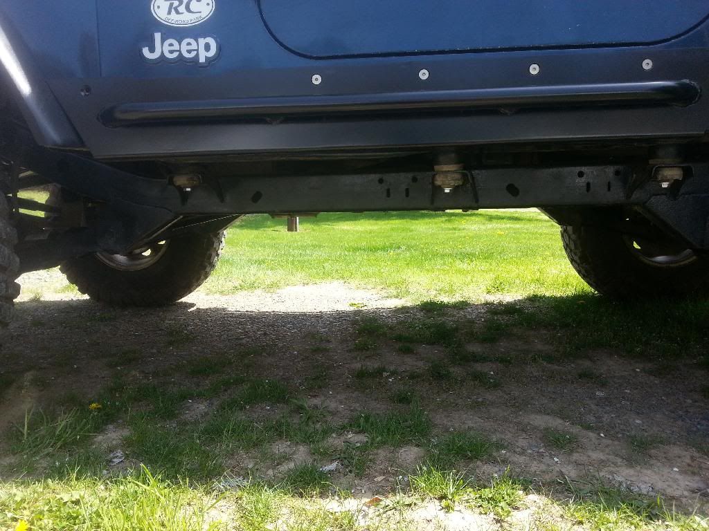

I found one more decent pic of the tummy tuck.
[IMG] photo IMAG0954.jpg[/IMG]
I wheeled like this pretty much trouble free and really enjoyed the jeep. It's amazing how far a front locker and tummy tuck will take you.

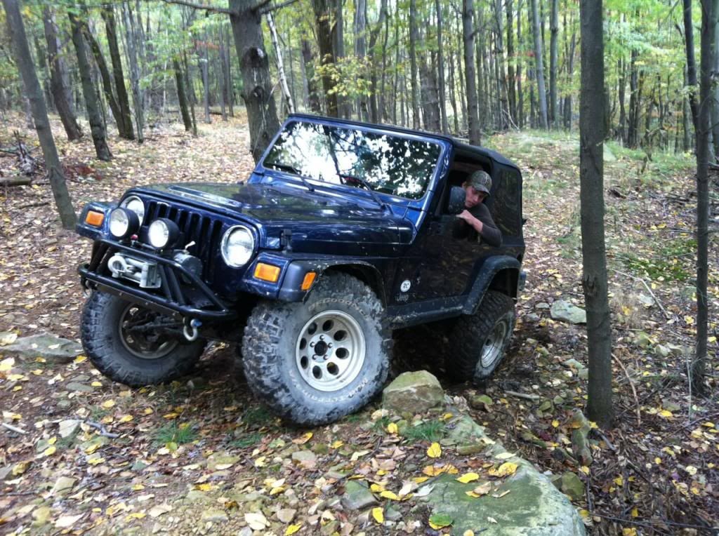

Here are some Wheeling shots from this year, the first two are yellow jacket at Rausch Creek, the third is trail 20 at Rock Run, the forth is my Wheeling buddy Goldensahara also on trail 20.
