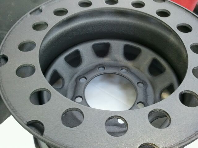

Originally Posted by stone View Post
Wheels are powdercoated
Let me know how you like these after running a few trails. I'm thinking about making some at work myself. Great build.
