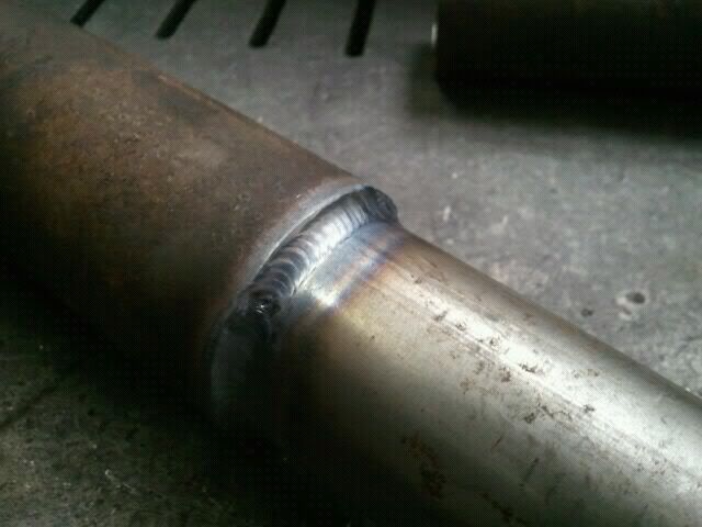

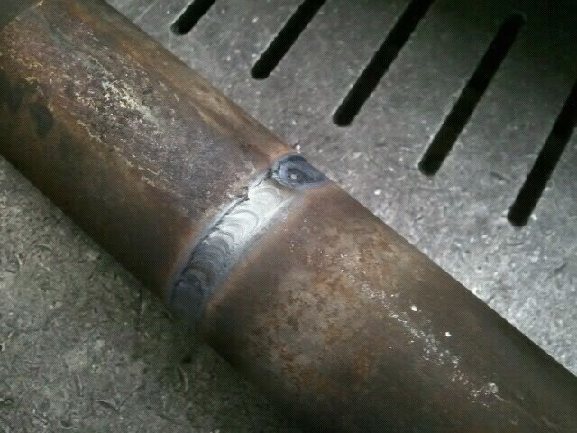

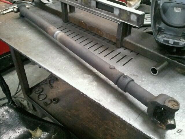

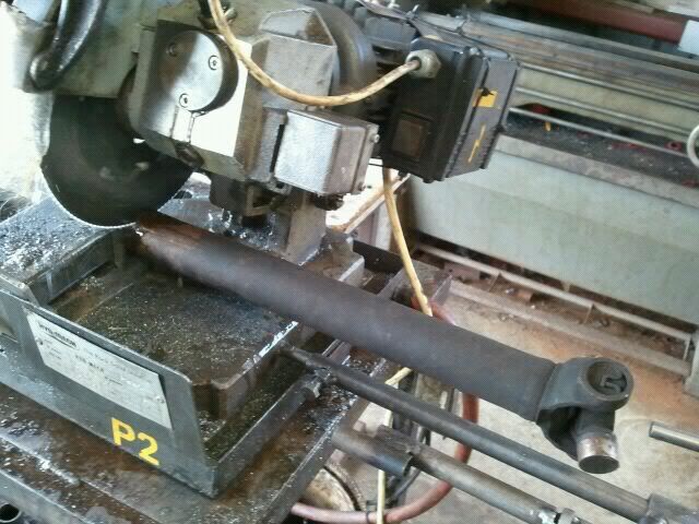

Cut down the front driveshaft today
Sleeved it with 1.5 x .120 DOM
Welded it back up
Finished
My YJ Build - http://www.jeepforum.com/forum/f22/stones-93-yj-build-1115815/

What advice can you give my on cutting down a drive shaft ? I have a explorer shaft for my TJ and I would like to cut it myself. I am confident in my welding skills, I am not confident in how to align it perfectly center.
How did you accomplish the task of keeping it straight?
Sorry to clog you build thread.
