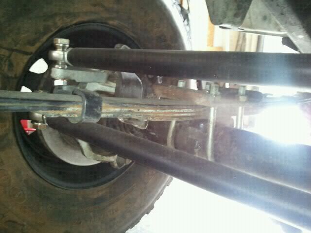

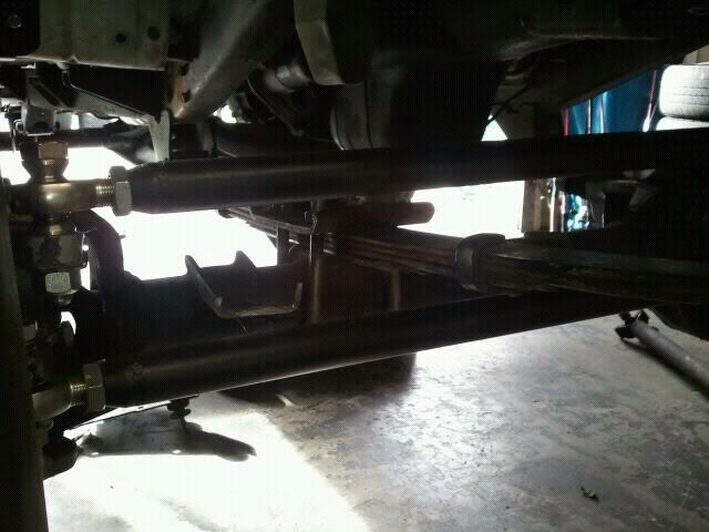

Looks great man! Did you have any issues with the tie rod contacting the diff cover in that position? Im running my tie rod just like you and I know with my SOLID diff cover I had to adjust my steering stops out a little to keep it from contacting the cover. Looks really good btw!

No but I'm also running a stock diff cover right now
