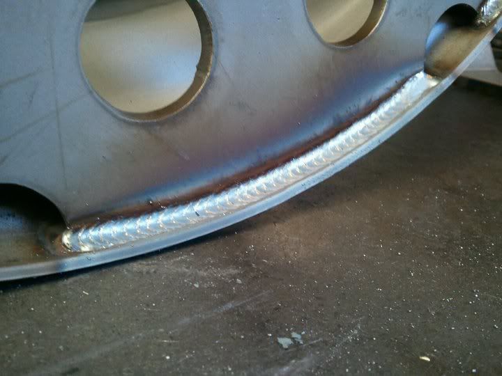

post #54 of 183 Old 11-29-2010, 04:04 PM Thread Starter
stone
Location: Tampa, Fl
Posts: 230
Sandblasted and welded the wheels today on lunch

post #55 of 183 Old 11-29-2010, 05:06 PM
kyle_craig
Posts: 2,747
Good lookin' welds!
