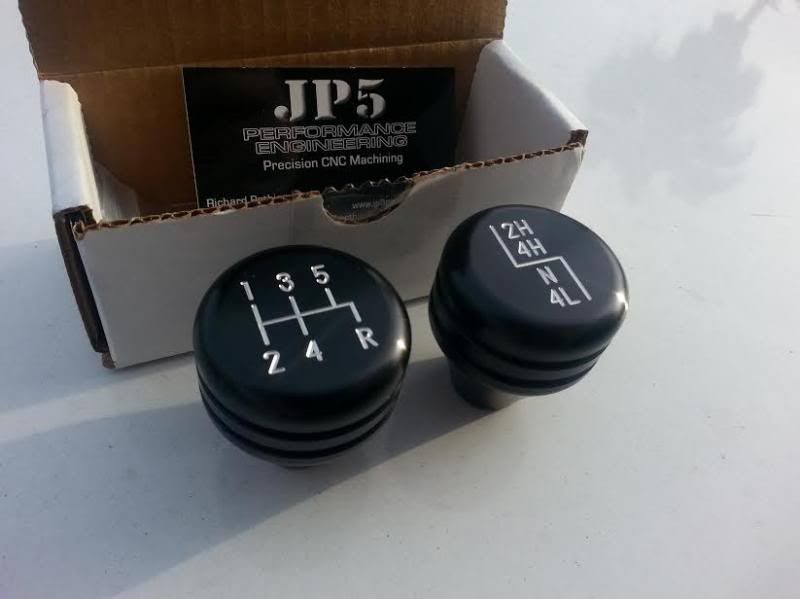

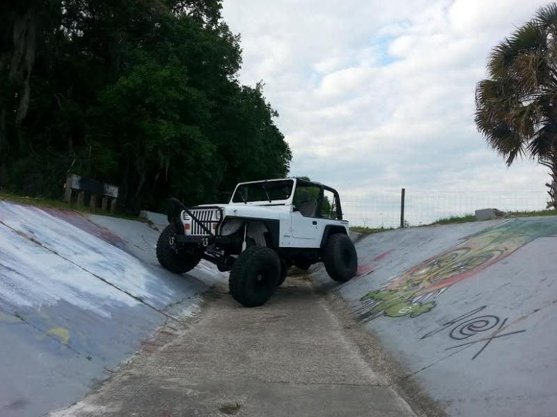

Got my new shift knobs in, they're really nice.
Messing around in a ditch by my house

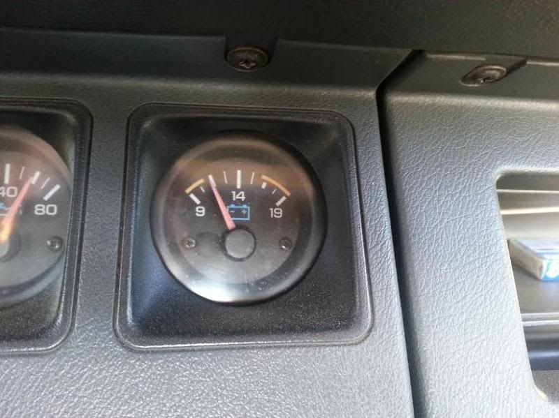

Keeping an eye out for a 136 amp alternator, this one is struggling haha

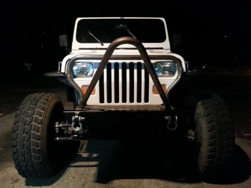

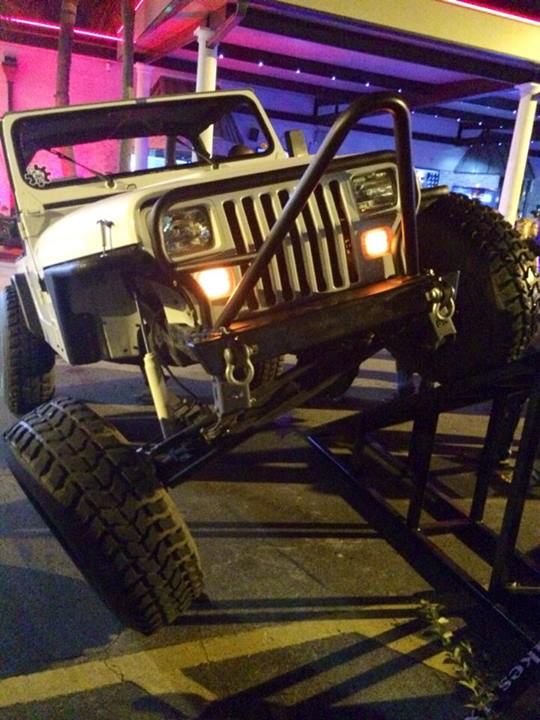

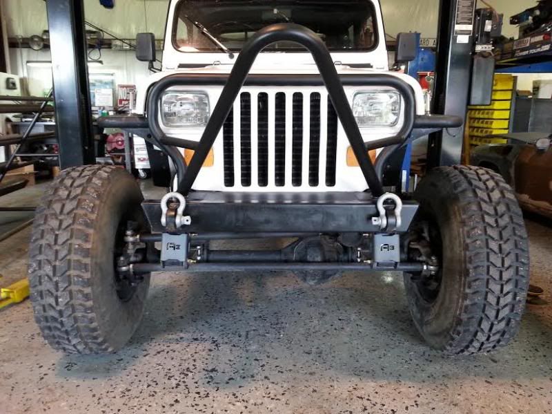

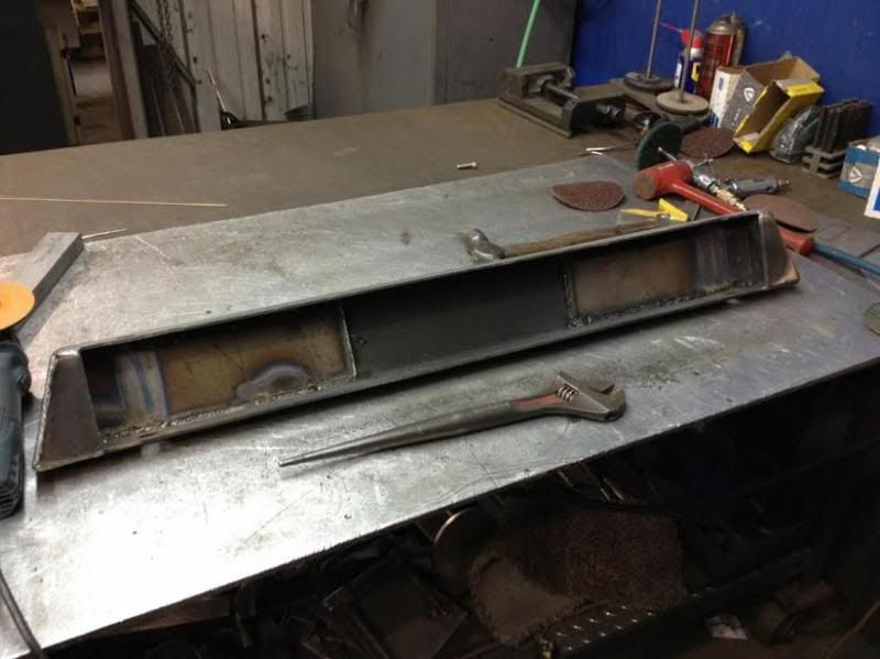

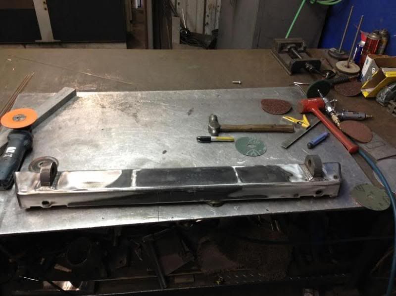

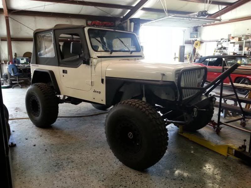

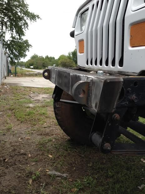

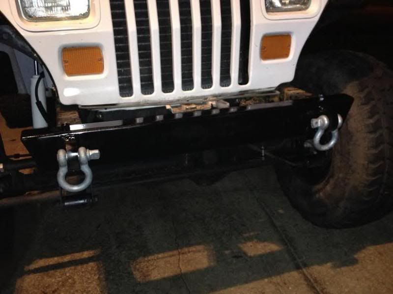

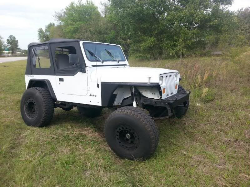

Also started working on the front bumper. We decided to beef up the stock bumper, and add winch plate, stinger, and grille guard.
So far, notched the bumper for the 1" clevis mounts, welded the mounts to 1/4" plate and slid them through the bumper and welded it all out.

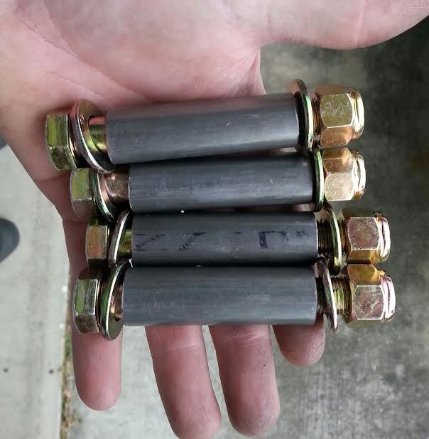

The winch plate is going to be welded to the bumper. It will wrap around both sides of the frame. I cut 4 sleeves, we're going to drill the frame and weld the sleeves in and through bolt the plate to the frame, along with the factory mounting bolts for the bumper on top and bottom.

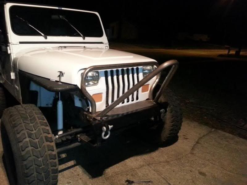

Had a productive weekend. Friday we finished up the bumper.

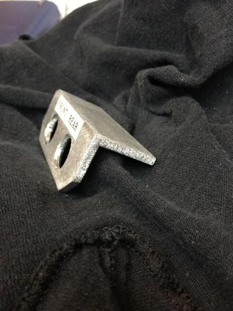

My buddy Brett made me some awesome shackles for the front.

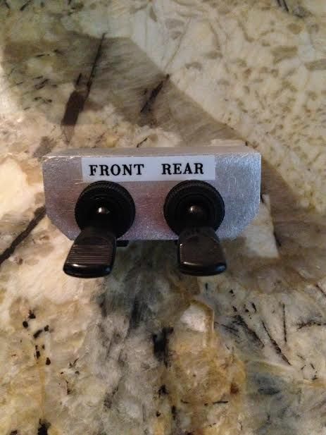

Made up a temporary switch mount for the light bars. We're going to build a nice switch panel when we do the cage and mount it above the rear view mirror, so this will be until the cage is built.

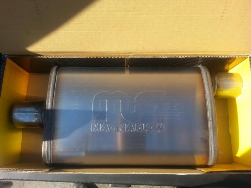

Also I ordered a magnaflow muffler today. Getting tired of the flowmaster, ready for a cleaner sound.

Muffler came in today, probably wont get it on until next week or so. We have a club meet friday night, then headed out to do some wheelin at hardrock saturday morning.

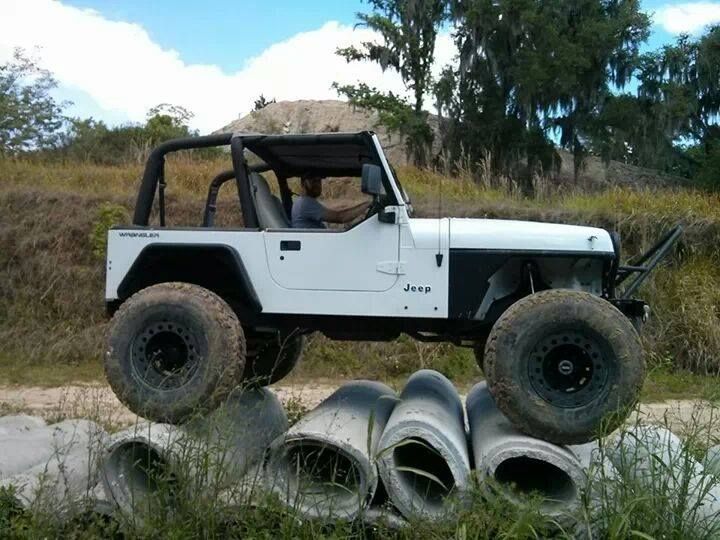

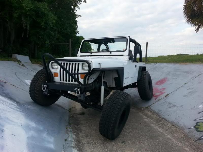

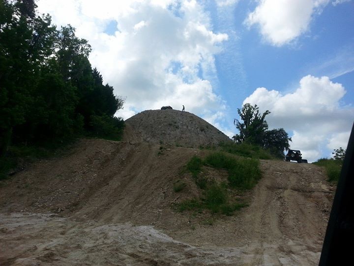

Warming up for the RTI ramp tomorrow night at the meet
My YJ Build - http://www.jeepforum.com/forum/f22/stones-93-yj-build-1115815/

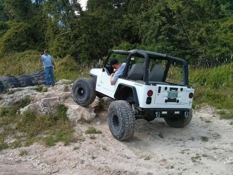

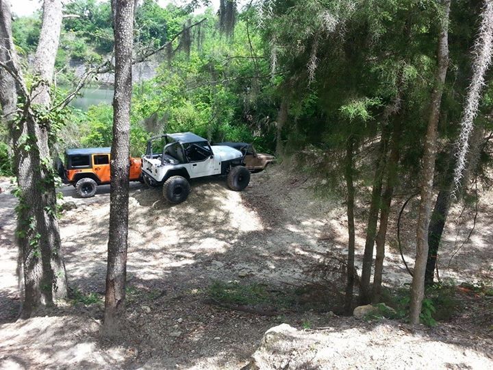

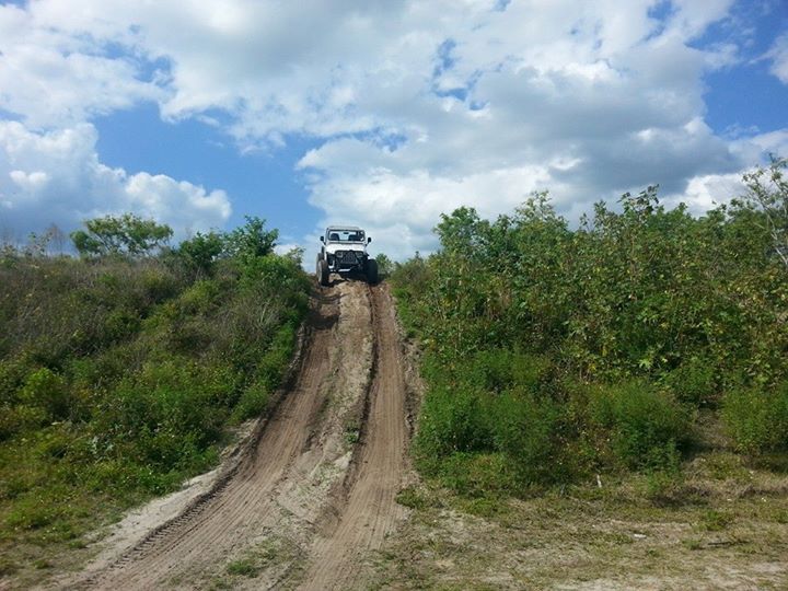

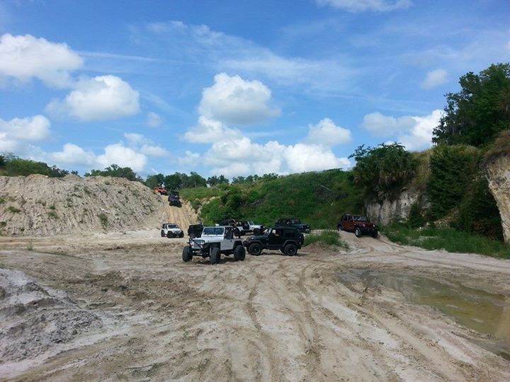

Saturday we had a group of 12 jeeps from TJK head out to hardrock to do some wheelin. I had a great time out there, and found a few things I'd like to change on my rig.

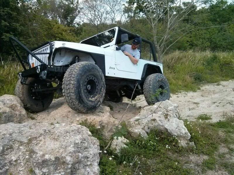

Few shots from last sunday, we went to a small spot and my girlfriend was climbing everything in the jeep lol

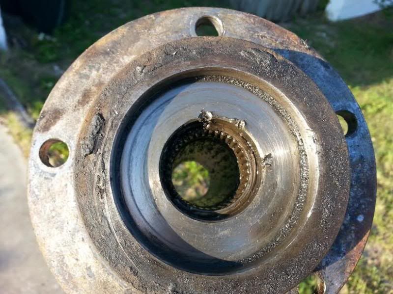

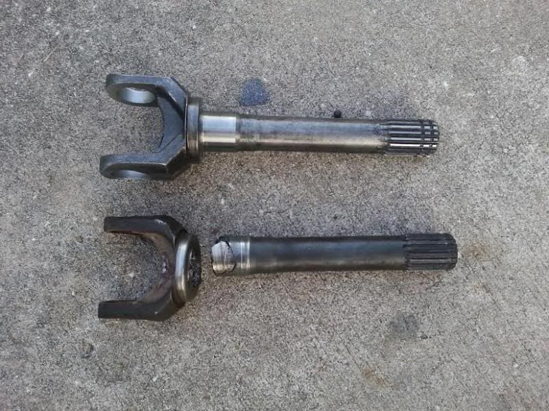

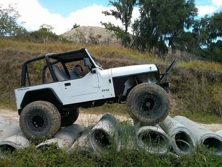

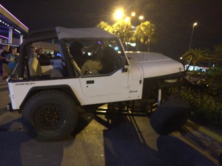

Well, I broke it.

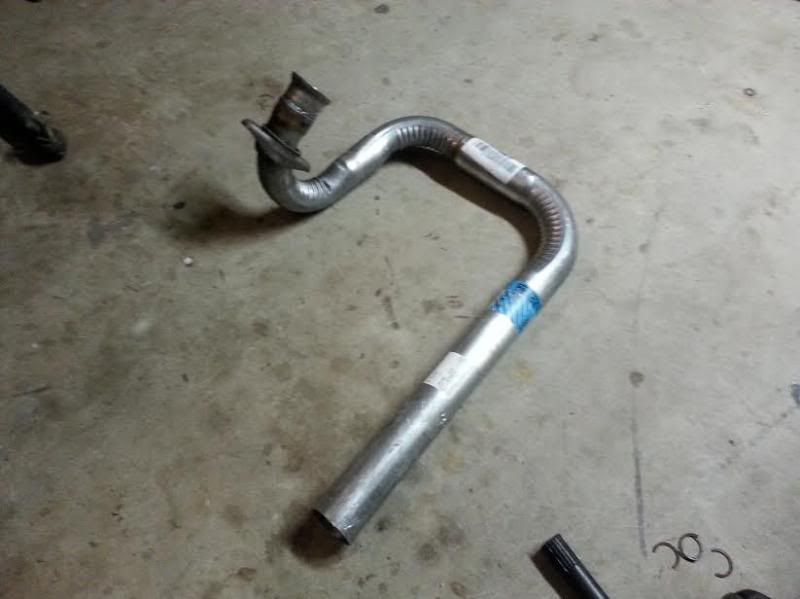

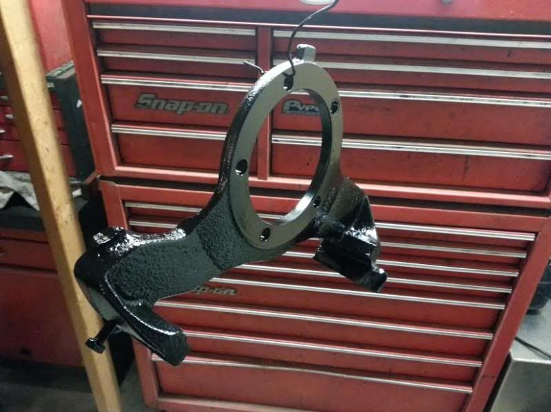

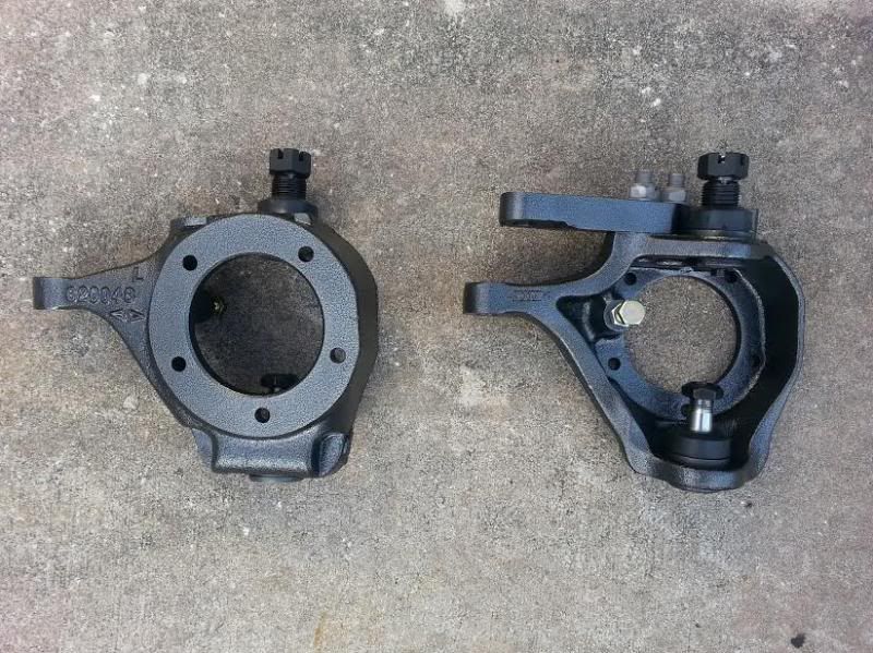

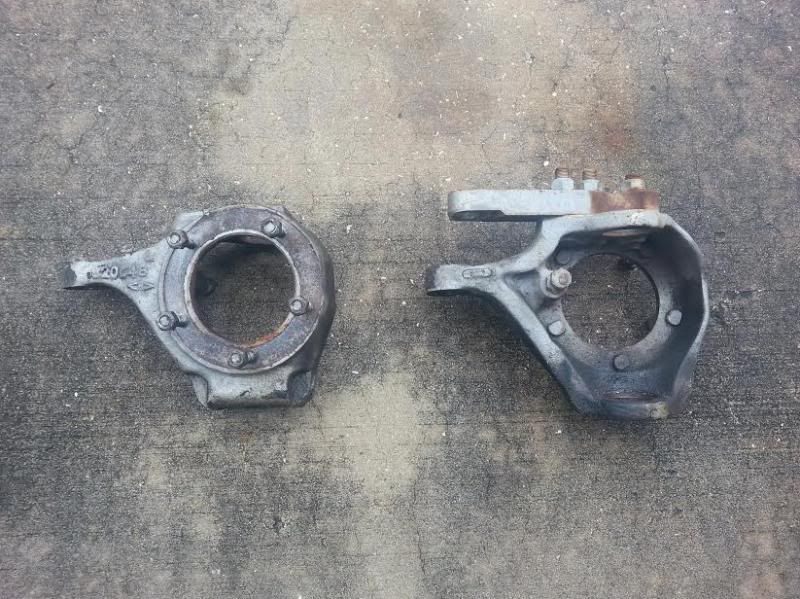

Time for a small update. Since I broke the axle shaft, I decided it was time to freshen up the D44, which I had been putting off for some time. I got the replacement shaft, axle seals, needle bearings, and 4 new ball joints. While I had everything apart I took the knuckles to work and powdercoated them, and blasted and painted the caliper brackets. I also got a TJ exhaust, I'm going to switch to the TJ style since the YJ exhaust hangs down low.
When the axle broke it beat up the inside of the spindle some, I'm going to clean it up.
