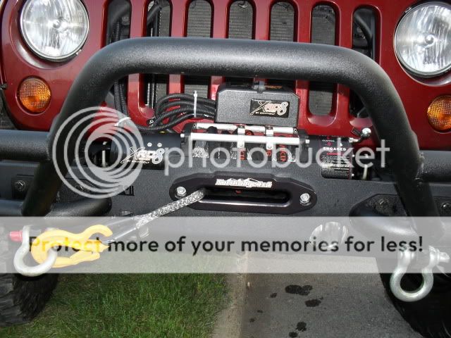

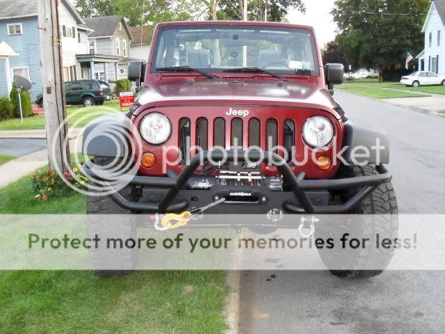

Got the winch line installed. Had a slight problem, the bolt they gave me to start the line wouldnt thread in the hole. Had to rummage around for another bolt. The one that came with my smittybuilt was too short. I also got my jeep rustproofed at Carwell (AKA Krown) today, that is why it looks greasy and there is stuff dripping on the street. I have to wait 4-5 days to wash it off. As u can see from these pics I also covered up with my winch power cables with that plastic covering stuff to protect and make it look a little better.

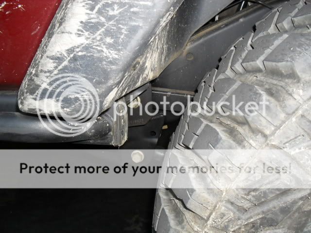

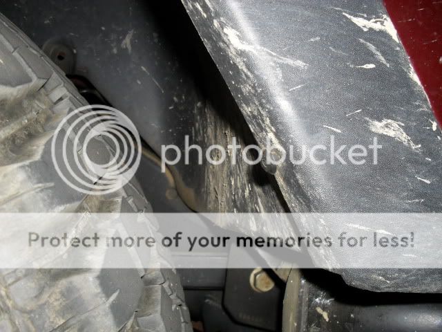

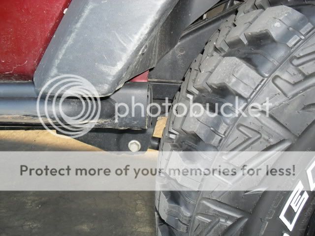

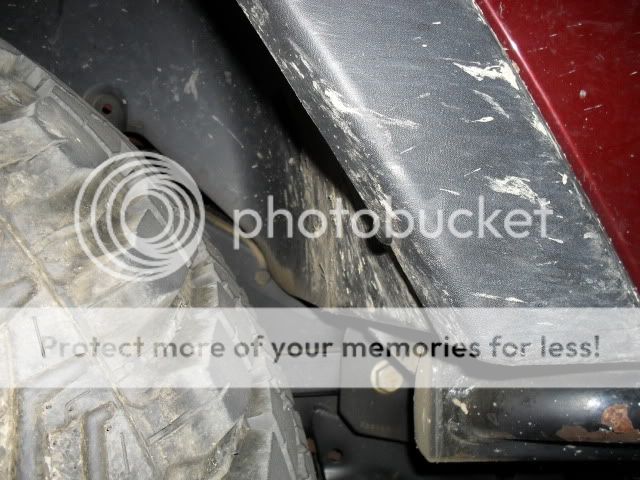

This past weekend, I removed my rock rails, trimed them and then trimmed the pinch seam. I was getting some light rubbing off road. Not enough to damage the tire but enough to annoy me.
Before:
After:

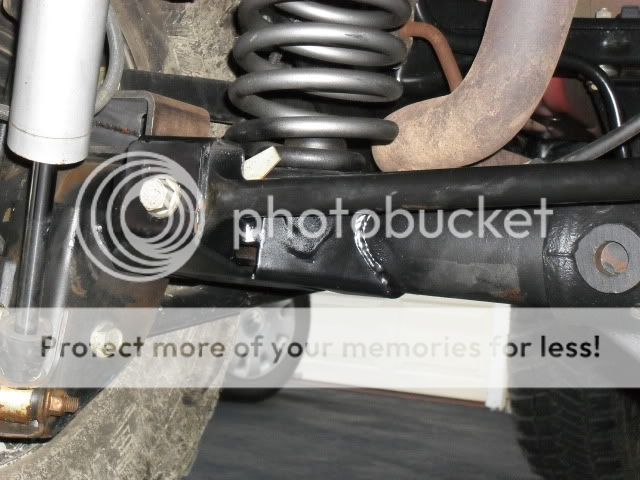

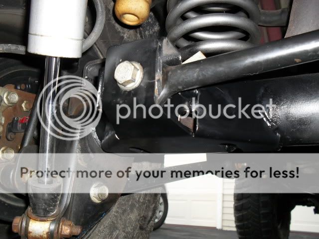

Got the JKS rear trackbar bracket brace welded on. Now I got to save for the front.

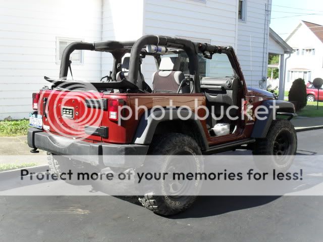

Here r some doorless and topless pics of the jeep in my driveway (I always forget to take my camera when I am wheeling)

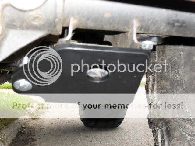

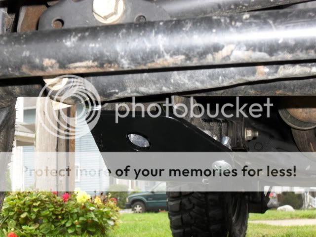

Installed SKid Row front lower control arm skids yesterday. Install was easy. I will post pics when I get a chance. They look like they will do the job.
Steve, Olean NY, 2004 TJ Rubicon & 2006 LJ Unlimited

Pics as promised:

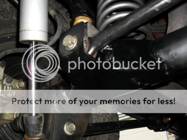

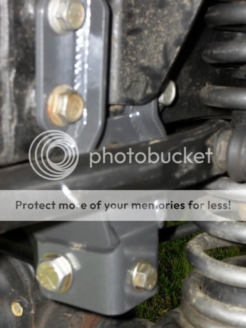

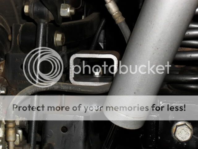

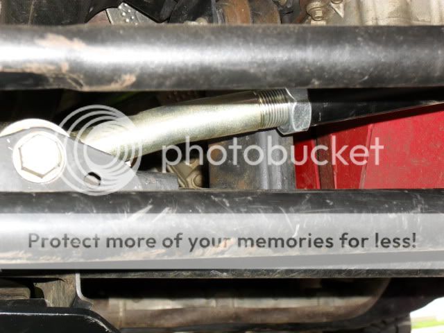

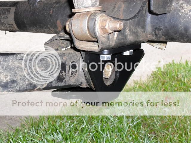

Got some updates. I was getting some DW so I upgraded some stuff on up front. Replaced lower control arms with stock replacements, upgraded front trackbar to JKS adjustable Track bar, installed Polyperformance Frame side track bar brace. Went with stock lower arms becasue they were cheap and I am ok with how jeep rides other than DW. My bushings in old arms looked worn. Here r pics:
I am installing the JKS front track bar bracket brace this week along with a teralex stabilizer and woods relocation bracket to get that up and out of the way. will post pics once installed.
