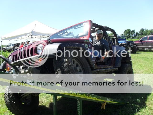

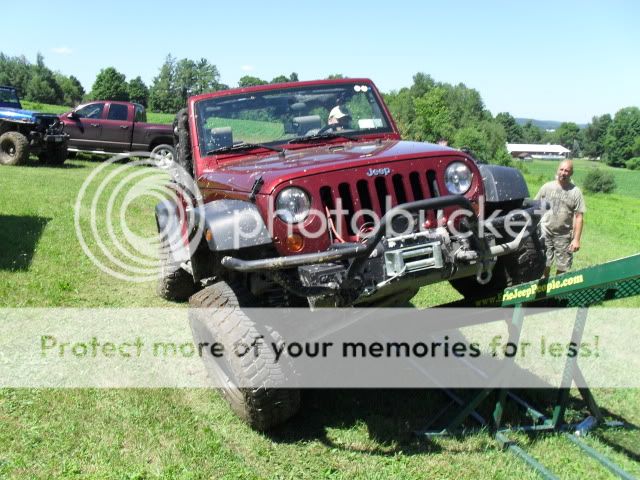

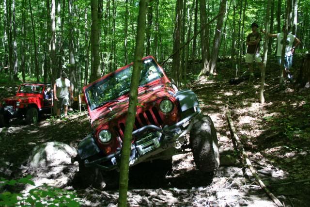

Here is a pic of me almost flopping couple of weeks ago.
Steve, Allegany NY, 2017 JK Unlimited Rubicon

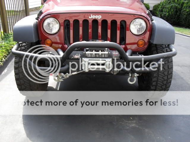

hey man, nice jk. i was wondering how much you spent on the front bumper + wench + guard, thing looks awesome. Also if you dont mind me asking, where did you get those wheels, how much were they? i have a white '10 rubi and they would look so nice with the rubi tires.

I got the bumber from Quadratec, it was about 700 for the guard and bumper. The winch was about 300 so it cost me a little over 1000 for everything. The wheels are 17 inch steel blackrock rims from quadratec. They were about 70 a piece.

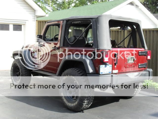

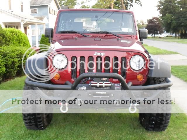

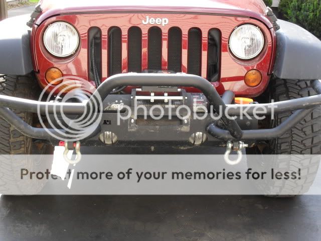

As promised, here r some more pics. the first pic shows my jeep sitting more level with the additional 1/2 inch spacer I installed.

the wheels fit my rubi 33's? im sorry im really new to this and just dont want to mess anything up

I assume you are talking about the stock rubicon tires which are actually 32s. Yes, as long as the rim is 17 and tire is 17 it will fit. I would make sure and get 8 inch wide wheels and not 9incn wide. They will hold your tire on the rim better when aired down. If you go back a few pages in this thread you will see stock rubi tires on the rims since this was the last tire I was running before I upgraded.

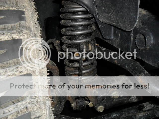

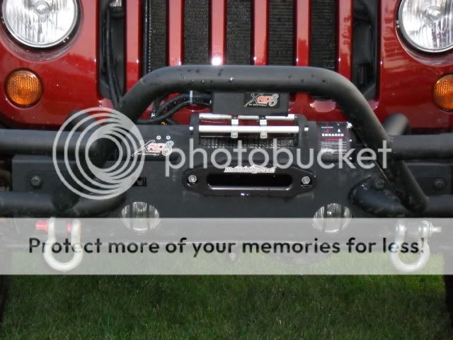

Well, nothing super exciting. Installed teraflex bump stop extensions in the front a last week. they were easy to install. Now I need to figure out what to do in the back. Most extensions are like 3 inchs but I only got 2 1/4 inch of lift in the back. I also changed my oil yesterday. Anyway here r pics of the front.

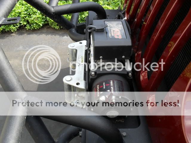

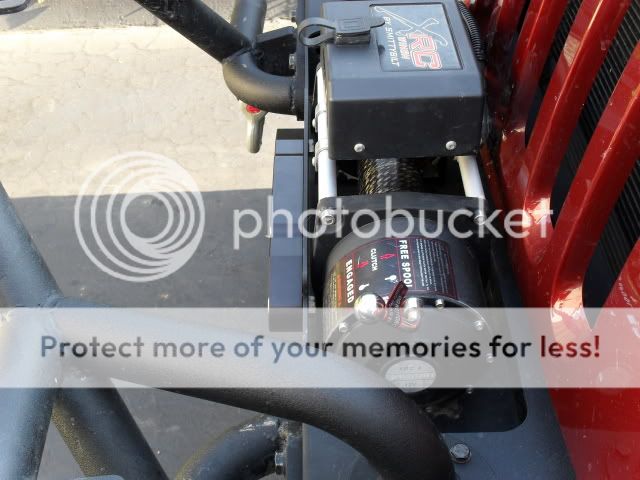

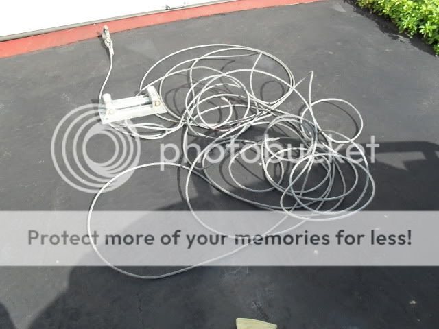

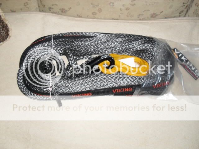

I got my synthetic winch line in the mail today along with my new Hawse fairlead. I pulled off the old winch line and fairlead and installed the new fairlead. I am getting my jeep rustproofed tomorrow so I will wait to put the new line on until this weekend.
Before:
During:
After:
Here is my winch line:
