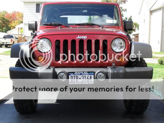

I have decided to start a build page for my Jeep. It is a 2009 2 Door X with the 17 inch tire and wheel package, 3.21 gears, dana 30/dana 44.
Here is the day I bought it in September 2009:
NOW as of 8/26/11 Read through the thread to see its evolution

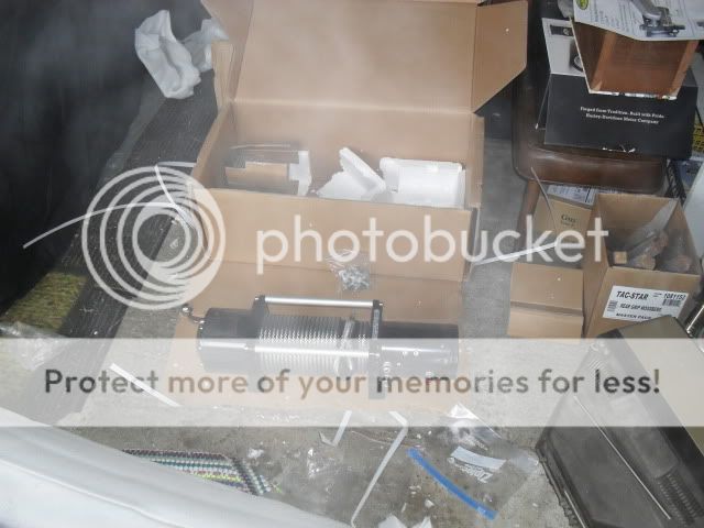

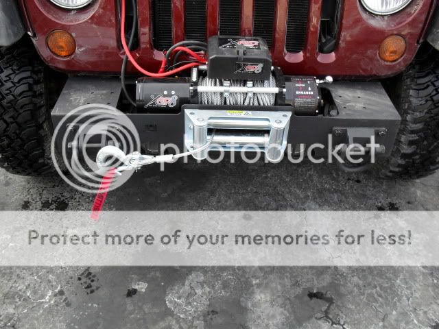

Received my 8000 pound Smittybuilt winch,Rugged Ridge ridge Modular bumber and Rough Country coil lift with front spacers from UPS this week.
Winch and bumper get installed on monday and lift next weekend. Pics to come soon.

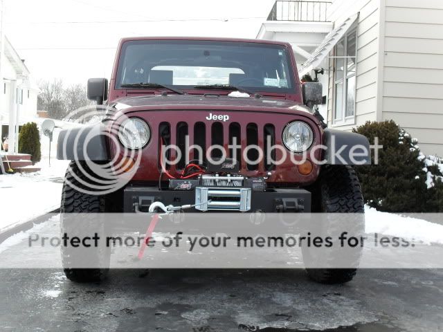

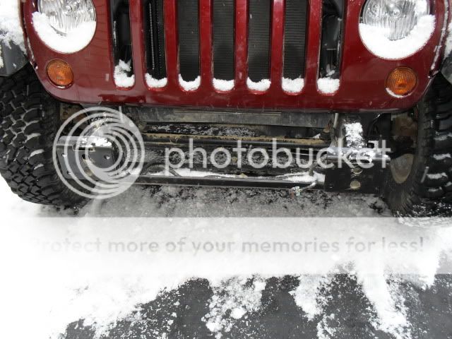

Pulled off skid row front skid plate, stock bumper and fog lights yesterday. Installed fog lights into Rugged ridge mod bumper (those little washers and nuts are a pain the but) I am about to go back out into the cold and start the bumper installation.

Well, its been long day. I went out this morning to get the garage ready to start working and brush the snow off my Jeep before I pulled into garage. Here is my Jeep before I started after removing the stock bumper last night.
bfolla06 Came over and started helping with the install at around 9. It wasnt long before I relized I would need a 19 mm deep socket and I didnt have one so it was off to tractor supply. We decided to try mounting the bumper firstand then the winch. No dice, too hard to get up underneath and get the bolts for the winch, so we took the bumper off and installed the winch on the bumper and then bolted the bumper to the frame. Than we realized that we couldnt get to any of the electical connections because the design of the rugged ridge bumper, so we had to pull the bumper off, then pull the winch off, connect the eletrial connections to the winch, remount the winch and mount the bumper and winch again to the frame. Its been a long day. But it was worth it, here is the finished product:

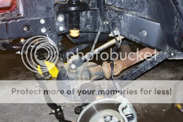

lnstalled the Rough Country 3.25 inch kit yesterday with the help of some of my friends from Erie Jeep People. Here are some pics of the install. I will get some shots of the Jeep finished up later. It was too late to take decent pics by the time we were done with everything.
You can just see my head in this one

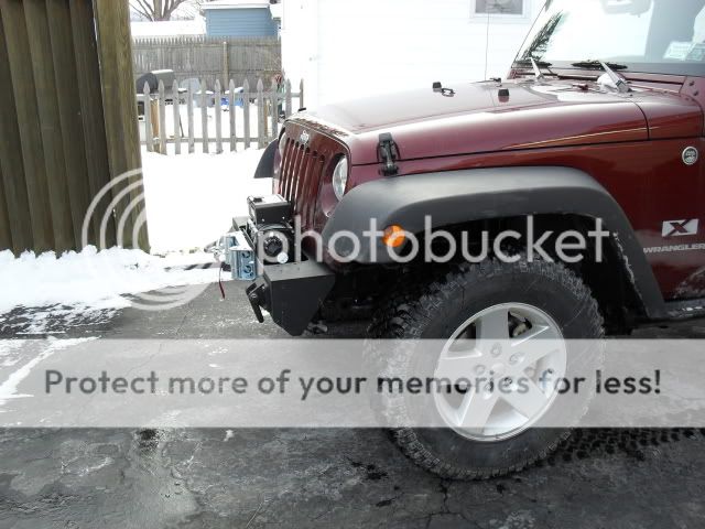

Lift pics plus new wheels, 17x8 inch black rock steel wheels with 4.5 inch backspacing.
