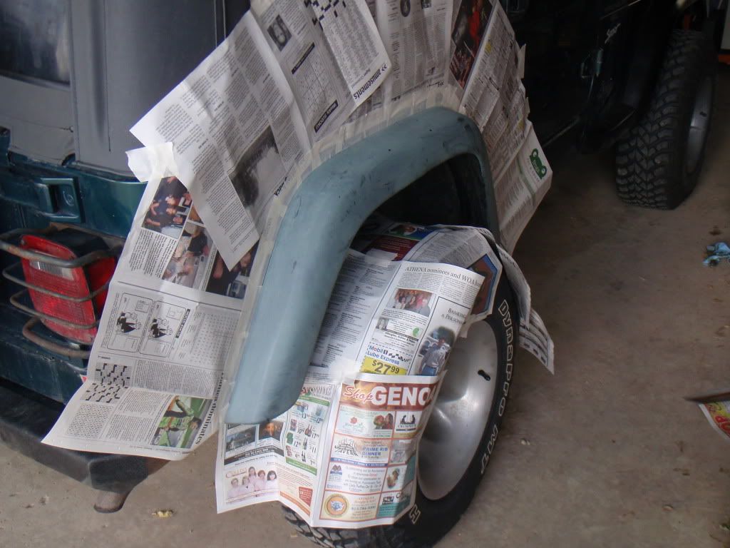

First! A little cosmetic loving got taken care of. I finally got around working on the rear flairs. Well I started out trying to remove them...but when the first bolt I tried to losen, and observed the threaded rivet just spinning in the body, I said screw it. Soooo, I decided to do all the work attached to the jeep still. I cleaned the flairs with Dial dish soap to get 'em nice clean, and free of any oils or grease.
Then taped up the body.
And finished off!

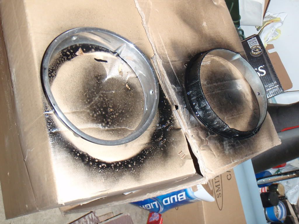

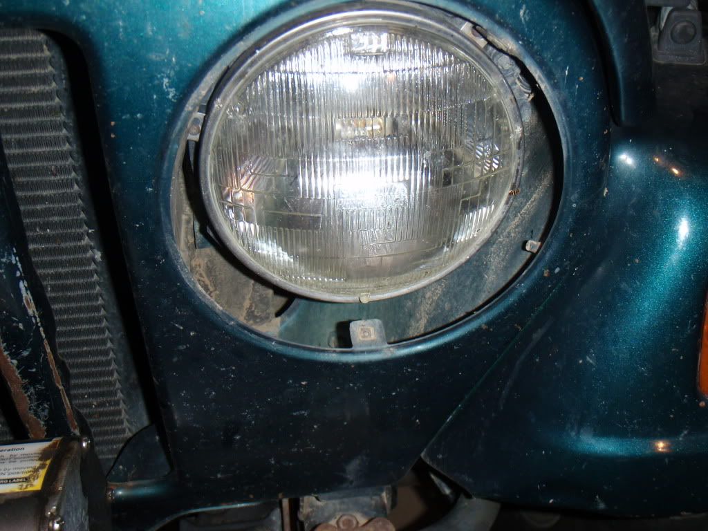

I also decided to pull my head light bezels.
I roughed them up, and sprayed them with Krylon gloss black.
It required a little messing around, and I had to redo the work a few times. I'm still new to this painting concept and just how much roughing needs to be done. Here's the final product.
My before picture.
Final result.

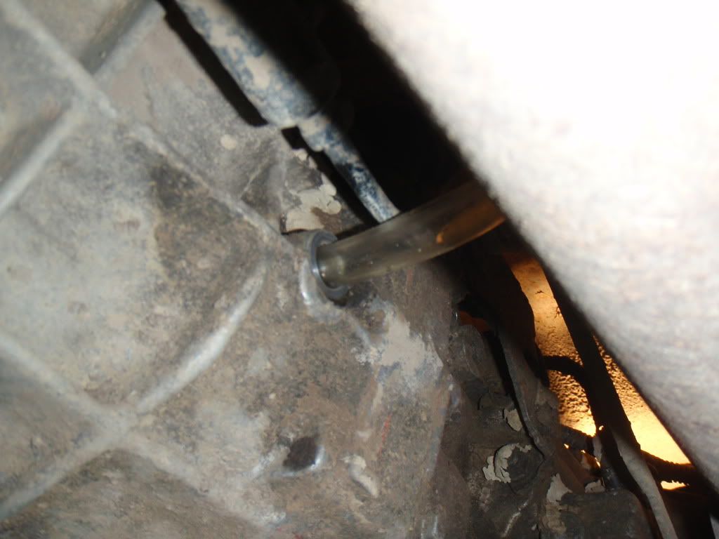

Finally got around to the rest of my fluid changes. Started out with my transmission fluid. Used 10w30 Castrol synthetic, per the recommendations on here. I didn't fill from the shifter like some, ended up just using a piece of rubber tubing. It's a little ghetto, but it works like a charm.
Draining was surprisingly easy. Just used a piece of aluminum foil as a funnel. I did notice a milkyness to the oil, I'm guessing I got water in the trans after one of the last wheeling sessions. Good thing I finally changed it.
After that I moved to the transfer case. I successfully managed to flood my skid plate, and dump a huge puddle of oil on the garage floor. Apparently I didn't place the aluminum foil properly. Oh well. Once it was drained, I filled her back up, using the same system. Sealed it all up and took it for a quick lap around the block. Everything seems to be running good. Then just a little kitty litter for cleanup of the spill and I'm good to go! Now, just to get the new wheels tonight.

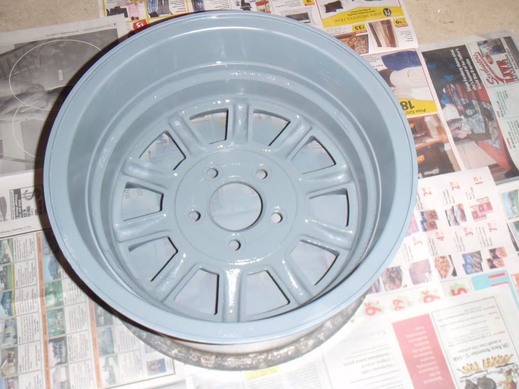

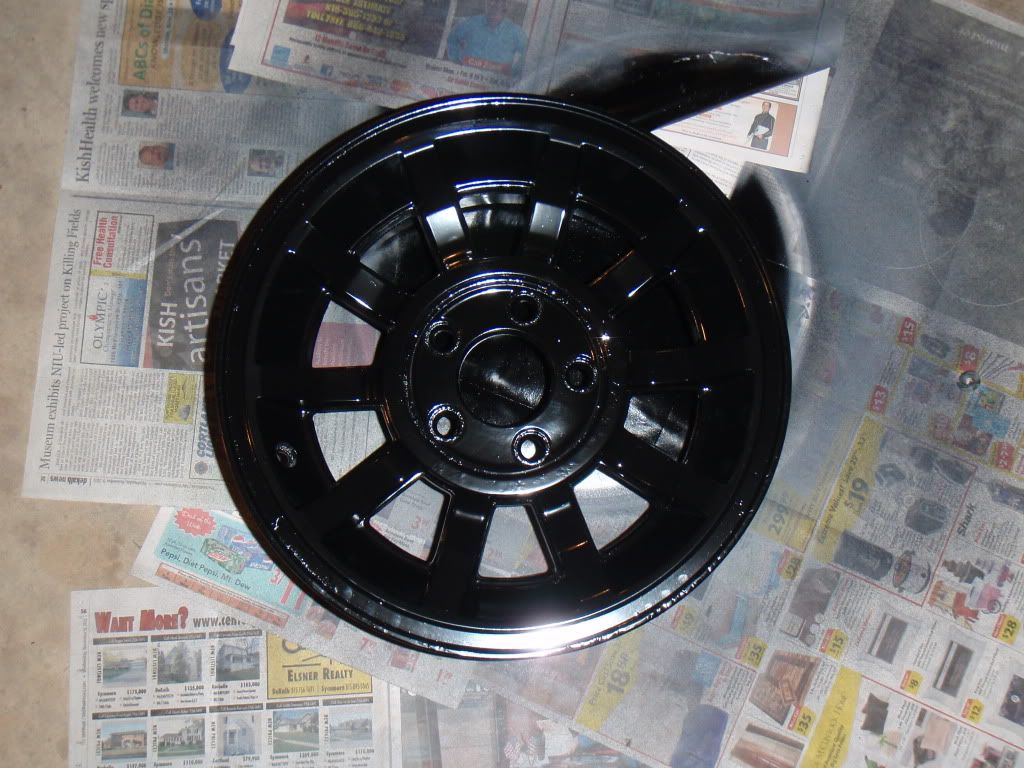

Back to more important things. Seeing as i haven't spent a lot of time painting, I decided to take the wheels slowly with a little trial and error. Soooo, I only started with one wheel. The results will determine how I handle the other 3. So I started out in my garage with a bottle of windex and an old t-shirt. I cleaned it up as good as I could and wiped it down again. I then sanded all the to be painted surfaces with 120 grit sandpaper. I then went over the whole wheel again with acetone.
I laid out some newspaper on the garage floor and lade out the wheel, starting on the back side, and painting the front last. I sprayed it first with Krylon gray primer. Here's out it turned out.
Once that dried, I again started with the back and then followed with the front. I used Krylon black gloss paint. Used most of a can for the wheel, but I think it turned out pretty well.

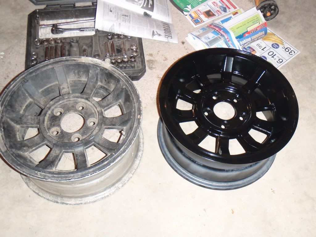

I think it came out really well. Here's a side by side comparison.
The CL add originally said there was 5 1/2" of backspacing...which was inaccurate. There isn't any actually. The guy didn't know what backspacing was, lol. But that's ok. I'm going to lose a little bit of overall width witch sucks, at least until I can get wheel spacers. Now that I've move up to a 7" wide wheel, I'm willing to shrink the wheel width a bit.
Any comments on the wheels compared to the existing? Opinions are welcome!

i like these wheels a ton more than what you have on there but im still not fond of wagoner wheels on a tj buts thats my own personal taste, but you did an excellent job bringing that old wheel back to life. i probably would have just bought some simple cragar soft 8's lol. your putting a lot of time into this jeep so too me its exciting to follow.

Thanks! Yeah, I actually am not super fond of the wheels either...but $50.00 vs. a set of new Cragars.....it was an easy choice. I figure next time I buy wheels, I'm going to save up my pennies and REALLY get what I want, which wis probably going to cost somewhere in the neighborhood of 4 figures...so the cheapos with a fresh paint job was the way to go for now, lol. I also definately have a bad pully somewhere in the engine bay... expect a new wright up soon...hopefully tonight.

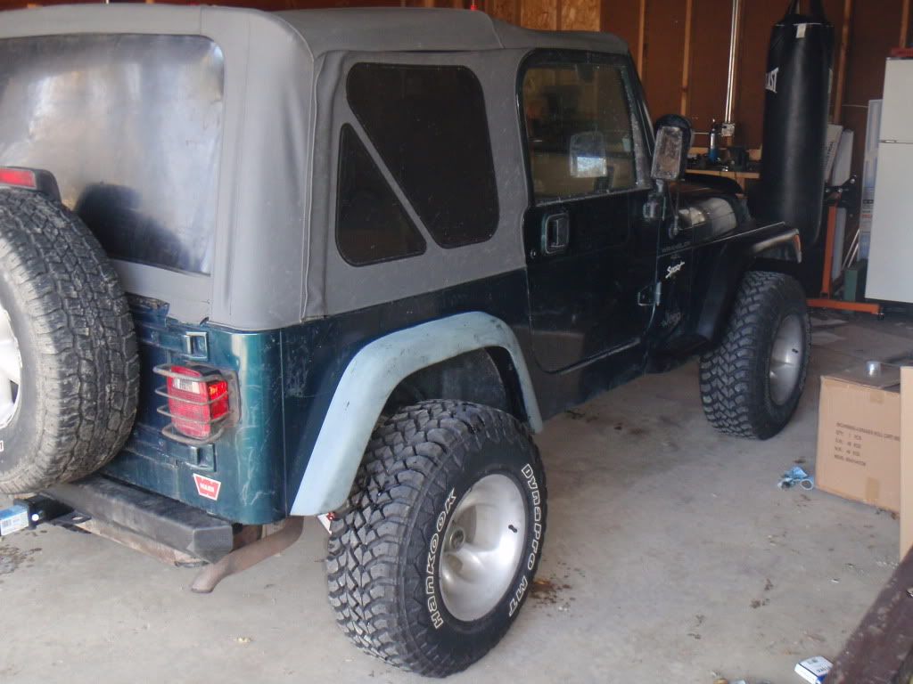

Alright, time for some updates. Didn't get as much done as I would have liked, but I was busy. For starters...my pulley squeal, or whatever it was, went away all on its own. I took it to a mechanic and they couldn't find it at all. Put an additional 200 miles on it, and I haven't heard the sound since. Go figure. I also did not get to my bumper yet, damn shame, but soon enough. Maybe Tuesday morning, since I'll have some time before my union meeting. I also didn't get around to painting the body of the jeep. Again, just ran out of time and didn't get a chance to pull the fender flairs that are in the way.
Now for the successes. I got the new wheels finished up. Brought them to Walmart to mount the tires. The duesch bag tech said it was "unsafe" to mount a 10 1/2" wide tire on a 7 1/2" wheel. I told him it was common practice in off-roading to put a big tire on a smaller rim. The schmuk said there was a liability problem and he couldn't do it. He didn't respond to the fact that they put my 10 1/2" A/T spare tire on my 7 1/2" stock rim without issue, but oh well. Called up Lovell's, dropped the car off, and a bit later picked it up. Got around to taking pictures tonight, my apologies for the darkness. I think it's a huge improvement. All comments are welcome. Here's how she sits as of today.
I miss having my tires extending beyond the fender flairs, I thought it gave it an extra level of aggression to the stance, but oh well. If there's a lot of rubbing I'll get wheel spaces.

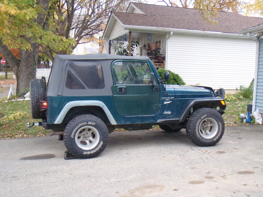

OMG!! What have I done!! As self punishment, I let the jeep run over my foot when it rolled out of the garage on the way to work this morning. I beg the forgiveness of the jeep gods. What can I say, I was half asleep last night.
