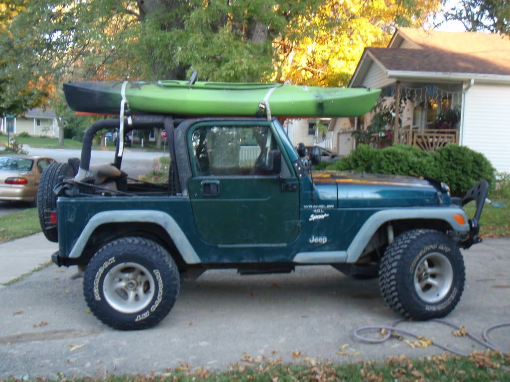

2 kayaks will fit on a tj when strapped to the sports cage.
Not gonna lie, I was a little concerned about this but, now that I know it'll work, I'm a pretty happy camper.

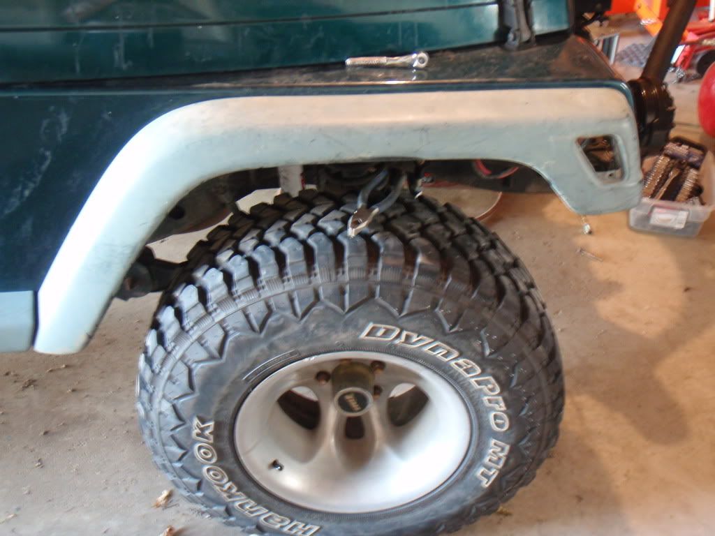

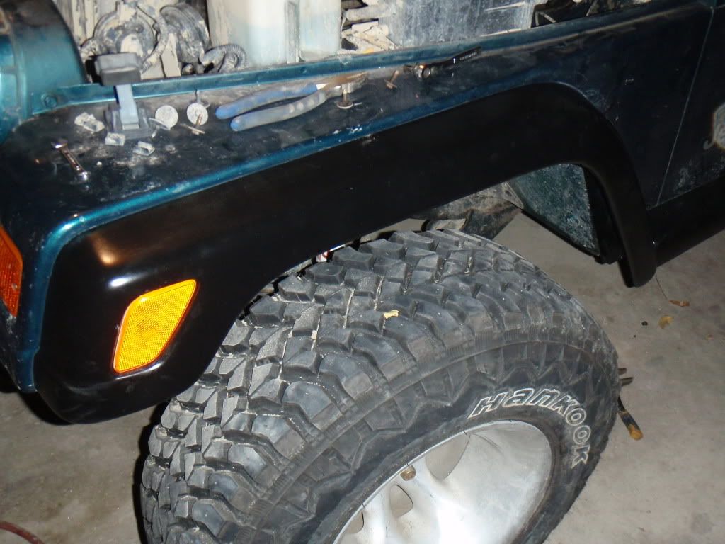

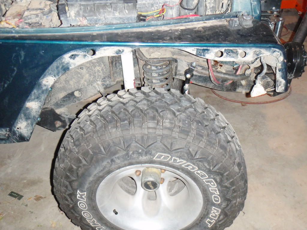

I did get to mess with a few small things. I DID get the new top mounted up, and returned my loner. And I finally took of the front fender flairs to paint them!
Taking them off was a bit more of a chore than I expected. The little threaded rivets that hold the flair into place, yeah.....a lot of those held onto their bolts and just kept spinning. Required a little loving with a pair of locking pliers, but I got them all out. They're no all back in after the fact....but enough of them are in place to keep everything secure. Here's the fender with the freshly removed flair.
I cleaned the crap off the fender before I reattached anything. Anyways. I washed the flairs with dish washing soap, got them nice and clean, then let them air dry. After that, 4 or 5 coats of Krylon Fusion satin black spray paint, and they looked like new! Got them reattached, with a few bolts left over as I mentioned, and it looks great!
The front end looks mostly like a new jeep!At that point, however, I ran out of time as it got dark and cold, so I didn't get around to pulling the rear flairs. I wish I had a profile shot but it looks hilarious with the shiny new looking front flairs and the ugly stained and faded rears. Oh well, I'll snap some better pics soon.
Today I finally had a few minutes to look at the rears. I went to unbolt them, yeah....no go on that. Looks like all the threaded rivets are just spinning in the tub. I know how to get them out...My issue is how am I getting the liner reattached after. Sadly that is not a project for an hour or two right after work as its getting cold. Going to have to save that for next weekend. Or maybe it's time to consider getting with my buddy and fabbing up custom tube fenders for the rear. ahhhh to dream.
