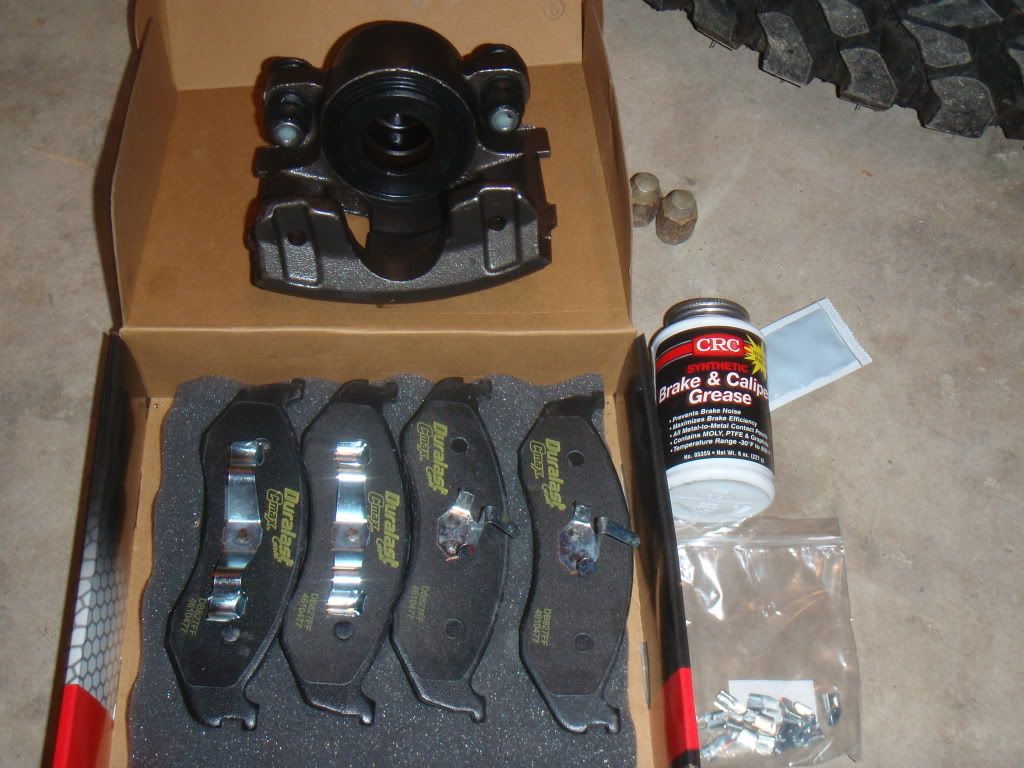

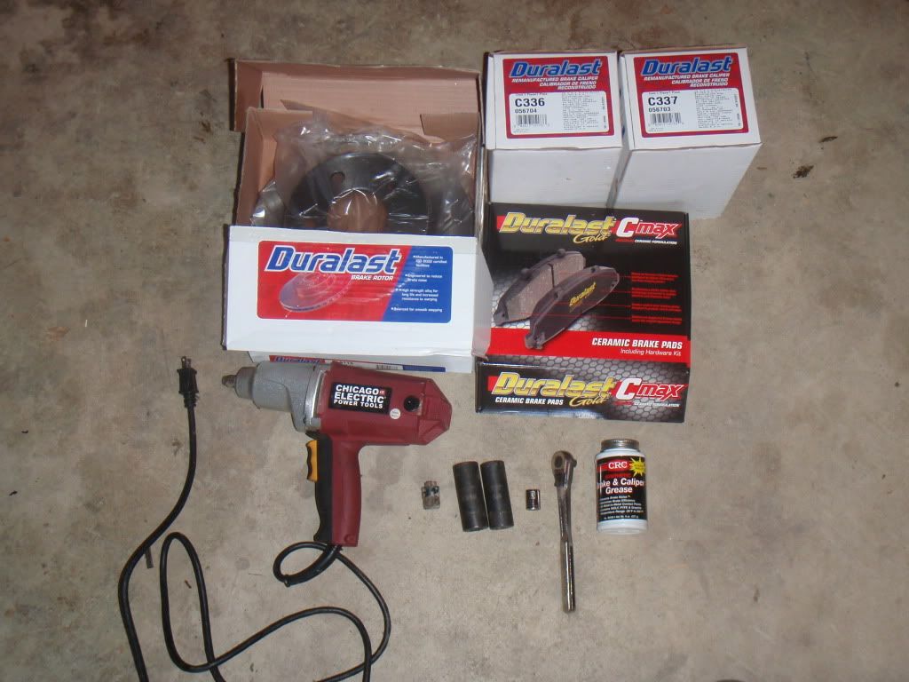

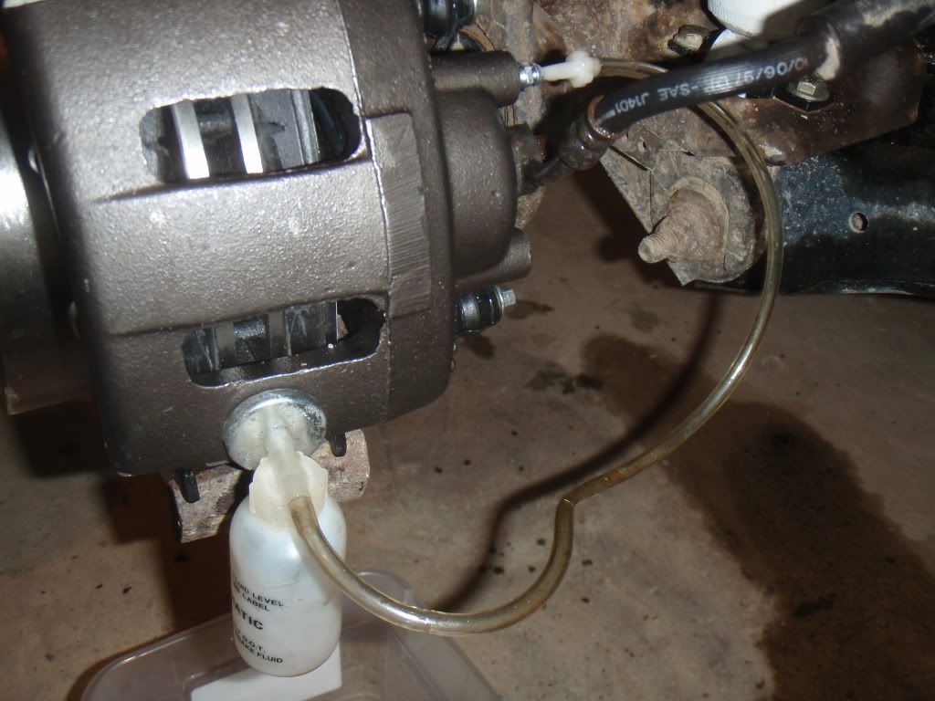

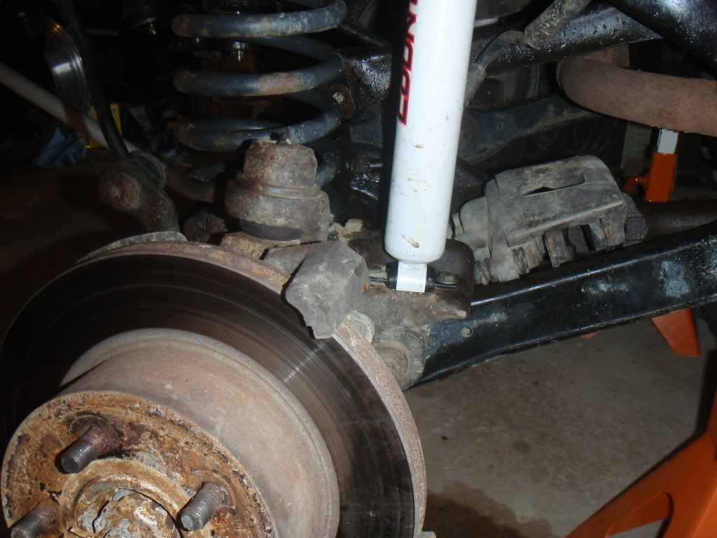

The Caliper Write Up
Alrite, got all my parts ordered from Autozone and picked the following up last night.
-Duralast re-manufactured calipers, right and left
-Duralast rotors x 2
-Duralast Gold ceramic brake pads
The following tools were used for this project
-harbor freight electric impact wrench (lug nuts)
-13/16ths impact socket (lug nuts)
-3/4ths impact socket (locking lug nut)
-locking lug nut tool (Locking lug nut)
-socket wrench
-3/8" torque wrench
-14mm socket (banjo bolt)
-13mm socket (caliper mounter bolts)
-11mm socket (replacement caliper mounting bolts)
-9mm deep well socket (caliper bleeder valve)
-brake grease (back of brake pads)
-bleeding tool
All the parts and some of the used tools.

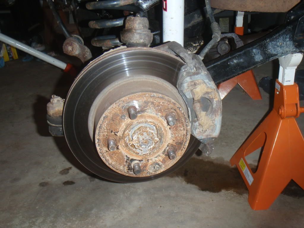

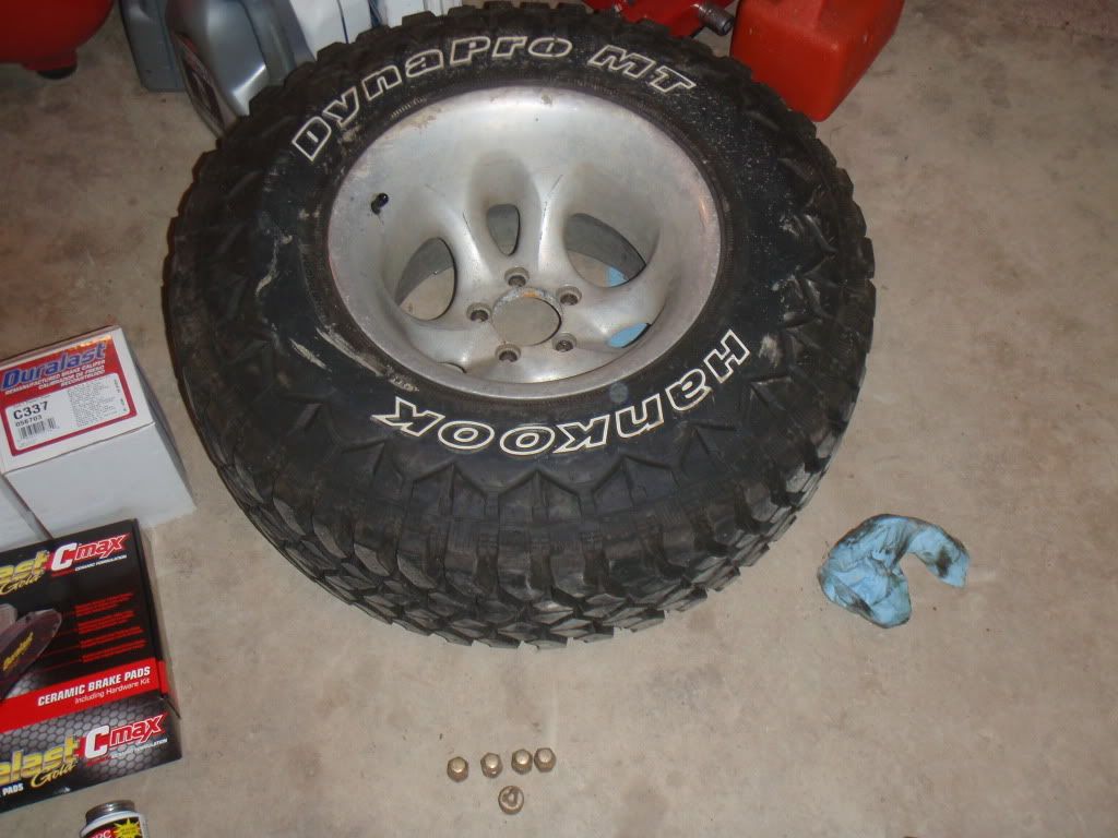

First off the jeep got thrown up on jack stands. I use my 6 ton harbor freight stands.
Next I used my impact to pull off the lug nuts from the tire. I pulled the tire off and placed both aside so I wouldn't lose any nuts.

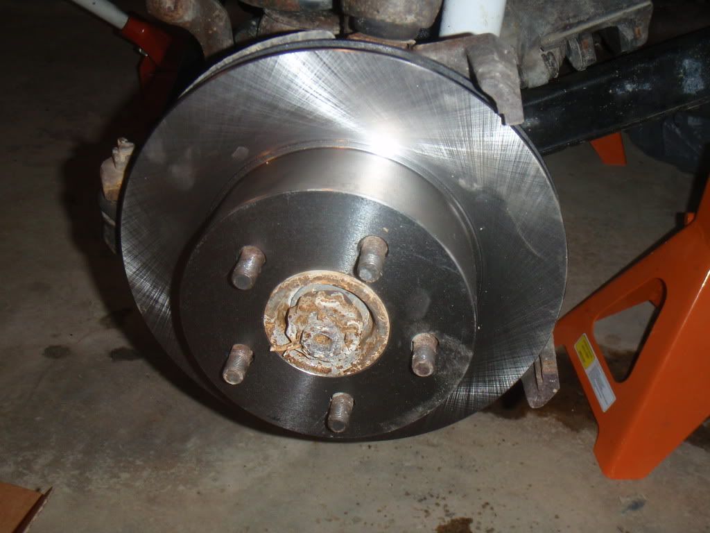

What we have hear is a very dirty hub/rotor/caliper.
Here's a picture of the back of the mounted caliper. I pre-loosened the banjo bolt that's in the middle there. It's the one with the brake line coming from it and it requires a 14mm socket. Once it was lose, I finger tightened it so it wouldn't lose any brake fluid. Then remove the to caliper bolts which require the 13mm socket.

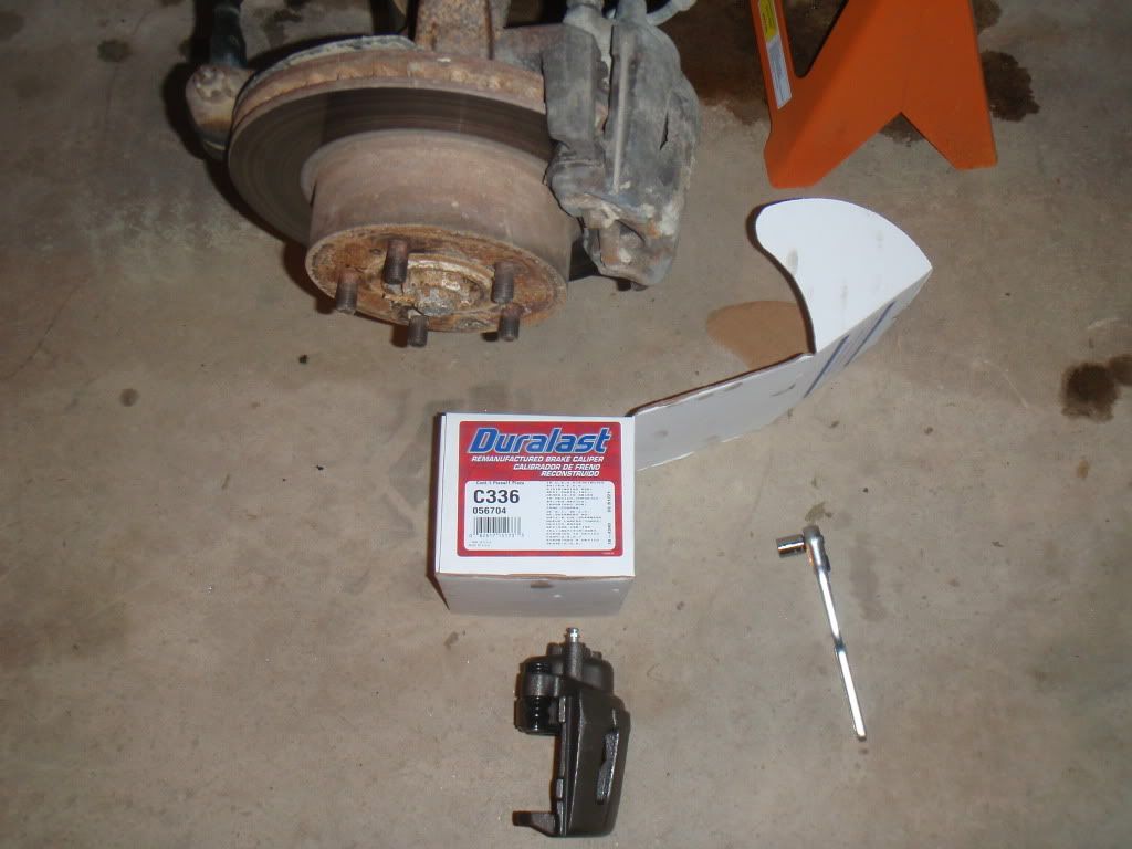

The new caliper, part number C336 belongs on the driver side. C337 belongs on the passenger side. I'm assuming this is an Autozone part specific number, so make sure you use the correct caliper for the correct side.
I removed the caliper from the hub and let it rest on the chassis.

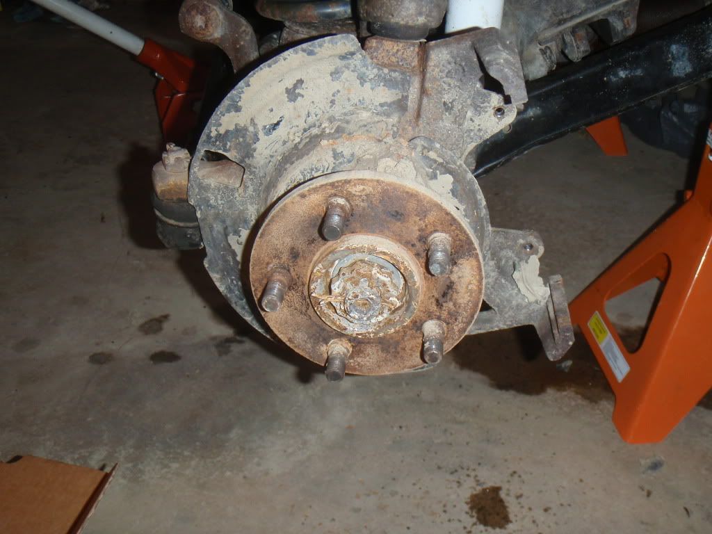

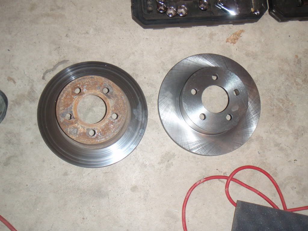

I then pulled the rotor from the hub. Mine slid off really easy. I've heard rumors of people having trouble and needing BFHs and torches. Mine slid right off. Here's the old and the new sitting next to each other for comparison to insure it's the same part.
The now naked hub.
I cleaned some of the loose dirt away from the hub assembly and slid the new rotor into place.
Time to prep the replacement caliper. Again, insure you have the right caliper for the right side. The bleeder valve should be near the top of the caliper when mounted, at least...that was the orientation of my existing one.

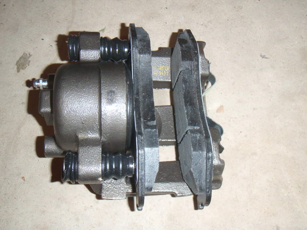

You're going to need your new pads, brake grease and the new caliper.

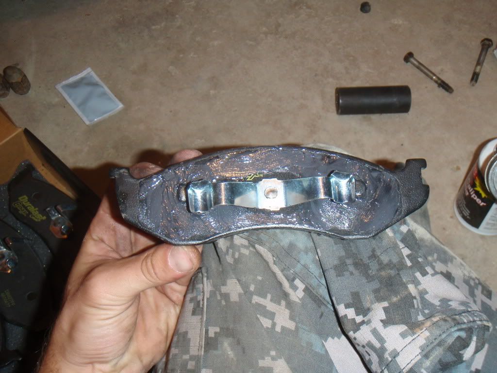

Apply a thin layer of grease to the back of the pads. DO NOT GET ANY GREASE ON THE FRICTION SURFACES.
Mount the inside pad first. It just slides right into the plunger of the caliper. Then the second pad just line up the pad on the inside of the caliper jaw, and the metal spring bracket on the outside, and push it into place. The little numbs on the back of the pad will basically lock into place on the wholes on the caliper jaw. The assembled unit will look as such.
Mount the caliper onto the rotor/hub assembly.
Install the replacement caliper mounting bolts. They require an 10mm socket for some reason. Torque them to 11ft/lbs. I guess over-tightening can lead to jacked up calipers. I've never done it or seen it, nor care to find out, so don't over tighten it.

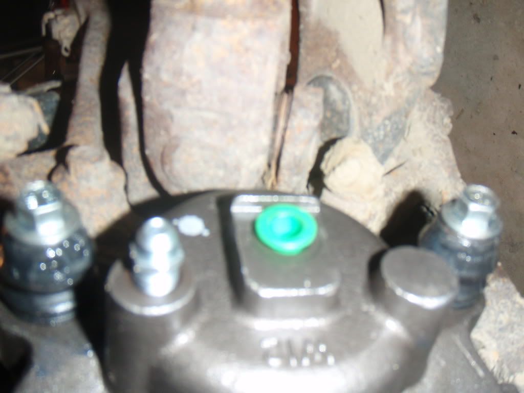

Remove the green plug, as that's where your banjo bolt is going to go. The replacement caliper should have come with 2 copper washers. The order of these on the line will be, copper washer - brake line - copper washer - banjo bolt. This next step you want to move fast on so you don't lose to much fluid. Remove the banjo bolt from the old caliper, set it up as I just described with the copper washers, then screw in the banjo bolt into the whole the green plug was in. There's only one way to attach it, so you can't scew it up. Tighten it down and discard the old caliper (or save to get your core charge back from Autozone).
Here's the caliper all mounted and the brake line reattached.
Open up the bleeder valve (loosen it), that's the little silver nipple looking thing next to the banjo bolt near the top. I used a bleed-o-matic that I borrowed from Jeffro. I guess it's only about $10.00 from NAPA, so I'll be making a purchase soon.
Just plug the bleeder hose into the bleeder nipple on the caliper. I hung the bottle using the little magnet supplied with the bottle.
Open the brake reservoir in the engine compartment. Now pump the brakes and watch the bleeder line. When you stop seeing bubbles in the line pump and the bottle fills about 2/3rds of the way, the line is bled. Remove the bleeder line, tighten up the bleeder valve on the caliper and discard the excess brake fluid appropriately. Top off the fluid reservoir in the engine compartment, put the cap back on, re-mount the tire, take the jeep off the jack stands, and you're done!
Repeat the process for the passenger side.
I let her roll down the driveway real slow, and brakes work great. Took her to Autozone to return my caliper cores and the tugging to the left is finally gone. The one negative thing I discovered is, when I still had the jeep up on stands, my driver side wheel has play to it. I think I need to replace the wheel baring. The passenger side is still good, but it's another thing that needs addressing. Such is the life of a jeep owner I suppose.
Any feedback if this was worth reporting, or if I should have kept my pics to myself and just told you I replaced the calipers, is welcome and appreciated, lol. It'll determine if I document future projects as thoroughly, more-so, or less-so.
