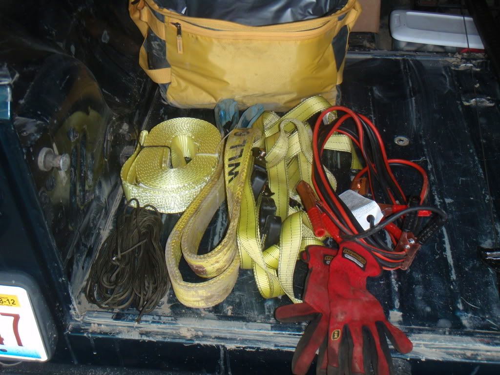

Here she is after a little bit of cleanup. You can see my soft cooler in the back. When it isn't holding drinks and food I stash my day to day jeep emergency stuff in there so it isn't just rolling around the back. It might not be secure...but nothing in there is super valuable either. There's also a small plastic box behind the passenger seat. It's just extra ratcheting straps for hauling my kayaks and the like. I haven't strapped a yak to the cage yet....but it's just a matter of time.
Here it is broken down. 20ft tow strap, an unknown length of 550 cord, 6 foot tow strap/ winch tree saver, heavy duty ratcheting straps, some mechanics glove, and a set of jumper cables. Just on the edge you can see the high lift jack and my CB antenna. They're not really secured well yet...but give me some time, I'll get them taken care of.
This is my tire repair tool kit. Small compressor, plug kit, extra plugs, valve stems. I just used the top flap from the compressor case to strap it to the cage in the rear above the wheel well. Keeps it nice and secure and out of the way. You can also see one of the 2x6's I have in the window wells. They're actually pretty well secured. I have them in there for the jack, temporarily until I find a big flat piece of steel I want to use.

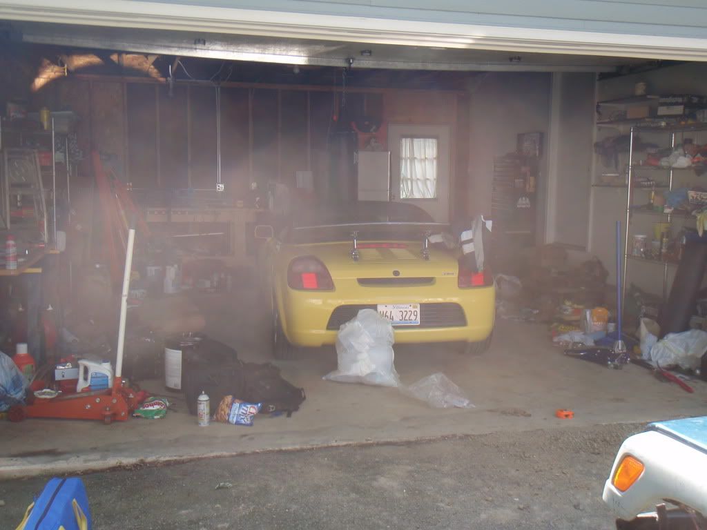

Well, garage clean out...is going to be a looooooooong process. I clean it out really well about every 4-6 months. This was a 6 month stretch. This is what I started with.
I cleaned up most of my tools so far, tore down the temporary work bench on the left of the garage, taken the old kerosene cans out and put them along side the garage next to the garbage can (I'm never going to make that flow bench like I told myself I would), cleaned up most of the garbage and beer bottles (and yes there were alot, I don't drink and drive, I do however drink and build. Perhaps even more dangerous. ), organized at least 2 shelves of tool/parts racks.
I managed to go from a 1 small car garage to this.
Still a ridiculous amount of work to be done. All my racks are still in complete disorder. I need to get rid of my junk metal pile, turn it in, do something with it. I need to do something with the torn apart engine sitting in pieces on the rack in the back, sell it, scrap it something. still have to clean up the entire back quarter of the garage, because there's still junk, garbage, misc parts, pieces and tools laying around. Figure out what I'm doing with all the heavy pieces, the cheery picker, floor jacks, engine stand, O2 compressor, tool chest. I don't know what I want to do, I just know I don't want it how it is :P. Maybe it's time for me to finally break down, and paint the floor with that Rustoleum stuff....I've always wanted to and ya know what they say, there's no time like the present

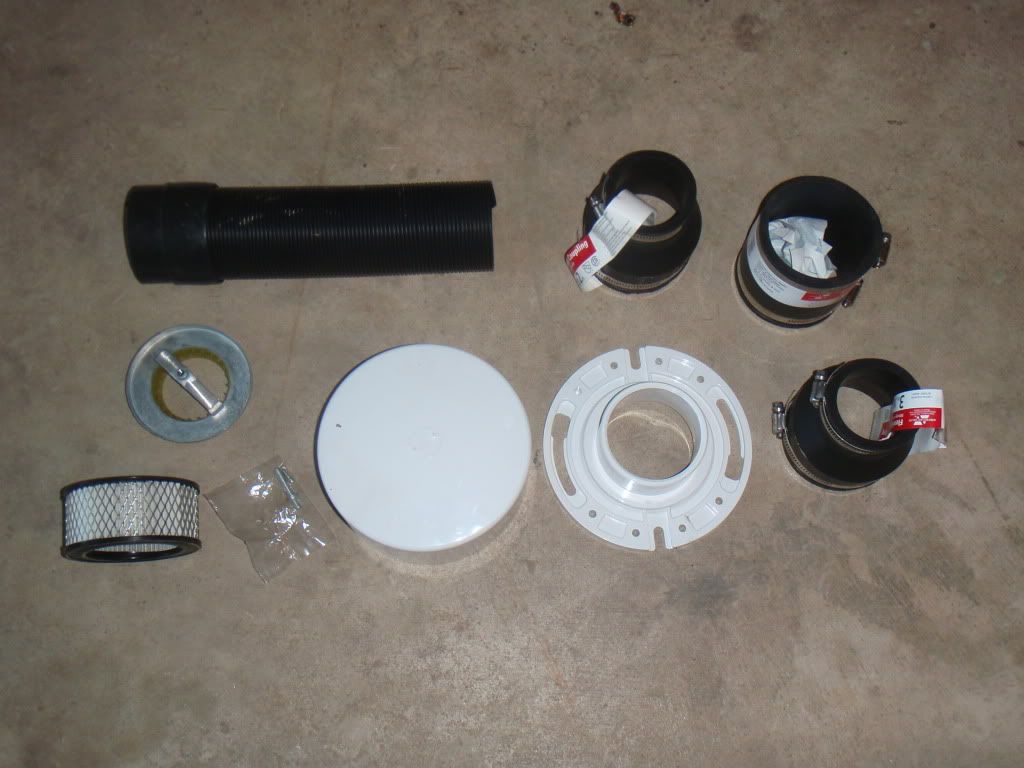

Alrite. Here's the news. Some initial small items I purchased this weekend.
Parts for my home made Hummer clone snorkel kit. My big issue with this is that it will remove the air box and I don't know if the surface area of the filter element will be big enough to get the proper flow to the intake manifold. If it doesn't (and lets face it, it probably won't), I'll most likely modify the stock box and just end up using that. But that was part of the point of the snorkel project. Get into a little bit of tinkering.

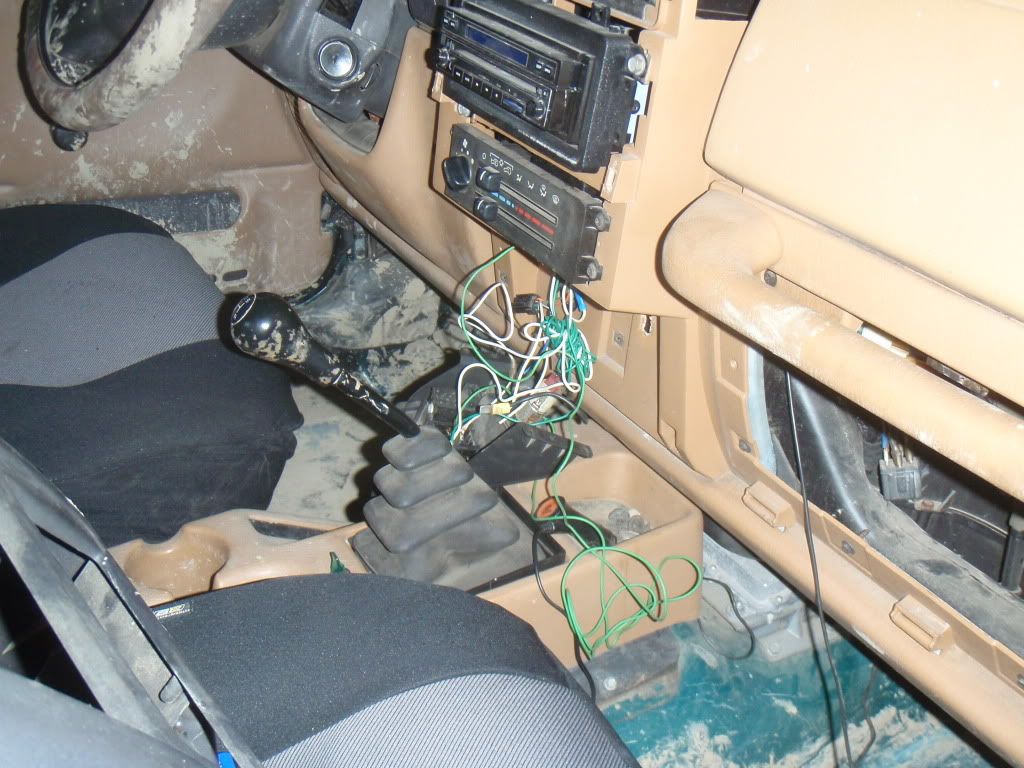

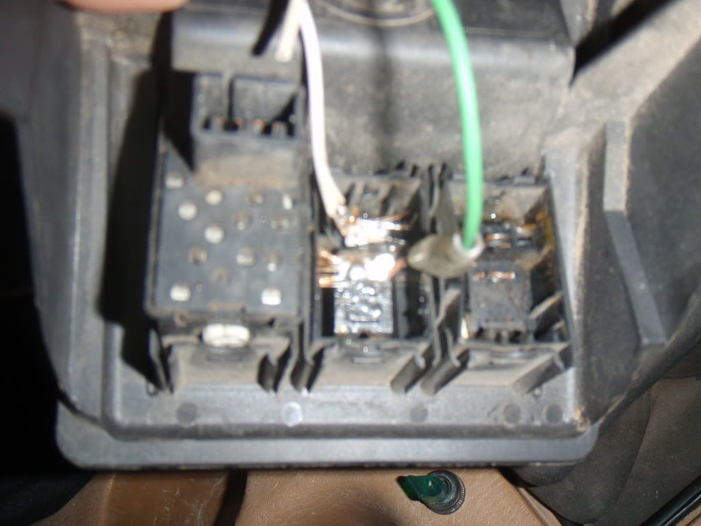

And next up, last nights fiasco. This is what I found when I cracked open the dash.
At some point in the relatively near future I need to clean this up. I've decided I'm going to use one of the empty slots in one of the fuse boxes and wire the lighting through that. The guy who did wire it...well, apparently he thought this solder job was better than actually wiring up proper connectors and actually hooking up a switch like you're supposed to. Yes it's blurry, but it gives you an idea on how much solder just got puddled on. No wonder something got blown.
I also took a look at the fuse box behind the glove box in my search for the fuse I blew when I reconnected one of the unconnected switches. Not only did I not find it, I discovered a lot of what should have been 10amp fuses had previously been replaced with 20 and 25 amps, and a few 20s were replaced with 30 amps. Add replacing nearly ALL my fuses to the list of things to do. Plus tearing out all that wiring and rewiring it properly. Can anyone suggest if it would be better to make a dedicated wiring harness right to the battery for the lighting/winch, or tap into the existing harness? I haven't researched it yet(don't worry I will) just curious on other's thoughts.

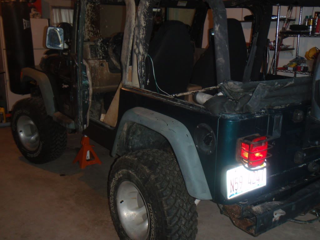

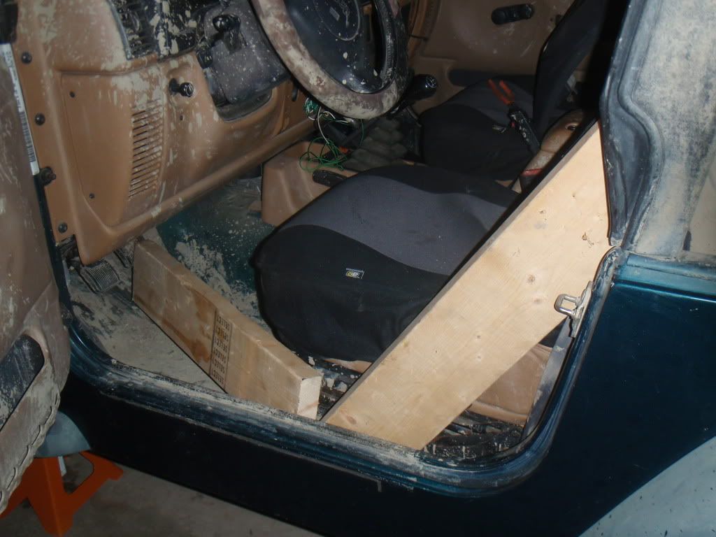

Tonight....is a hillbilly rig my jeep night. So I jack it up, throw it up on my 6 ton truck stands. I spin both front tires, both spin freely by hand. I assemble this lovely contraption to engage the brakes because I don't have a second set of hands available tonight.
Yes, that's a pair of 2x6s that I carry in the jeep for my high lift. And in case you don't believe that actually engaged the breaks.
Anyways. I walk up to both tires. Spin the front driver side, it's extremely tight. What should happen when you spin a tire with the brakes engaged. Walk to the passenger side.... and it spins freely as before.
Well, that would make sense considering the Jeep pulls to the left when I hit my brakes. I guess I'm learning how to replace a set of calipers now. FYI, I hate bleeding breaks. If anyone within reasonable distance of Dekalb Illinois has a speed bleeder and likes darn good BBQ and beer, or just really likes bleeding brakes, please come help me, lol. I'll be pricing those out at the local stores shortly. Now I just have to decide if I wanna do pads and rotors as well... definately pads, maybe not rotors... I guess we'll see.
