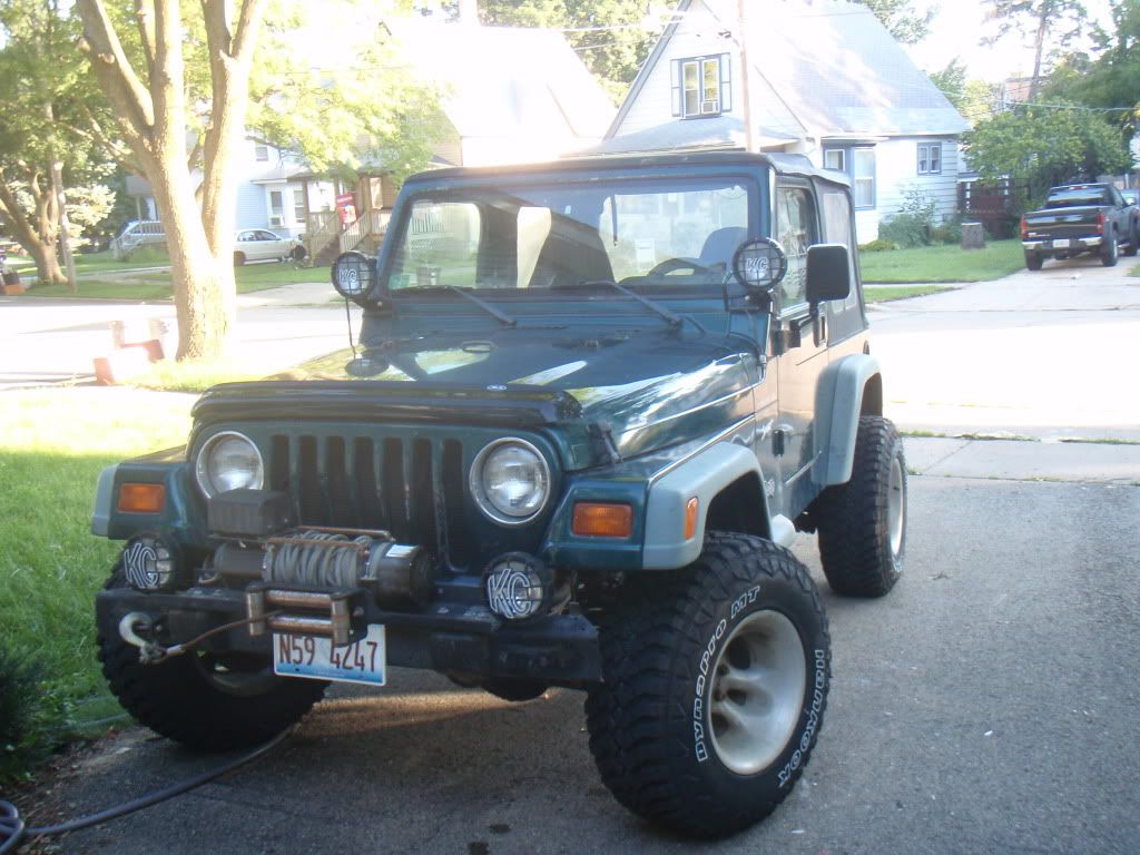

Update time! I got all the hardware mounted and got some pictures. Also got the tires mounted!
New overall.
I know it's a trick of the eye, seeing as I went from a 31" to another 31" tire, but it just seems like the TJ is taller and there's more space under the fenders. I've put alllll of 60 miles on them so far. For those who don't know, or in case I'm just that retarded and forgot to post it, I got Hankook DynaPro M/Ts in 31". My review so far is pretty strait forward. They drive and handle great! Better than my old crappy A/Ts. I haven't noticed an increase in road noise, and I've driven it completely buttoned up, and completely topless. Also gotten a little bit of highway time back and forth to work, fastest i hit was I THINK 65mph, at least according to the speedo. I'm pretty sure when the tire size was boosted to 31" from stock, the speedo wasn't changed so the speeds are probably higher. The lack of road noise is a bit of a surprise because the tread pattern is pretty aggressive. I didn't think of photographing it, especially seeing as all you have to do is google it to see it. Buuuut, maybe I will later, just for the sake of thoroughness, adn post it up later. Annnnnnd end the first review. Time to put some miles on, drive it in the rain, mud and snow, and a little more highway time.
The new tire itself, mounted.

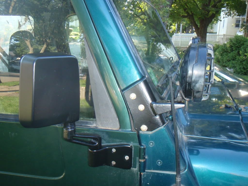

And my mirrors, though you can kinda see them in the previous pictures. I'm going to have to sand em and paint them again I think. You can definitely see oil spots where I touched the mirrors prior to priming...and probably after priming. Note. Don't touch painted surfaces with bare hands.

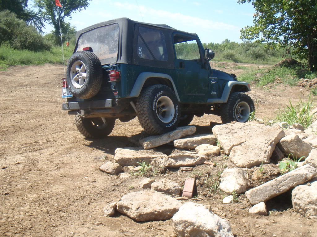

Started off by playing on a rock pile. Seemed like a good idea and it really was a lot of fun. Scary as hell, but fun. Not used to driving on a pile of objects with sharp edges. I was just praying I didn't pop anything. I did finally get to stretch a little
Played just a little bit around the edges of the pile, I wasn't yet feeling brave enough to clear the top of the pile. Sat and watched a bunch of ATV's playing for a bit, then continued our adventure. Worked our way around the park, bypassing the big mud trenches that appear to be there so people can get their mud fix if they feel the need for one. I did not at this point in the day. Did a full lap of the exterior path of the park with no major incidents. Never got stuck, didn't break anything, didn't need to even look at the winch. It was almost too easy, still a lot of fun though. But we couldn't go through just one lap and NOT play a little more.
So back to the rock pile to play some more. I was feeling a lot more comfortable at this point so over the top we were going. I wish there were more pictures, you think since all Jake had to do was ride shotgun he'd have been all over taking pictures, but alas, there are very few. Anyway, so over the pile I start to head, get to the peak, a rock shifts, the jeep slides to the left a bit....and I hear a rush of air. : I look at the tire from my door, I don't see anything yet. I back her off the pile as quick as I can trying to avoid breaking anything else. I get her back down to the dirt. I find the problem right away.

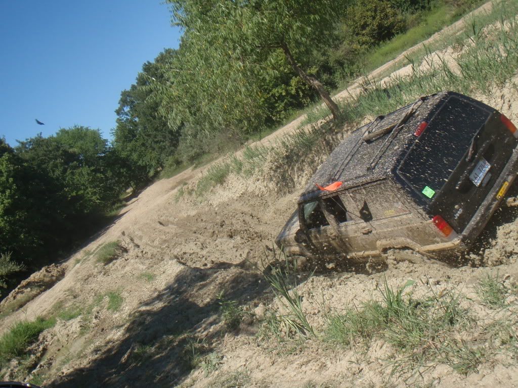

We continued on, climbed some stuff, drove through some puddles, then arrived at the big trenches. Apparently Pat's a mud person, because he dove right in. I figured, hey, I got new mud tires, lets see what they got. I played right along. Made it through the water hole no problems. The thick mud however... I needed a tug.
And our new friend getting good and stuck.
And the playing continued, our very intelligent stock friend just watching. I started getting cocky and stupid. Went through a bug mud pit, got through no problem, then there was a hump and another one right in line. I barrel into it full speed....and hit something. I'm completely stuck. I pop my head out and this is what I see.
There are no words as offensive and horrifying as the slew of curse words uttered from my lips when I saw that. I blew the bead on both sides of the tire, and now I'm terrified a jacked up my brand new tires. Pat drives around to tug me out, if he can and goes to drive through this dinky LOOKING little mud pit, instead of taking thirty extra seconds to go around the pits. He gets stuck. and I mean REALLY stuck. He managed to bury both differentials completely in clay. The little stocker grabbed the tow strap and tried to tug him out, no good. We were going to try the winch, but as it turned out, his winch didn't actually work. No one had a shovel. This was turning out well. Thankfully after maybe 45 minutes of digging, a good samaritan showed up, and tugged me out. We pulled the 31" spare out again, mounted it up and repositioned to help out Pat. A good hour and a half total digging time, finally I parked mine in front, winched up, and tugged him out.
The final damage amounted to 2 of his fender flairs completely broke off, another half broke off, half of his front bumper cover was torn off. We decided enough was enough, we'd head to the creek off of the parking lot, wash up a little, and then call it a well abused day. We made it to the creek when Pat advised me of the next problem. His Jeep was drawing from the battery, and his amperage was dropping quick. His alternator was dieing on him. Apparently it had been a common occurrence, because he had a spare in his jeep. He did a quick splashing lap in the creek to rinse off and parked it for a minute.

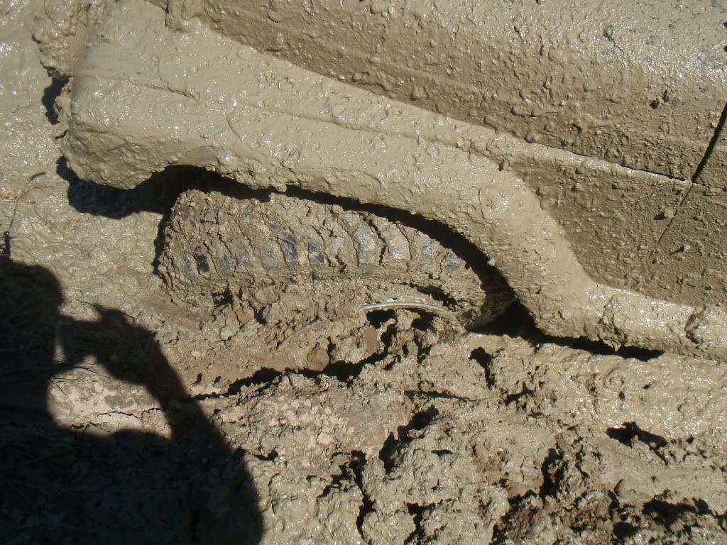

I did the same, and tried to clean some of the mud out of my unmounted tire to decide if it would be possible to remount it, or if I was going to half to tricycle home on my 28" spare. Our stocker friend decided to play in the water, and started playing in the deeper section. Low and behold, he got stuck. After rocking back and forth trying to get out for a while, the jeep actually began digging itself lower in the water. After a few more minutes of that, the jeep just died. Sadly he didn't give anyone a chance to get into position to tug him out. Before me or Pat could get into position to tow him out, a nice fella in a Suzuki Samurai back in and towed him back to the lot. Me and Pat decided we'd head to the lot, he'd swap his alternator while Phil tried to get the stocker running again, and we'd all get out while we could. I swapped over to my little spare and back to the lot we went.
This was taken from home,but gives you an idea what it looked like.

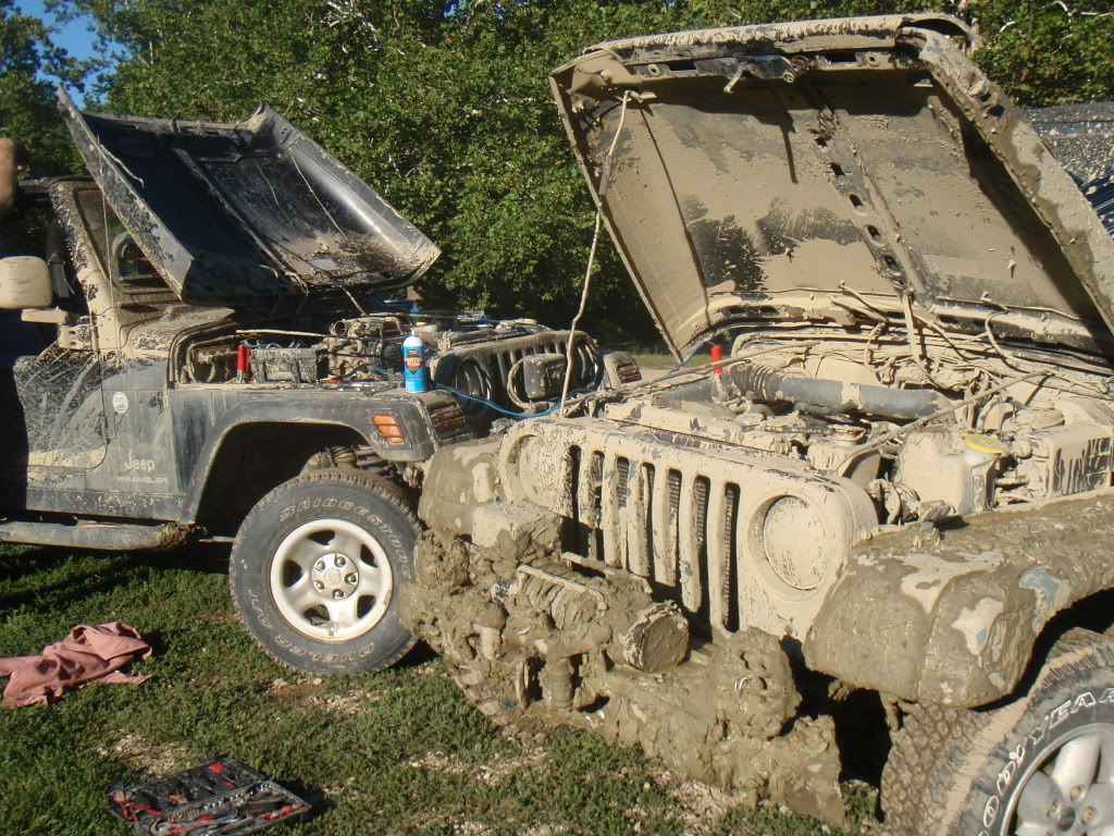

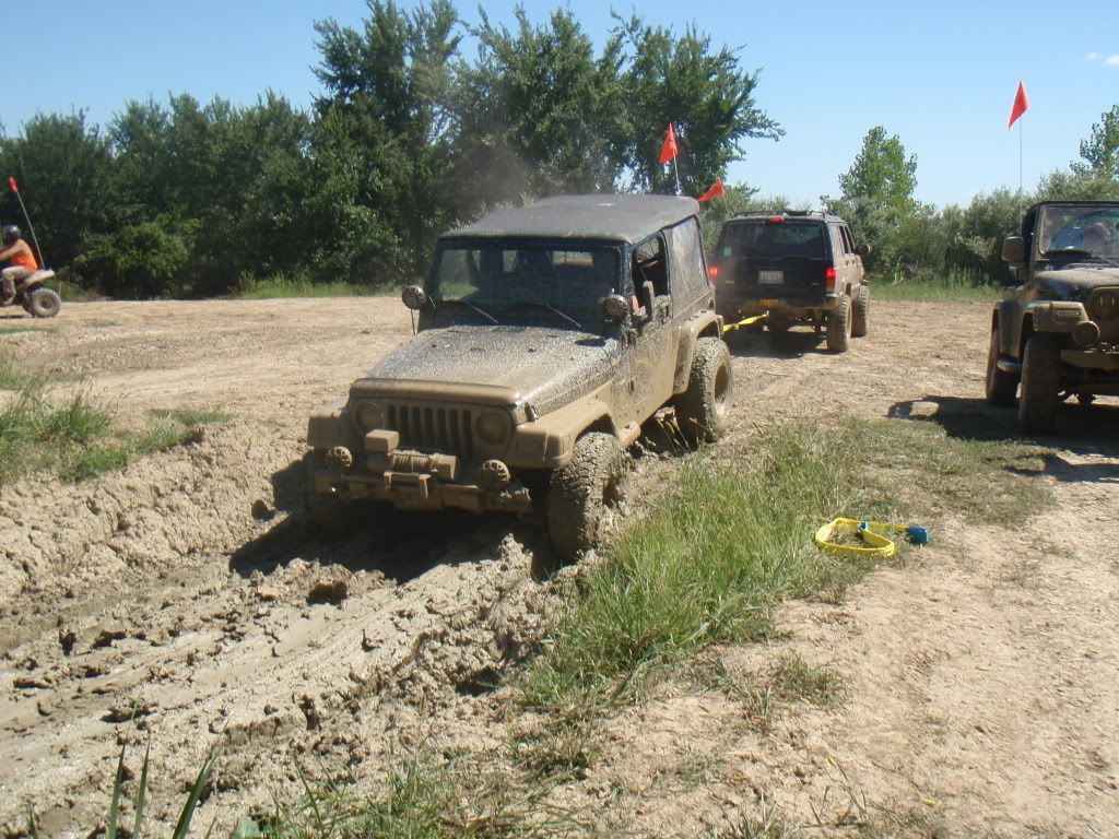

So we all powowed, shared tools and did our best to get everything fixed. After a while of cranking the stocker, Phil managed to kill the battery. I hooked up to him and revved my engine, and basically my jeep and his starter trying to get it running.
Finally we have to give up. I unhook, and park my jeep. It dawns on me if we were pulling that much current...maybe my battery needed to charge a bit. Yup...it sure did. All I got were a bunch of clicks. The park was now trying to close, and the last employee tried jumping me with his little S10. It wouldn't do it. We ended up push starting it and getting it going. Our stocker friend got towed back to the garage for the local mechanic to try and fix it. Pat got his alternator in. All parties involved swapped names and number, of which I lost most of on the drive home...stupid cell phone...but it was still a great day, even if filled with disasters.
I did find out later the stocker got back to the garage, had his battery charged, and it started right up. Lucky guy.
Me however, lol. I got home, turned of the jeep and tried to start it again, nothing. Battery was dead. I through the trickle charger on and let her go. I have a thread up in the TJ section to diagnose that one. I'll get to that adventure in my next post.

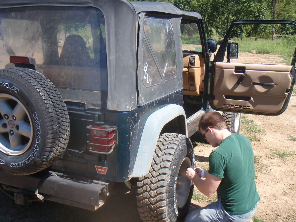

I learned two new ways to mount a tire in the field. One is using a ratcheting strap and an air compressor. The other, which I tested on my 28" spare (and only because I discovered it's suffering from dry rot and I should NEVER have driven on it) starter fluid and a lighter does set a bead very effectively. And a $6.50 Walmart tire balance on my front driver side tire, and I'm good to go!

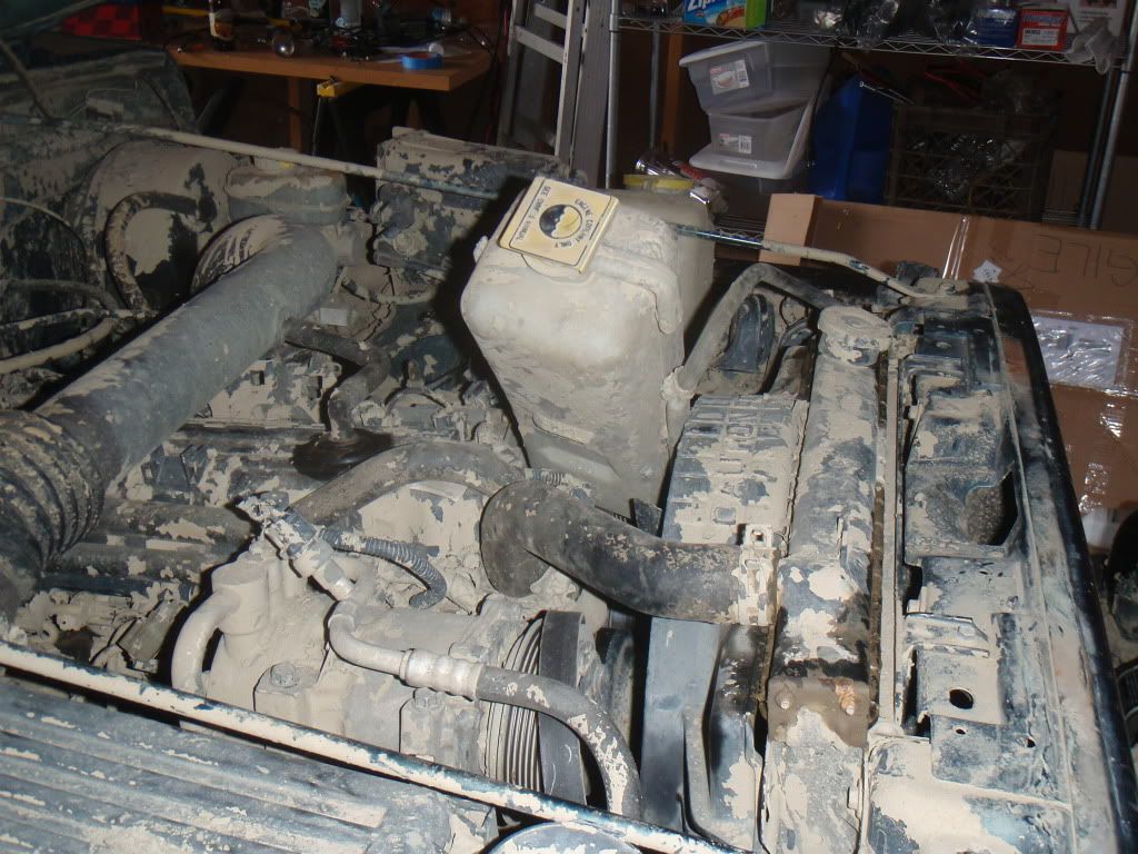

I made a little extra space for this project by yanking the coolant overflow reservoir. Thankfully the hose on it has enough play to let me just lay it on the engine.

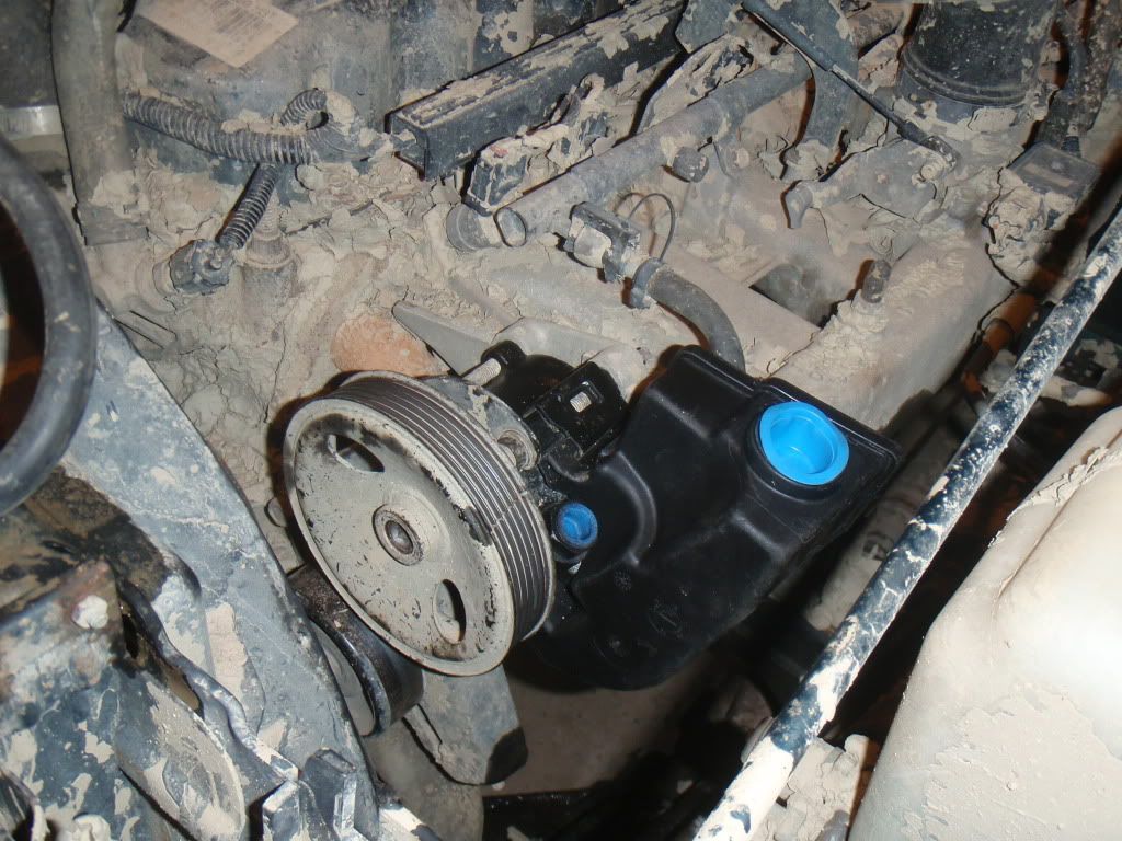

Start out by disconnecting the hoses from the top. I successfully managed to break the plastic nipple of my power steering pump. Well sunuva........ This project is clearly going well. I call Autozone about a replacement reservoir. They don't carry one, only the full pump unit. I call around town and Napa carries the reservoir for $30. Autozone's replacement pump is $50 after yet ANOTHER discount. New pump it is! I go to Autozone, pick up the new pump and a pully puller kit.
I yanked the pulley off the old pump.
And mounting the pulley on the new pump.
Everything buttoned back up.
