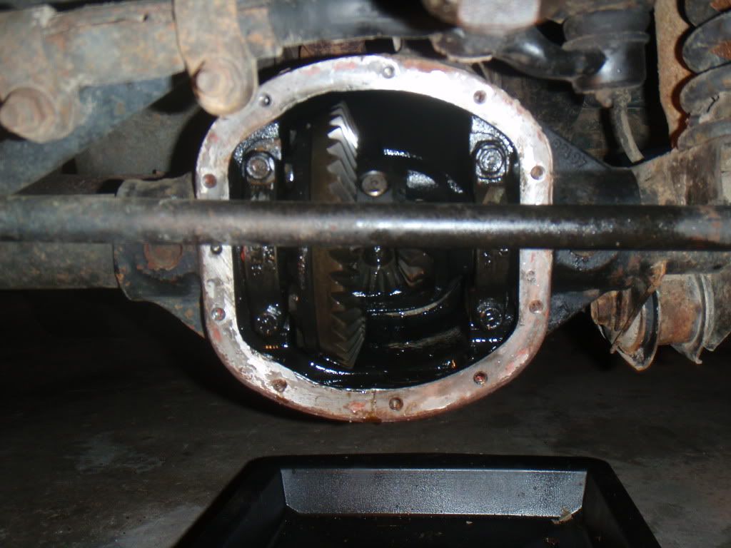

My neighbor also came over while I was sealing the diffs back up. She's renamed blue RTV as smurf poo. I thought it was appropriate.

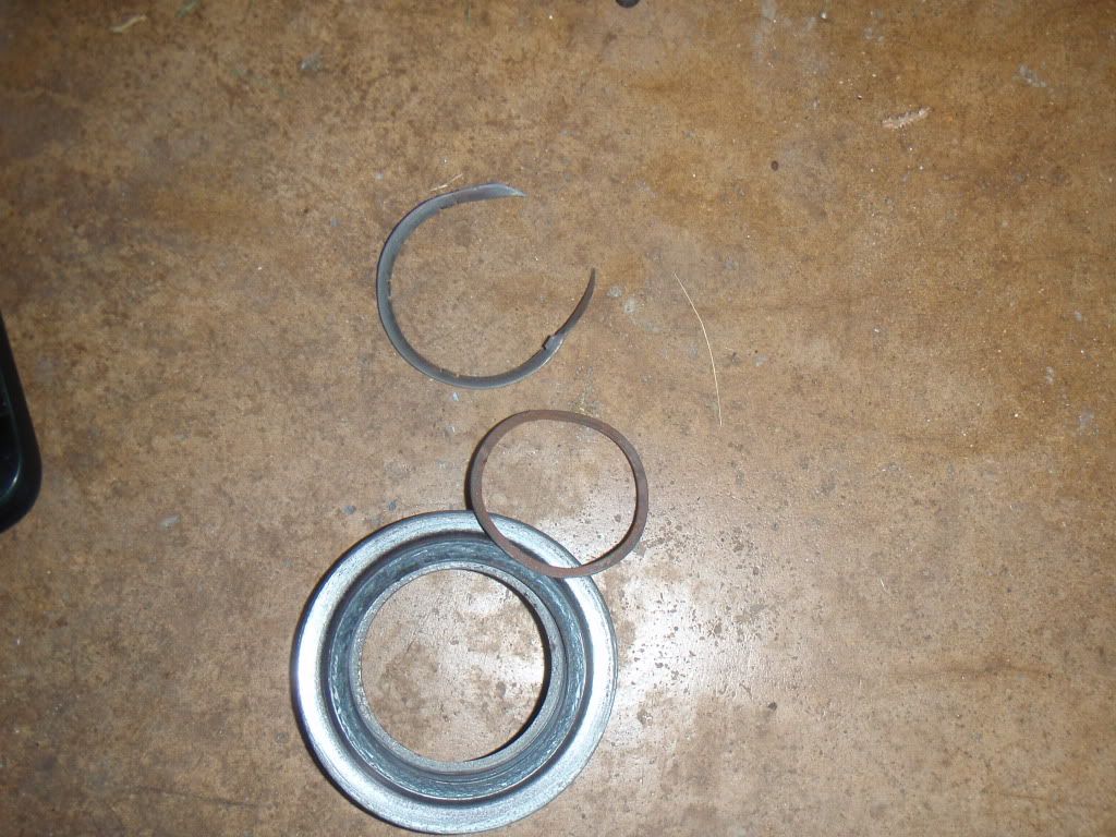

Before I refilled the rear differential, I decided to fix the leaky pinion seal that we found in our going around the vehicle. $15.00 at my local Jeep dealer (I went to 3 local autoparts stores, no one carried a rear pinion seal for a 98 TJ. Now that was rediculous) That, surprisingly went really smoothly. Minus the fact that there's STILL mud coming out of every nook and cranny of my undercarriage, ESPECIAlLY when I'm wrenching on anything, the procedure went relatively smoothly. The only stalls I had where the old seal and the new seal. Had to run out and buy a seal puller from Autozone, because I couldn't yank the old one with a screwdriver. My other issue was putting the new seal in. It said in the write up I found, just tap it in. Well, tapping involved a couple 2x4s and a big rubber mallet. Took me a while to figure it out. I tried just tapping the seal itself with a mallet, but it would go in strait, then a pair of 2x4s around the edge of the seal got it seated, then I just went around the edge with the mallet until it was in place. After that reassembly went smooth. Filled up the diffs, and took her for a spin around the block. Checked everything, no leaks drips or anything else. Good sign.

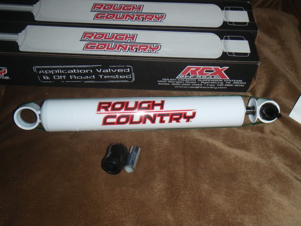

Anyone I open her up and see a beautiful sight.
Mmm, my new Nitro 9000s. And low and behold, no boots. I check my receipt, yup, must have forgotten to order them. I could have swore I checked the box online for 4 black boots, but oh well. I hop online real quick and put an order in for my boots.
I make a quick run to Lowes to get grade 8 hardware, get in line to check out with a handful of bolts... and can't find my wallet. It's still sitting next to the computer from my boot order. Another bout of profanity leaves my lips. I step up to the service desk, tell them my plight, and tell them I live a few blocks away. The saintly people agree to hold onto my parts while I run home. A few short minutes later I'm back, and leaving for the second time, bolts washers and nuts in tow.
I want to have functioning shocks on the jeep already, so I decide to start installing them as is, and go back and put the boots on later.
I start with the rears, seeing as I'm still missing one. I pop the old one off just to get a feel for how they mount. Seems easy enough. I install the top mounts first (interesting side note, everything on this jeep has been imperial sizes, but for some reason the threads for the top shock mount are metric threads, someone PLEASE explain that one to me ), then cut the plastic strapping used to keep them compressed. As it expands I line the bottom mount up with the lower bracket...and it's to tight to slide right in. A few minutes later with small pry bar and a rubber mallet and everything's in place and the bolt is in.
I tighten everything down and slide over to the side that was missing the shock. I go to put the first bolt in place up top to start it to mount the shock... and it'll only go in a few threads. I break out the shop light and realize the threads are caked in mud still. I break out the Q-tips and some water and start scrubbing them out. I get them both relatively clean. Mount the shock up, tighten it down, alright another victory. Get the bottom mounted, same procedure. Alrite, I have rear shocks again. Check my watch, it's 4:30. Annnnnnd I've gotta be outta the house by 5, so I pack up for the night.

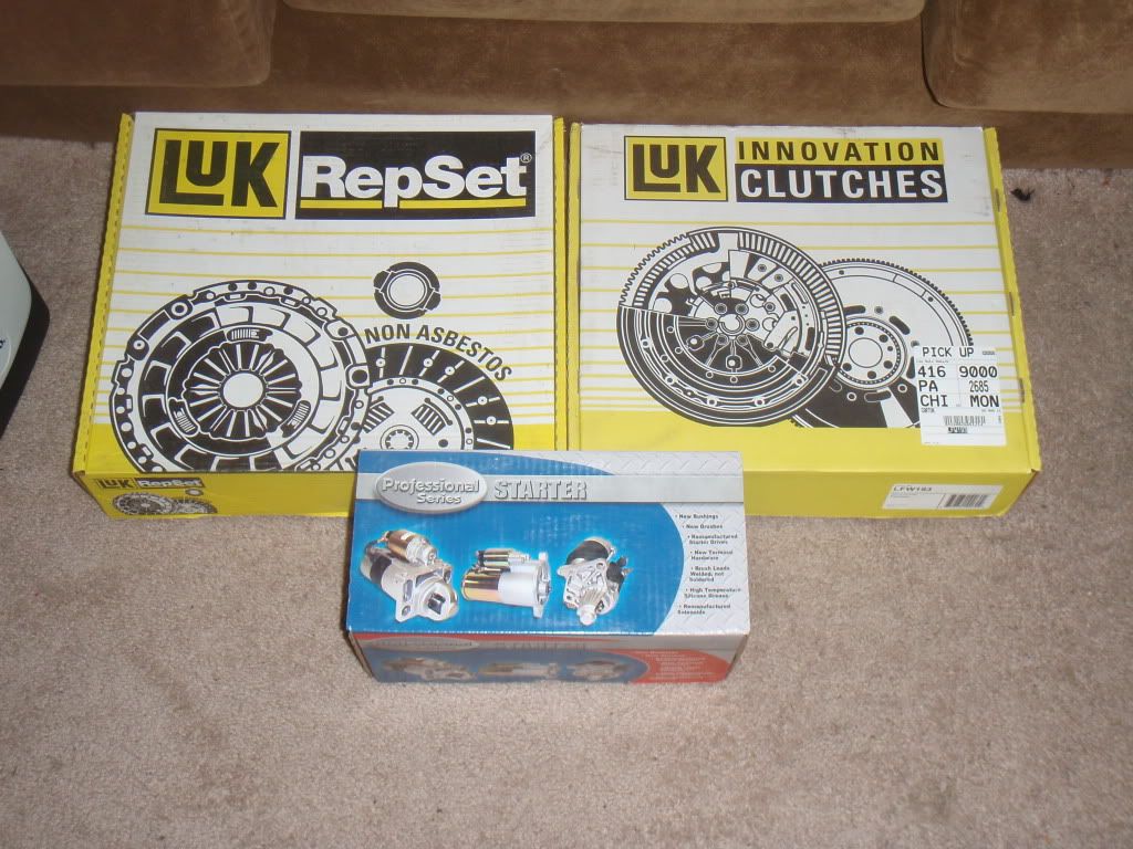

Monday comes along, and then goes. After a little net search I find out there's a Lee's auto about 3 blocks from my house. Didn't even know it existed till the day before and it turns out it's the closest parts store to me. I give them a call and they say they can have all the parts I need on hand by the end of the day. I show up after work, and I get a big stack of boxes.
$132.99 for the clutch kit, including pressure plate and bearing
$72.87 for the flywheel
$94.89 for the starter.
Grand total of $362.61 after tax. The cost of the clutch kit alone for my Spyder was over $400. This was GREAT news for me. I bring everything home, and naturally, like any kid on Christmas, take a look at what I have.
Everything lined up nice and pretty...well, pretty as fairly plain cardboard boxes can be.
And everything opened up.
No surprises there. Everything I need appears to be in place. I leave the parts in their wrapping. No need to mess with any of that till install time. Now I just have to wait until this weekend to get started. It's going to be a painful week.

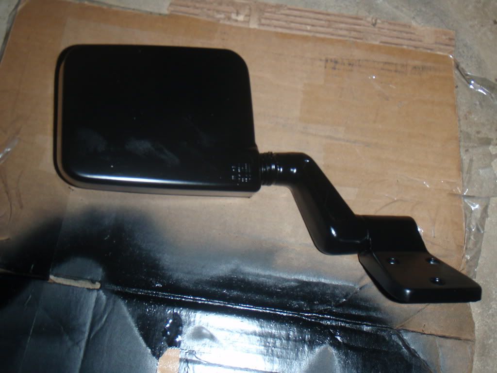

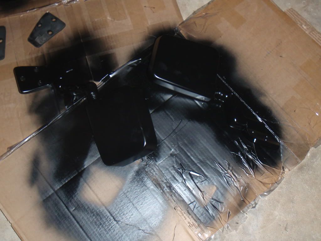

After all that, I get home and decided to start by painting and touching up my mirrors and spot light mounts. Here's what I had to work with.
And after a little grinding.
http://i1216.photobucket.com/albums/...3/P8050003.jpg
And Devin (the buddy I bought the Jeep from) came over to help out. Lots of sanding.
Devin goes to remove the passenger side spot light mount, but he ends up stripping out one of the hex screws. I'll have to drill/easy out it later. So I'll continue to have one rusty mount for a few more days.
I'm a big fan of the Krylon product line soooo, a can of Krylon grey primer and flat black got pulled out.
I wiped everything down with acetone, then sprayed 2 coats of primer on each part.
And then next morning a coat or two of flat black.

Alrite, I'm not at all happy with how the flat black turned out. Soooo I busted out the can of satin black. Of course, in the name of making sure even the simplest jobs are made unimaginably complicated, all the bolts holding the spot light mounts, stripped out when I put the allen's in place. After a trip to Lowes for a new easy out to replace my existing broken one, and about and hour and a half of drilling and jacking around, I got the brackets off. Some more grinding of the rusty bracket. Then a couple coats of primer. Then a bunch of coats of the satin. No pictures right now. I still need to get new bolts and get them mounted up. When that's done, I'll snap a few fresh photos and get them posted. So far, everything I've done looks good. I still need to re-tape the mirrors so I can spray the bodies down with the satin. Couldn't find my painters tape. I'll dig around tomorrow and finish those off, then those little items will be done.

Alright, quick update. Re-taped up the mirrors again with an old piece of target, since I couldn't find an old newspaper around. I cleaned everything up again, and wiped everything down with acetone. Sprayed a couple coats of Krylon black Satin on the mirrors and a last coat on the spot light mounts. Everything looks to be coming along really well. I snapped a few quick photos.
Side note: uploading to photo bucket and THEN to here, is a HUGE PITA. Thankfully I'm actually really enjoying keeping this updated and documented. Probably the only reason I have been continuing to upload the photos.
Everything laid out after a few coats.
One of the mirrors after having dried for about an hour. I seem to be having trouble getting rid of some light spots. I have a feeling that has to do with paint prep. After all, I am still pretty new to the painting thing. Practice comes perfect.
