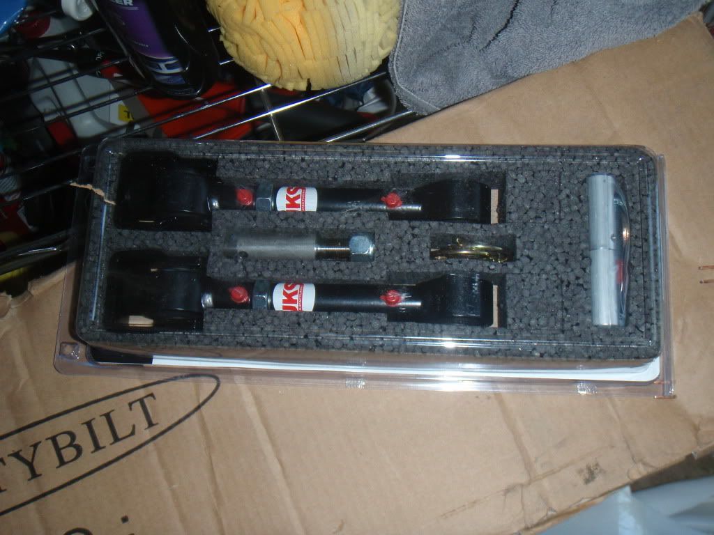

Alright, finally got some pictures to show ya'all. So like I said earlier. I got some new bumpers and JKS disconnects. I guess I'll start with the initial photos when I first opened the boxes. Yup, it was like a great, paper and cardboard Christmas.

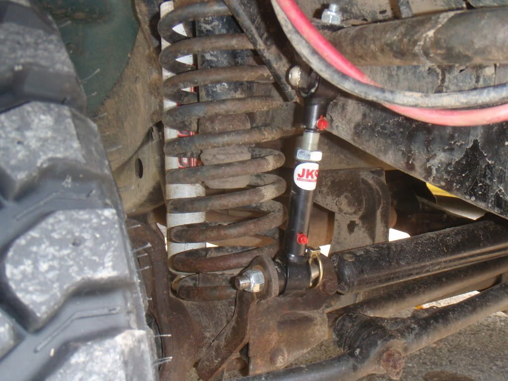

First my new JKS 2" lift endlinks.

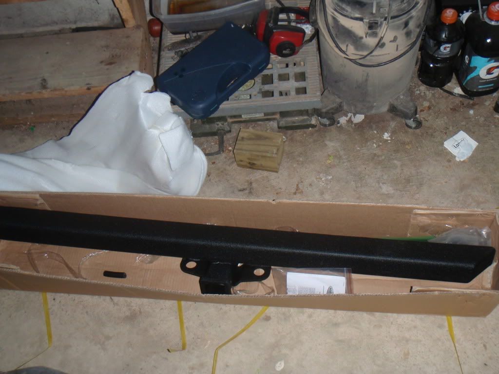

My new Smittybilt classic rear bumper.
And my favorite new item, my Smittybilt front stinger with winch plate in place.

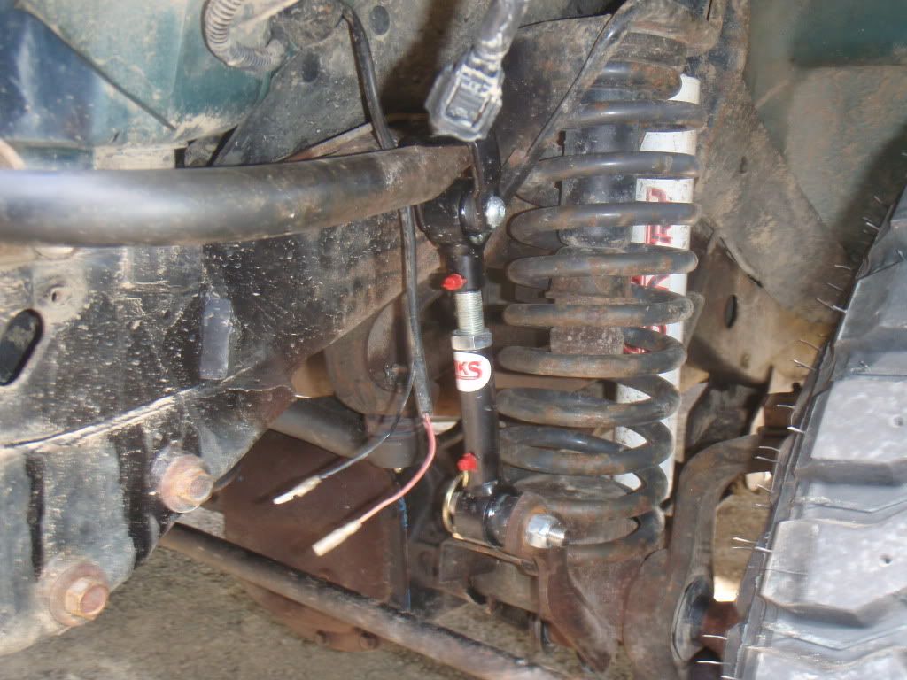

Anywho. My driver side front end link.
And passenger side.
Notice the amount of visible threads from the end links on each side. There's definitely about an inch of sag on the passenger side, maybe more. Add new springs to the list of things to replace. It's just never ending.

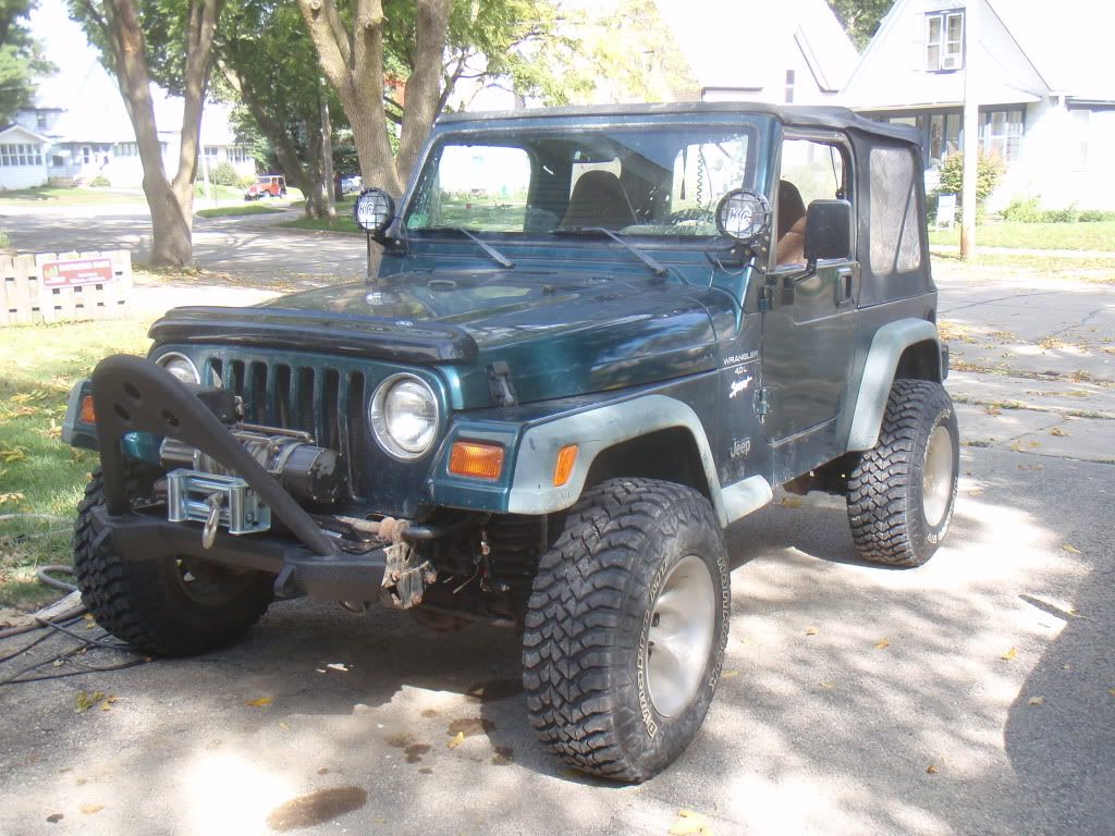

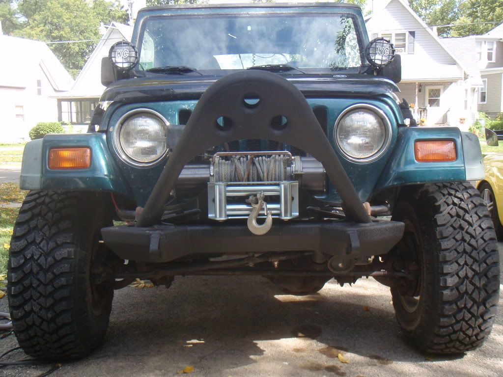

Anyways, back to my new front bumper. Here's a nice angled shot.
And a mean front view that I really like.

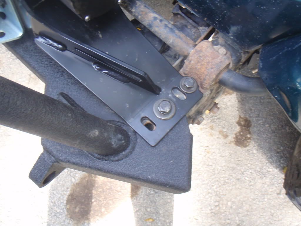

Yup there she is all mounted up, complete with winch. One of the nuts welded to the jeep frame broke off, I think I mentioned it. here's the empty space. I am still confident it'll hold up without the bolt.
And the rear bumper.

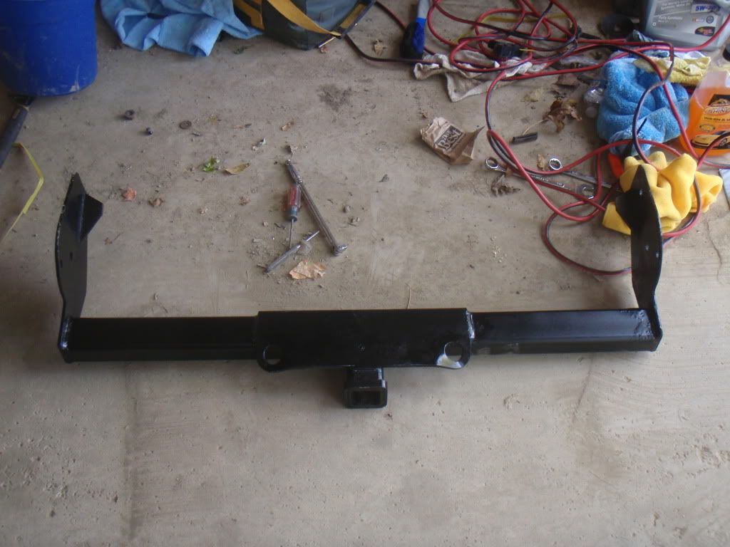

This ended up being a hugely difficult process. The old bolts on the old hitch were mounted with nuts, on the INSIDE of the frame. When I pulled everything out, looked like whoever installed the hitch, welded a wire to the nut to hold it in place. I have NO idea how they got tightened up, but I couldn't loosen them. So cutting disk + angle grinder = lots of sparks, flying bolts and a popped off trailer hitch
The old hitch got ground down, with the assistance of my old man. A fresh coat of paint later and it looks brand new...or close enough anyways. Well my good buddy Drew is coming out to the house tonight and we're going to work on fixing my wiring. In trade I'm giving him the old hitch, since he only has a mini hitch on his TJ. Then tomorrow, time for a trip to the Cliffs!!!!

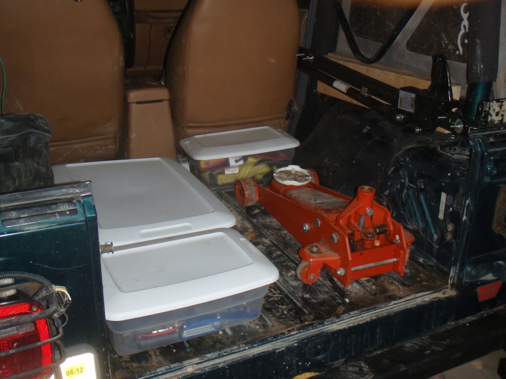

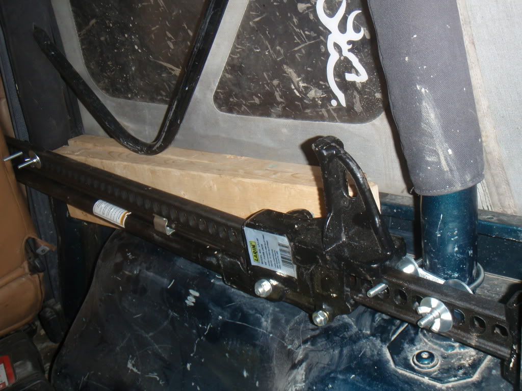

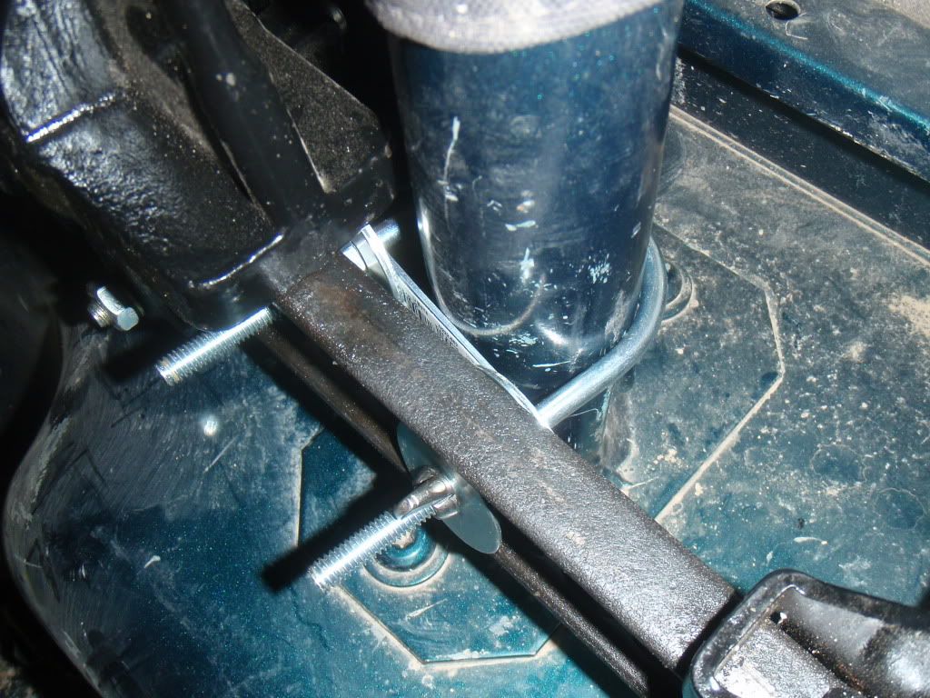

Alrite, Drew isn't here yet, but I did accomplish a few things. I finally decided to build a high lift jack mount. Originally I wanted to do a hood mount, partially because I like the way it looks, partially because I like the accessibility of having it high and on the outside of the vehicle, and to keep the interior as uncluttered as possible, especially for when I put the back seat in. (anyone got a line on a rear set of seat belts?) Unfortunately, I wasn't about to spent $60+ on a hood mount, and my original idea for doing it proved....impractical. Anyway, so a quick and dirty, yet still effective interior mount was the way I chose to go. I went to Do It Best Hardware and picked up some 3" U-bolts and wing nuts. I mounted the U-bolts with some washers I had on hand as spacers. I mounted the U-bolts to the vertical bars on the sport cage on the passenger side.
Here you can see how it was positioned on the rear most vertical bar.
The same was done on the front bar.
Then I mounted up the high lift on the U-bolts. The high lift was a bit long, so it actually sits along side the passenger seat by about 3". It's not perfect, but it shouldn't bother a passenger too much, plus, I probably won't have one. So here's the completed mounting complete with 2x6s wedged between the jack and the wall.
I also cleaned everything up and organized the back for tomorrow's wheeling session at the cliffs. Hope the weather holds and I still get to go.
