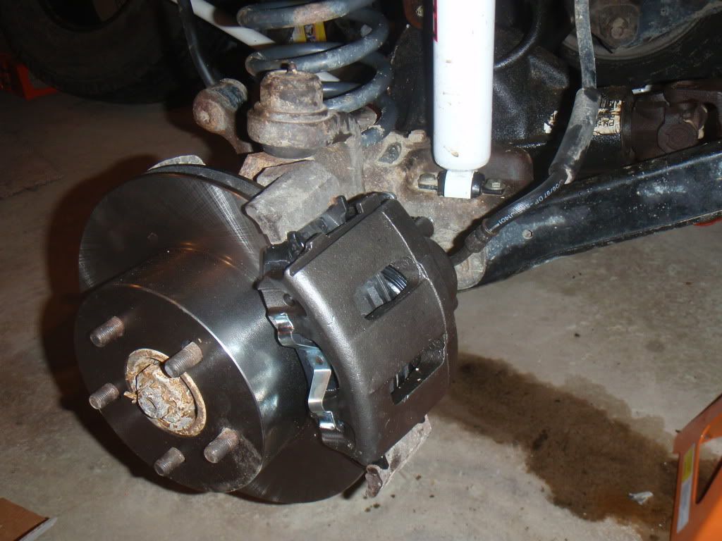

Mount the caliper onto the rotor/hub assembly.
Install the replacement caliper mounting bolts. They require an 10mm socket for some reason. Torque them to 11ft/lbs. I guess over-tightening can lead to jacked up calipers. I've never done it or seen it, nor care to find out, so don't over tighten it.
Remove the green plug, as that's where your banjo bolt is going to go. The replacement caliper should have come with 2 copper washers. The order of these on the line will be, copper washer - brake line - copper washer - banjo bolt. This next step you want to move fast on so you don't lose to much fluid. Remove the banjo bolt from the old caliper, set it up as I just described with the copper washers, then screw in the banjo bolt into the whole the green plug was in. There's only one way to attach it, so you can't scew it up. Tighten it down and discard the old caliper (or save to get your core charge back from Autozone).
Here's the caliper all mounted and the brake line reattached.

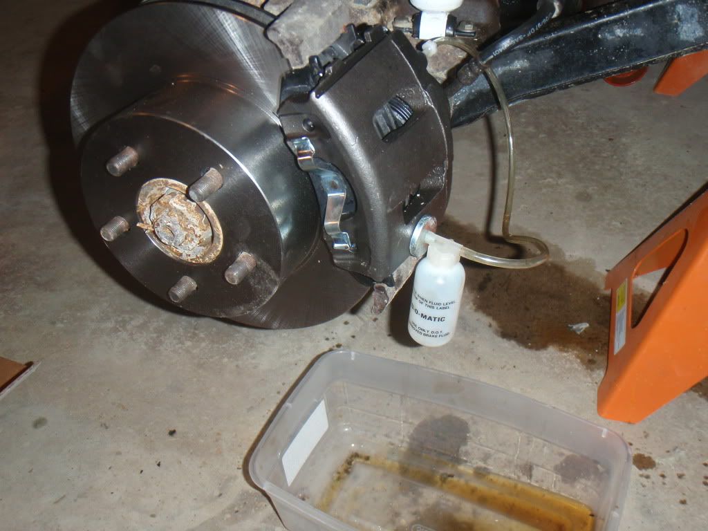

Open up the bleeder valve (loosen it), that's the little silver nipple looking thing next to the banjo bolt near the top. I used a bleed-o-matic that I borrowed from Jeffro. I guess it's only about $10.00 from NAPA, so I'll be making a purchase soon.
Just plug the bleeder hose into the bleeder nipple on the caliper. I hung the bottle using the little magnet supplied with the bottle.
Open the brake reservoir in the engine compartment. Now pump the brakes and watch the bleeder line. When you stop seeing bubbles in the line pump and the bottle fills about 2/3rds of the way, the line is bled. Remove the bleeder line, tighten up the bleeder valve on the caliper and discard the excess brake fluid appropriately. Top off the fluid reservoir in the engine compartment, put the cap back on, re-mount the tire, take the jeep off the jack stands, and you're done!
Repeat the process for the passenger side.

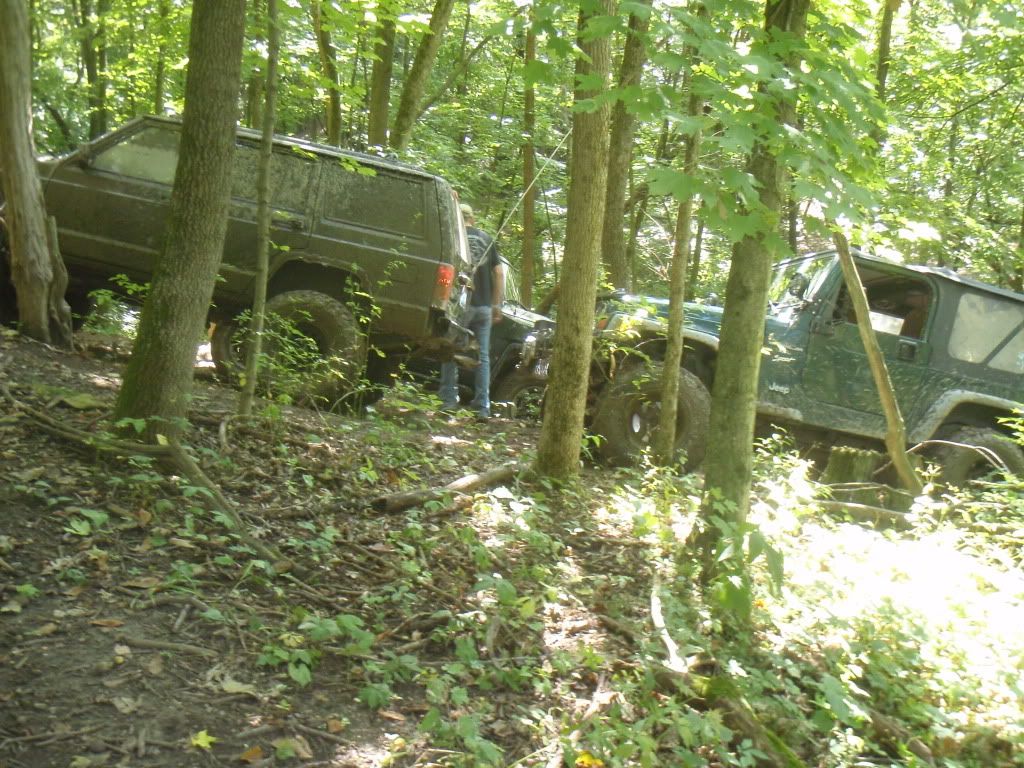

Alrite, so I got to go wheeling again today. I'm REALLLLLLLY glad I didn't just go to the Badlands without going again. Yessiree sports fans, a bunch of other stuff broke again. And this time, FYI, I didn't do anything stupid. And I manage to resist the urge to play in the mud. My buddy not so much, lol, but I did not get TOO dirty.
On the plus side, explored alot more of the park, and tried some new things, learned a few others. First...avoid rocks without armor. I just looked at the rock pile...and imagined a boulder going through my TC...or my gas tank...or ANY of my steering gear. So the pile got avoided. At some point though, no idea when, my front driver side endlink snapped. Guess I'm just going to have to replace it with a disconnect.
On the plus side, I've discovered my jeep can ride 45 degrees on its side. and 45 degrees down. And up. I could take things more extremely if I just had a front stinger. * hint hint * Also realized parking on a 30 degree grade, without a parking brake, very difficult to work with. And before anyone says anything, yes, when I park, I leave it in gear with the engine off, but still. Anyways.

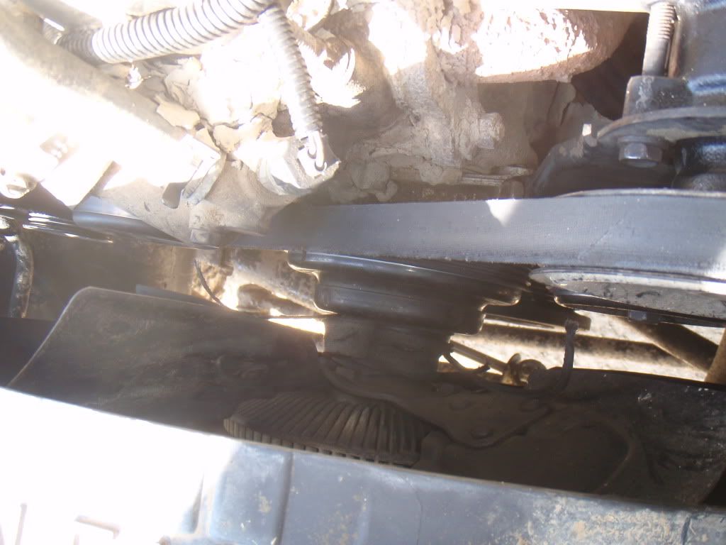

Well throughout the day we noticed a rattle from my engine bay. We looked, and it appeared my AC clutch was rattling. Didn't seem to be causing any other troubles, and the pulley seemed to be spinning free and without problems...and wasn't any making any noise itself, so we didn't worry about it. Until I tugged my buddy Chris's very mud stuck Cherokee. I heard some unusual sound, heard a squealing of my belt, and smoke billowing from the front end. I stopped pulling, and the horror went away. Of course... after a few minutes I noticed a ticking. Killed the engine, popped the hood. And found shredded pieces of my belt wrapped around my fan. After burning my hands a few times, I grabbed my gloves and my knife and cut the fan free. (Yup, I brought gloves, I'm starting to learn what actually to pack on these trips ) Oh well, I managed to successfully limp my jeep back to Dekalb, and it's now parked quietly in the garage.
JKS disconnects on order from EBAY. I'll pick up 2 new belts tomorrow (Yup, I'm getting a spare). Hopefully I can get the AC fixed Friday, and then I MAY go wheeling again on Sunday after my BBQ. I also found some trail scars on my driver side. Lost a fight with a tree on some narrow trails. I'm actually kind of proud of them. Not sure how I should patch them. Any suggestions? I'm thinking of just going the cheapo way and spraying black :P. I want to paint my jeep black at some point, not sure if I want to ghetto-fy my jeep with random black spots over the green...but I also don't want rust. Hmm...I'll be thinking about it.
But regardless, what everyone REALLY wants. Some random pics of the events!
Yup we're those guys.
A couple of fine looking vehicles, if I do say so.
A good place to park.
One of the more terrifying moments of my life.
My broken endlink, also a little bit of flex from that stupid ditch I got stuck in.
He was very stuck. You'll never see me do it again.
Mud flying, verrrrrry stuck.
My very shredded belt.
The old girl took a beating, note the KC lights.
A few battle scars.
My adventure continue. I'll keep the few who read this one posted.
