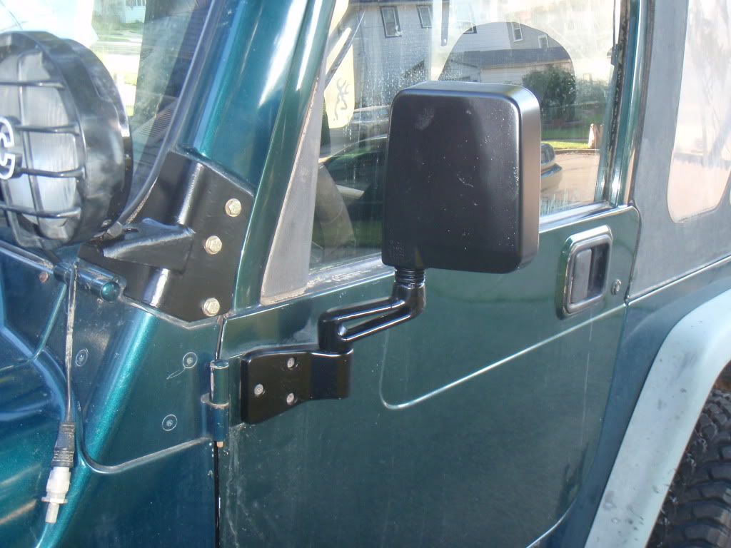

And my mirrors, though you can kinda see them in the previous pictures. I'm going to have to sand em and paint them again I think. You can definitely see oil spots where I touched the mirrors prior to priming...and probably after priming. Note. Don't touch painted surfaces with bare hands.

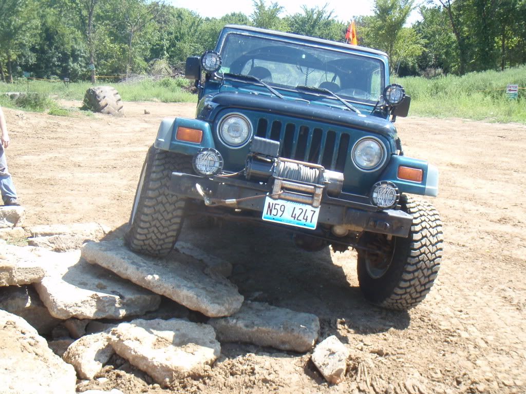

Well I made it to the cliffs, and let me tell you, it was an educational experience. I learned how to replace a valve stem in a tire, that I absolutely hate mud, how to remount a tire on a rim in the field, that a 90amp alternator CANNOT power 2 jeeps simultaneously, I'm pretty sure my jeep hates me, and a whole series of other thing I'll get to in a few minutes.
Well we get to the park with minimum issues. Forgot to coordinate with other JP folk, so I ended up not meeting with anyone, but I did bring my buddy Jake. So we got to the park, hooked up my flag, and up the trail we went. Stopped off early and aired down to 14psi in my brand new mudders.
Jake helping me out. Note: a screwdriver works better than the crappy little valve on my tire gauge.

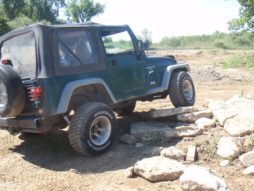

Started off by playing on a rock pile. Seemed like a good idea and it really was a lot of fun. Scary as hell, but fun. Not used to driving on a pile of objects with sharp edges. I was just praying I didn't pop anything. I did finally get to stretch a little
Played just a little bit around the edges of the pile, I wasn't yet feeling brave enough to clear the top of the pile. Sat and watched a bunch of ATV's playing for a bit, then continued our adventure. Worked our way around the park, bypassing the big mud trenches that appear to be there so people can get their mud fix if they feel the need for one. I did not at this point in the day. Did a full lap of the exterior path of the park with no major incidents. Never got stuck, didn't break anything, didn't need to even look at the winch. It was almost too easy, still a lot of fun though. But we couldn't go through just one lap and NOT play a little more.
So back to the rock pile to play some more. I was feeling a lot more comfortable at this point so over the top we were going. I wish there were more pictures, you think since all Jake had to do was ride shotgun he'd have been all over taking pictures, but alas, there are very few. Anyway, so over the pile I start to head, get to the peak, a rock shifts, the jeep slides to the left a bit....and I hear a rush of air. : I look at the tire from my door, I don't see anything yet. I back her off the pile as quick as I can trying to avoid breaking anything else. I get her back down to the dirt. I find the problem right away.

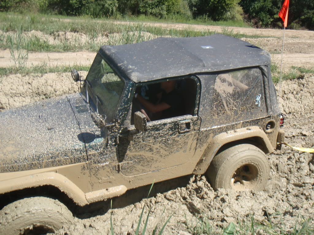

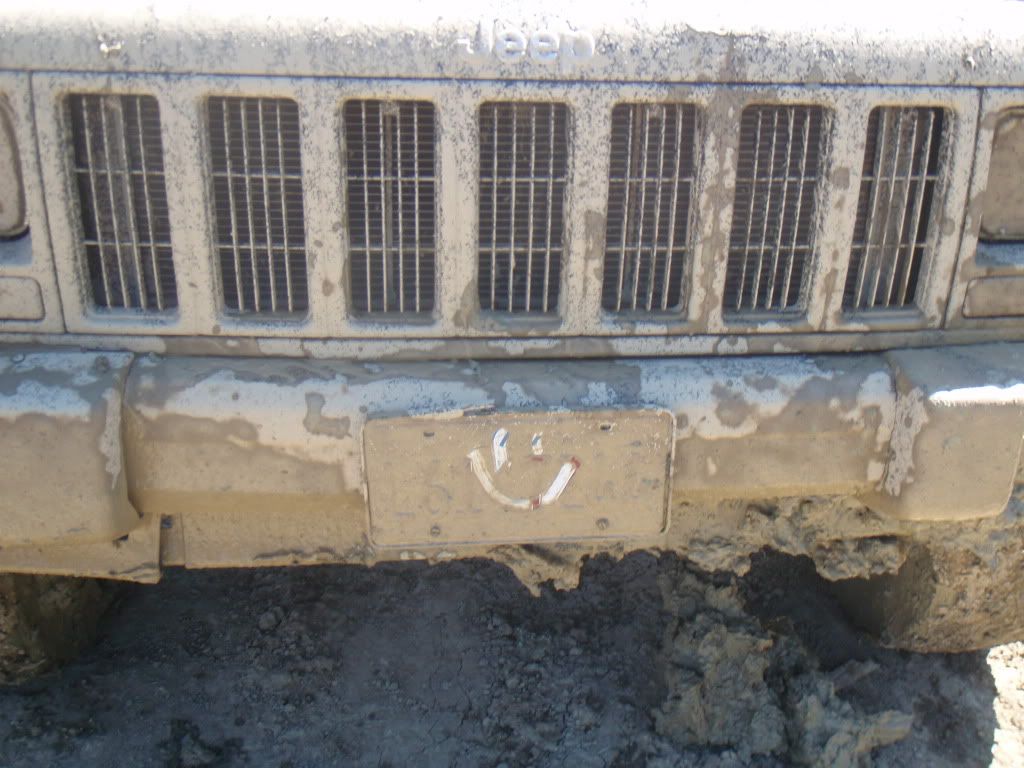

And the playing continued, our very intelligent stock friend just watching. I started getting cocky and stupid. Went through a bug mud pit, got through no problem, then there was a hump and another one right in line. I barrel into it full speed....and hit something. I'm completely stuck. I pop my head out and this is what I see.
There are no words as offensive and horrifying as the slew of curse words uttered from my lips when I saw that. I blew the bead on both sides of the tire, and now I'm terrified a jacked up my brand new tires. Pat drives around to tug me out, if he can and goes to drive through this dinky LOOKING little mud pit, instead of taking thirty extra seconds to go around the pits. He gets stuck. and I mean REALLY stuck. He managed to bury both differentials completely in clay. The little stocker grabbed the tow strap and tried to tug him out, no good. We were going to try the winch, but as it turned out, his winch didn't actually work. No one had a shovel. This was turning out well. Thankfully after maybe 45 minutes of digging, a good samaritan showed up, and tugged me out. We pulled the 31" spare out again, mounted it up and repositioned to help out Pat. A good hour and a half total digging time, finally I parked mine in front, winched up, and tugged him out.
The final damage amounted to 2 of his fender flairs completely broke off, another half broke off, half of his front bumper cover was torn off. We decided enough was enough, we'd head to the creek off of the parking lot, wash up a little, and then call it a well abused day. We made it to the creek when Pat advised me of the next problem. His Jeep was drawing from the battery, and his amperage was dropping quick. His alternator was dieing on him. Apparently it had been a common occurrence, because he had a spare in his jeep. He did a quick splashing lap in the creek to rinse off and parked it for a minute.

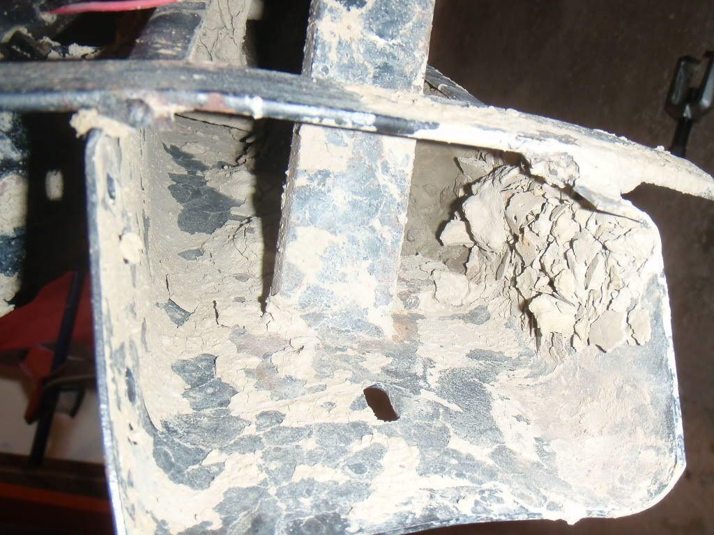

I did the same, and tried to clean some of the mud out of my unmounted tire to decide if it would be possible to remount it, or if I was going to half to tricycle home on my 28" spare. Our stocker friend decided to play in the water, and started playing in the deeper section. Low and behold, he got stuck. After rocking back and forth trying to get out for a while, the jeep actually began digging itself lower in the water. After a few more minutes of that, the jeep just died. Sadly he didn't give anyone a chance to get into position to tug him out. Before me or Pat could get into position to tow him out, a nice fella in a Suzuki Samurai back in and towed him back to the lot. Me and Pat decided we'd head to the lot, he'd swap his alternator while Phil tried to get the stocker running again, and we'd all get out while we could. I swapped over to my little spare and back to the lot we went.

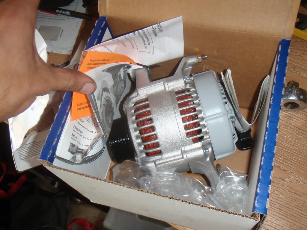

On to what I posted about earlier. I had some power issues to say the least. So here's the details and my responses. First, I drove home form the cliffs, after having been running two jeeps off my alternator, I drove home, turned off the jeep, and she stayed dead. Through her on the trickle charger over night, unplugged her in the morning, she started right up, turned her off right away. Went to work, came home, she started right up. Drove out to Warenville that night for a little Buffalo Wild Wings, which is about 40 minutes away. Stopped, and she was dead again. Got a jump drove her home...and dead again. On all the trips, about 20 minutes into the ride, the battery gauge would drop to nothing and the heat gauge would spontaneously hit 240. Didn't hear any boiling...but I kept the revs and the speeds low. 55mph(at least according to the dash which I know is off) and in 5th gear. It's an absolute dog, but it kept the temps in check and kept them in the 210 range.
Anyway, so I pulled the battery, brought it to Autozone...annnnnd low and behold it checked out Ok. wtf. I figured since the jeep never died while driving, it HAD to be the battery. While I was there I also picked up a replacement steering box, seeing as this last trip...broke whatever seals were left. Yes, it was leaking out of every seal on the box. I did not purchase a Durango box. The price difference was about $60.00 I believe, and right now, I'm sort of on a budget. Anyway, so we established the battery was good, and I brought home the new box.
Someone mentioned the possibility of the alternator going bad, which I couldn't understand, seeing as the jeep never died while it was running. Well, I'm not above being wrong, so I yanked the starter, and brought that to Autozone. And before anyone else points out the obvious, yes there was mud on/in the alternator, and yes, I washed it off with the hose as much as I could prior to bringing it to Autozone. Side note: pulling it out is a serious PITA. I had to unbolt the AC pump to have enough play to pull the alternator. Anyway, long story short, I bring it to Autozone...and it fails virtually instantly. And I'm proven wrong again. You live you learn, and thanks everyone that gave me advise on it!
So I've also been reading about the Durango 160 Amp alternator. I asked the cashier to look up the part for an 02 Durango 160 amp alternator, as that seemed to be the popular choice for the mod. The associate pulled it out... and the connector was not the right one. I ended up just getting a direct replacement, only a 90 amp. It's cheaper and I really just need to get rolling again.
I get home, open up the new alternator and take a look. Annnnnd one of the terminal mounts are broken. Grrrrrrr.
The busted Alternator.
I'm taking this as a sign from God. To JF I go for more Durango research. After plugging around for an hour, I find that the 160 amp works on the 02 and newer TJ's for sure. I THINK (Don't hold me to this as I have no way to confirm, feel free to chime in if you can corrent me) 99 and newer have a different connection for the alternator. Pre 99 uses a diferent plug and requires a different year Durango alternator. I find that a 98 Durango alternator will fit. Draw back, its only a 136 amp. Still a 46 amp improvement over what I have. I have a winch and a bunch of flood lights.... I'll do it!
Back to Autozone the next day. They knock of 10% for the previous damaged alternator, and another $20.00 for having a rewards zone card and another $30 for the core replacement. About $90 out the door. Not to terrible. Get it home and hook it up. It actually went in faster then the old one came out, go figure.
I know you should technically only fix one thing at a time...but I never was real bright. Sooo I got started on the steering box.

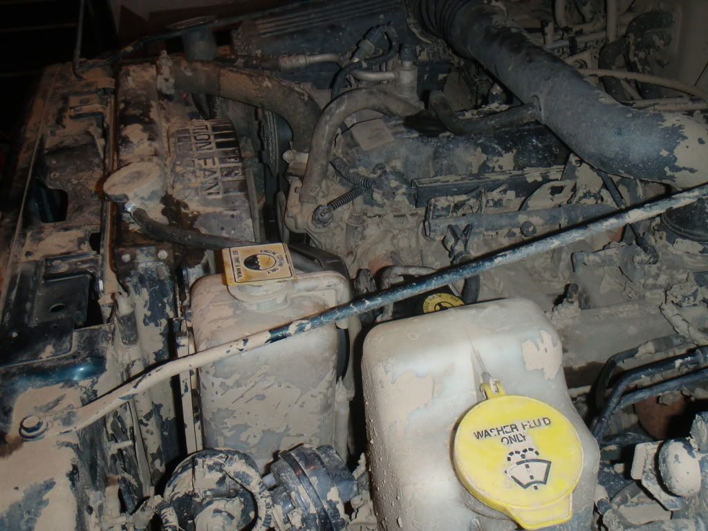

I made a little extra space for this project by yanking the coolant overflow reservoir. Thankfully the hose on it has enough play to let me just lay it on the engine.

Start out by disconnecting the hoses from the top. I successfully managed to break the plastic nipple of my power steering pump. Well sunuva........ This project is clearly going well. I call Autozone about a replacement reservoir. They don't carry one, only the full pump unit. I call around town and Napa carries the reservoir for $30. Autozone's replacement pump is $50 after yet ANOTHER discount. New pump it is! I go to Autozone, pick up the new pump and a pully puller kit.

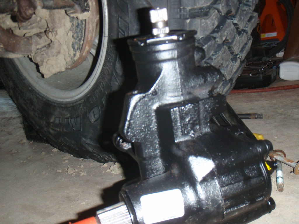

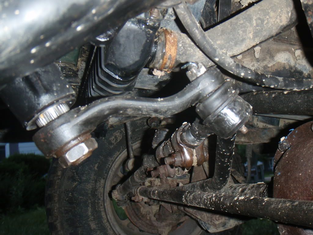

And back to my my steering box. I unbolt the steering shaft from the box. I cut off the old cotter pin from the castle nut that connects the pitman arm to the tie rod, and remove the castle nut. I leave the pitman in place on the steering box for now. I have the bench vice for that particular removal. I pull the 3 bolts that connect the box to the frame and pull the box. It's heavy, and it's dripping like crazy. Thank God for air tools. Though I have to admit, with all the remaining mud...it was pretty much raining all over the garage floor from the impacts.
Anyway, so that got pulled and the new unpackaged. Here it is in all its close up splendor.
I toss the old box in the vice and break out my pitman arm puller. I loosen the main bolt holding the pitman arm in place. I leave it in place, but loose. I've read to many stories of flying pitman arms, and have no urge to have a live demonstration. Pop on the arm puller and the arm comes off without to much fuss. Thank God. Here's to the little victories!!
I bolt the hoses up to the new box and thread them through the underside of the engine compartment. I hook the box up to the steering shaft and bolt the box back up to the frame. I put the pitman arm on the new box, line everything up, replace the pressure washer and bot, tighten everything down...and the arm doesn't go all the way onto the box. I torque it down and nothing. The teeth are 3/4 through the pitman arm, so everything still functions. I don't know how important it is to get the arm all the way against the box. I'm getting an alignment in a few days...I'll have them take a look at it. I bolt everything back up, and at least for the moment, I'm good to go.
Here's the gap in the pitman arm. Anyone have any advice how to remedy this? This also shows the castle nut and new cotter pin.
I start the jeep up...and low and behold! Everything works! I fill up the power steering reservoir, bleed it, and everything seems to be working good. I take her for a run around the block, and it all works like its supposed to. Woot! Of course...that ignores the fact that it tends to pull to the right...and when I hit the breaks it pulls HARD to the left. Like I said, an alignment is in my near future. I'm also overheating really easily. I did notice there was quite a bit of mud packed on the back side of the radiator. Ya know, I bet that's the issue. So today I spent a LONG time with the hose cleaning it out. Looks better now. I'll run it tomorrow and see if it fixed it.
