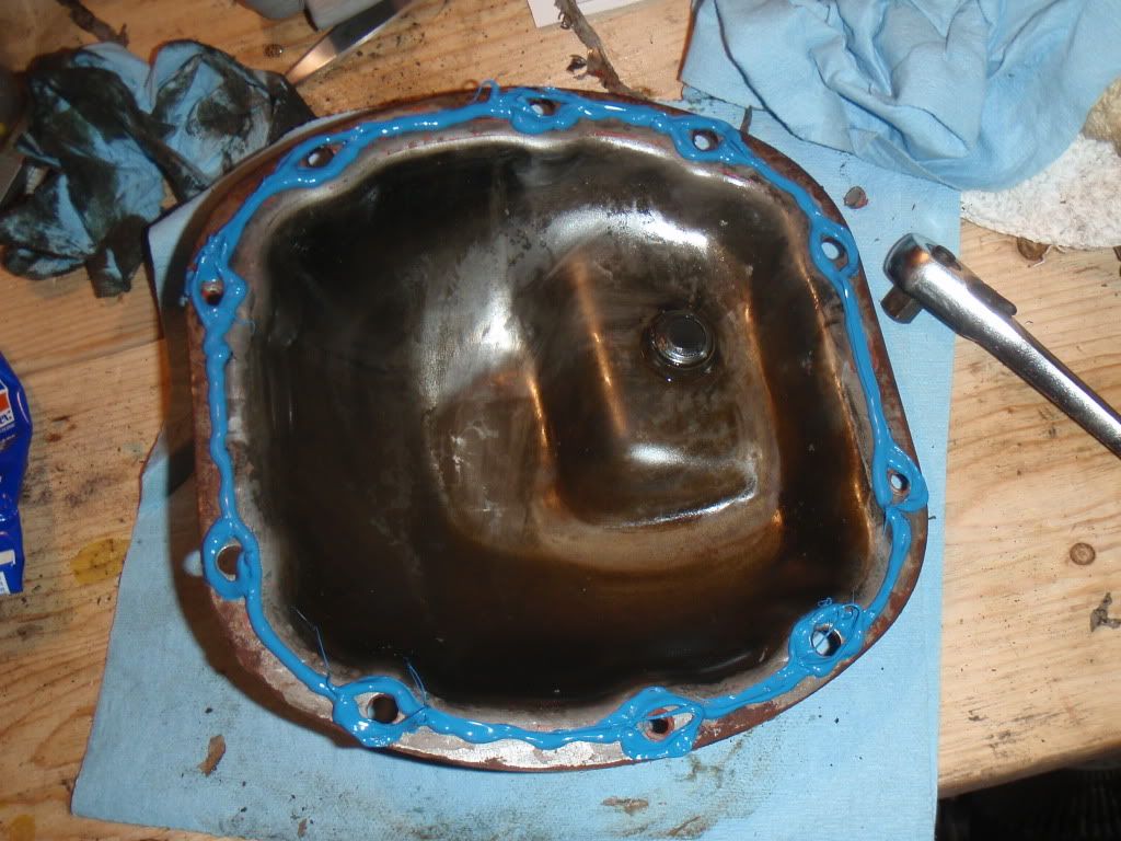

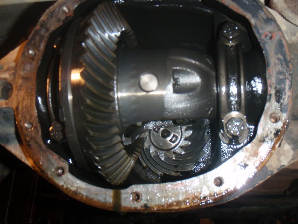

My neighbor also came over while I was sealing the diffs back up. She's renamed blue RTV as smurf poo. I thought it was appropriate.
Before I refilled the rear differential, I decided to fix the leaky pinion seal that we found in our going around the vehicle. $15.00 at my local Jeep dealer (I went to 3 local autoparts stores, no one carried a rear pinion seal for a 98 TJ. Now that was rediculous) That, surprisingly went really smoothly. Minus the fact that there's STILL mud coming out of every nook and cranny of my undercarriage, ESPECIAlLY when I'm wrenching on anything, the procedure went relatively smoothly. The only stalls I had where the old seal and the new seal. Had to run out and buy a seal puller from Autozone, because I couldn't yank the old one with a screwdriver. My other issue was putting the new seal in. It said in the write up I found, just tap it in. Well, tapping involved a couple 2x4s and a big rubber mallet. Took me a while to figure it out. I tried just tapping the seal itself with a mallet, but it would go in strait, then a pair of 2x4s around the edge of the seal got it seated, then I just went around the edge with the mallet until it was in place. After that reassembly went smooth. Filled up the diffs, and took her for a spin around the block. Checked everything, no leaks drips or anything else. Good sign.

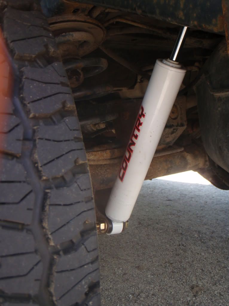

Finally got to get back to work on finishing installing the shocks on Sunday. Double check everything is good with the rears, yup good to go. I move over to the fronts, take a look at what I'm doing. Everything's still covered in mud, so I clean off the hardware as much as I can.
I start on the passenger side shock first. Unbolt the bottom first. Once you get past the dirt, rust and seizure issues, it really came apart quite easily. Or at least, soaking everything in PB Blaster definitely makes things easier. I move to the top, start wrenching, and the whole upper half of the shock is just spinning. I use a 1/4" wrench to hold the top of the stud, and its still slipping out. Hmm... So I bust out the locking pliers grab onto the shock shaft and give that a whirl. That works better,but it's still ridiculously hard, not to mention taking forever. Time to try something a little different.
I make a run to Lowes, and buy a set of ratcheting combination wrenches. I have a few in metric sizes, but nothing in imperial standard. It's a little pricey, but in my experience, they're worth their weight in gold. Get them home and back to work.
I get to work with the wrench, and use a second wrench to lengthen the arm, and start twisting. It works like a charm!..... until the stud snaps off below the bolt. Oh well, they were junk shocks to begin with, and it accomplished the same thing. I pull it out. I open the piston by hand, it stays open. I close it by hand, it stays closed. Yeah...new shocks was not a bad investment.
I break out one of the new front shocks. I'm looking at this shock still strapped in the closed position. I figure I'm supposed to mount the top first, cut the strap, and let it expand. Great plan...in theory. I put the bushings in place, put the stud up through the mount on the chassis, place the other bushing and cup in place, and there are no threads visible to place the bolt. Great. I push up with both hands and can expose the threads, but I can't hold it one handed. Hmm... issue. Thankfully my friend Staci was over and washing the interior for me from the mudding adventure at the Cliffs. God bless bored college students. I get under the jeep, push up, and she gets the bolt started for me. Yes!!! I tighten it down, cut the wire and the shock expands and I guide it into place on the lower perch. I bolt it in, no problems, tighten everything up, and it looks good to go. Here's to the small victories.
I move to the other side and at this point Staci bids me goodbye, work has a habit of interfering sometimes. I look at this and again try to mount the shock to the top first, this time solo. Not happening. Then I remember something I read in a thread about mounting the bottom first. Hmm...no way this has enough upward pressure to work. Heck, I'll try anything once. I mount up the bottom, easy as can be. Snip the strap, and the shock opens up, right through the hole in the upper mount all by itself. I place the additional bushings and cup in place and bolt it down. Tighten everything up, double check all four shocks and examine my work. Ya know what, not half bad. It might even function like its supposed to.
Finally, a freshly mounted shock.

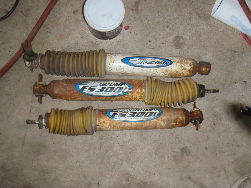

And just to put things into perspective, this is the remains of the old shocks.

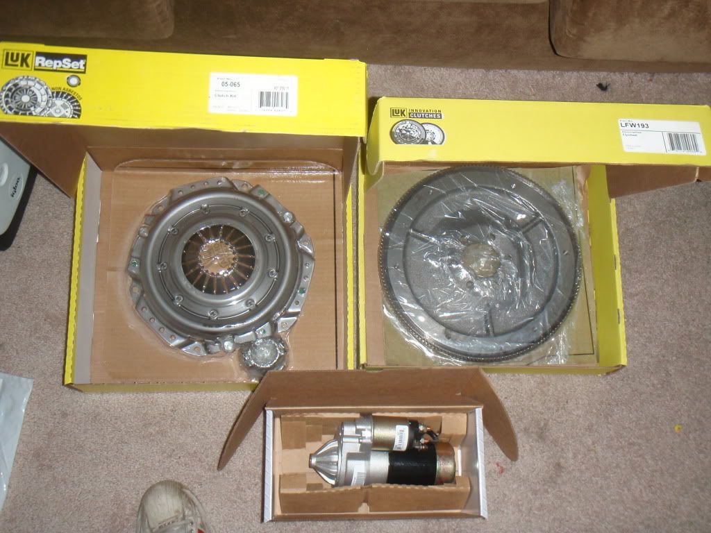

Monday comes along, and then goes. After a little net search I find out there's a Lee's auto about 3 blocks from my house. Didn't even know it existed till the day before and it turns out it's the closest parts store to me. I give them a call and they say they can have all the parts I need on hand by the end of the day. I show up after work, and I get a big stack of boxes.
$132.99 for the clutch kit, including pressure plate and bearing
$72.87 for the flywheel
$94.89 for the starter.
Grand total of $362.61 after tax. The cost of the clutch kit alone for my Spyder was over $400. This was GREAT news for me. I bring everything home, and naturally, like any kid on Christmas, take a look at what I have.
Everything lined up nice and pretty...well, pretty as fairly plain cardboard boxes can be.
And everything opened up.
No surprises there. Everything I need appears to be in place. I leave the parts in their wrapping. No need to mess with any of that till install time. Now I just have to wait until this weekend to get started. It's going to be a painful week.

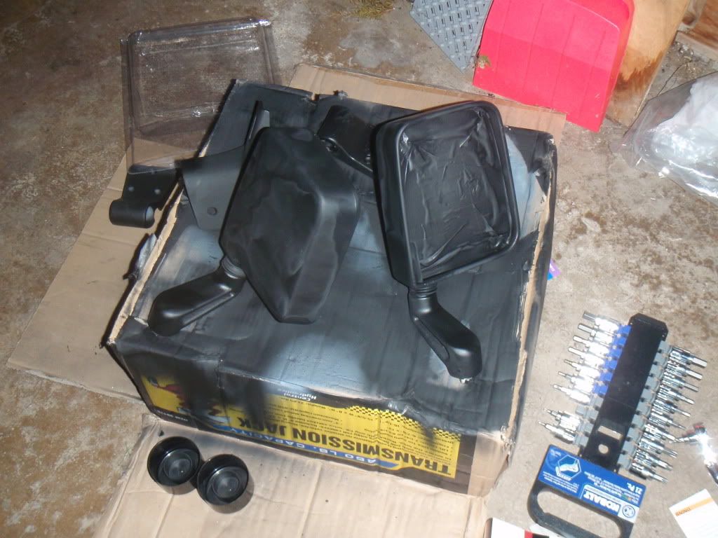

After all that, I get home and decided to start by painting and touching up my mirrors and spot light mounts. Here's what I had to work with.
And after a little grinding.
http://i1216.photobucket.com/albums/...3/P8050003.jpg
And Devin (the buddy I bought the Jeep from) came over to help out. Lots of sanding.

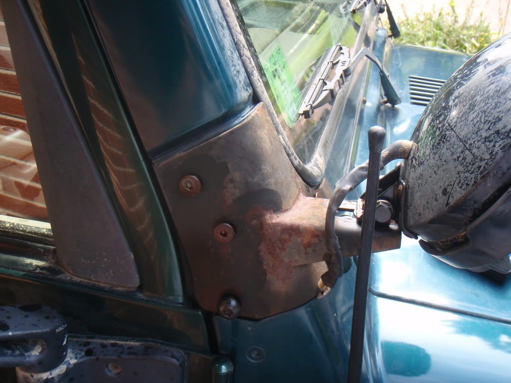

Devin goes to remove the passenger side spot light mount, but he ends up stripping out one of the hex screws. I'll have to drill/easy out it later. So I'll continue to have one rusty mount for a few more days.

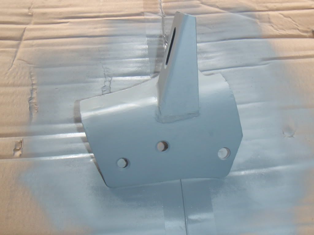

I'm a big fan of the Krylon product line soooo, a can of Krylon grey primer and flat black got pulled out.
I wiped everything down with acetone, then sprayed 2 coats of primer on each part.
And then next morning a coat or two of flat black.

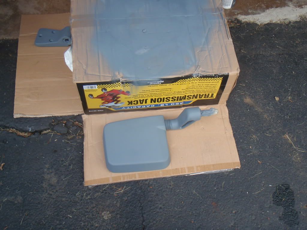

Alright, quick update. Re-taped up the mirrors again with an old piece of target, since I couldn't find an old newspaper around. I cleaned everything up again, and wiped everything down with acetone. Sprayed a couple coats of Krylon black Satin on the mirrors and a last coat on the spot light mounts. Everything looks to be coming along really well. I snapped a few quick photos.
Side note: uploading to photo bucket and THEN to here, is a HUGE PITA. Thankfully I'm actually really enjoying keeping this updated and documented. Probably the only reason I have been continuing to upload the photos.
Everything laid out after a few coats.
One of the mirrors after having dried for about an hour. I seem to be having trouble getting rid of some light spots. I have a feeling that has to do with paint prep. After all, I am still pretty new to the painting thing. Practice comes perfect.
And one of the spotlight brackets.
