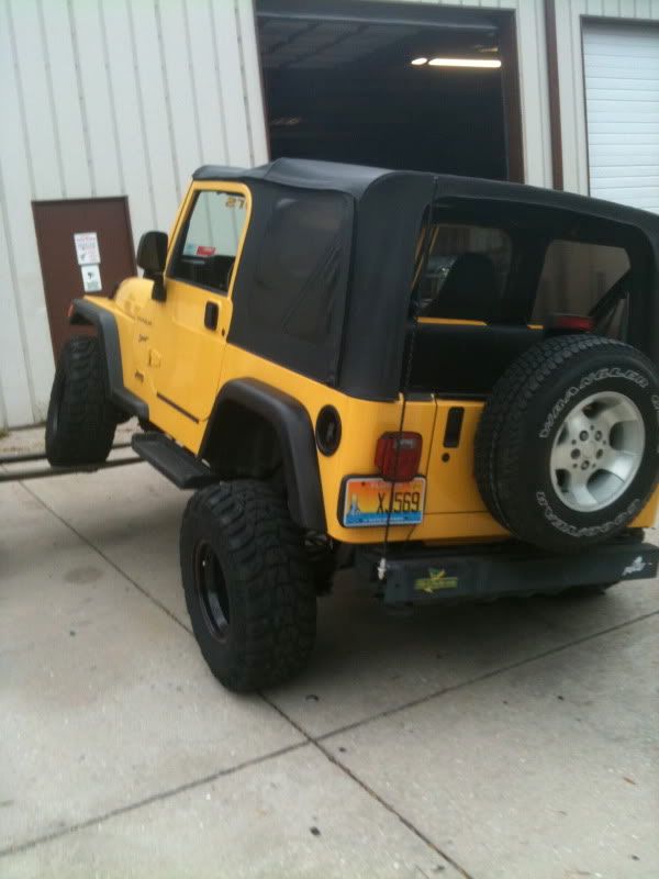

night i got it.
next day..

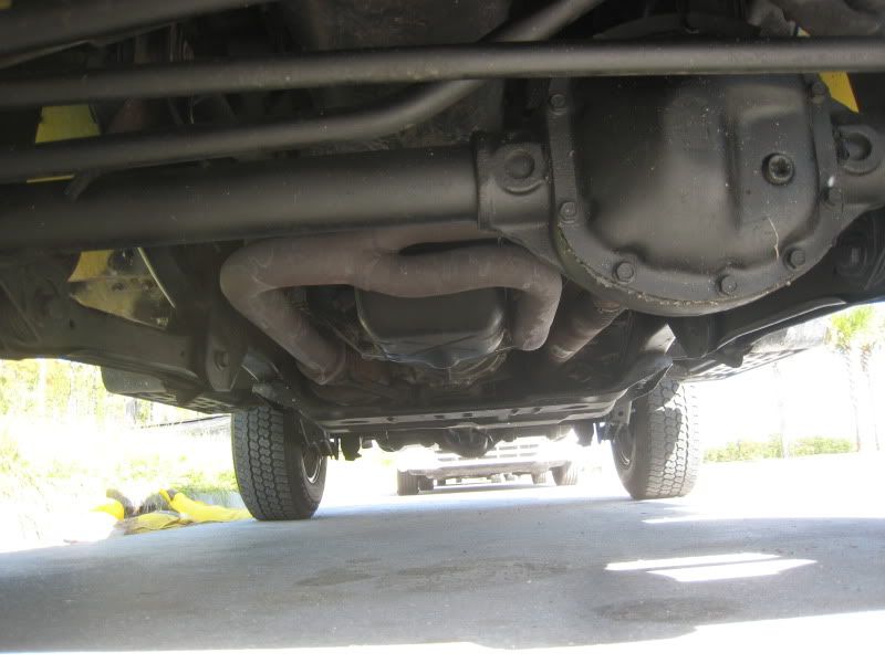

undercarriage shots,, it was alot cleaner when i got it believe it or not..

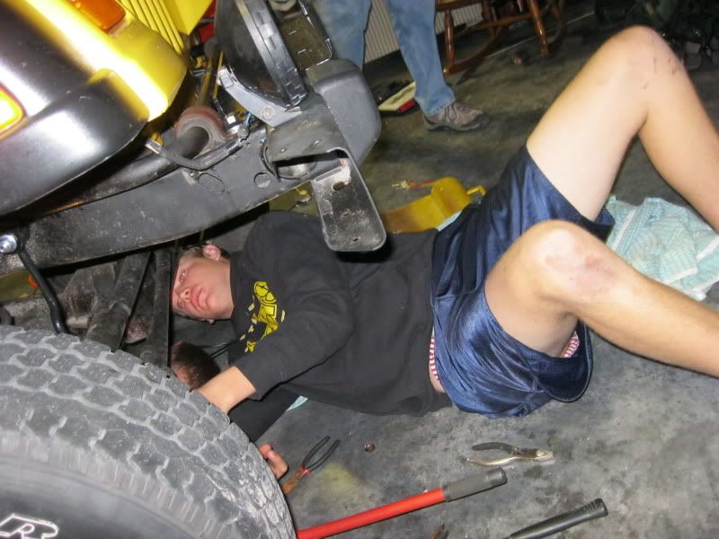

me working on her. (The PO called the jeep "sunshine", idk what to do for a name though)

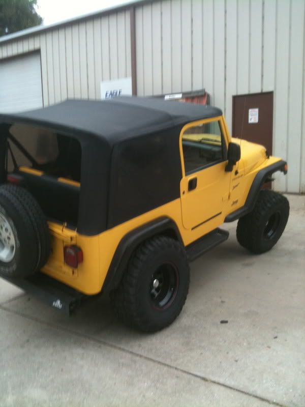

bumper cut and it was nice today so took top and doors off (December 16th it was 70 degrees) I love it
As you can see got a few stickers as well as joined a jeep club by my school

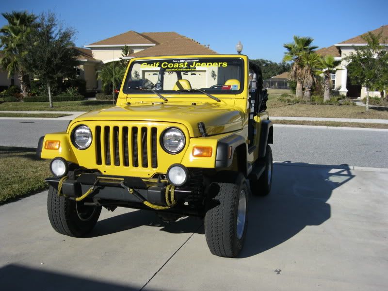

As you can see I got my wheels and tires.. did not end up getting the procomp wheels but these are similar.. I love the tires though they ride great and balanced fine. I did go with a 15x10 wheel with 4inch backspacing.. I went with the 10 because i like the look and do not air down much so not really worried about losing the bead seal, plus figure the stock tires were 9.5 wide on an 8 inch rim, thats only 3/4 an inch wider on each side than rim.. mine are 12.5 on a 10 inch rims, thats 1 and 1/4 inch so i figure its not that bad.. I think it looks geat though.
Also added a steering stabilizer as well as a dif guard for the D30
Let me know what you think
